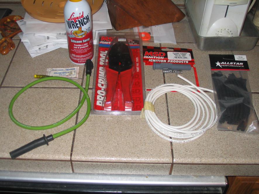

                                Wound up using 30 KV 2 amp rated Ham radio type diode blocks from ebay. 30 KV rated white silicone insulated tinned copper wire to connect diode blocks to spark plug wires at plug ends also from Ebay.
                                I found a great source for 2 of the ingredients I used, I promised to give credit to him. Josh Lee Sales Mgr. at Silver State Wire and Cable supplied 22gauge green hi temp insulated tinned copper wire to connect coil+ to diode blocks, also some really great black industrial heat shrink I used over the white 30KV wires to plug boots. Josh is a Great Guy, super nice and showed enough interest in what I was doing to drop what he was doing and go out in the shop to help find what I needed. My shameless plug: his phone # is 775-356-8969 Call him for wiring needs!
                                Diode blocks came w/o screws, I found short stainless M5 screws at Home Depot, then cut little pieces of copper tubing to act as crush spacer sleeves between screws/wire terminals. Used vinyl vacuum caps over screws for insulation. I went to an industrial rubber supply house and got 2 feet of some Goodyear yellow water hose, kinda in between HD Vinyl and rubber. cut that into 3" pieces to act as vibration and terminal sheilds, clamped 'em to diode blocks with zip ties. Crammed all 4 blocks together in a rear upper corner of engine bay, they just fit.
                                I hope Admin doesn't mind my plug for Mr. Lee, I told him I'd give credit! I'll post pics of the diode blocks/hardware later.

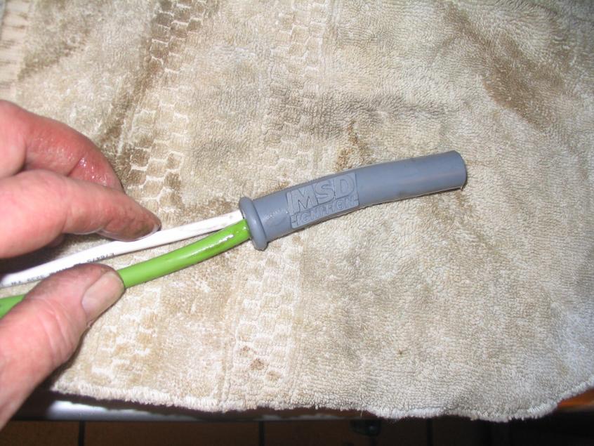

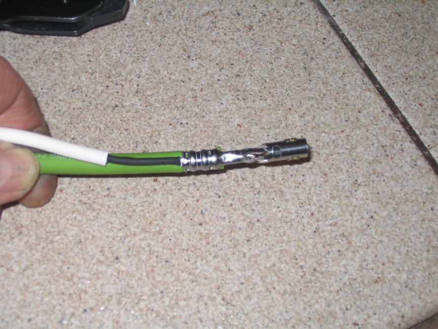

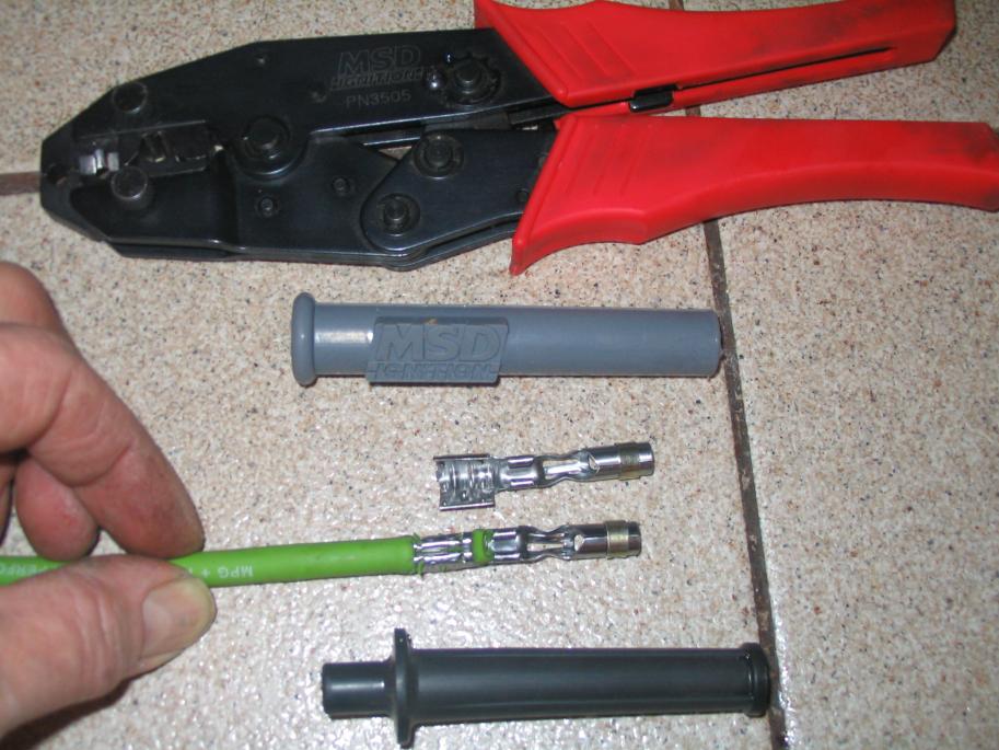

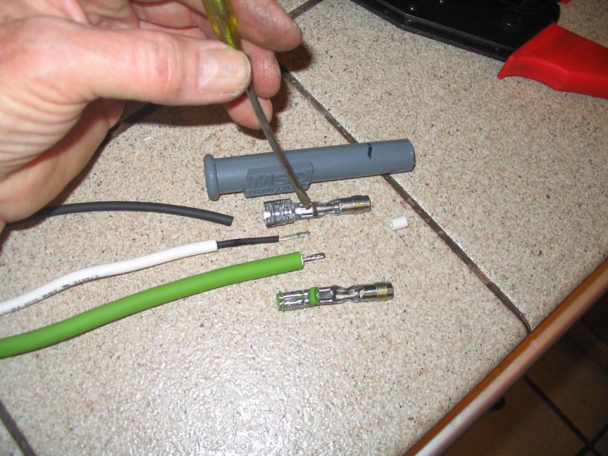

                                These pics show details of how Granatelli MPG+ plug wires were modded w/ MSD plug terminals & straight silicone boots. The MSD terminals are identical to ones on Granatelli's. Using MSD ratcheting tool I put both the stripped back Granatelli wire AND stripped back white 30KV wire into same terminal. I stripped white silicone wire back about 1 inch and added short heat shrink over the part that would be be beside the Granatelli wire inside the boot. w/ silicone grease and spray and care, the whole deal slipped into the boot OK. Granatelli MPG+ wires from JCWhitney online, MSD straight silicone boots/term's from Summit Racing.
                                Resulting spark from this setup is something Else. I'll post a short video once I figure out how. And I'll post pics of the diode block/hardware setup.
