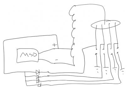

    #4 - Did you fasten the High Voltage Diode up to both the T-junction and coil positive at the same time to check for plasma? Or did you only try running the engine with the diode completely removed? (Wondering about RFI from an open antenna effect.)

                            That makes things simple being positive - always my preference.
                            That resistance is pretty low too - looks good.
                            If the hv output is truly positive, then this is how the diodes should be pointed. This of course doesn't address you possible rf problem, which I'm not so sure about or igniter issue if there is one.
                            Just to re-confirm, is this how you have your diodes or had your diodes?
                              Yes and I did try them reversed and it wouldn't run at all.
                                Any ideas of how we can get this to work???
