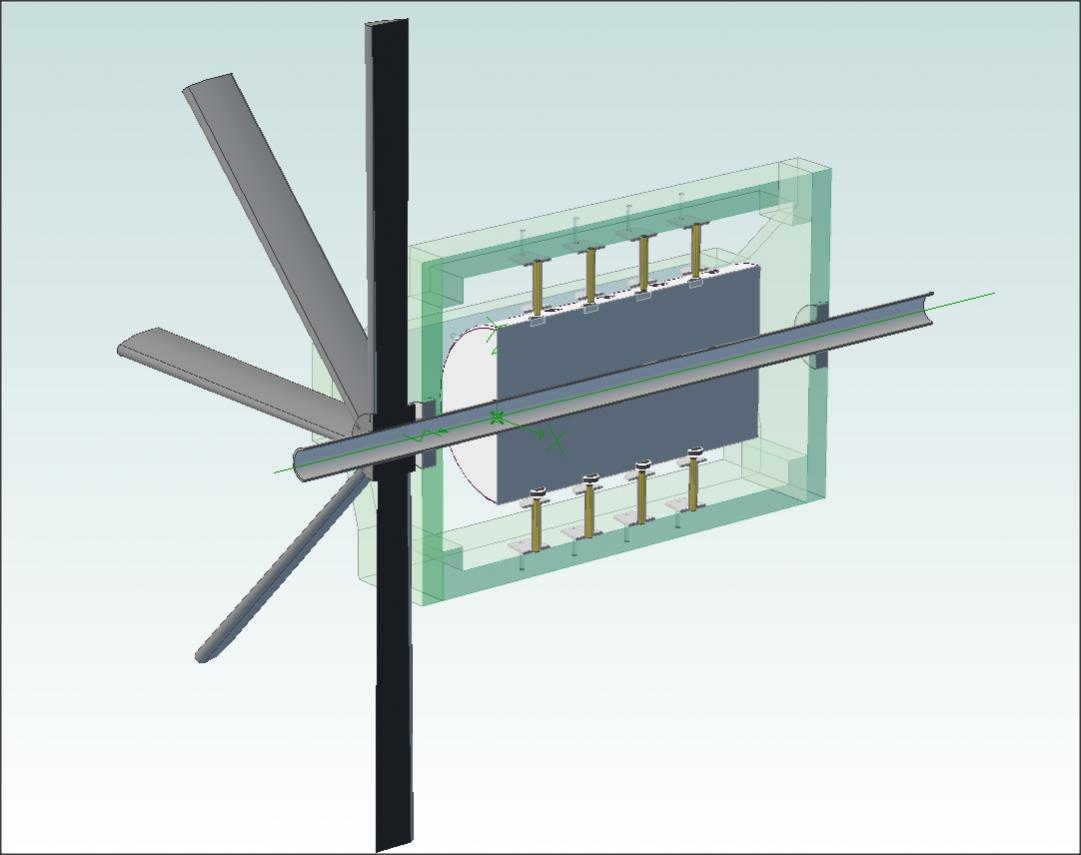

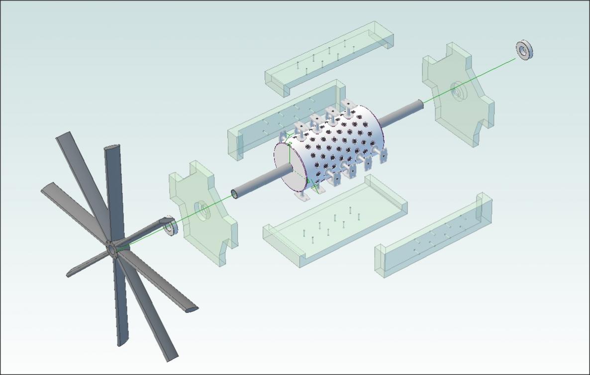

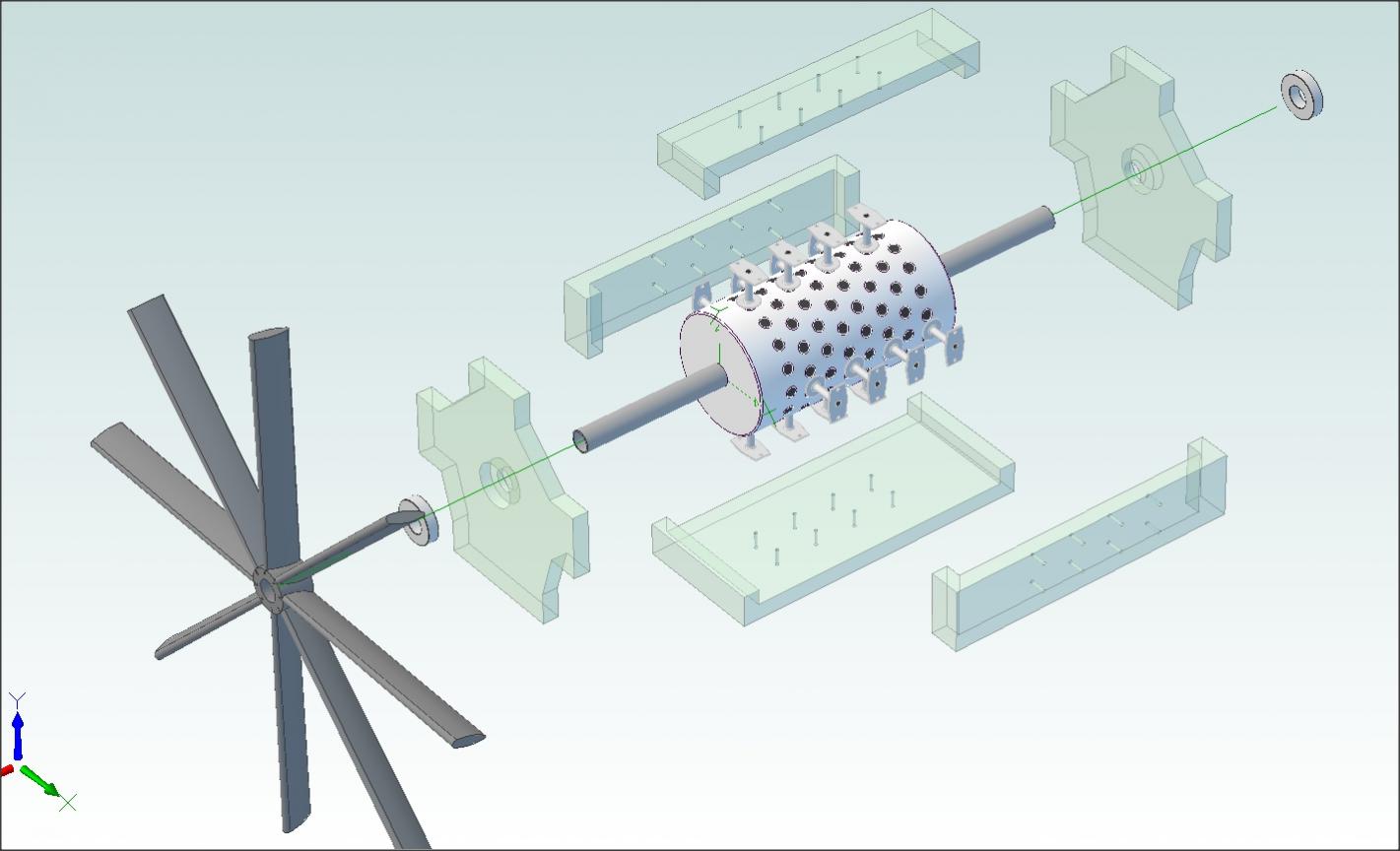

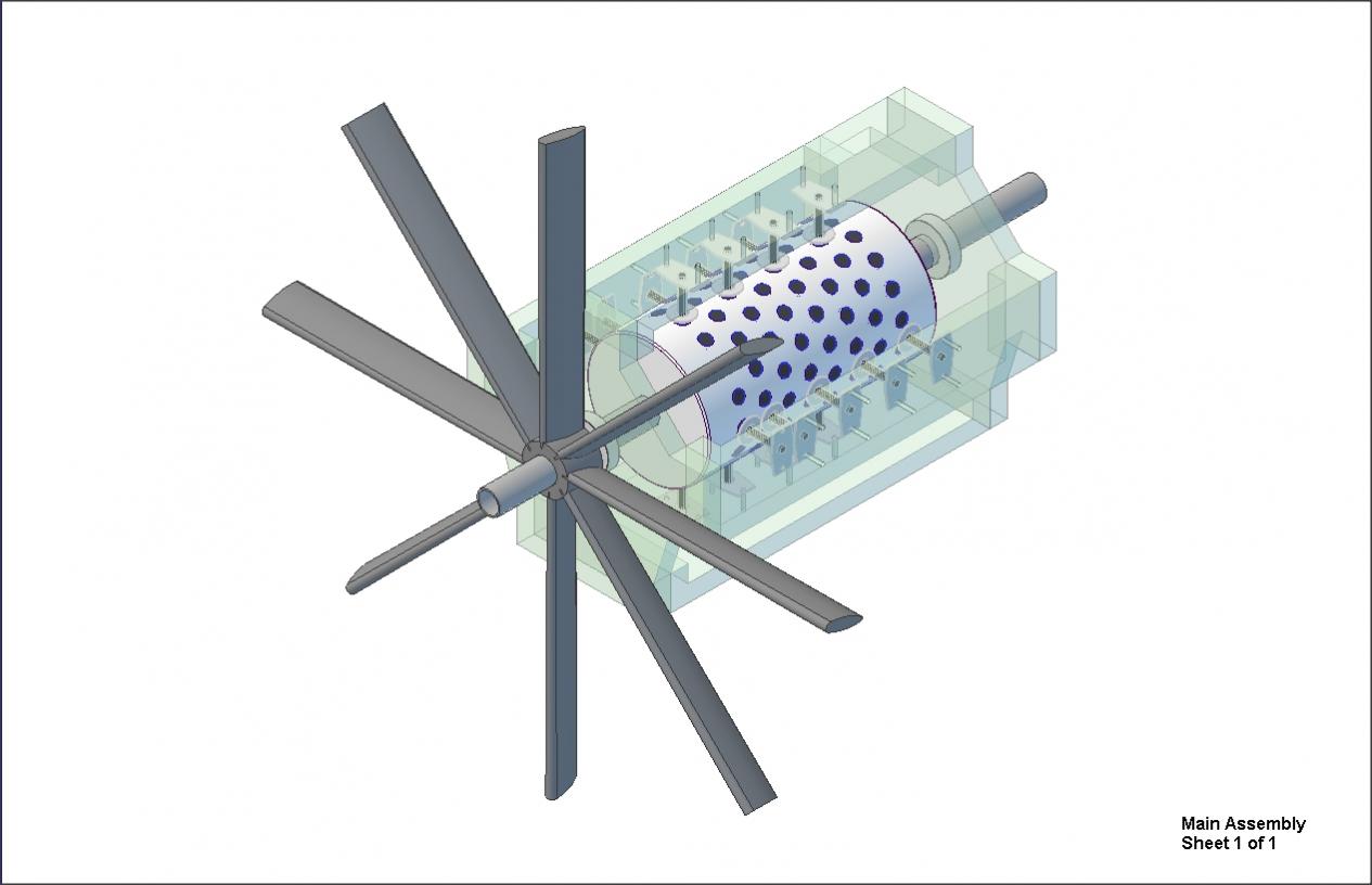

After watching John Bedini's DVD #25, I have designed a multiple "Trigger" coil assembly which will be mounted to a 15-20 foot pole. The "Power" coils, the associated electronics, and batteries will be at ground level. As a newbie, I would appreciate any and all comments as to the viability of this arrangement. The materials are as follows:
I have attached several drawings.
Bill
- The shaft is 316L stainless steel tubing 1.000 inch OD x .065 inch wall
- Low friction ceramic bearings are used.
- The rotor material is closed cell foam. There are 8 rows of magnets with 16 magnets on a 22.5 degree spacing. Alternate rows are offset 11.25 degrees from the previous row. The magnets are .500 inch dia x .188 thick. The entire assembly is covered with a shrink wrap material to retain the magnets.
- Sixteen small spools are used for the trigger coils. The coils are arranged with 4 coils on a 90 degree spacing.
- The end plates and cross braces are 3/4 Plexiglas or 3/4 MDF (Multiple Density Fiberboard)
Bill
