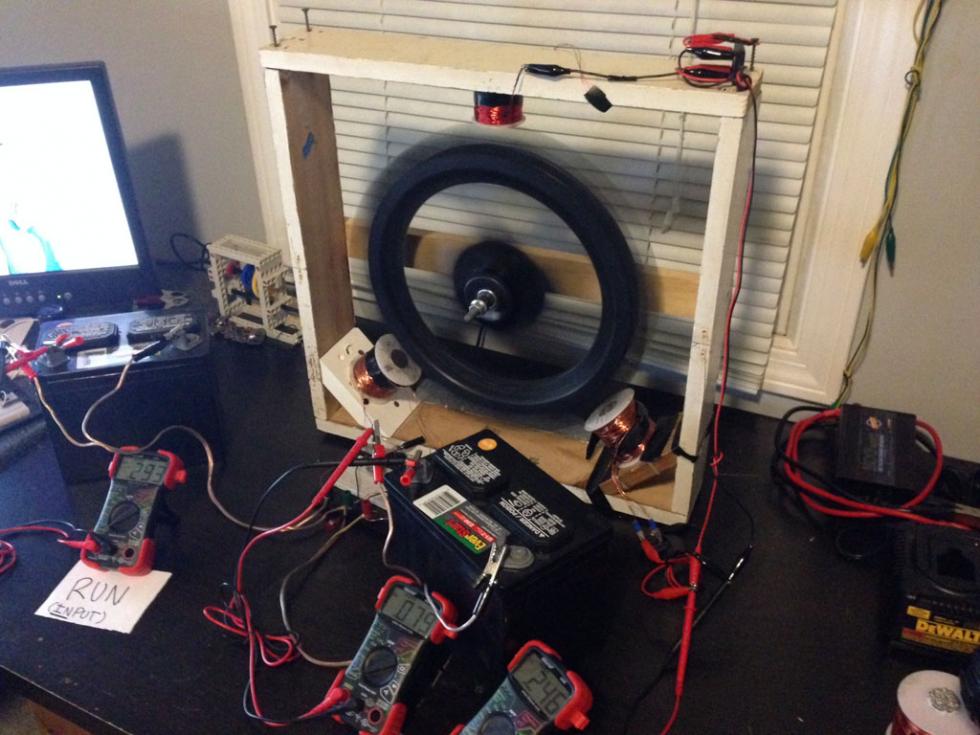

This version of my Bedini motor was built inspired by John's 1984 book and the very simple principal of using a DC motor and the mechanical advantage of a flywheel to spin some magnets near some coils in order to pickup or regain more energy than required to run it. This fit in well with the 3 stacked magnet setup I used on my wheel; the weight must have added up to make my wheel act like a flywheel. The reason I stacked 3 magnets was simply because thats where the gap fell on my coil mount, 3 magnets high.

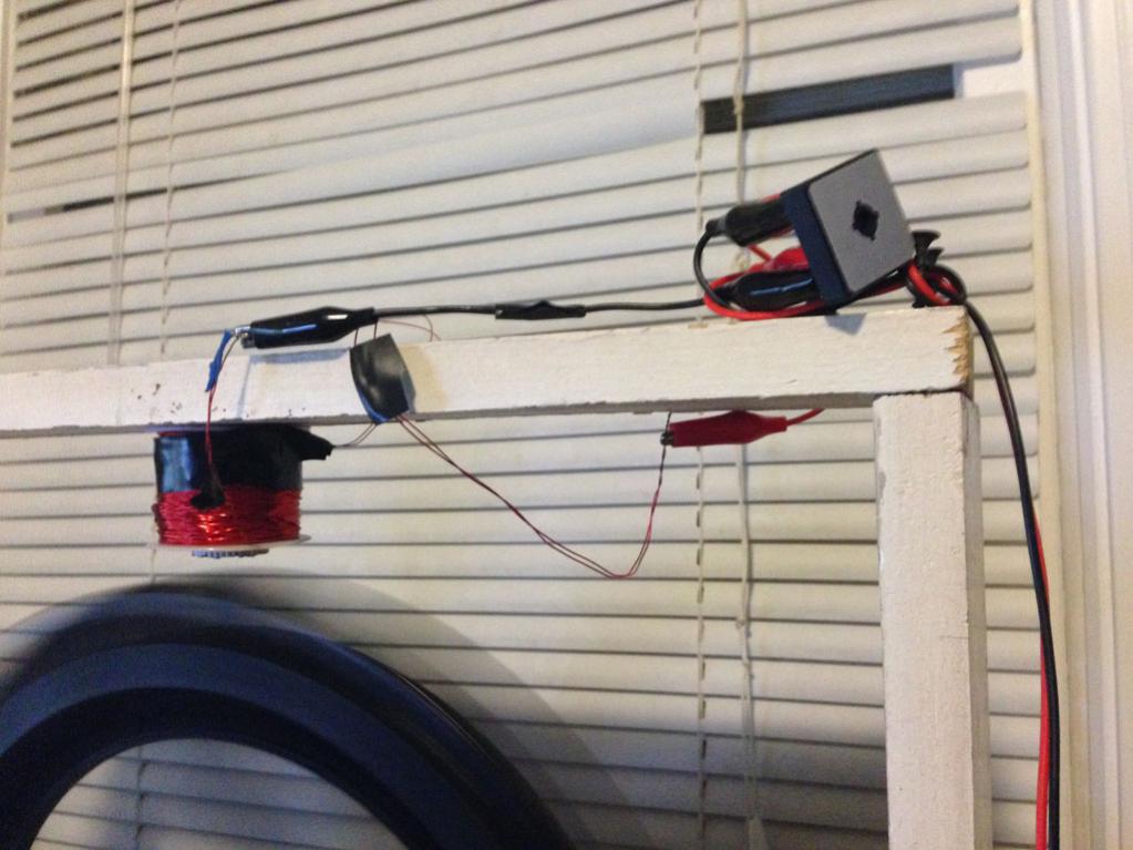

Bedini Circuit:
2n3055 transistor
1n4001 diode
1n4007 diode
470 ohm resistor
X crappy 1k variable resistor didnt do squat - so its bypassed
neon bulb - 90 plus volts
2 - 18 inch lengths of 12awg wire for the battery wires.
3 - jumper wires made from 4-6 inch pieces of 20awg wire

SETUP:

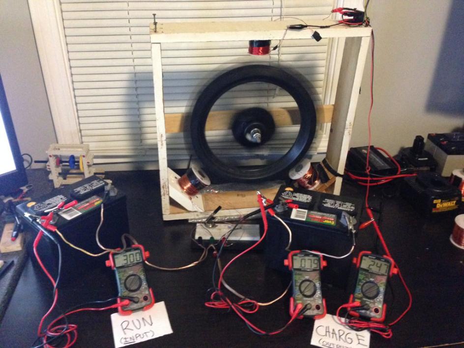

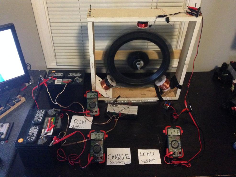

The Bedini motor is a standard 2 battery Bedini motor with NO cap. I am using the 2 - 12 volt batteries to run it, they were bought at the same time, have 1 digit serial # difference, and both measured 12.6 volts when I got them.The circuit is built with the parts listed above, and the smallest guage wire in it is the 24 awg trigger wire.
So the Bedini motor part is a standard Bedini setup, I am using the two 12 volt batteries and it is running right now with this load of the 2 extra coils at 225 RPM with an input amp draw of 304 milliamps, and an output current of 81 milliamps.

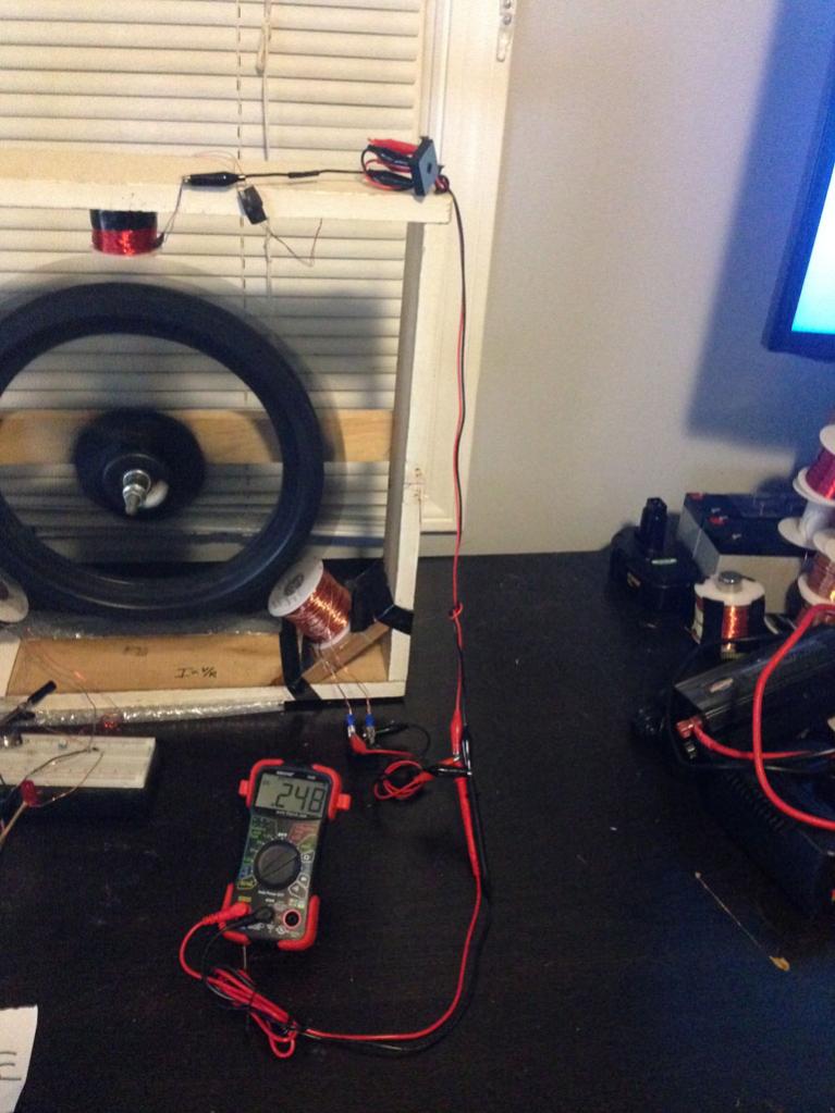

The 2 pickup coils are simply bifilar coils with the ends twisted together so that the 2 wires are connected at each of the ends, and the 2 ends are connected to the AC posts of a bridge rectifier, with the DC posts of the bridge rectifier running to a multimeter.
This is my setup, and I am seeing a higher total output than the input, and thats measured at the source and destination with the meters being connected directly to the batteries for the Bedini setup, and the extra coils are connected to a bridge rectifier, then directly to another multimeter in parallel.
MY CONCLUSION:
I tried calculating the power in wattage and theres no OU.. But strictly at the current level, I am moving more electrons at the output then I am at the intput. I would ask if anyone could suggest ways for me to dump that low potential current into my 12 volt charge battery? I am new to all this lol
