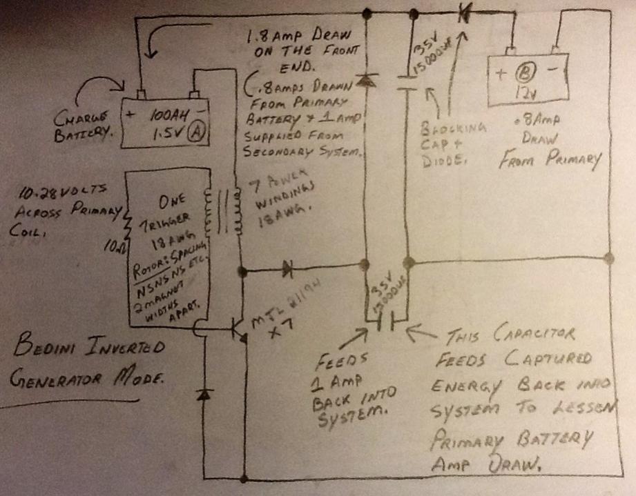

Originally posted by Dave Wing View Post[ATTACH=CONFIG]4201[/ATTACH]Hi All,
Just thought I would share this with everyone here... As I posted it already on http://www.energeticforum.com/renewa...gy-device.html
The SG machine will charge two ways with this configuration... First it captures the energy that is normally wasted from the emitter to the primary negative and secondly it also captures the negative or opposite polarity... energy across the coil. I am not sure if what I am saying is worded correctly in the proper terms... But the machine does charge the secondary battery or batteries and the emitter to ground battery as well at the same time and at good rate. This is what I have been looking for for some time... Thanks again to John Bedini for giving so much.
It is way to early in my research to honestly tell you what we have exactly with this setup... Sorry for this. Here is a picture schematic anyway.
Also you can use the standard SG instead of the brushless motor results should be the same. You can also try just one battery across the coil for a total of four batteries in the circuit. Or one may put another one in parallel with the one between the emitter and the negative of the primary battery.
-Dave Wing
Hi Dave Wing,
You are essentially doing John's 'Inverted Circuit' by doing the SSG in the Emitter Circuit. this is in a way a Tesla Switch , as you have a 24V source Battery, why not put another one in parallel to the Battery in the Emitter circuit... in your last diagram in the post... a total of 6 Batteries now...
Ho sorry Dave I just read it again and see that you have already done this!!!!

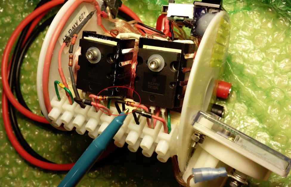

I saw Generator Mode done by John Bedini in his Cap Dump Vid w. Chuck Hupp here: https://www.youtube.com/watch?v=TRLVhKzamUE
I did not realize in Generator Mode, that the Charge Battery must be a higher voltage than the Run Battery, else drains trough coil and Diode as a short until voltages equal. Maybe this is which Patrick touts charging higher back end from lower voltage front end. What i did notice right away is that my SS SSG w. Patrick's CPD Mod sounded suddenly flat in firing sharpness, especially when sticking a magnet into air core to hear the speed of pulses. The range of crisp firing went lousy, firing sounded flat, and i tore apart until i realized that Gen Mode just fires flat and mushy sounding, like a flacid (edit) Vs. SSG Mode. It may charge better, but only if back-end higher voltage. I recall it made Tranis hot when pushing same Amps SSG mode liked. Mine had two, and i found balancing of trigger wiring lengths and splits matters much, per one would run hotter when pushing Amps on purpose.
Anyway, i found that a 1N4006 has a superior sounding crisp firing in Gen Mode, in the Output Diode position only, clamping diode does not care what it is. When i returned to SSG Mode, it does not matter. idk what brand these are. Glass orangish-brown color diodes from a surplus store nearby.
Conversely, the hardest hitting firing i ever heard was removing the CHarge Battery and running output straight back to Run + terminal. Draws about zero Amps, does not charge, but sounds so so right. Try it and consider the four modes Hob Nilre shows in the video i linked above. Enjoy ! :-)

Hi Brodie,Originally posted by Brodie Gwilliam View Post[ATTACH=CONFIG]4200[/ATTACH] looks awesome.... in the picture is what ive been doing for a while(sometimes with diode added from primary positive so all the charge goes to secondary), it really helps smaller sg's charge bigger batteries... i might have to test this new one out
This is equivalent of the one that is shown by Dave, In fact what you have shown is the way how the JB patent 6,545,444 in the Inductive mode. (not the Cap Pulser mode), would work!
we were not educated on the 24V operation Pre-requisite in this topology.Thank you,
Faraday88

Brodie Gwilliam I have also experimented with the same circuit great minds think alikeOriginally posted by Brodie Gwilliam View Post[ATTACH=CONFIG]4200[/ATTACH] looks awesome.... in the picture is what ive been doing for a while(sometimes with diode added from primary positive so all the charge goes to secondary), it really helps smaller sg's charge bigger batteries... i might have to test this new one out
The charging battery charges very fast with this circuit. This circuit is also the same as a portion of the Tri-Symetrical switch I have been experimenting with.
I wonder if adding cap dumping to this circuit would make it work better or worse. The cap dumping may be mixing the positive energy with the negative energy, in this circuit. So good that I am not the only one who has tried this circuit out.
Brodie,
Putting the inverted charge battery before the low resistance load (instead of after the emitter which is on negative side) seems to work better. Thanks
Here is what I am doing now... The primary amp draw is decreased from 1.8Amps to .8Amps doing this plus you get to charge the inverted battery with a full 1.8Amps. Even if we did not account for the readily available energy from the inverted charge battery it should be much easier to make up the .8Amp short fall via a low drag generator. I have some ideas... But will share them after I try it for myself.
-Dave Wing
