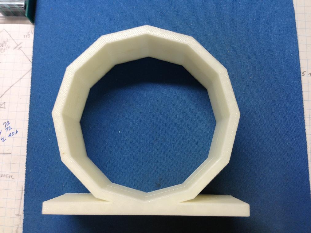

          3D printed Stator
          Just finished printed stator and base about 4 inches in diameter.
          John B

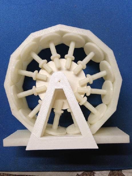

                  At All,
                  I’m looking forward to doing this as it is something new and it has taken me about 2 days to learn the cad program I suggest that you all get involved in learning how to 3D model a simple program is the 123D cad by Autodesk, just go and down load it for free. We all can help with some of the tricks to the program. I started with a DaVinci 1.0 Printer, I have had no problems as others have had because I do not try to Jailbreak it and I just follow directions, I do not try and re-invent it. The only thing about it is do not use the auto calibrate and I just use a piece of paper to align the printing bed. It makes no difference if you must buy cartridge for it’s just like buying gasoline for your car without it you don’t drive. I also have a Robo which I have not set-up yet. I now have 100 hrs. on the printer and for the price you cannot beat the printer. If the printers work that good then I will get a much better one. Tom C got me into 3D printing so it’s his fault. The Monopole project can be very exciting if you can just print it out.
                  Neo magnets must be used because the coils must be iron-less and the coils are conical in shape because of the spacing if we go bigger the coils can be normal looking like a bobbin. The other thing is most are just winding with a drill, you must know how many turns and what the resistance is on each coil, this is not a guessing game with coils, we want to keep the current as low as possible. This is like building a fine watch. The crystal cell is going to be printed cylinder and I have some ideas on that but we are going to change the mixture. I’m also looking into what metals can be printed with the ABS. So I have downloaded the Ez- Spin just to see what happened with the parts fitting, they did not and everything had to be re- scaled and in most cases the files had been corrupted by others that thought they could do a better job at re-inventing and they admitted that they changed the files. So here is a picture of the Energizer after it was put back together correct.
                  John B
ID:	47086Click image for larger version

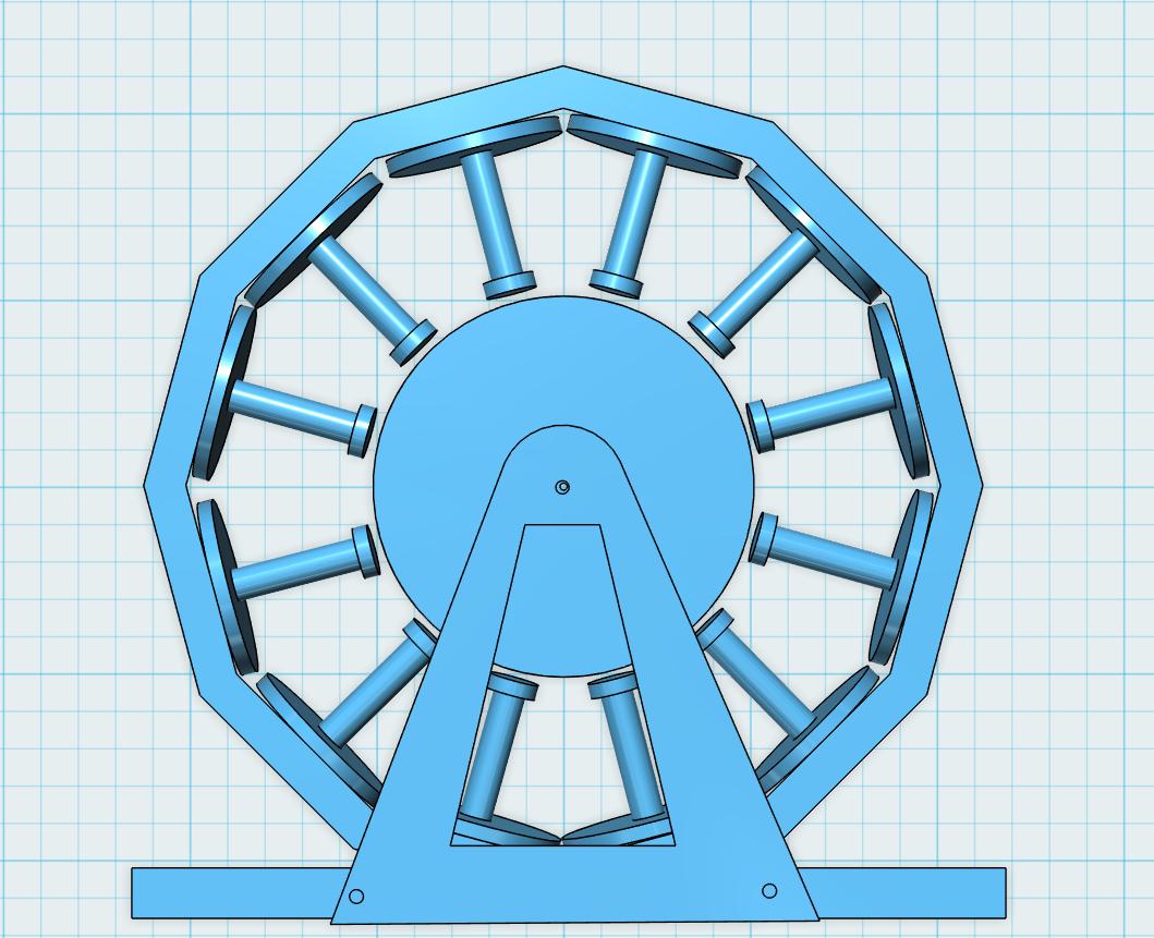

                    Hi All
                    This is my 3D Window motor model:
                    I have been using Free Cad, and Blender for 3D modeling, have tried 123D Cad too, but liked Free Cad better, but they all work, and have some things they do better than the others... And they are all FREE...!!!
                      RS.

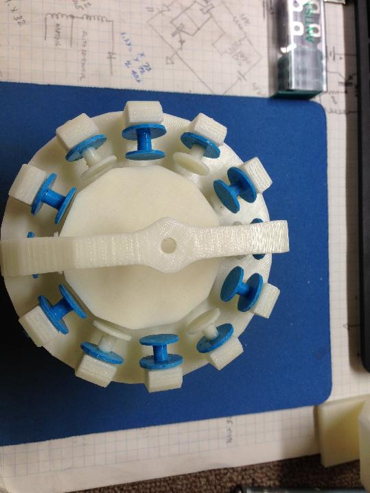

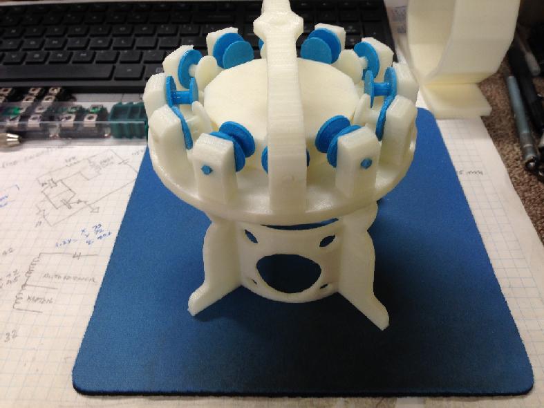

                        Printed parts 12 pole monopole
                        I have most everything except for the new split rotor. The reason I decided to split the rotor is so the magnets can be scaled on the rotor. Here is a picture of what I have so far.
                        John B
