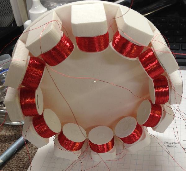

              The Coils And Picture
              Just getting my coils wound with the bobbins I have printed of which I have given you all, the size in MM. It looks like 2001 turns number 32 wire, resistances is 826.77 ohms for each coil for a total of 12 coils in series gives me about 9921.24 Ohms or close to 10K ohms for the total it works out to be about .15 micro amps I would suspect the voltage will much lower using the Crystal cells then a 1.5 volt battery. Each coil has the exact number of turns since my coil winding machine is counting to the exact turn. I’m making sure you have the numbers if you’re going to build this machine. This could change a little depending on the length of wire hooking them up. I’m testing a super cap of 4 farads at 5.5 volts to see how long it will power the device in hours, so far 3 hrs. Has not dropped .5 volts across the 10k resistor this will change also with it being pulsed, much extended run time. Will give the figures in how much your fingers can generate holding the electrodes. Back to winding coils, I’m using a LCR bridge to measure all of this. I will go back and measure the coils again when they are all hooked up in series and give all the figures. Here is a picture of the mounted coils. Update....... 12 Hrs 3.13 volts going down to .7 volts
              John

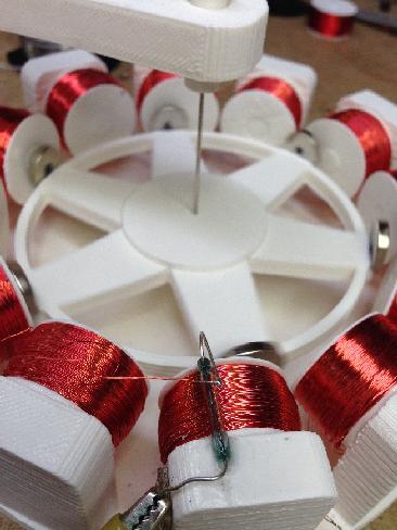

                    To All,
                    I have completed the first Motor /Energizer. Now I will give some figures, yes it does run on a capacitor and does charge it. However the coils in the arrangement they are in make it very difficult to align the reed switch for the proper sweet spot. I arranged the coils for the tightest arrangement, so the reed must be mounted above the coil to the left side and not in the center between the coils. For some numbers, Coil resistance totals 8.688 K ohms, 360 MH. 2001 turns of wire on each coil # 32 Magnet wire. I did find some problems with mounting things and so I did go into the drawings and change some things. But for first print it was successful and seems to work real well. The other thing is that it does prove that monopole generators work as to how much it returns to the source is another question. The return power is much lower because the current meter is not showing a current in the opposite direction as if it is recharging anything, I have not hooked a diode up yet. Normally with the Monopole if in attraction you could use a linear regulator and supply the second battery with an exact amount of current, or use the pulse charger. This machine is going to work much different as far as recharge goes. I’m not even sure that what they are claiming on You-Tube that it is in push pull, it’s almost like it is caught in a balance condition between north and south poles. You can only see these things when the coil spacing is tight. Now the other thing is it can only be attraction with the reed in the center as the magnet has already passed the 0 balance point of the coils, so in other words it turns on in attraction and the north coil does nothing to help to make a push pull motor, the rotor would have north and south poles on the rotor and use something like the Bedini/ Cole switch. But this can be arranged to do that with two reeds 180 out from each other. If you were going to go through all this trouble to arrange the coils in series filliped on each coil just add the correct amount of magnets for each pole and make a pancake monopole in attraction / or repulsion either way it would work excellent at very low current. Anyway bigger coils as a 4 or 6 poles would make the correct pancake monopole with output to charge batteries.
                    Oh I forgot to say that it ran all night on a super cap it was charged at 5 volts and reading taken at about 10 in the morning the voltage on the cap was about 3.4 volts when I stopped it to solder things together.
                    John

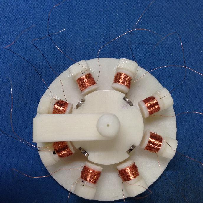

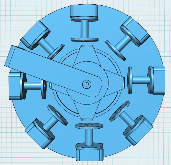

                              At All,
                              Yes I know what you mean the ez spin can be a real pain in the butt. But remember it is a monopole with series coils. The 123 D Cad program can be a real pain also when it starts to slow down, main causes, Swap file, and anti-virus. Anyway try to run it in attraction by placing the reed a little more off the neutral point between the coils it will make a big difference. You can also run it off an earth battery; I have watched it do some strange things running that way when ground currents change. The 8 Pole I’m going to run in attraction very efficient that way as I said if you study the way the ez spin runs you will see it running past the neutral point of the magnetic field it’s almost a zero force motor but the coils would be oriented in a different direction I will try to post a drawing of the fields so you can see what I mean. I have studied this type of motor since the beginning of my research on the Stubblefield motor. His motor was the first pulse motor running on Earth currents and not from the coil itself. Here is a drawing of the 8 pole I will set the reed so it runs past the neutral point in attraction.
                              John
Name:	8 Pole Monopole.jpg

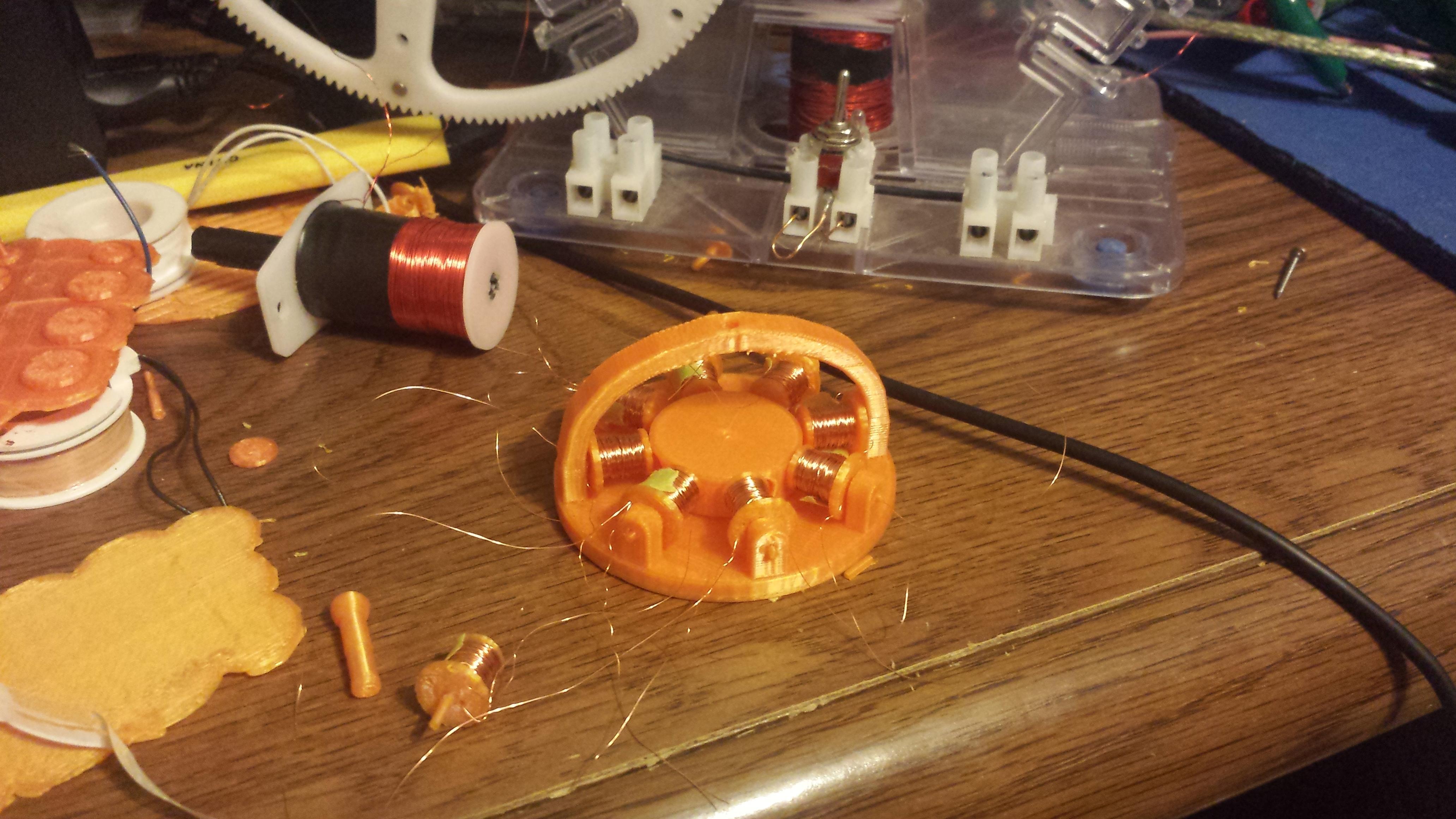

                                The small one
                                The small one,
                                This is by far the smallest one I have done yet. This was a real pain to do since I had to hold the coils to wind them. I also had to file the rotor and some parts. Think I’m going to re-draw rotor with slots to slip in magnets as they are about 5 mm X 1.5mm. Coils 650 turns #40 wires the printer seems be able to print this just fine. The energizer is about 64 mm in diameter. Will post when it is running.
                                John
