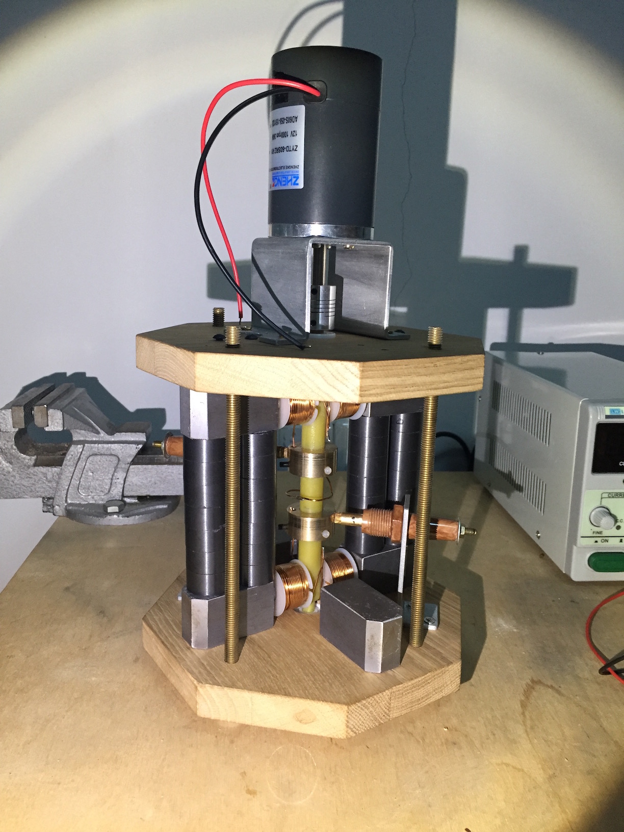

After careful build of a Bedini-Style-Kromrey-Converter (see photo) it does not output a single volt when running (over 800 rpm).
Wonder whether anybody can help with hints to debug. Don't need a good performance machine, just one that works a bit to study it.
Device Info:
Thanks in advance
Steven
Device Info:
- Barium ferrite Magnets
- non-conductive shaft
- N-S arrangement through coil
- upper 2 coils in series and have same winding direction. Lower 2 coils in series and have opposite winding direction than upper one.
- around 400 turns for all coils , 0.8 Ohms for all coils in series
- rectifier used
Thanks in advance
Steven
