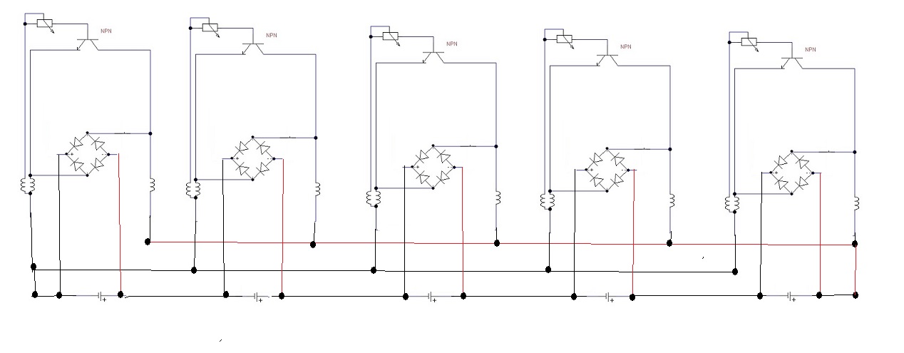

Hi Notsure,Originally posted by Notsure View Post[ATTACH=CONFIG]5398[/ATTACH] Technically it's 20 coils. My goofy conical coils.
Thanks for that picture you posted...you seem to be using one of the Monopole configuration..why not put the other two..? you shall see the differences
the combined out put of these coils are additive and will charge a battery a lot better and faster..the challenge is: figure out the other two geometries of the coils!!
There are 3 poles on the coil. Just facing a single pole of a magnet towards a coil doesn't mean only that pole is the only one involved. The magnetic potential, and the electric potential work the same way. Takes two for there to be motion, one high, one low. I can have attraction on the ends and repulsion in the middle or attraction in the middle and repulsion on the ends. It doesn't just push the magnet away or pull it in, it's more angular I guess you could say. It's only confusing if you haven't tried it. Unbalance costs, but balance is free.

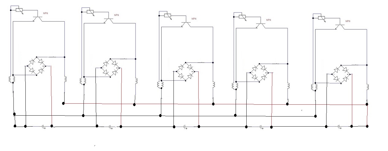

Hi Notsure,Originally posted by Notsure View Post[ATTACH=CONFIG]5409[/ATTACH] oops!
Was just wondering, what has this schematic to do with your Two Capacitor paradox??, however the schematic is interesting.. try Swapping the places of the Collector and Emmitter Coils position...makes more sense...
and then it is Monopole triggered and not free running i guess..!
