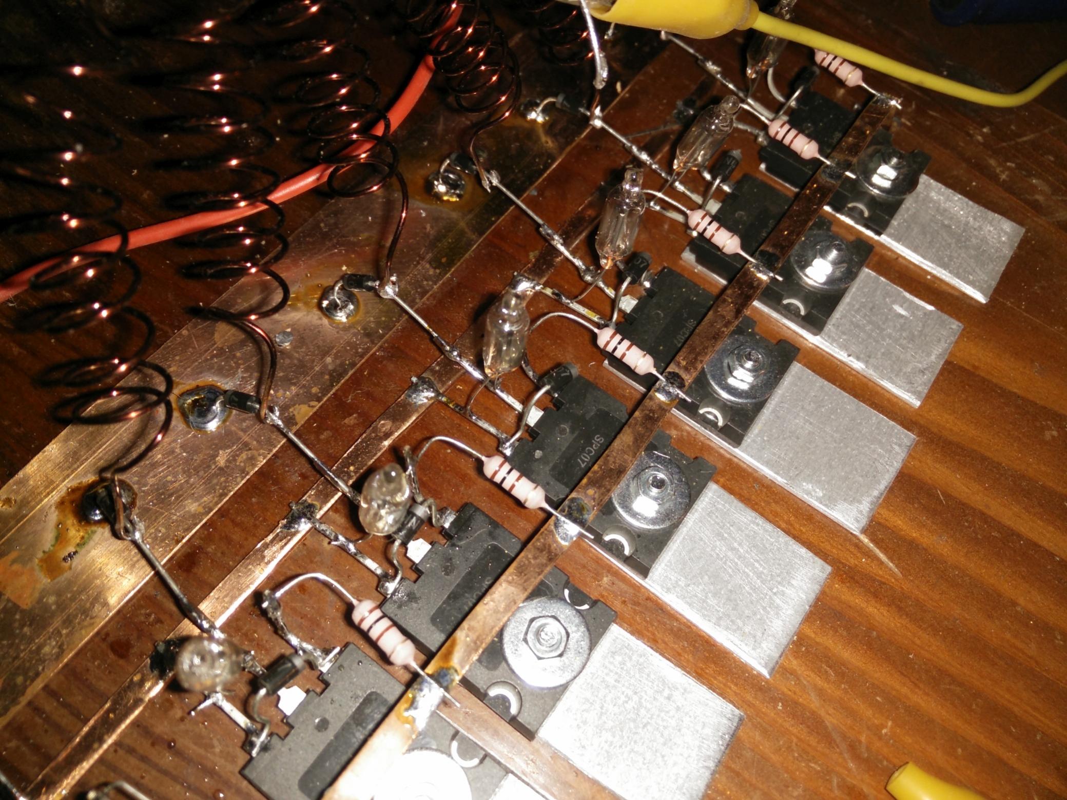

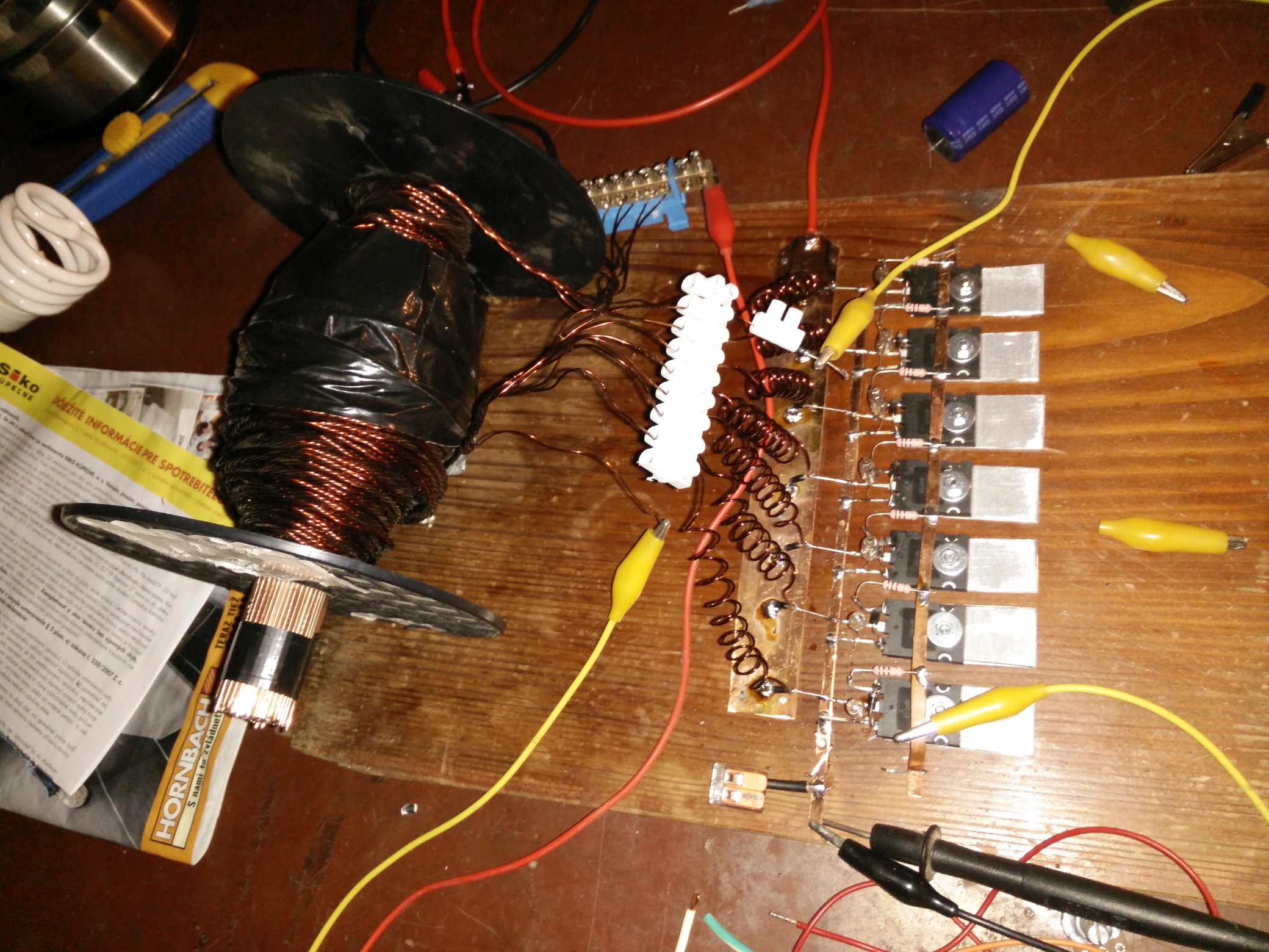

so this is my SolidState SG
wire lenght is the recommended lenght of the wheel version
AWG ?!
7x MJL21994
100ohm resistor on the base of each MJL
1N4007 diodes
converted to CPD (cap+pot+diode)

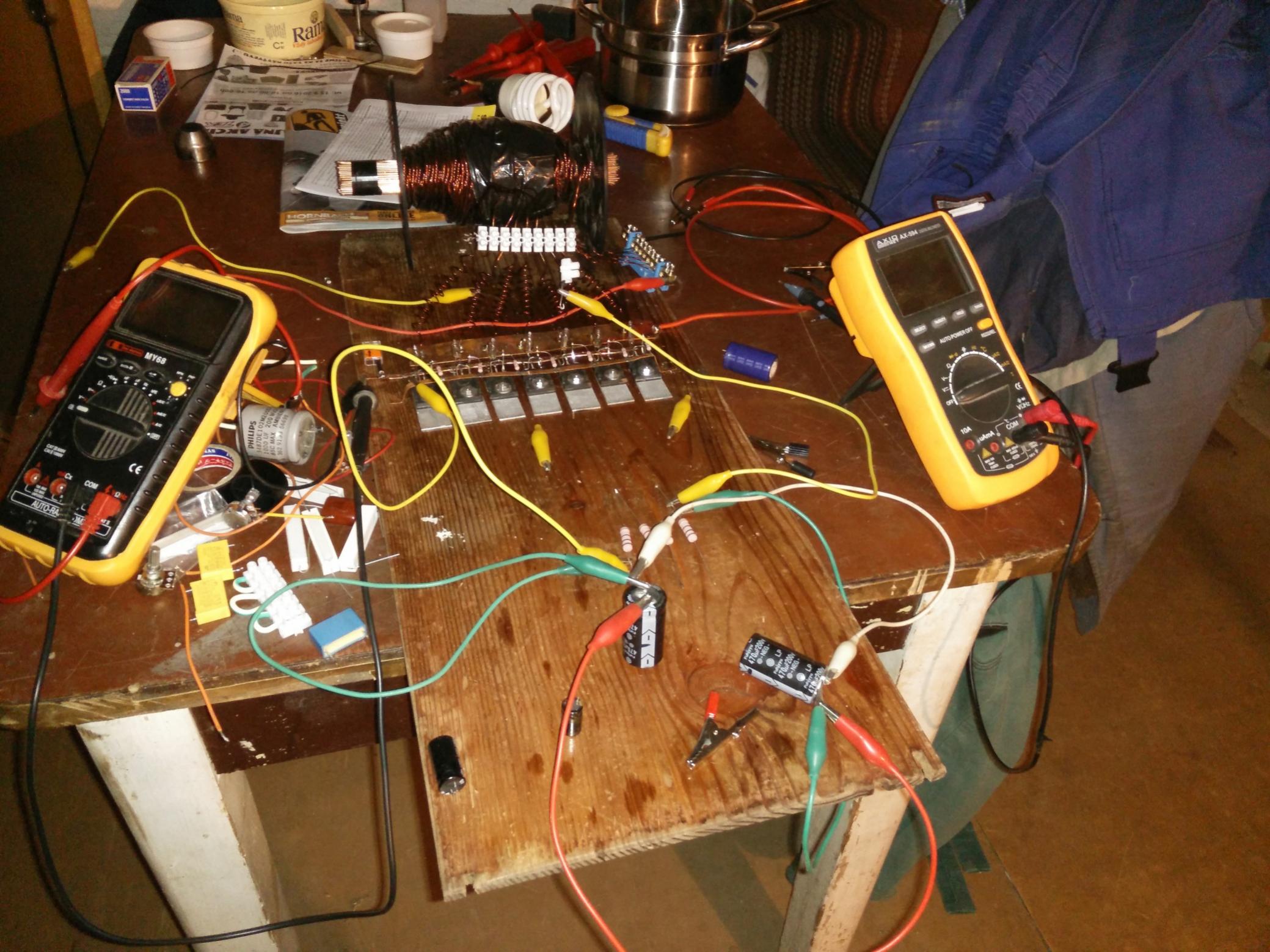

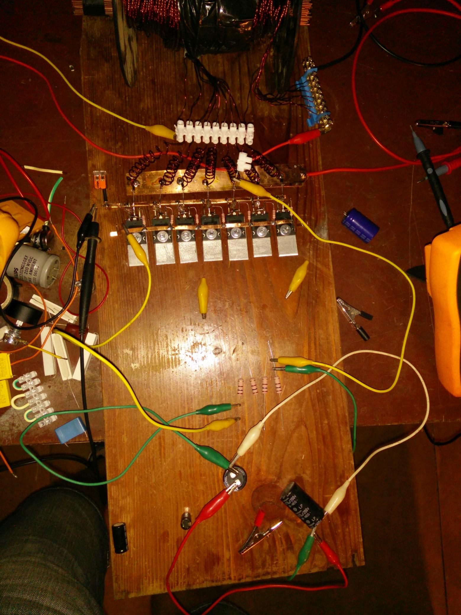

In my case I changed the potentiometer to fixed resistors in series because I was running tests with higher uF caps which were killing my small pots.

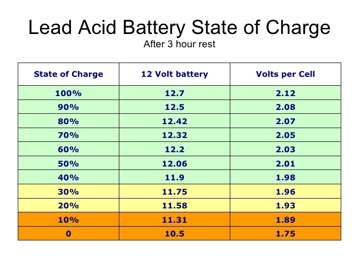

I used two 12V 7Ah batteries. Both batteries capacity was measured with CBA IV. Input battery was fully charged with RC1-AU and the output was dischgarged to 10.50V with CBA IV. I ran the test for 3 hours or the input V dropped to 12.06V (50%). Then I discharged the output with CBA to measure how much charged. I measured the input mA with digital multimeter , there might be slight deviation when the DMM was and was not in the circuit.

If I pulled the iron core out it stopped working correctly. I was listening to the pops on the standard battery operated AM radio.
