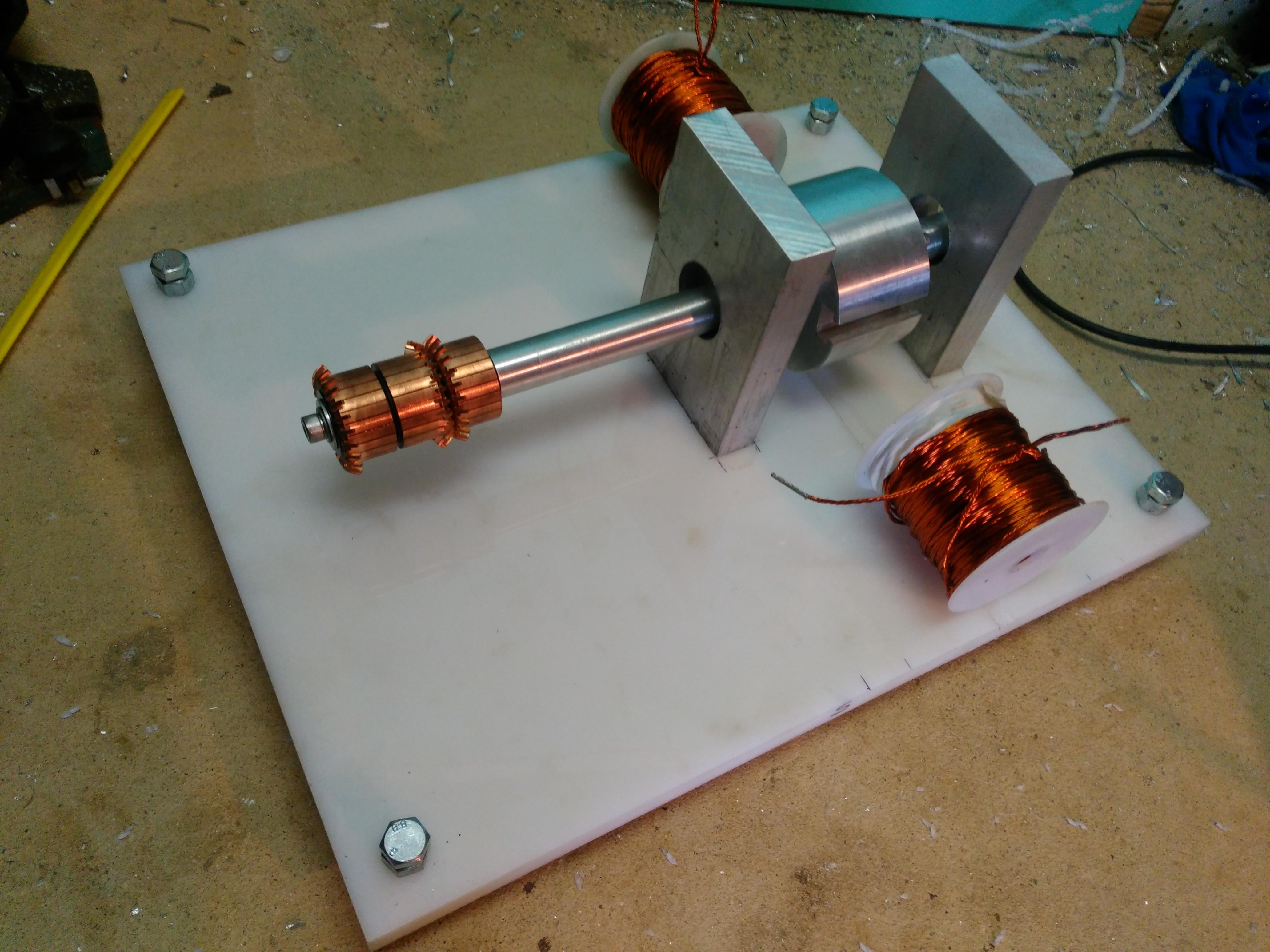

I just re-read a good chunk of FEG, this is exciting!Originally posted by Deuis View PostI'm building it according to Bedini's old mechanical commutator drawings.
While there are 24 segments on the commutator several of these will be soldered together to allow for maximum attraction time.
More or less can be soldered to allow for tuning.
The commutators themselves are held in place by an end nut which is variable too.
The brushes will be mounted to 6mm PVC in a geared mount for tuning while running.
"There is another type of controller I must make known, and it is the simplest of all. With three brushes and a commutator, you can do away with all the electronics and handle 100 times the power back to the battery. The simplest method would be a split commutator, of which a little less than 180 degrees would be copper. (see figure 12 Free Energy Generation.)"
Allowing for two magnets in the commutator I will use a maximum of 12 segments per magnet.

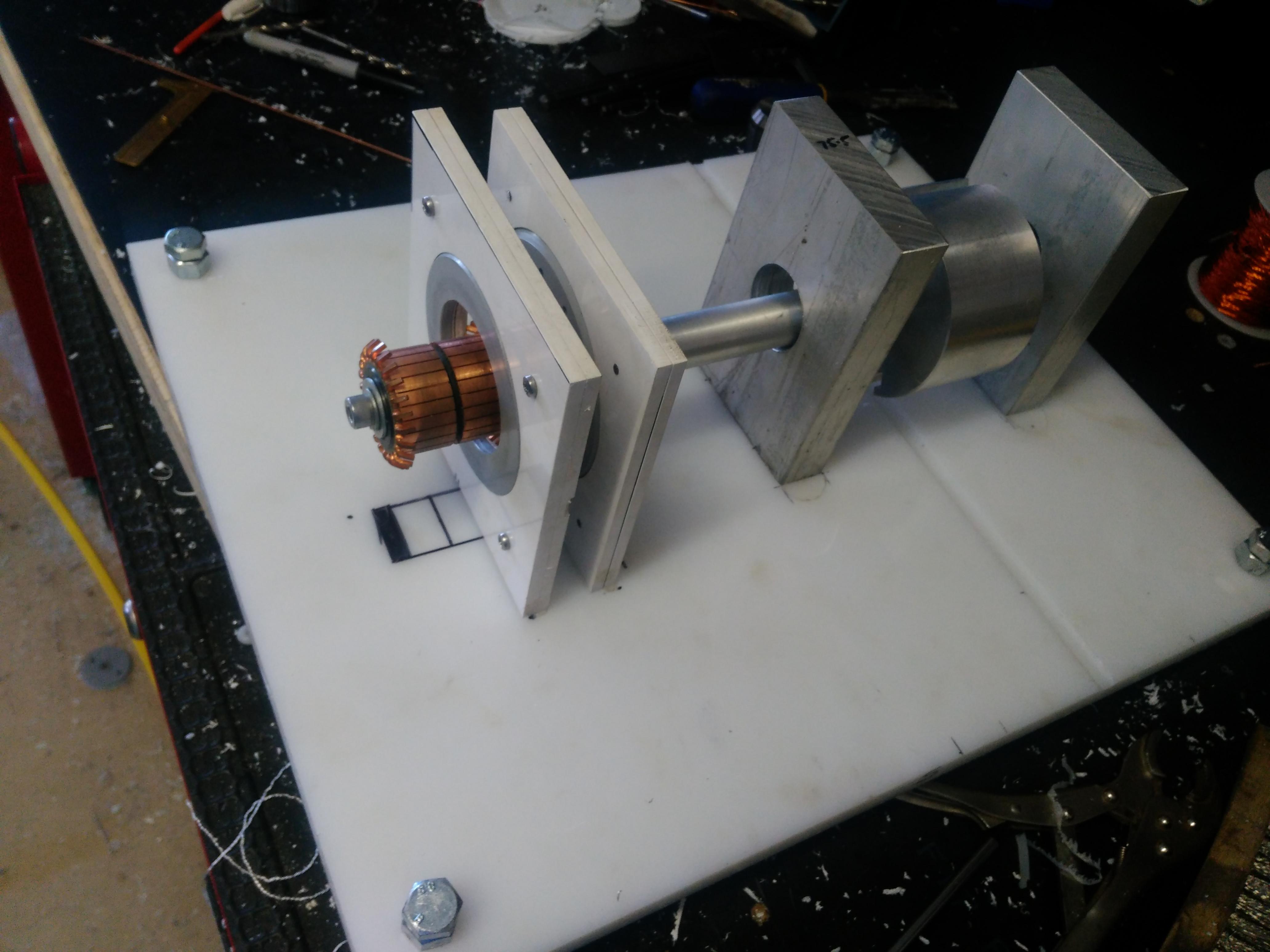

Bearing blocks milled into the 20mm polyethylene.
Center line milled for coil placements.
Commutators fitted ready for brush mounts.
Corner screw jacks fitted for vibration control.

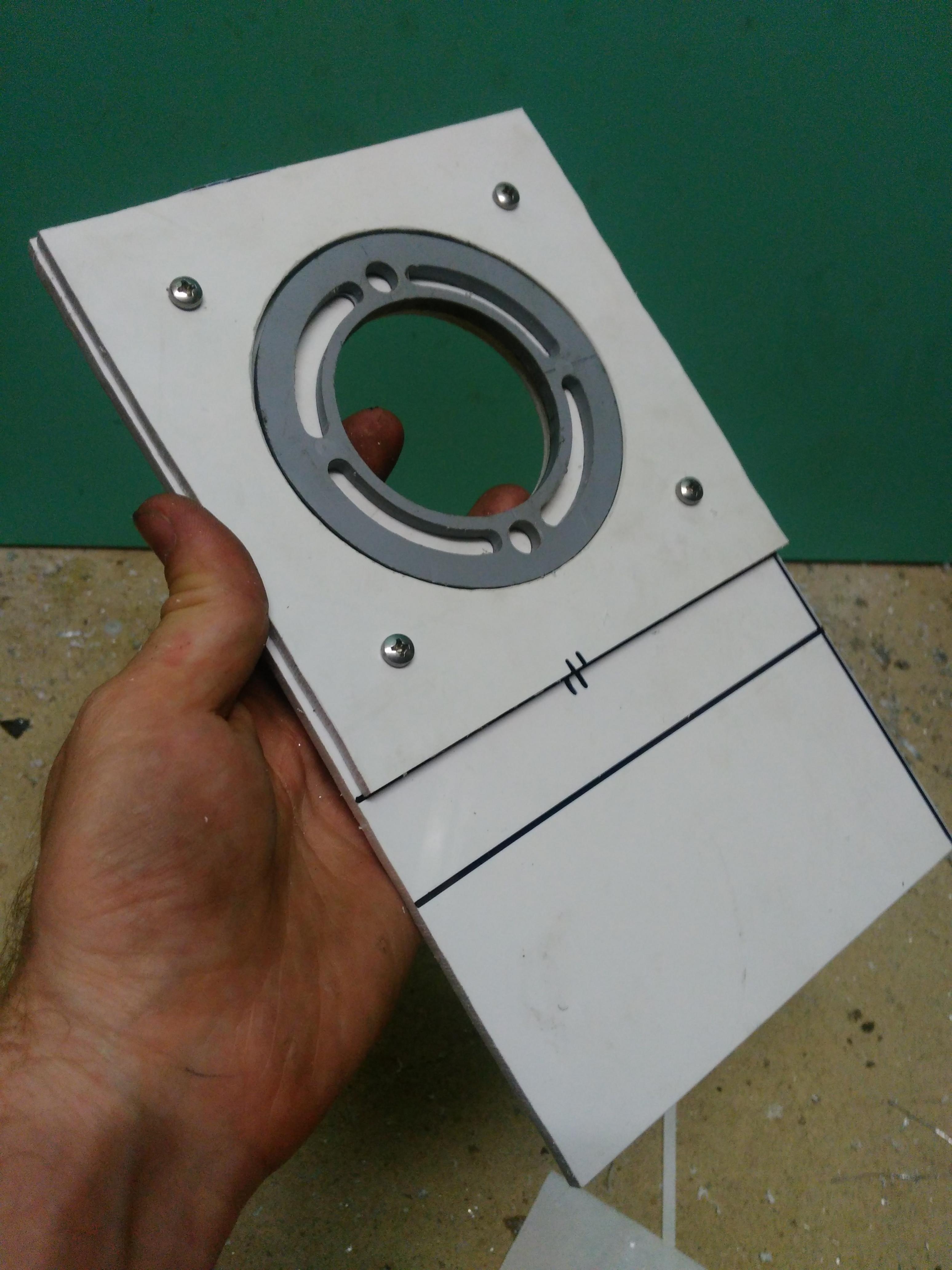

These are the adjustable brush cards.
Two layers of PVC are bolted together, one ring larger than the other.
The inside of the larger ring is cut at 45 degrees.
The inner circle is also cut at 45 degrees and will sit inside the larger circle like a bearing.
The cards themselves will sit in slots milled out to suit in the 20mm polyethylene base.
The commutator sits inside the smaller circle and the brushes will be mounted to the inner ring.
(The 45 chamfers have not been completed and the inner ring is yet to be finished.)

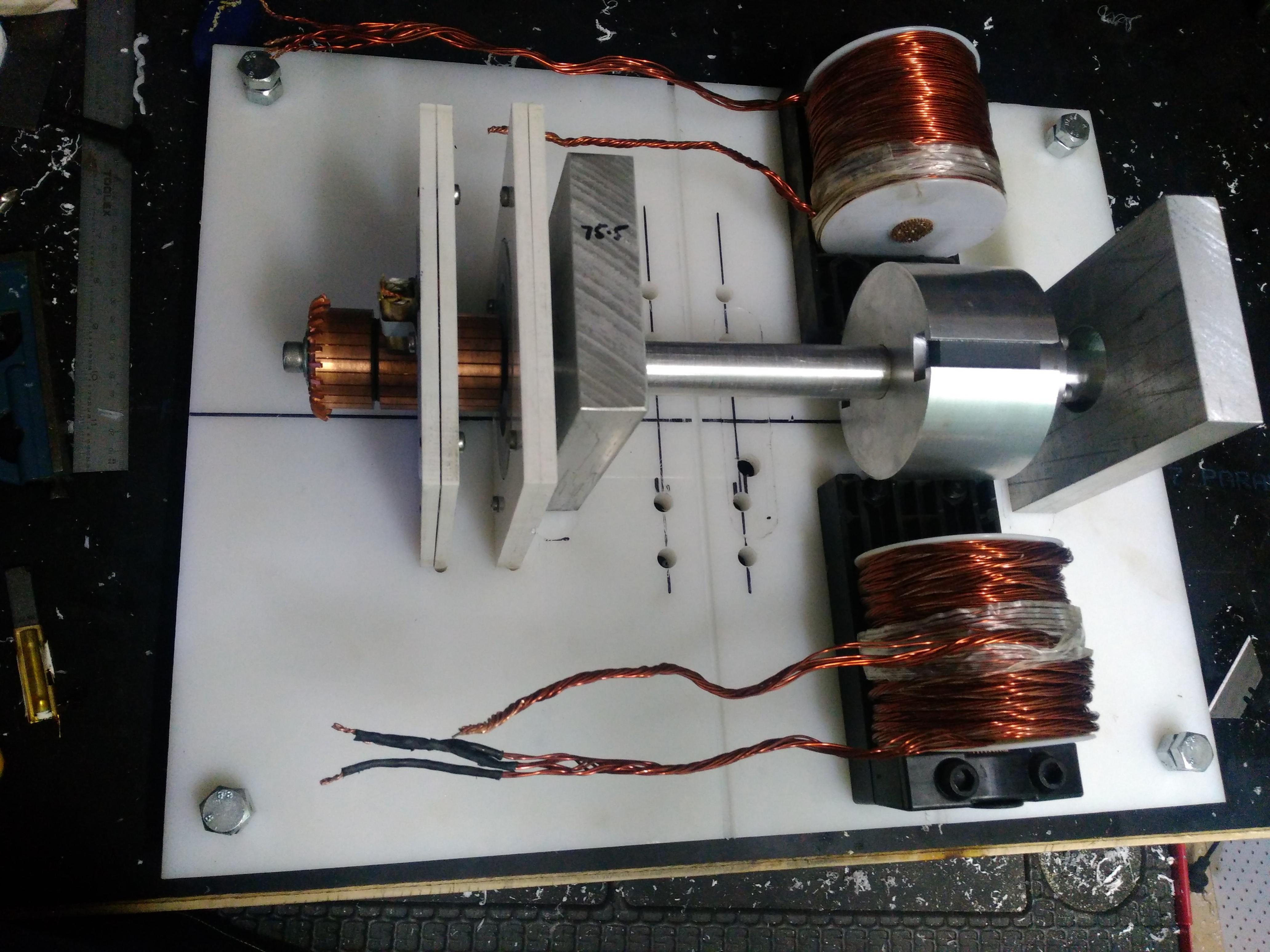

One completed brush manifold.
Slots have not been milled into the polyethylene yet (card is upside down for demonstration purposes).

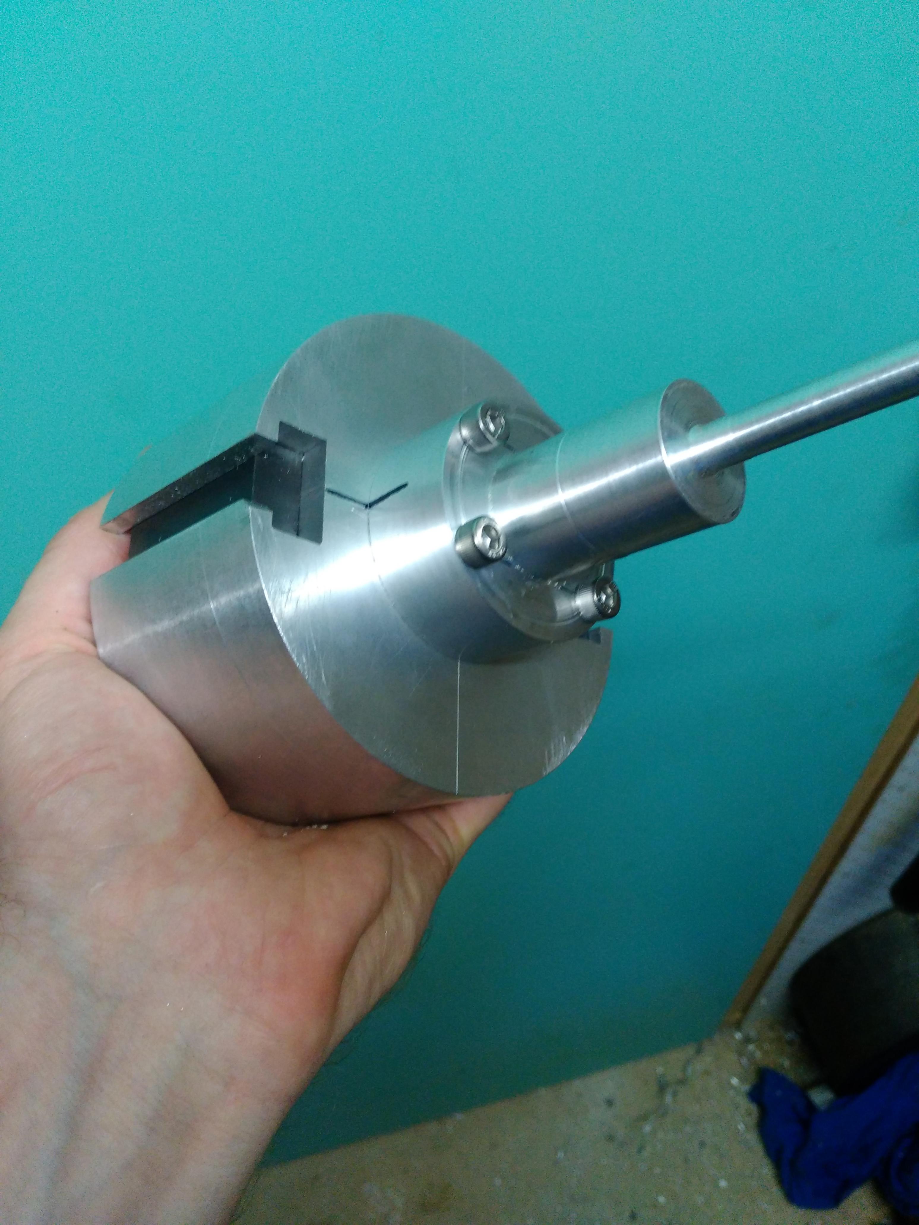

As a side note I have just bought some 150mm X 25mm X 25mm ceramics which I intend on mounting to a second rotor.
This allows me to put two coils side by side and pulse from one magnet.
I'm wondering if anyone has tried this and any theories that may accompany it?

I'm not sure my comment here will be relevant but I will shoot my mouth off anyway ;-)Originally posted by Deuis View PostI'm commenting on your comment of Patrick's comments....
I have a similar setup on my little machine in that it has a front and back rotor with magnets on each. Often times I align them exactly even so you could think of it sort of like an imaginary single magnet lining up with two coils.
Early on with the machine I only put coils around the front rotor, six all around it. Later on I tried putting three around the front and three around the back which is what i was just describing so like having two coils pushing at the same time on both magnets (on rotors), kind of like two coils on one big magnet. Anyway I found using both front and back rotor was a bit more torque than only one rotor. WHat I am saying is I had six coils in either setup but when they were distributed throughout the front and back rotor it was better over all. Hopefully that makes sense. It would effectivly be similar to what I think your describing with one magnet to two coils.
Now something more specific to consider with your one magnet two coil arrangement. Often times there is a stronger pole slightly off center from the center of the magnet. In other words on a normal wheel setup we often times do not line up the magnets dead center across the coil because it wants to push off a bit to the side. If you were to loosen the shaft bearings keeper and spin it you will notice the whole shaft wil want to slide over from center of the magnet because teh pole is stronger there. SO all I'm saying is watch out for a possible bucking effect of the pole on that single magnet becasue they have a strong spot and it is not usually center.
