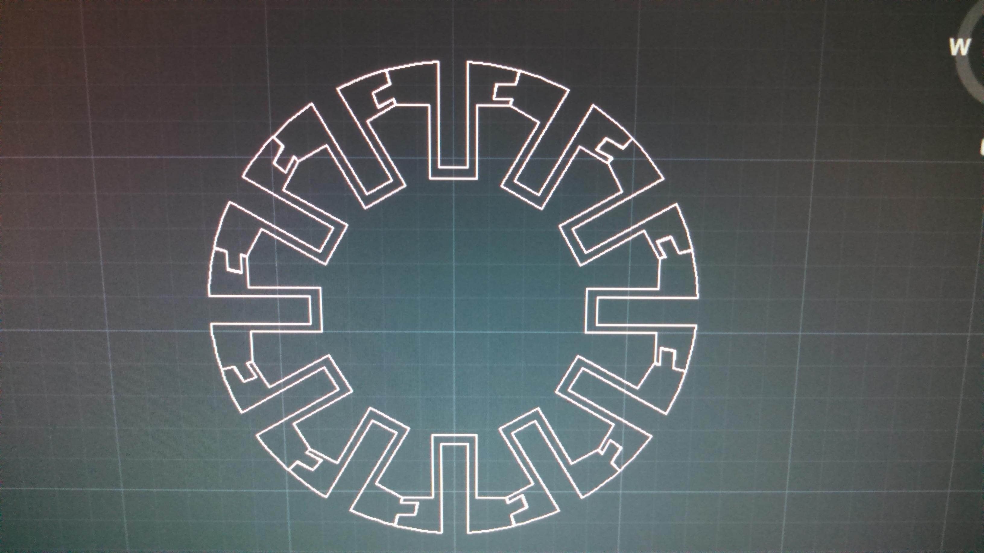

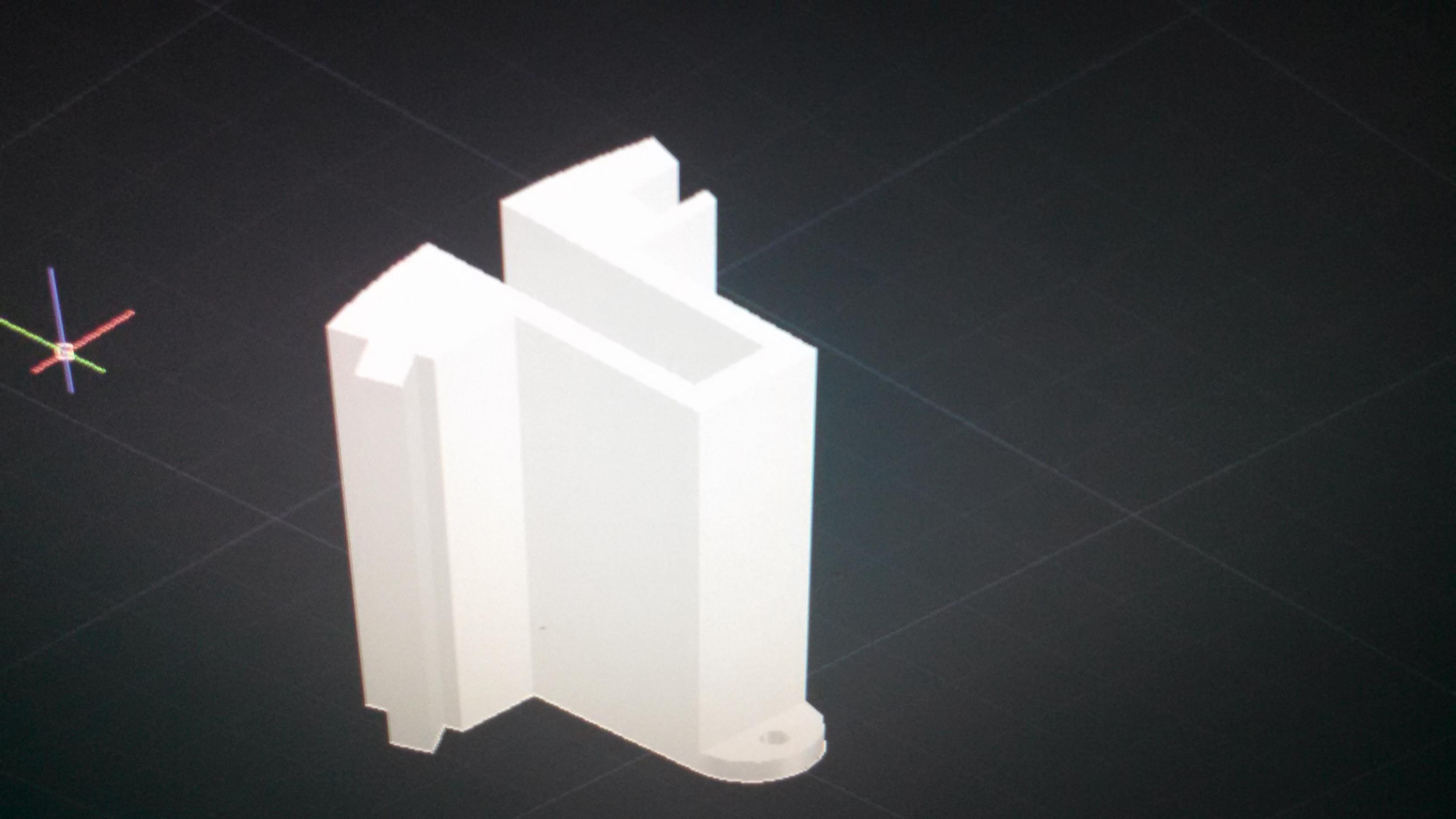

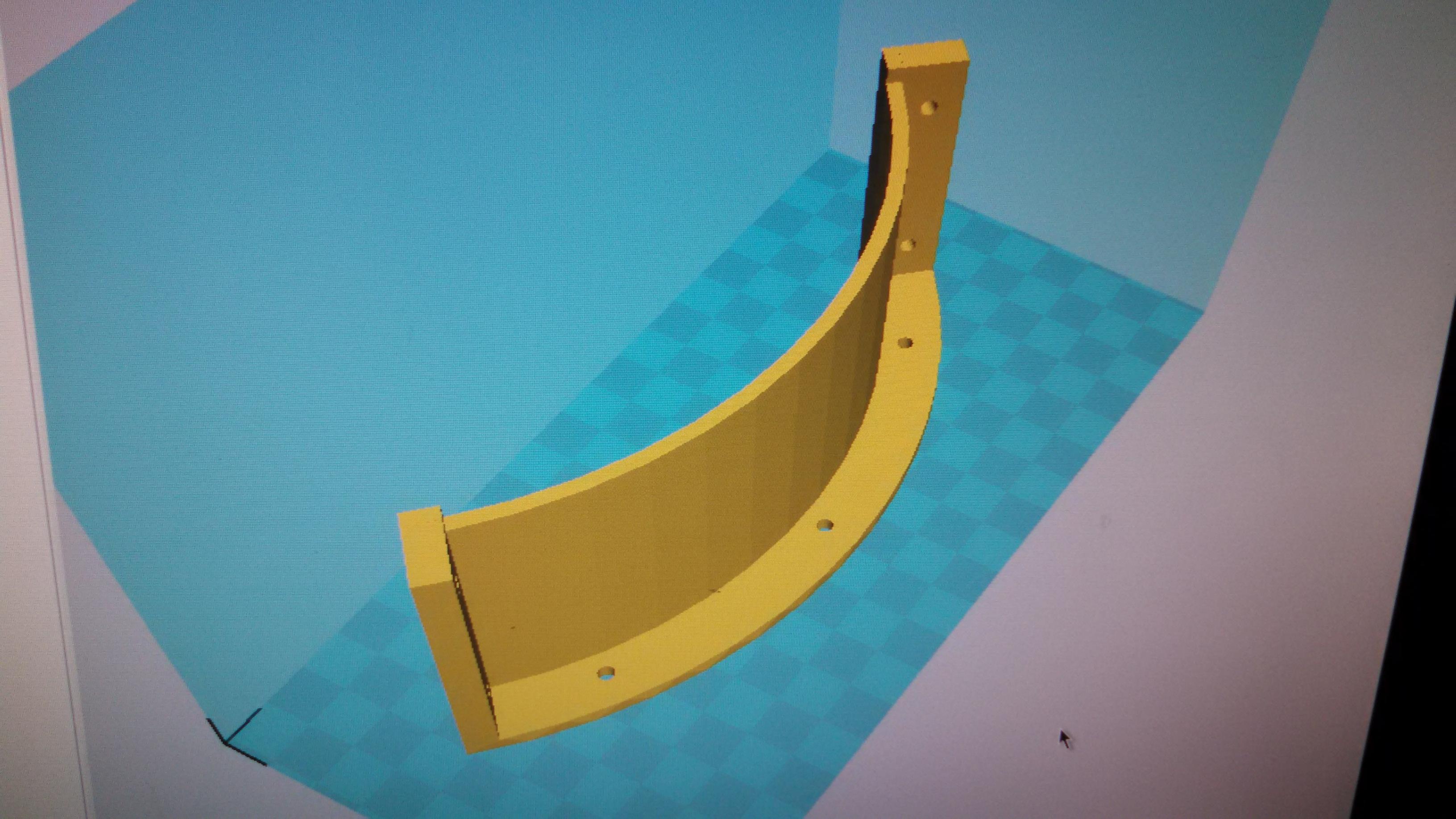

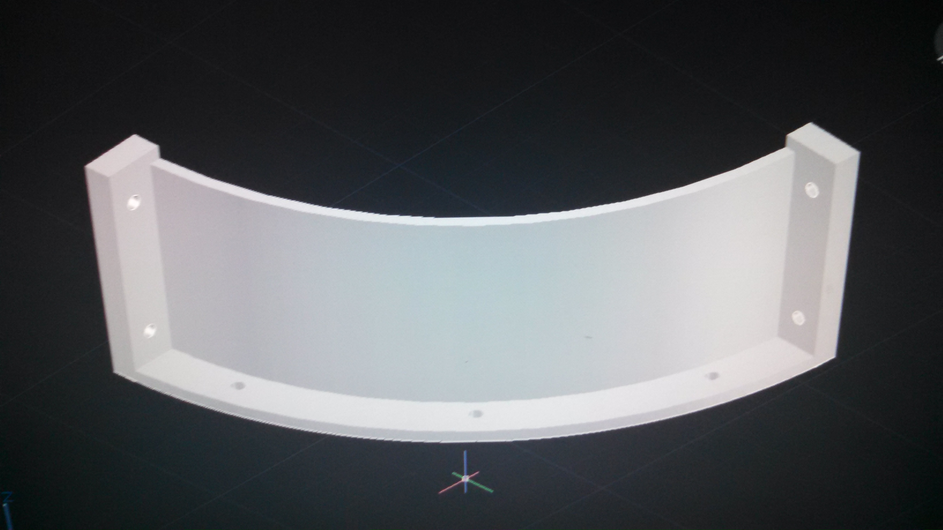

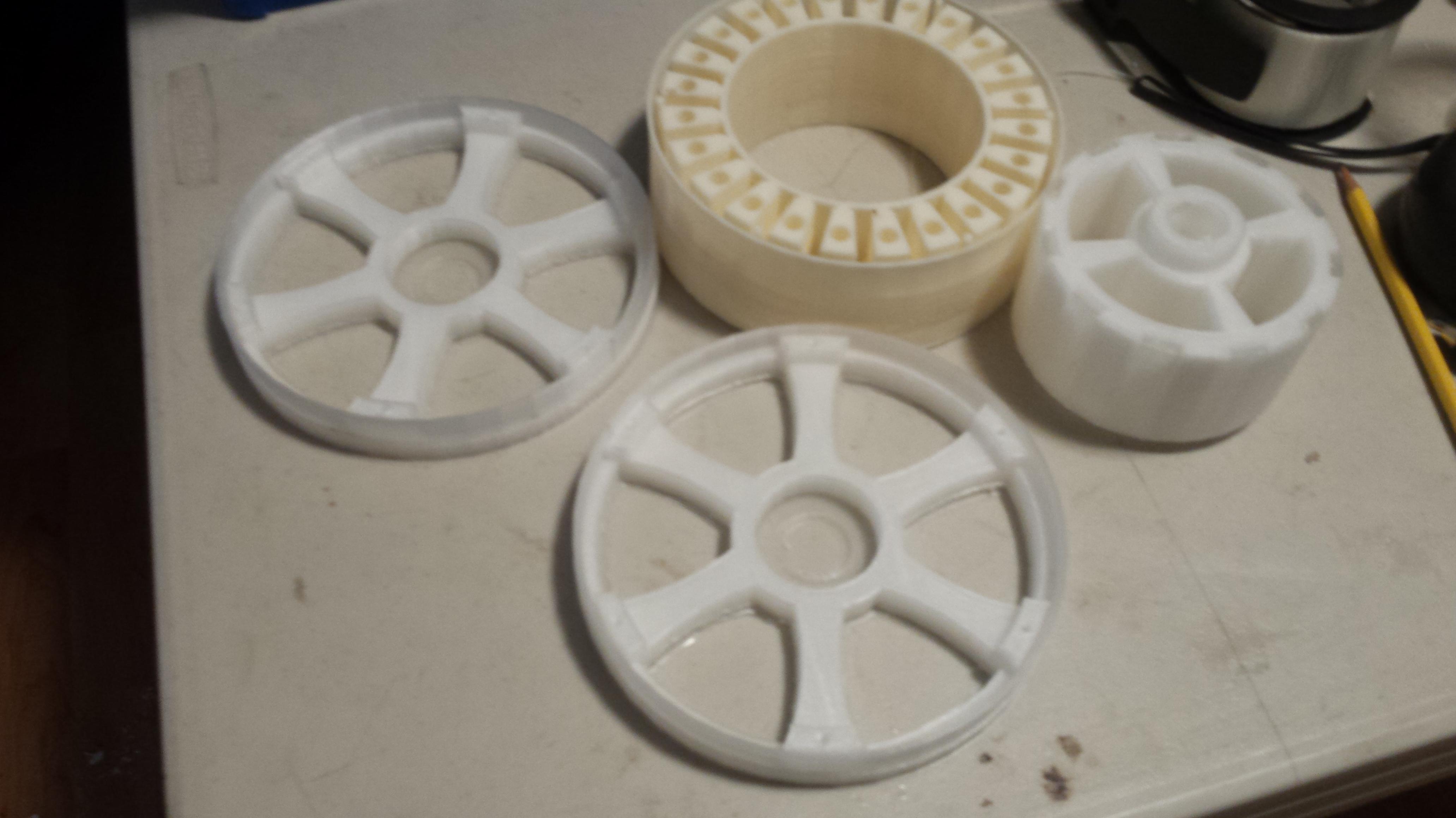

I have come up with a fairly simple but large 3D print file for experiments with this type of motor. I believe that the circuits found on this website can provide the current needed to power this motor. I am going to discuss the parts here first.
Part 1:

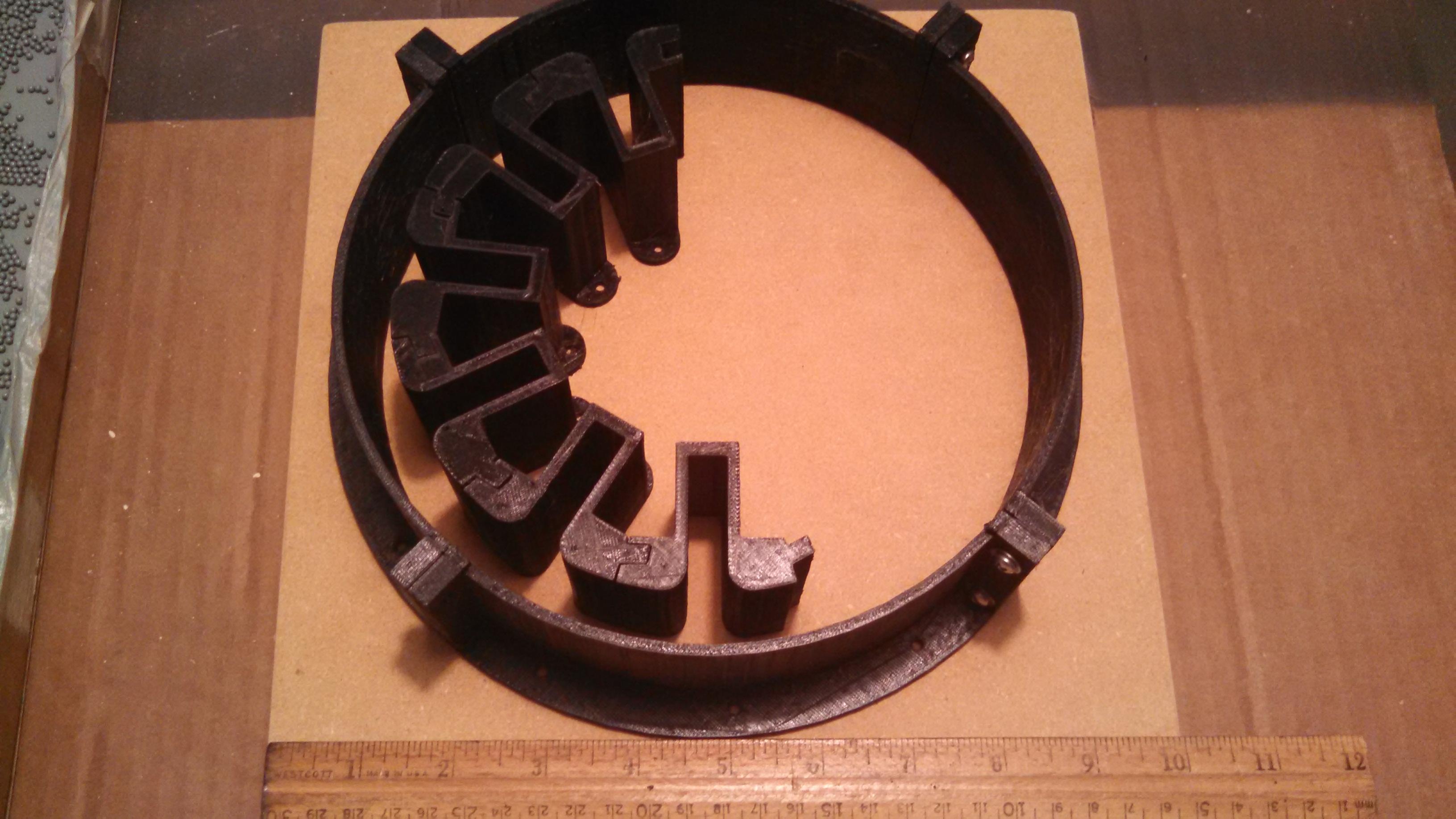

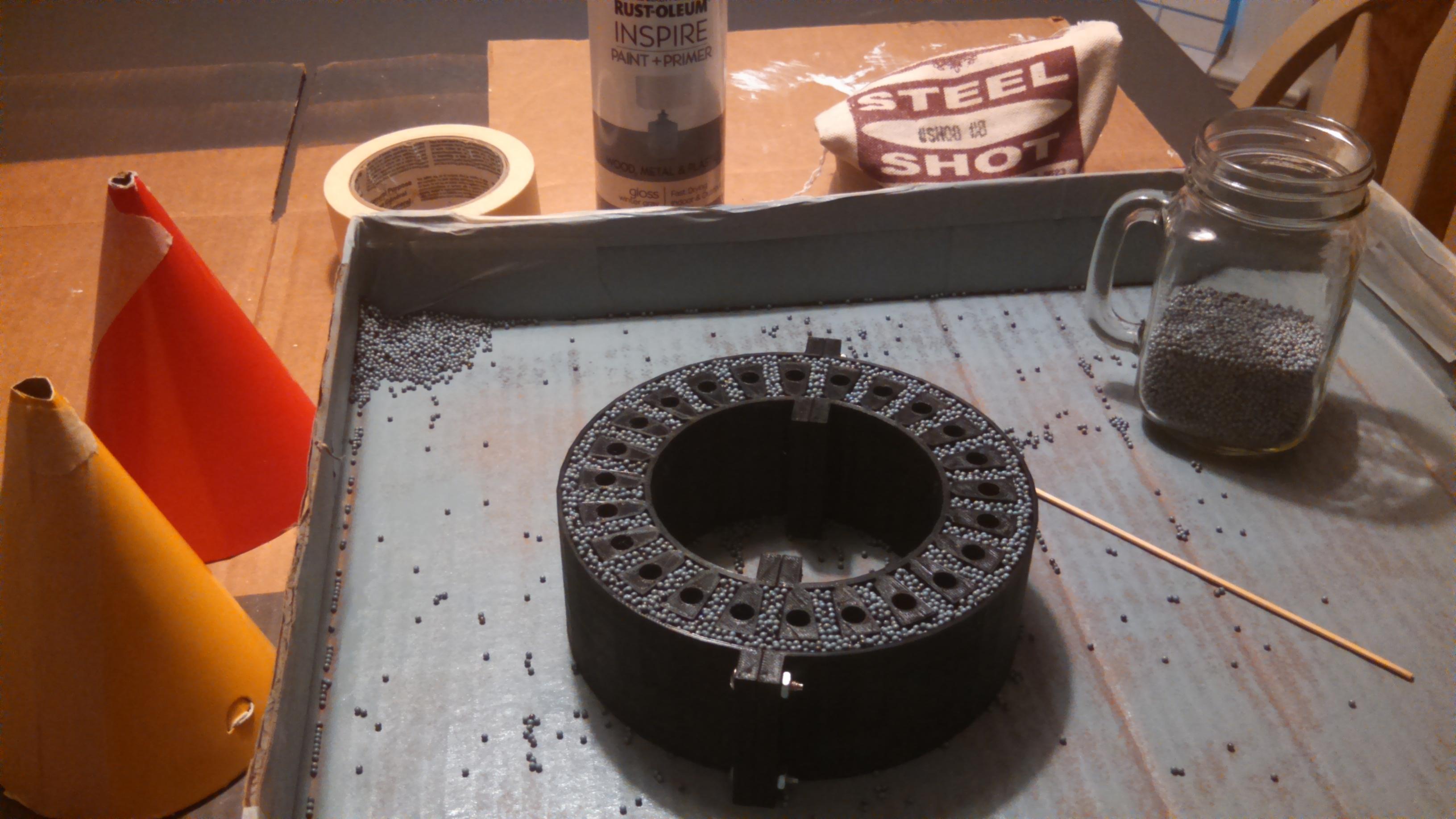

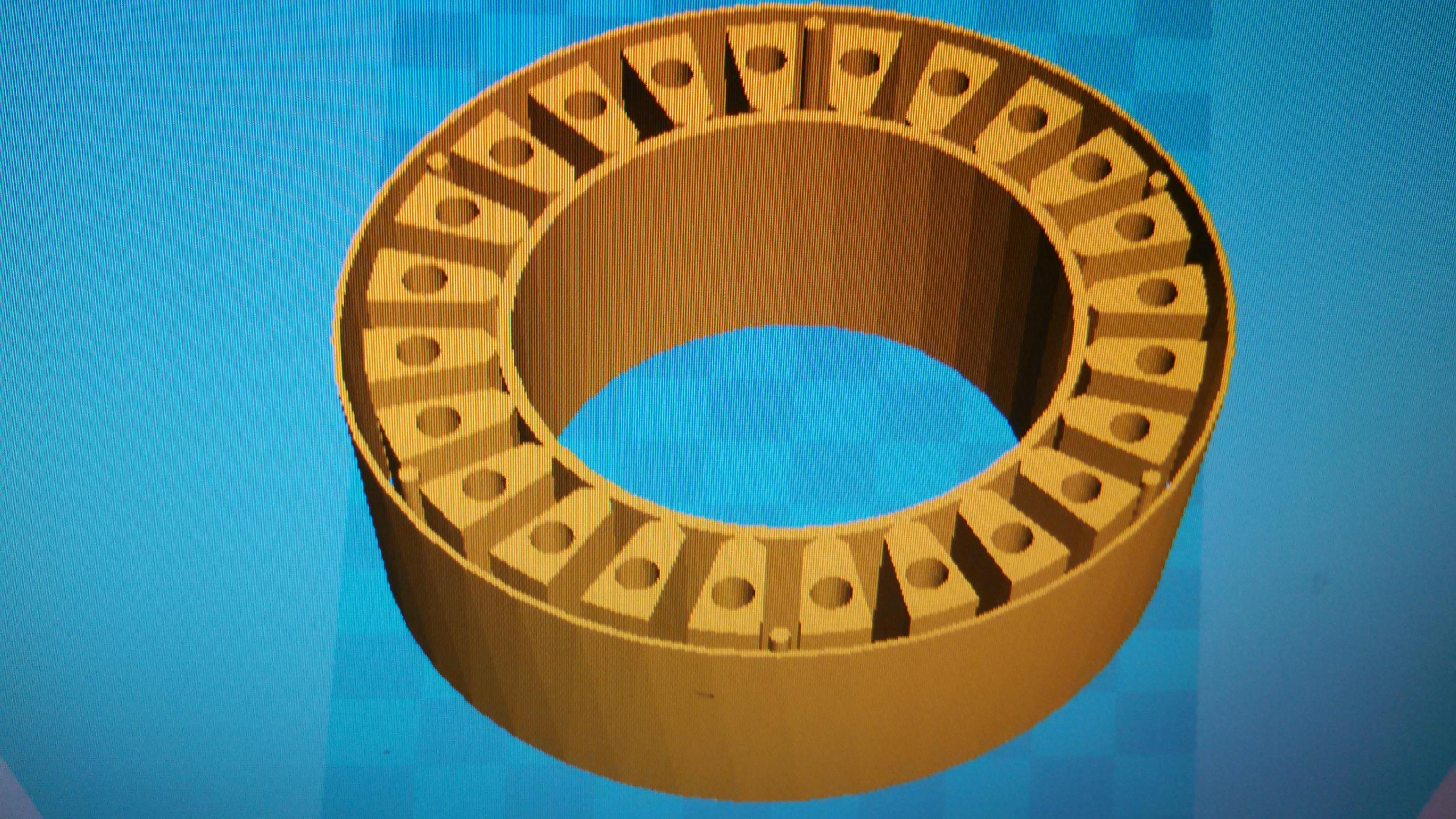

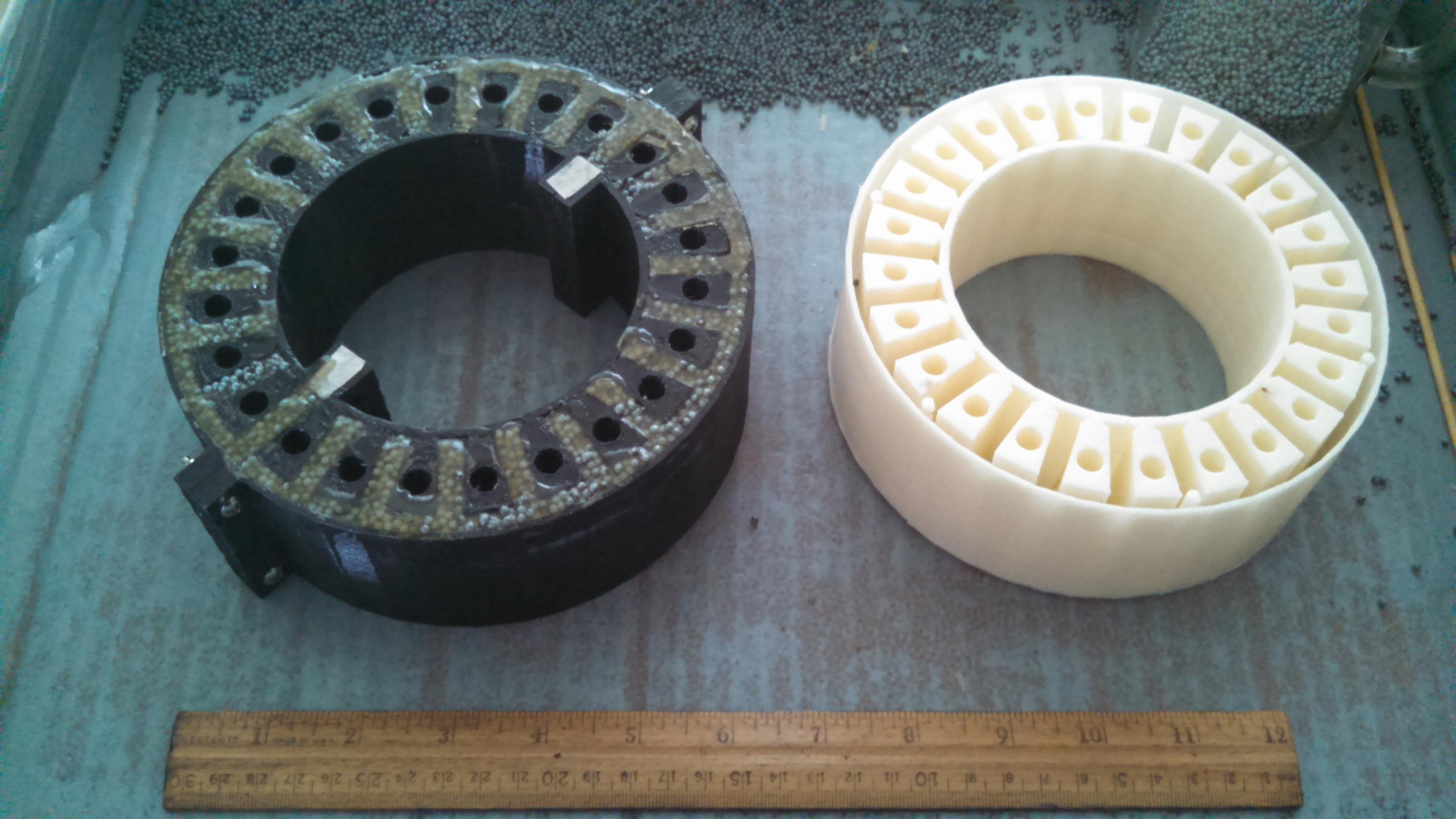

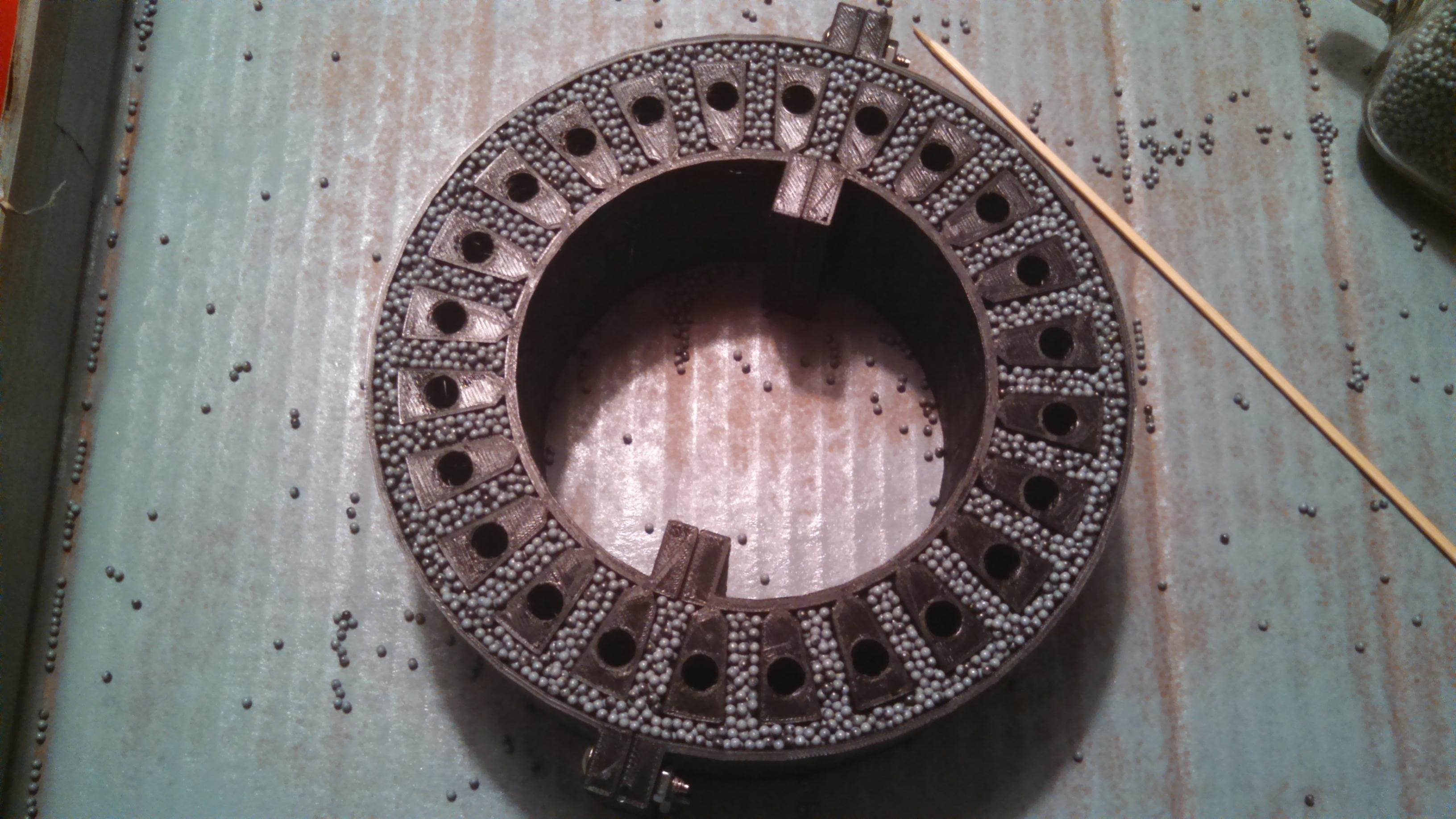

This is a stator mold. It is nominally 6" in diameter and 2.15" thick. It should be filled using the #8 reloading steel shot method described somewhere on this site. You will have to grease all of the internal surfaces so that your end piece can be removed easily. The choice for adhesive is up to you. I am using white Gorilla Glue. It has claims of weather and reasonable heat resistance. The mold should be mounted to a flat smooth surface which should also be greased. Silicone lubricant may be a good option. There are 24 screw holes for mounting the mold to that surface. It will also be your choice on wiring. It is a 24 pole stator. It can be wired for 6-phase. There are six mounting positions that should use 1/8" threaded rod.
Part 2:

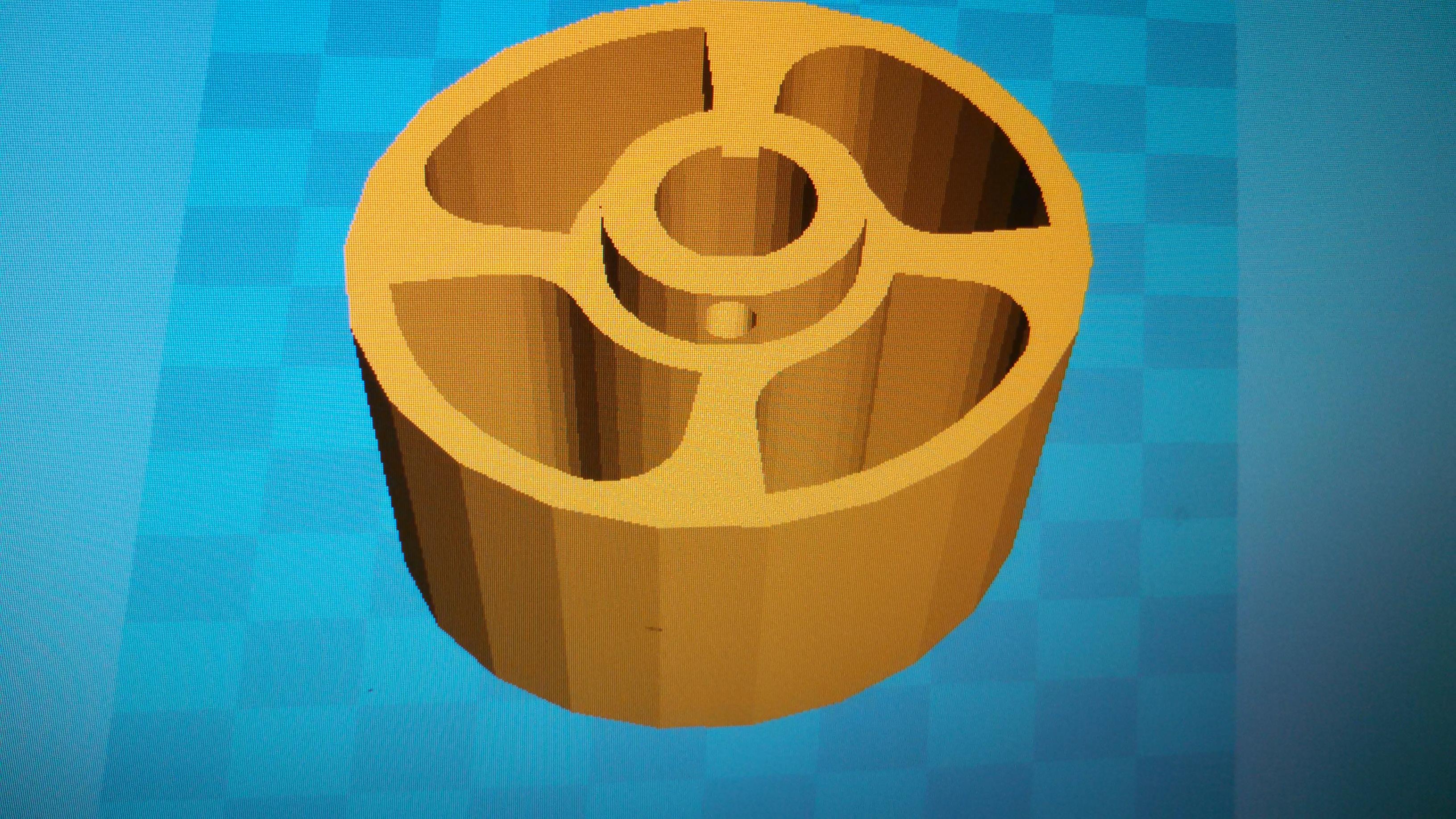

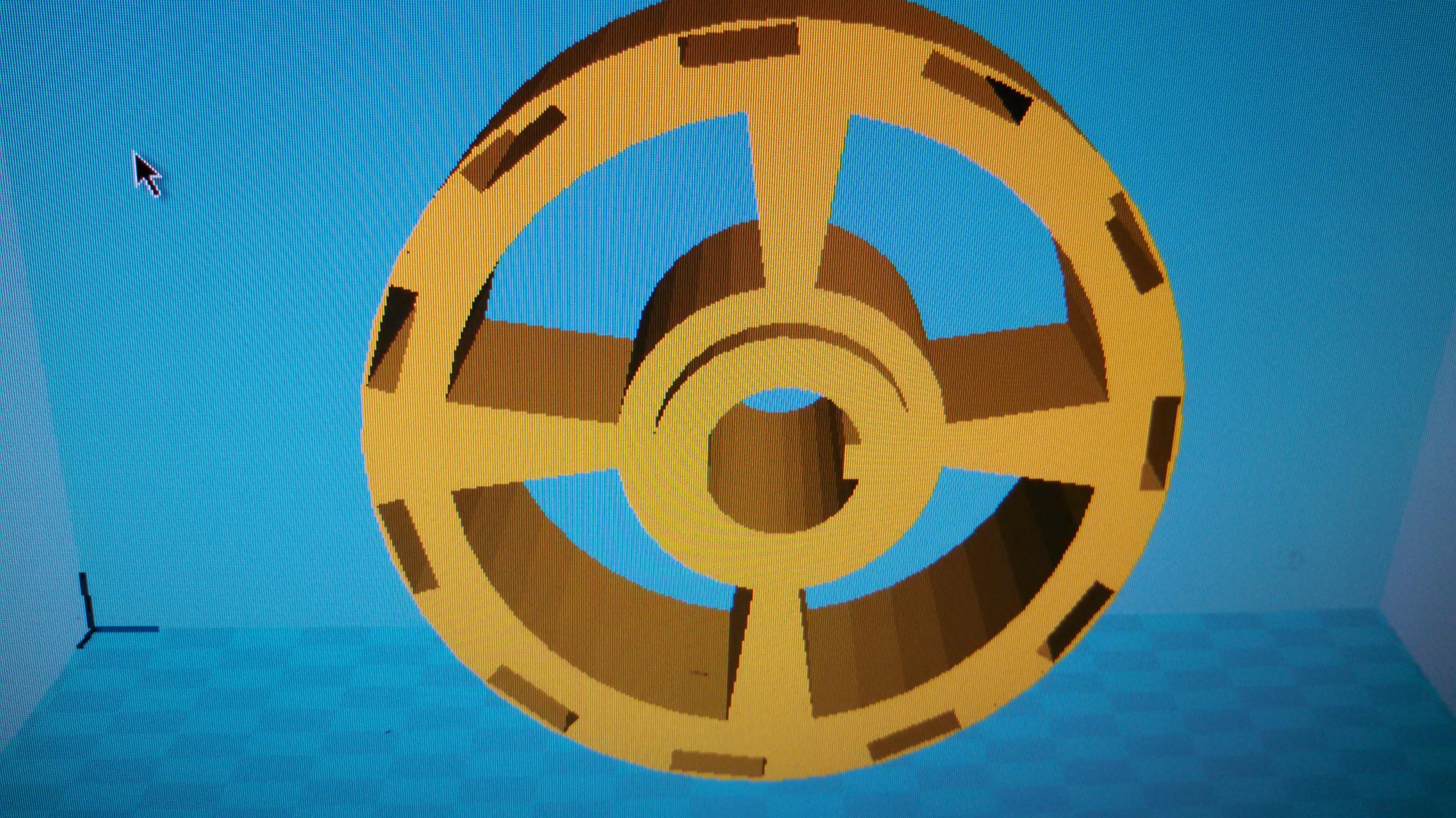

This is the rotor file. It is for a quantity of 22 (2" X 1/2" X 1/8") neodymium magnets. They should be adhered to the 22 flat surfaces. A thin hollow cylinder can be printed and slide over the magnets for protection. They should be installed in the NSNS configuration. It has a 3/16" key stub included and 1/4" set screw hole. I am using a 3/4" shaft from BMI Karts for my shaft. It has a 3/16" key slot in it. It comes 36" in length and be cut to the length you need for this motor.
Part 3:

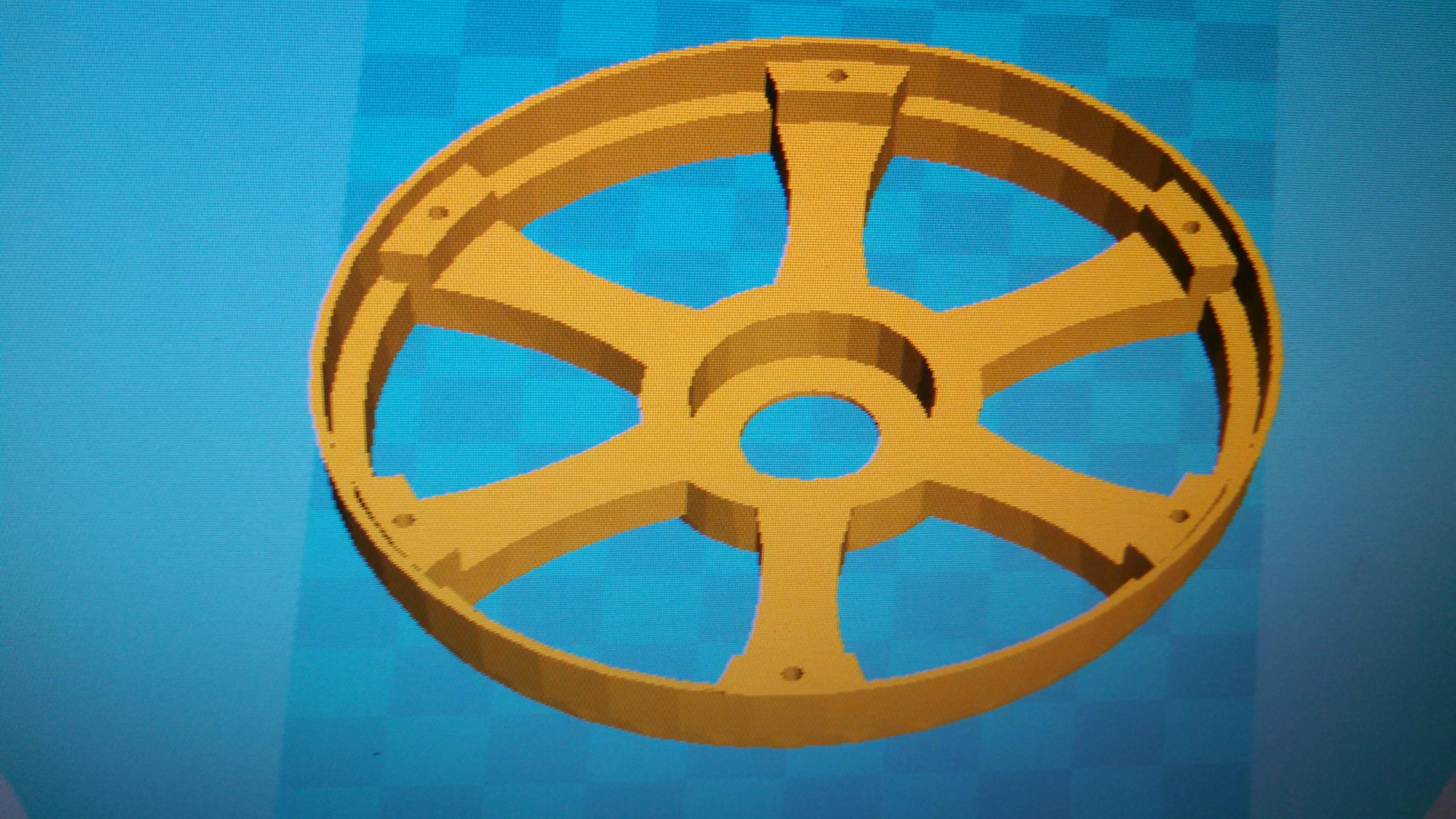

This is the bearing ends. It is for 3/4" X 1 5/8" X 7/16" bearings.
This will be an open source project. It is at the ground level at this point. My hopes are to integrate multiple Bedini/Cole Window Motor Circuits and to stack an additional stator for a low-lenz generator to charge a second bank of batteries. If you need parts printed Tom Childs with Teslagenx has the files for distribution and is also set up to print upon request. I only wanted to share this with those on this site that are familiar with Bedini's technology so you will have to make an individual request to Tom for the files. Disclaimer: Build and experiment at your own risk. If you intend to use this on a mobile craft you will need to seriously consider exchanging the plastic parts for metal. You will also need to consider using premium bearings. The plastic motor ends and rotor is just for low voltage experimentation. Please share your build to include your circuit setup and any improvements made.

This is a stator mold. It is nominally 6" in diameter and 2.15" thick. It should be filled using the #8 reloading steel shot method described somewhere on this site. You will have to grease all of the internal surfaces so that your end piece can be removed easily. The choice for adhesive is up to you. I am using white Gorilla Glue. It has claims of weather and reasonable heat resistance. The mold should be mounted to a flat smooth surface which should also be greased. Silicone lubricant may be a good option. There are 24 screw holes for mounting the mold to that surface. It will also be your choice on wiring. It is a 24 pole stator. It can be wired for 6-phase. There are six mounting positions that should use 1/8" threaded rod.Part 2:
This is the rotor file. It is for a quantity of 22 (2" X 1/2" X 1/8") neodymium magnets. They should be adhered to the 22 flat surfaces. A thin hollow cylinder can be printed and slide over the magnets for protection. They should be installed in the NSNS configuration. It has a 3/16" key stub included and 1/4" set screw hole. I am using a 3/4" shaft from BMI Karts for my shaft. It has a 3/16" key slot in it. It comes 36" in length and be cut to the length you need for this motor.Part 3:
This is the bearing ends. It is for 3/4" X 1 5/8" X 7/16" bearings. This will be an open source project. It is at the ground level at this point. My hopes are to integrate multiple Bedini/Cole Window Motor Circuits and to stack an additional stator for a low-lenz generator to charge a second bank of batteries. If you need parts printed Tom Childs with Teslagenx has the files for distribution and is also set up to print upon request. I only wanted to share this with those on this site that are familiar with Bedini's technology so you will have to make an individual request to Tom for the files. Disclaimer: Build and experiment at your own risk. If you intend to use this on a mobile craft you will need to seriously consider exchanging the plastic parts for metal. You will also need to consider using premium bearings. The plastic motor ends and rotor is just for low voltage experimentation. Please share your build to include your circuit setup and any improvements made.
