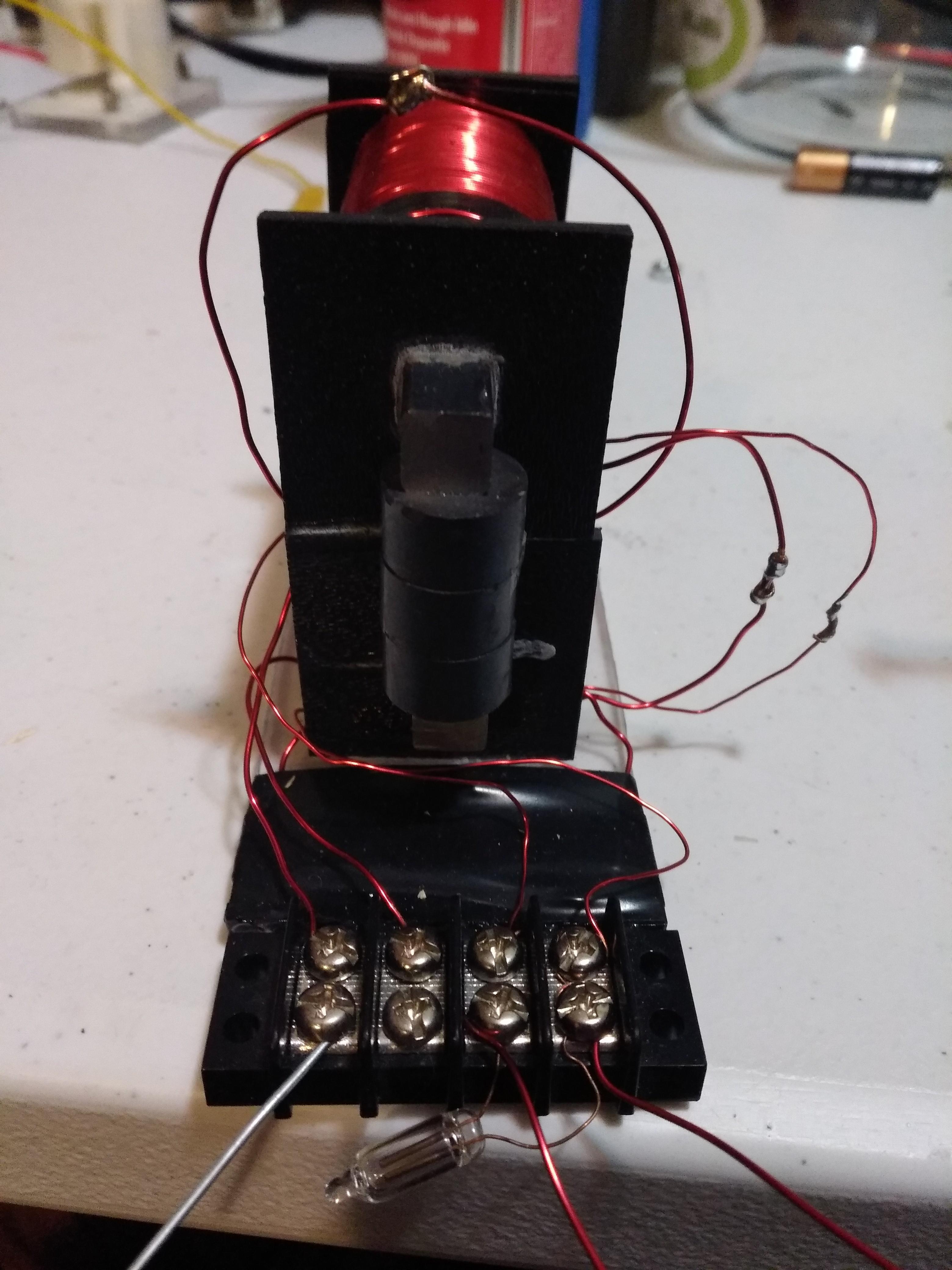

This first post will be mainly for documenting the build and all relevant information pertaining to it wire size, resistance, # turns, magnets used etc.

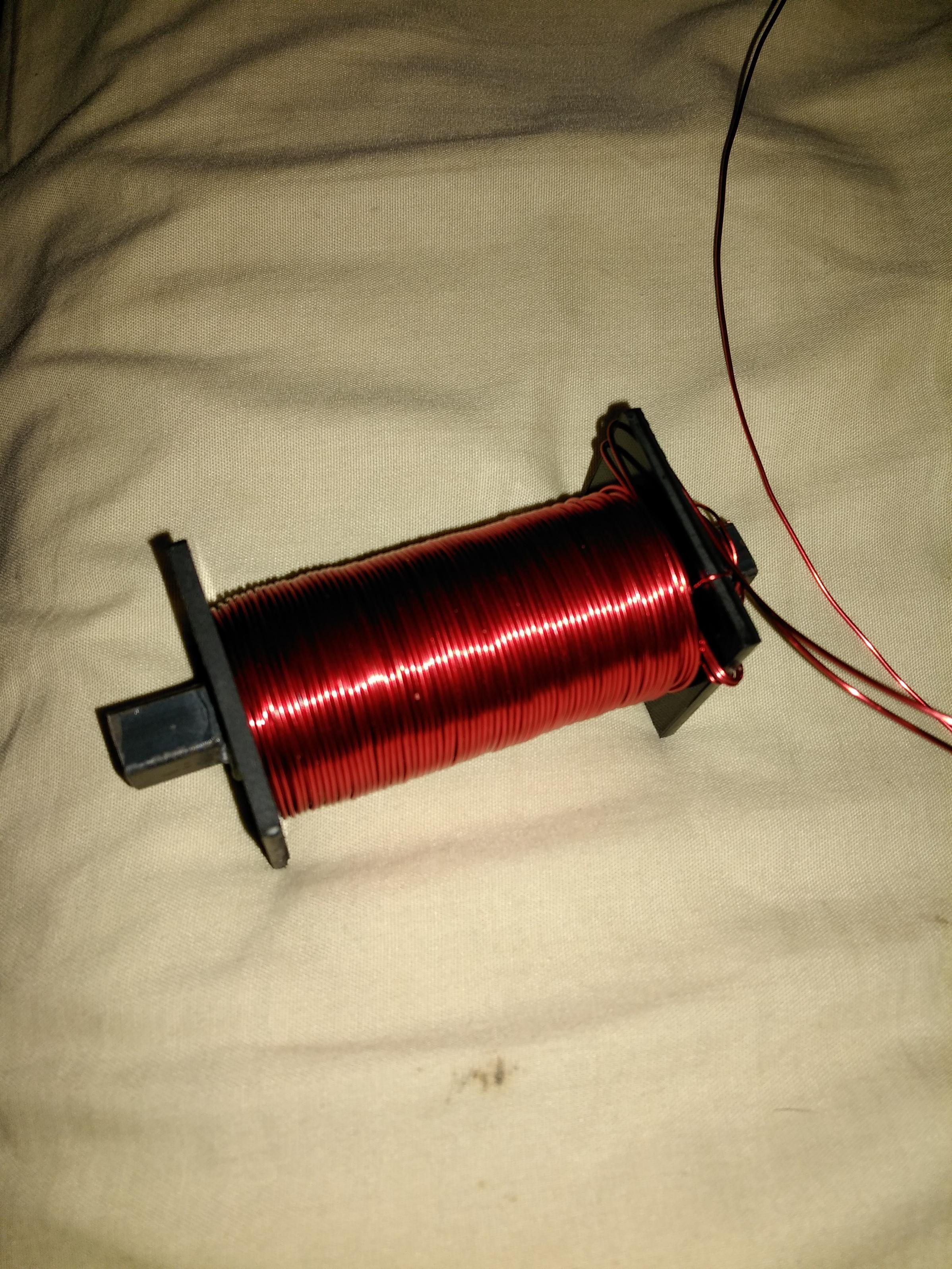

MATERIALS:

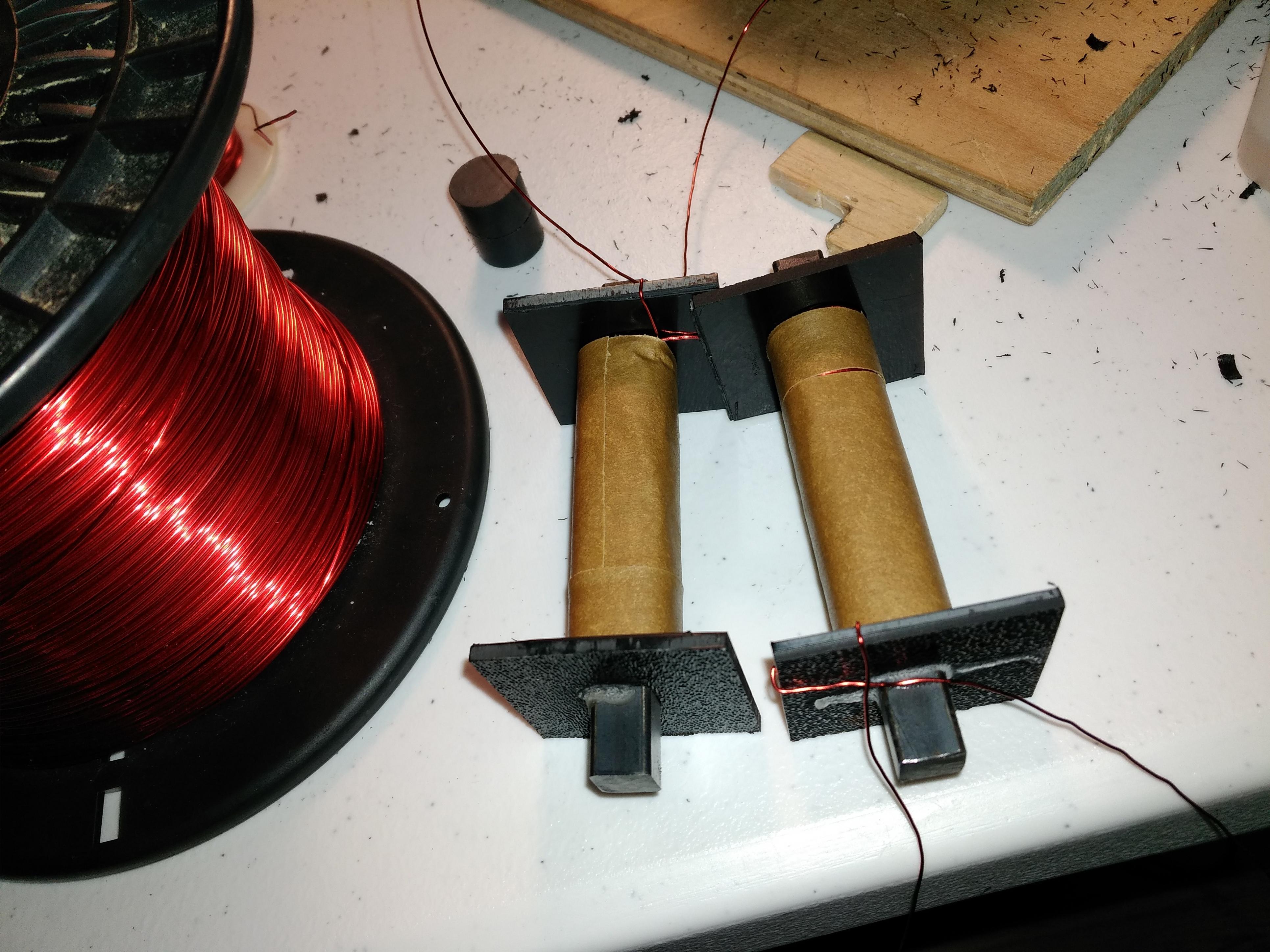

cores-- are 3/8" (Not certain will check and update) square rod from lowes
magnets -- ceramic round

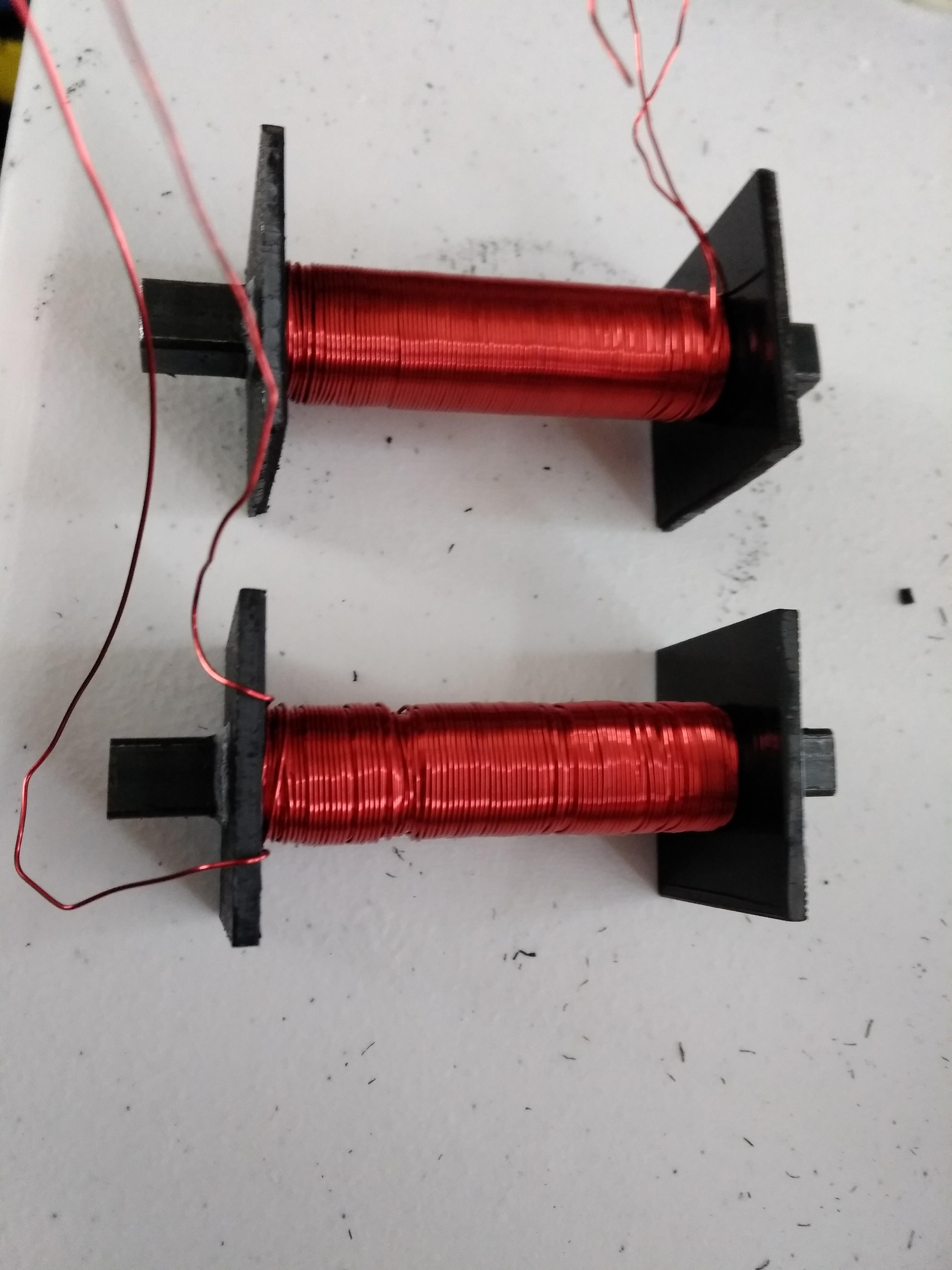

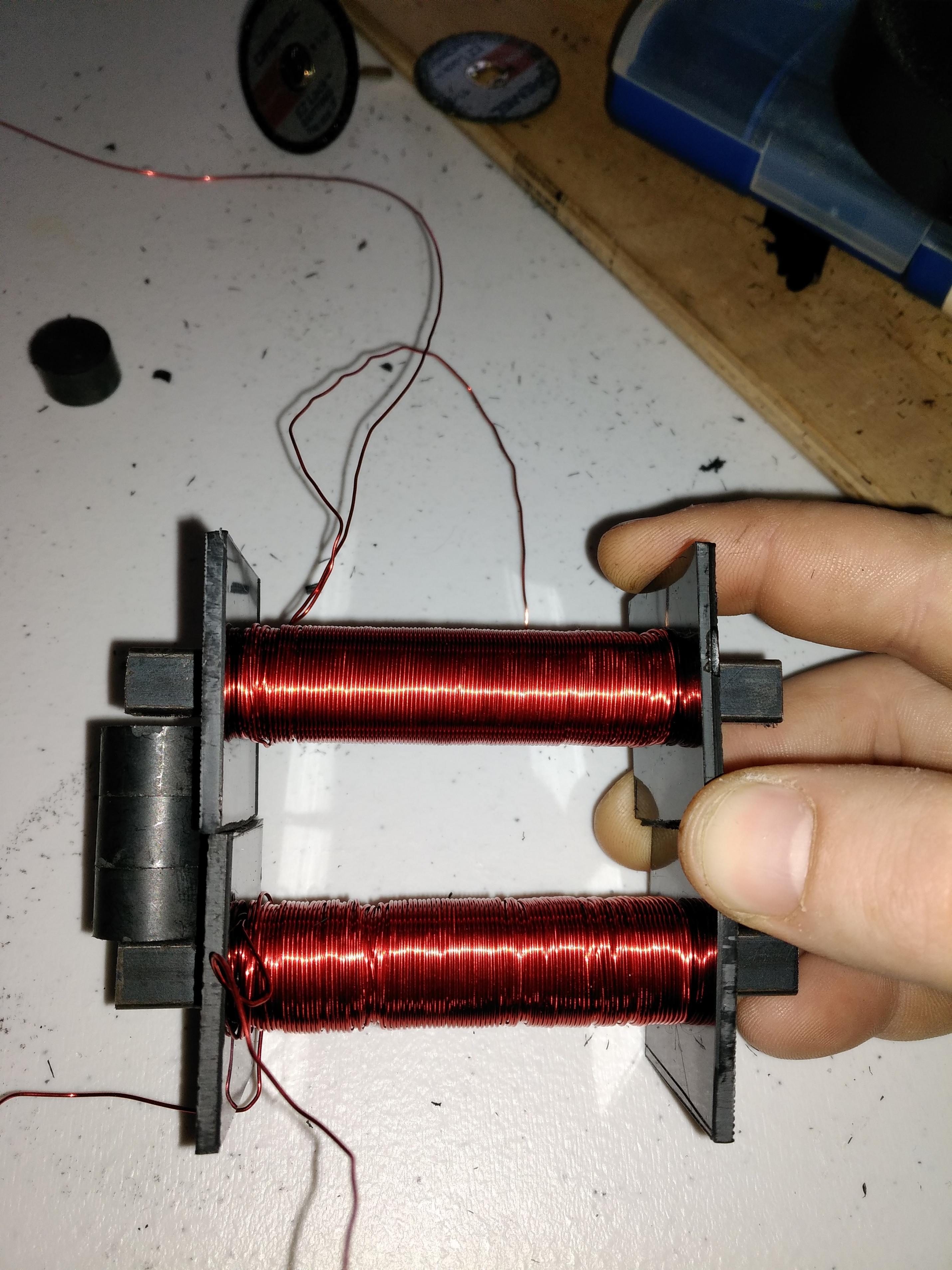

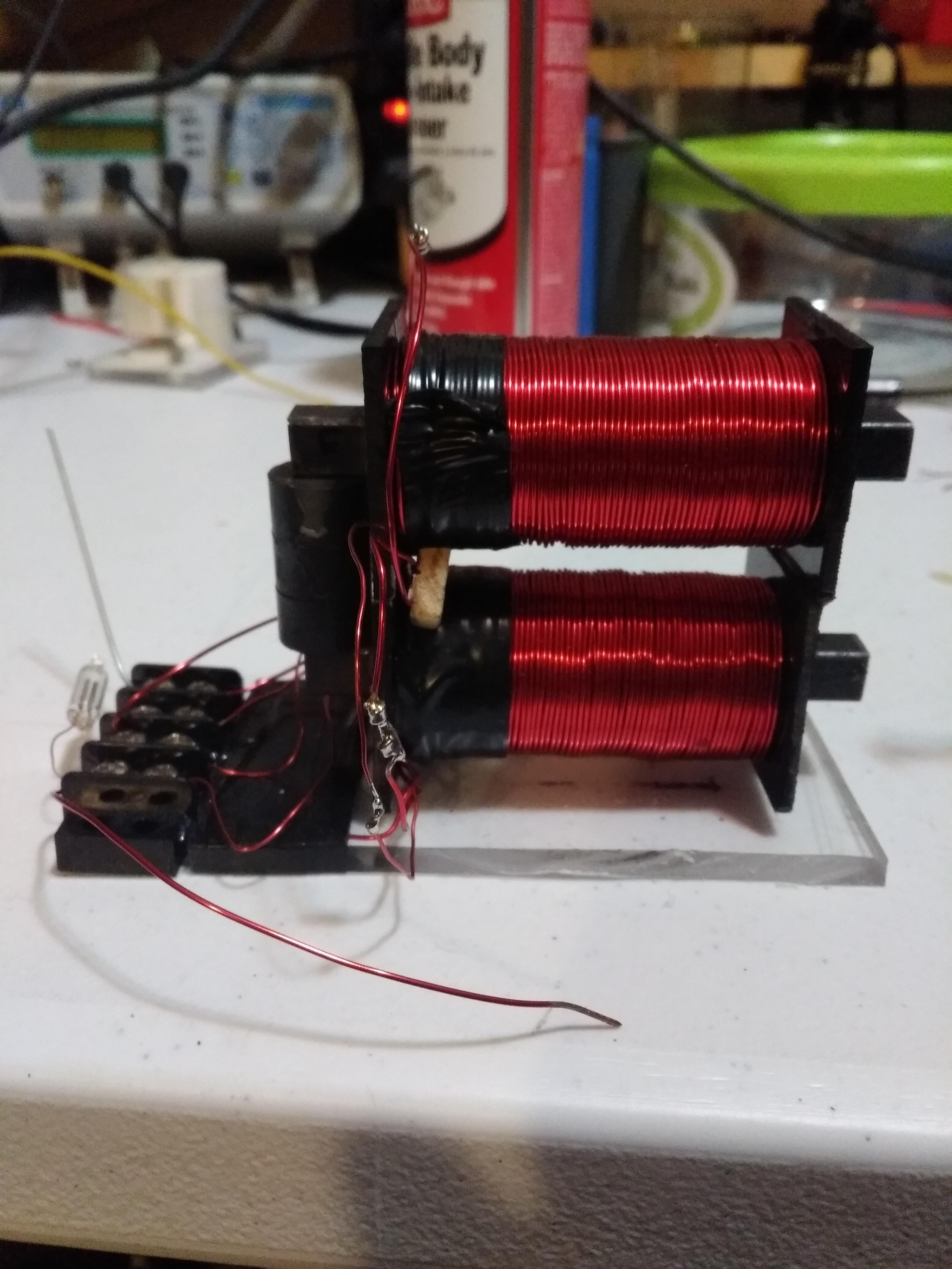

Drive coils--4 ohms #22 AWG 250 turns single wire
Gen coils-- 3.33 ohms #18 awg 250 turns bi-filar wound (so 500 turns together)

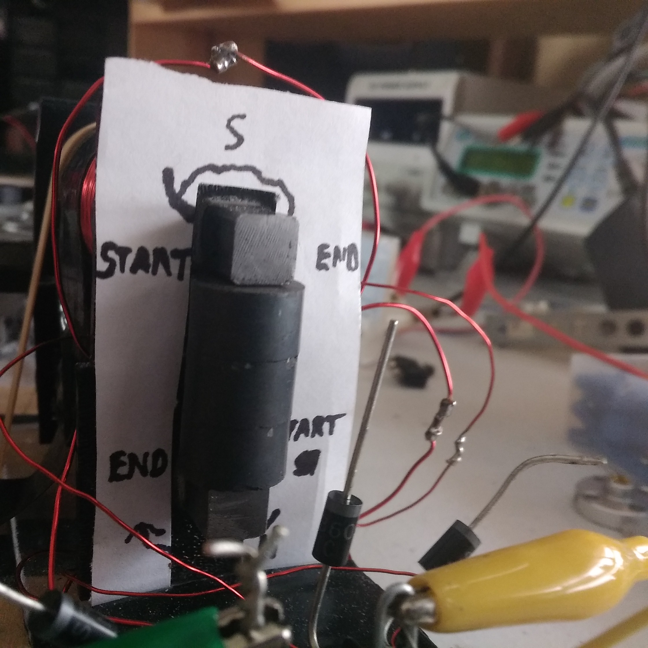

With the coils I was trying for a 1:2 ration run:gen with equal resistances. I dont really have a solid reason for this, it just seemed right for some reason. On my multimeter they both read 4 ohms. However when tested using my power supply and calculating the resistance using ohms law I came up with the above values. Also they are wound in the Normal bifilar configurtion with the end of one bifilar coil connected to the begining of the next coil. In the patent they are wired so that the begining and end of one bifilar are connected to the bedining and end of the other, with the output being pulled from the middle of the second. I Did not notice, or pay any thought, to this fact untill after I already made this coil pair. I may try to swap the wire sometime soon and see if any difference presents itself. I speculate that there is a reason for this way of wiring but will post more on that when I have more solid data about it.

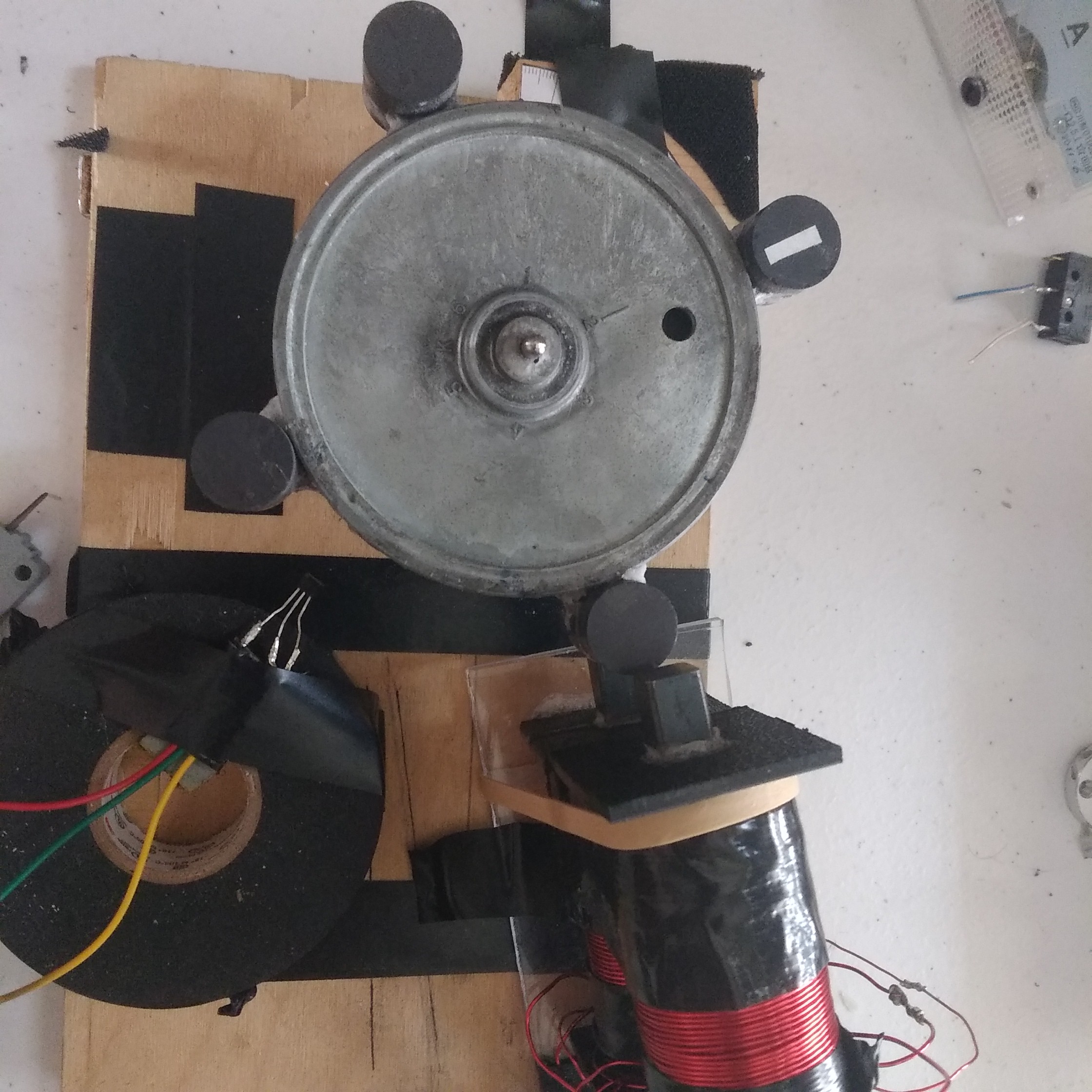

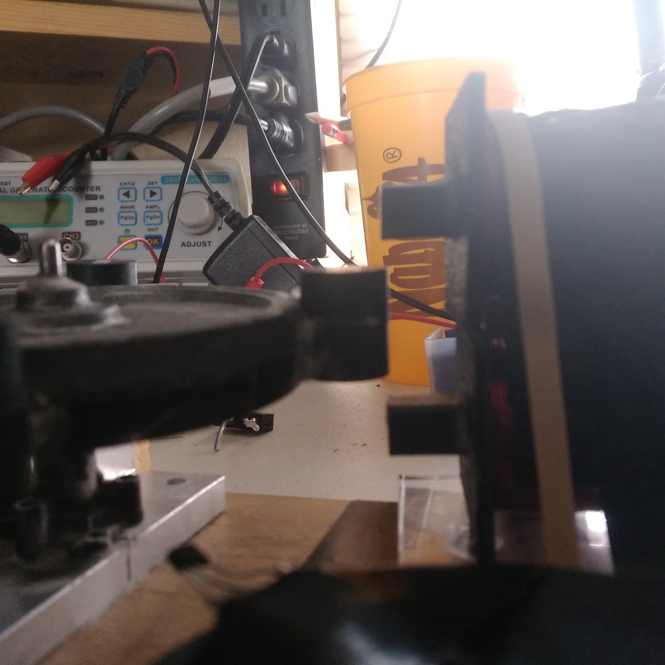

Rotor-- two metal flywheels pulled from old vcr, or something like that can't remember, glued together. Without the magnets the full rotor is 233 grams.

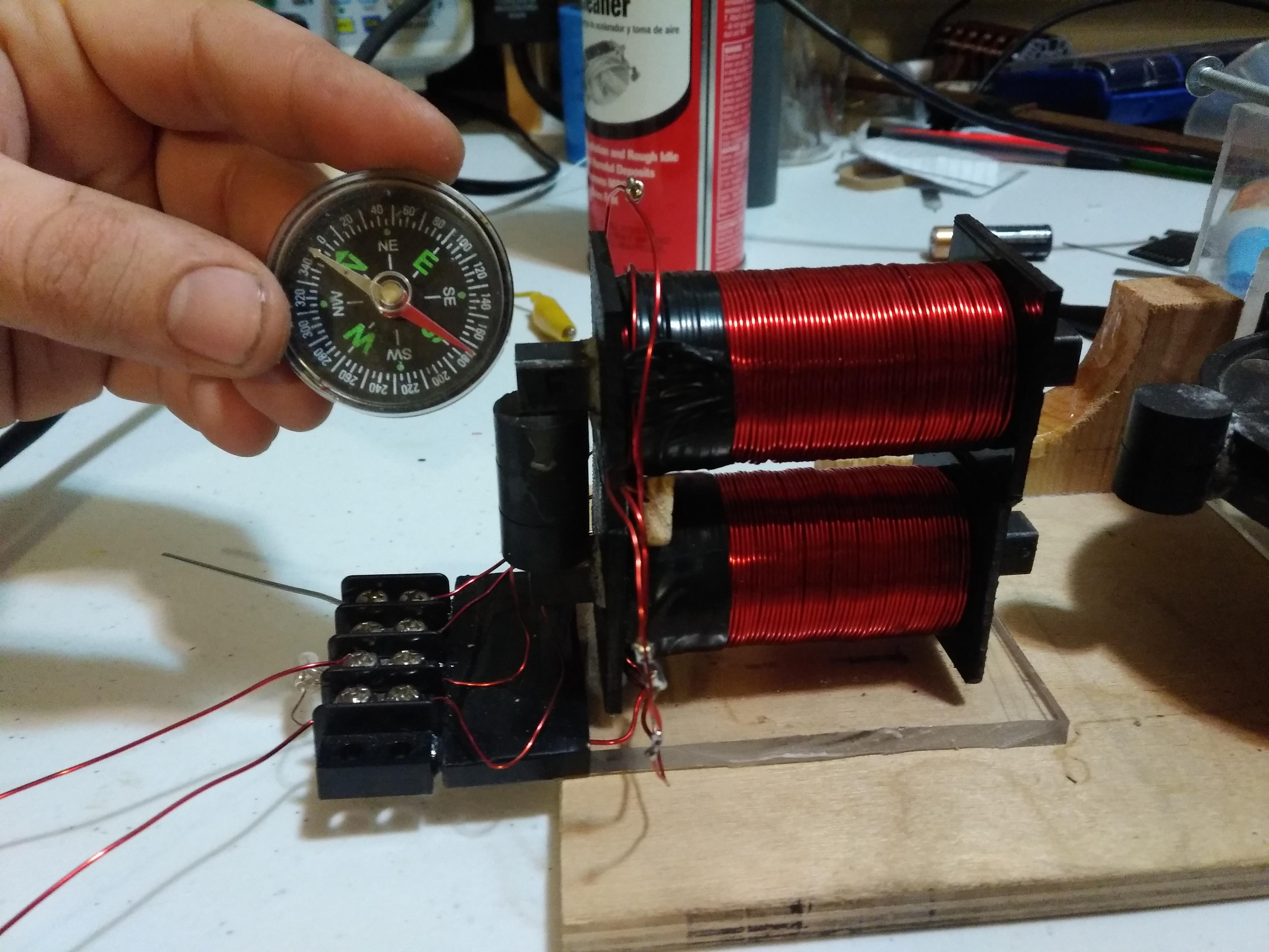

The rotor has 4 magnetic poles (each having two stacked magnets) and the coils has 3 stacked magnets. I did this for simplicity and not having a super tight gap between the cores and the rotor magnets for testing. I plan on adding ends to the cores, as in the patent, to close the gap. I dont know how far into the hysteresis they are with the 3 coil magnets and two rotor magnets given that the cores are small for this first build.
The drive circuit is a 1/2 BC circuit just as in the patent. I do believe the small transistors may not match the patent, simply because I had everything else and wasn't waiting on ordering the exact ones...to impatient for that!
I will be editing this post, as soon as I can, to make sure I have everything right and post pictures of the build as soon as I have time.
