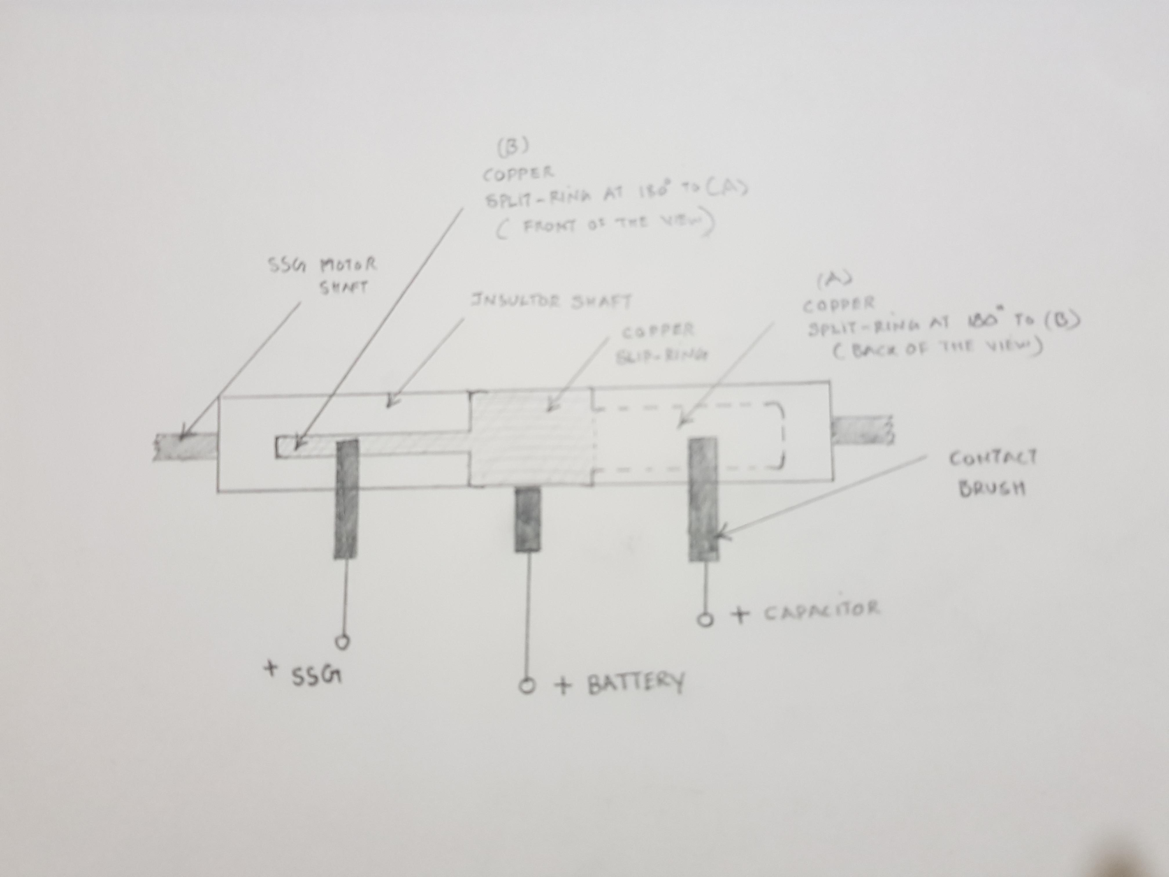

      Yes, you need a split-commutator when you break the power in between the pulses feeding the Energiser and the Motor function. JB did this in his 1984 single battery Motor-Energiser set-up. There are other
      refinments that can be done to this topology i shall not go into that here.
Name:	Split-Commutator Schematic..jpg
        That is if you want to connect and disconnect the input side battery.
        For the method in Peter's presentation, John only had 2 brushes and a wheel with a brass bar that would make contact to dump the caps to the batteries. The front side was connected constantly.

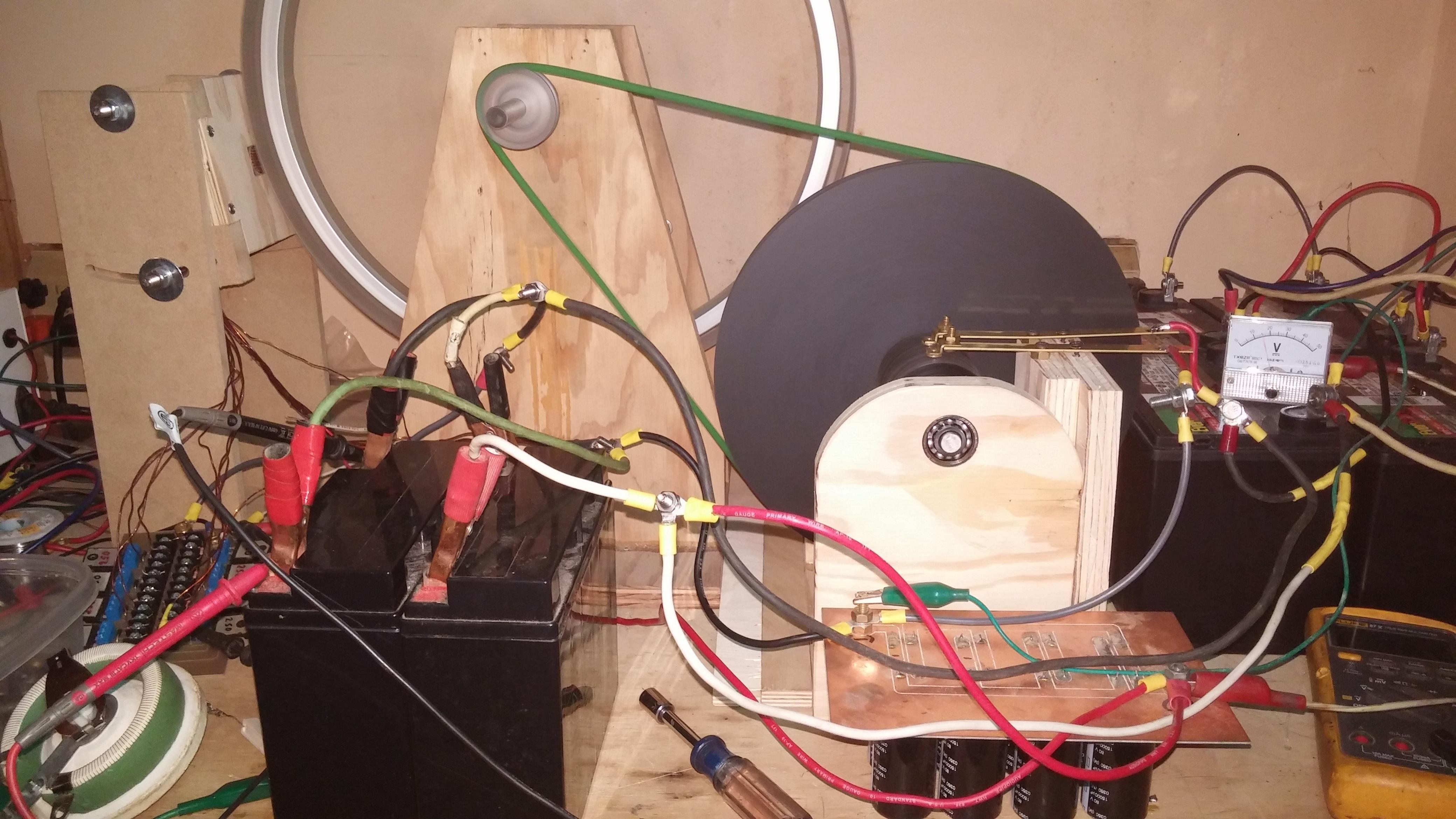

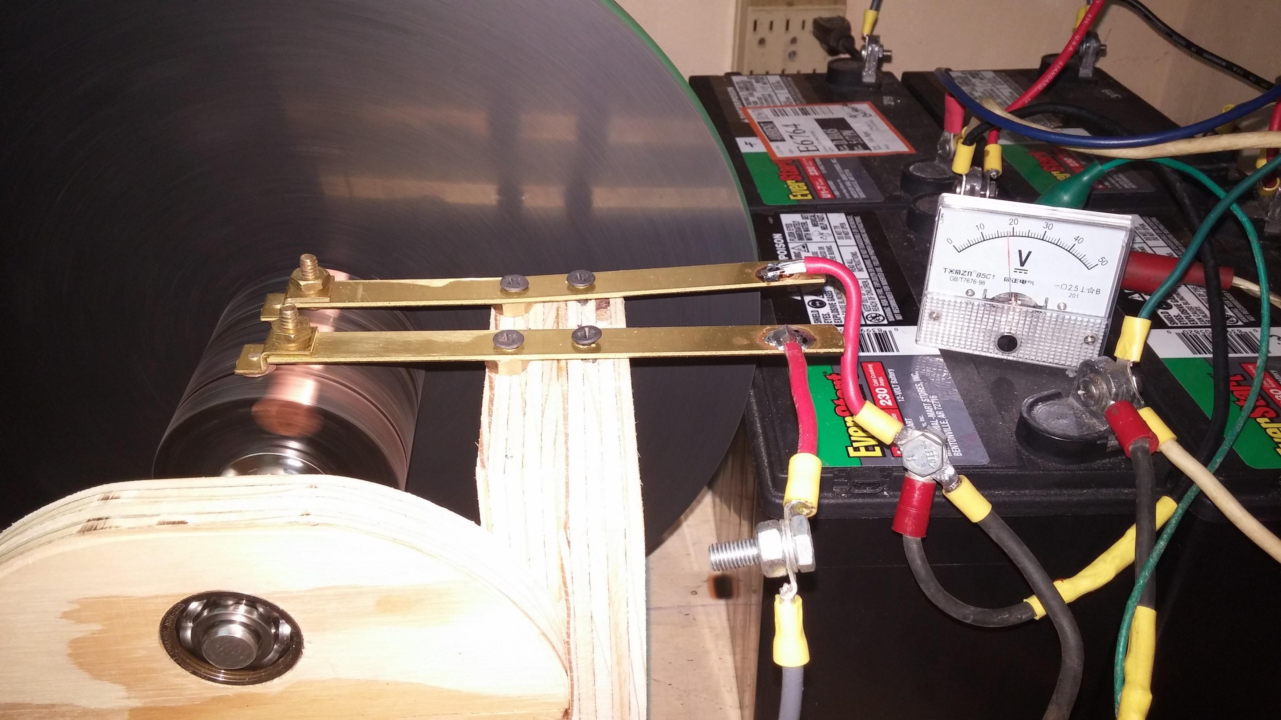

                      Got the fab work done today but not running yet.
                      The mechanical commutator is ready to go with the large timing wheel,
                      The silver brushes and round belt, etc.
                      I'll start with one, 8 strand coil and switch it manually with beefy battery clips.
                      Should have a report tomarrrow.
                      bro d
                        Hi All,
                        Initial report of Bedini self charging with mechanical cap dump:
                        Bike wheel rpm - 370
                        1, 8 pwr strand coil.
                        120,000 mF cap bank
                        10 dump pulses in 8.5 seconds at 21v
                        Presently I'm running with a charger on the run batt until large bank is fully charged.
                        Then we'll have proper testing prep.
Name:	BEDINI SELF CHARGING WITH BATT CLAMP SWITCHING.jpg
ID:	50211 Click image for larger version
                        Always grateful,
                        bro d

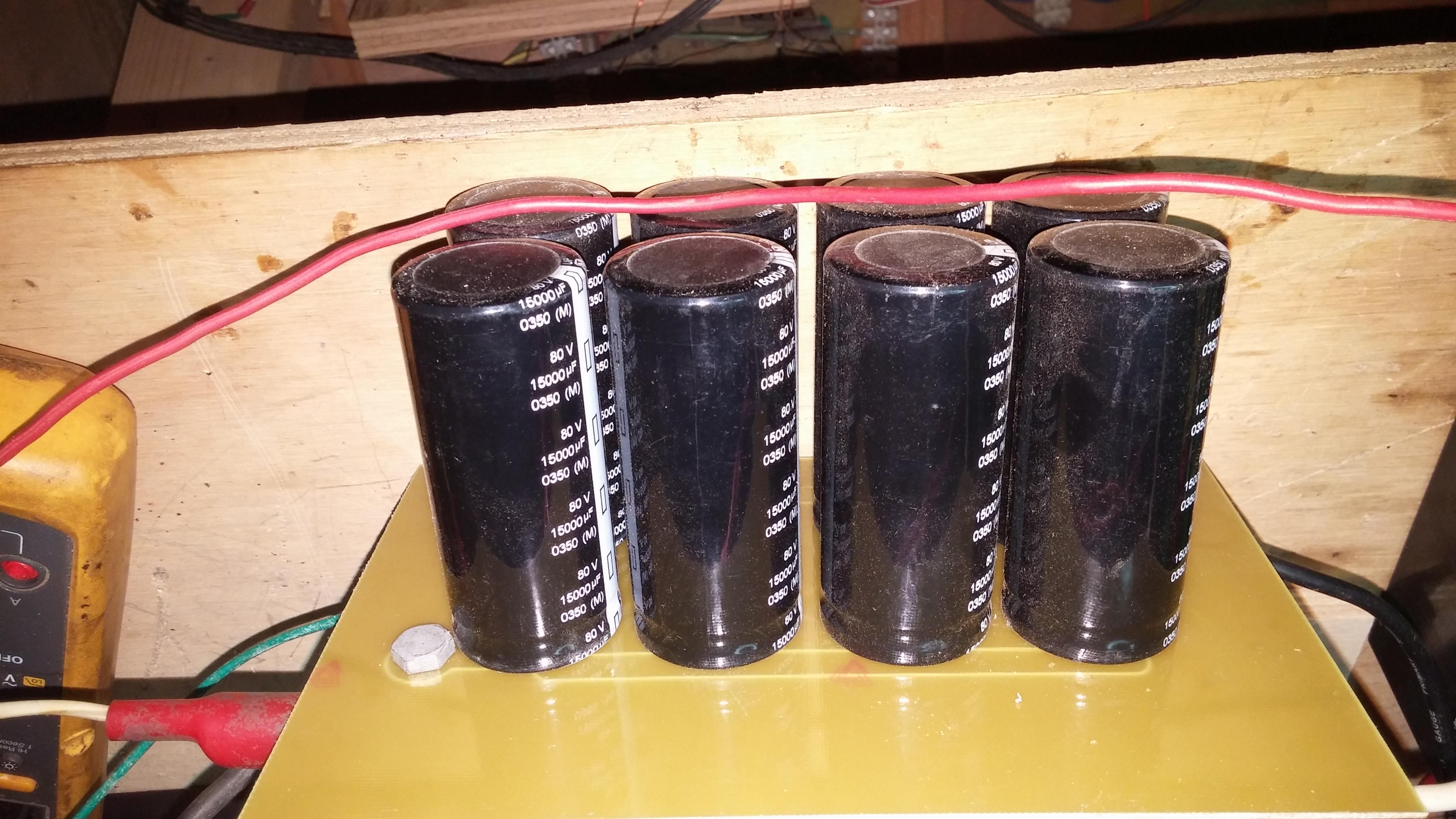

                          What are the specs for your cap(s) bank?
                            8, 15000uF 80v caps
Name:	120,000uF cap bank.jpg
                              Originally posted by brodonh View Post
                              8, 15000uF 80v caps
                              All in parallel for 120,000 is a bit over 1/3 of what John used but is a good start. If you got those to 2-3 volts above battery voltage and dumped that every 2-3 seconds or so, that would be similar to what John did. There is something else that happens with the batteries with those big cap dumps. It wasn't mentioned in my walk-thru video - I want to see if anyone experiences it and reports it.
