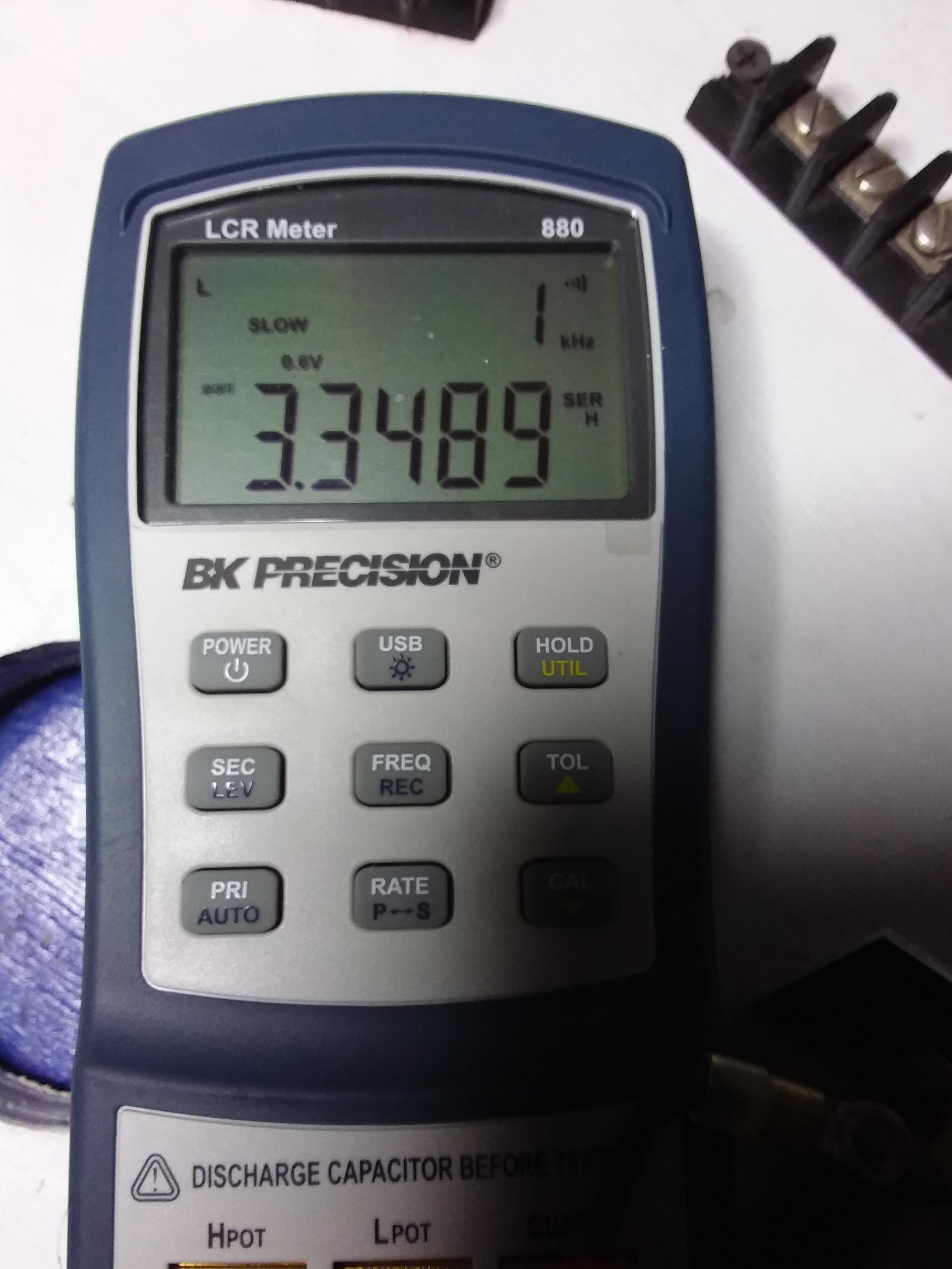

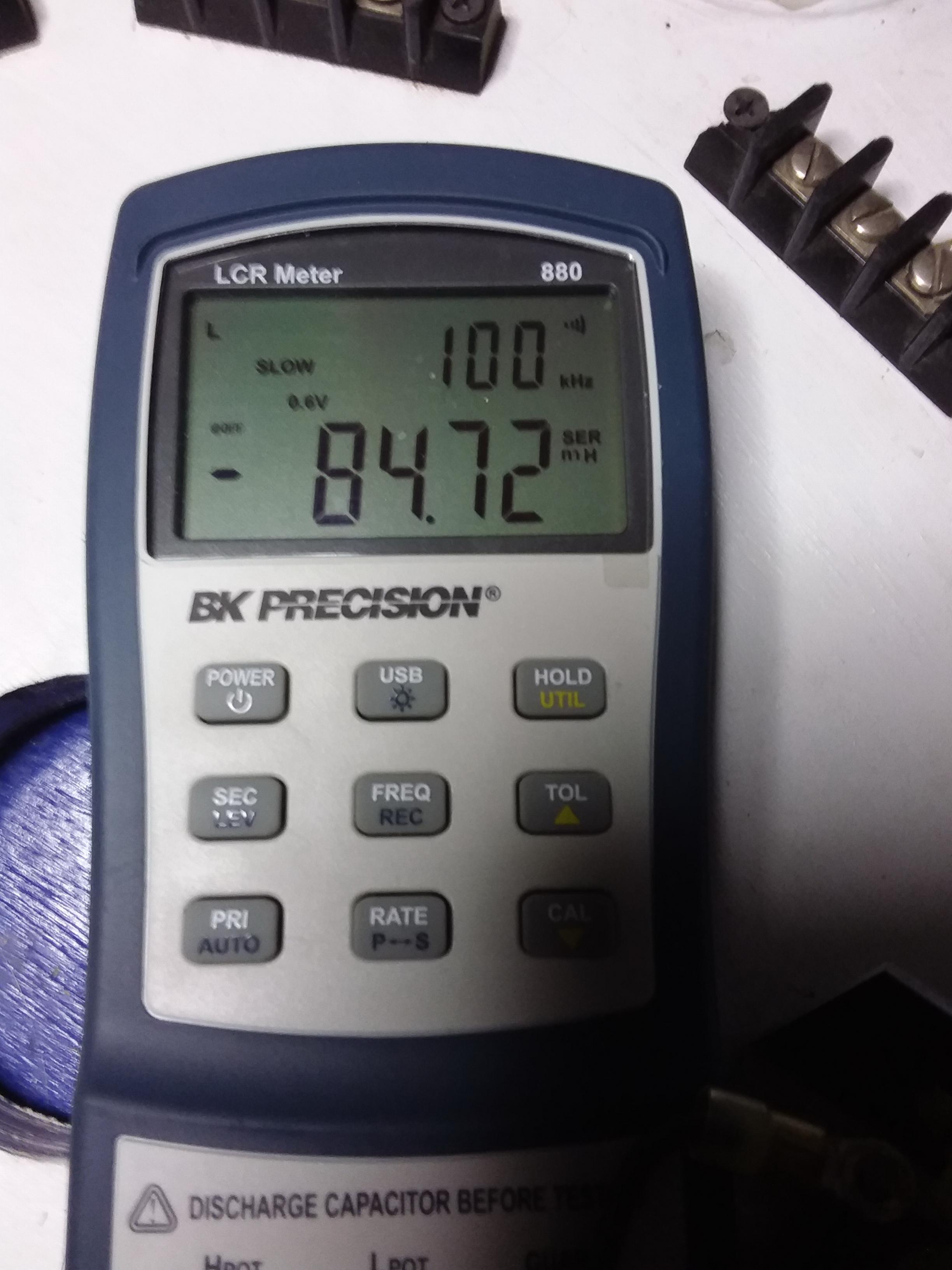

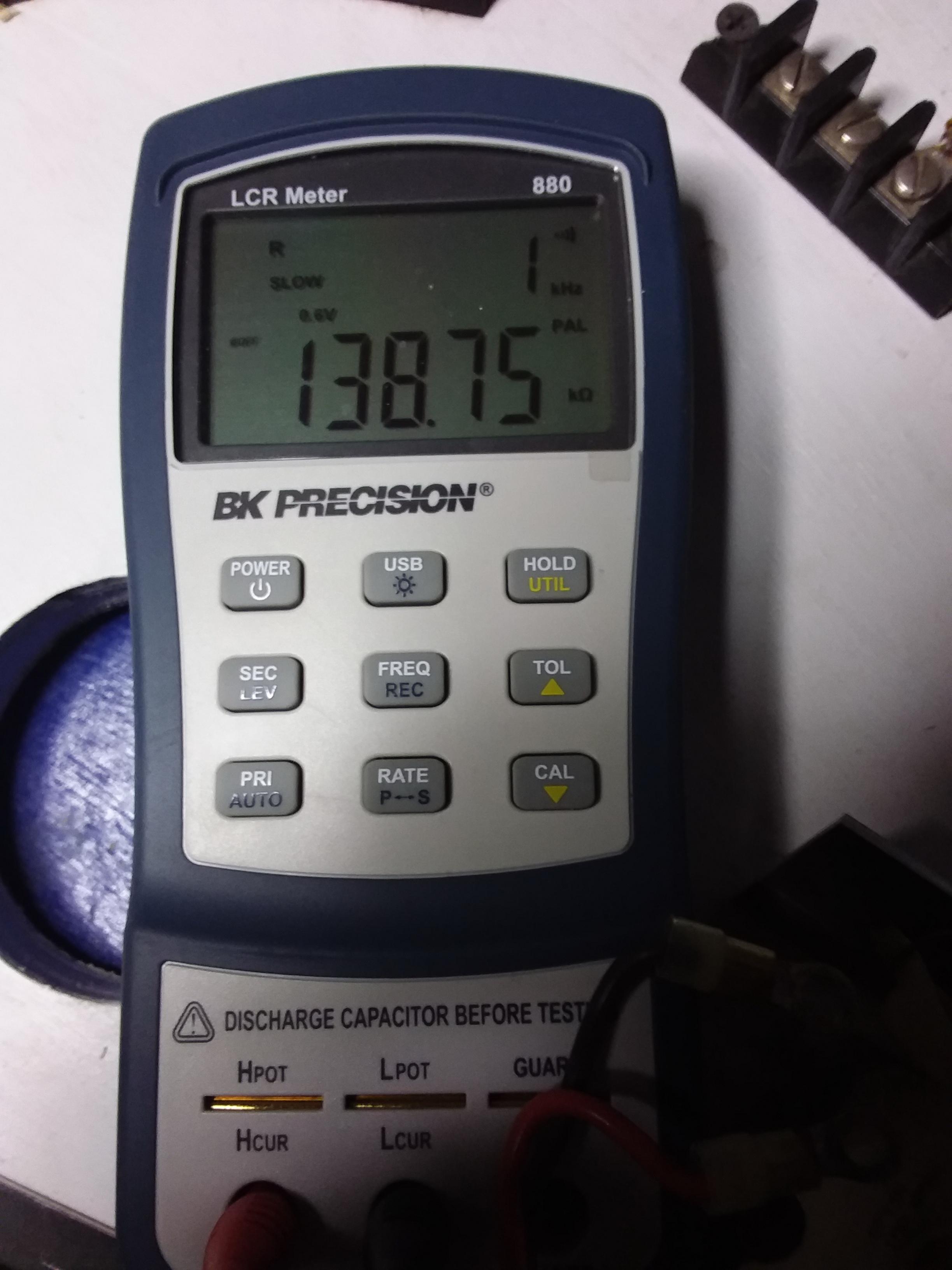

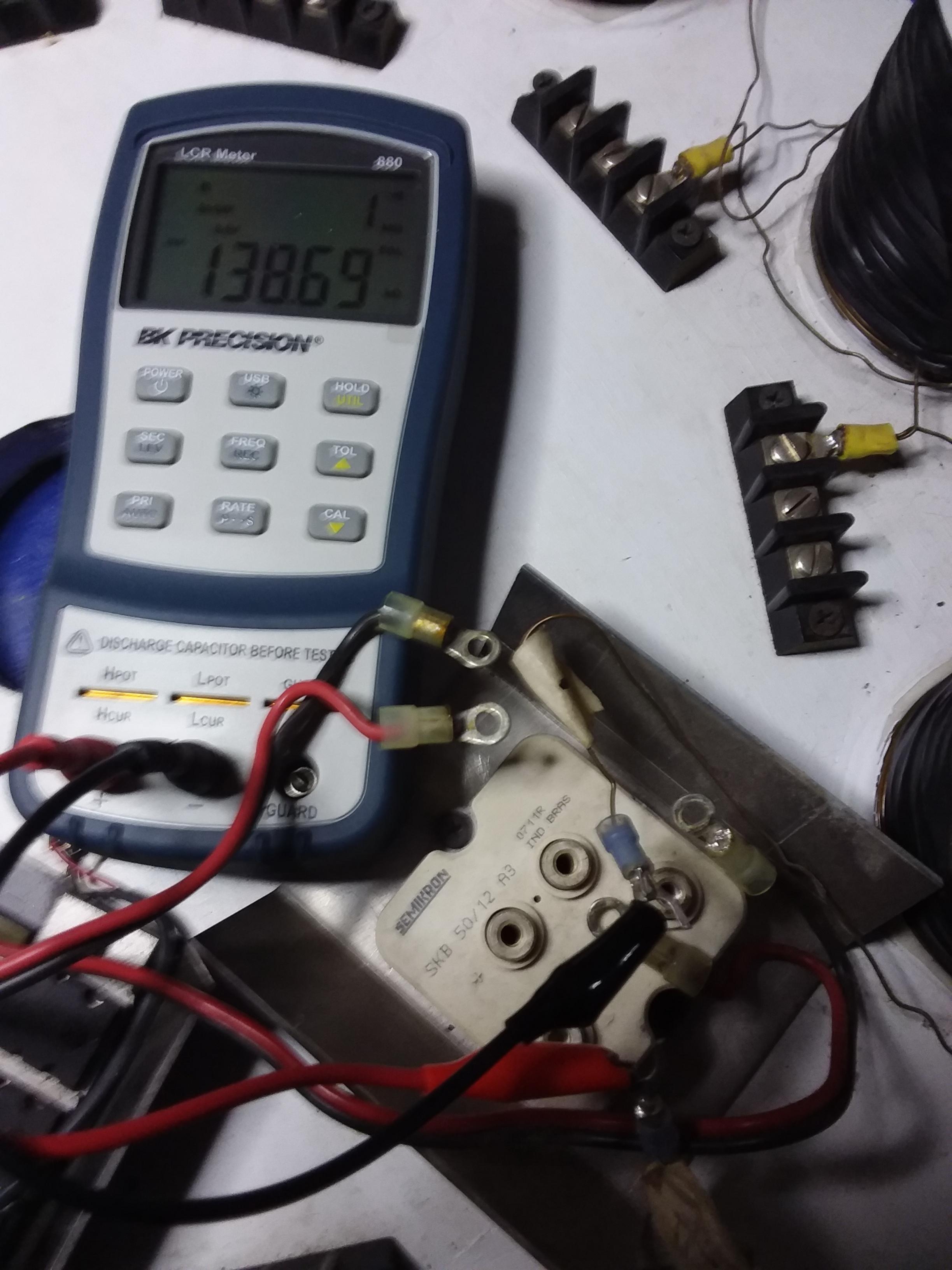

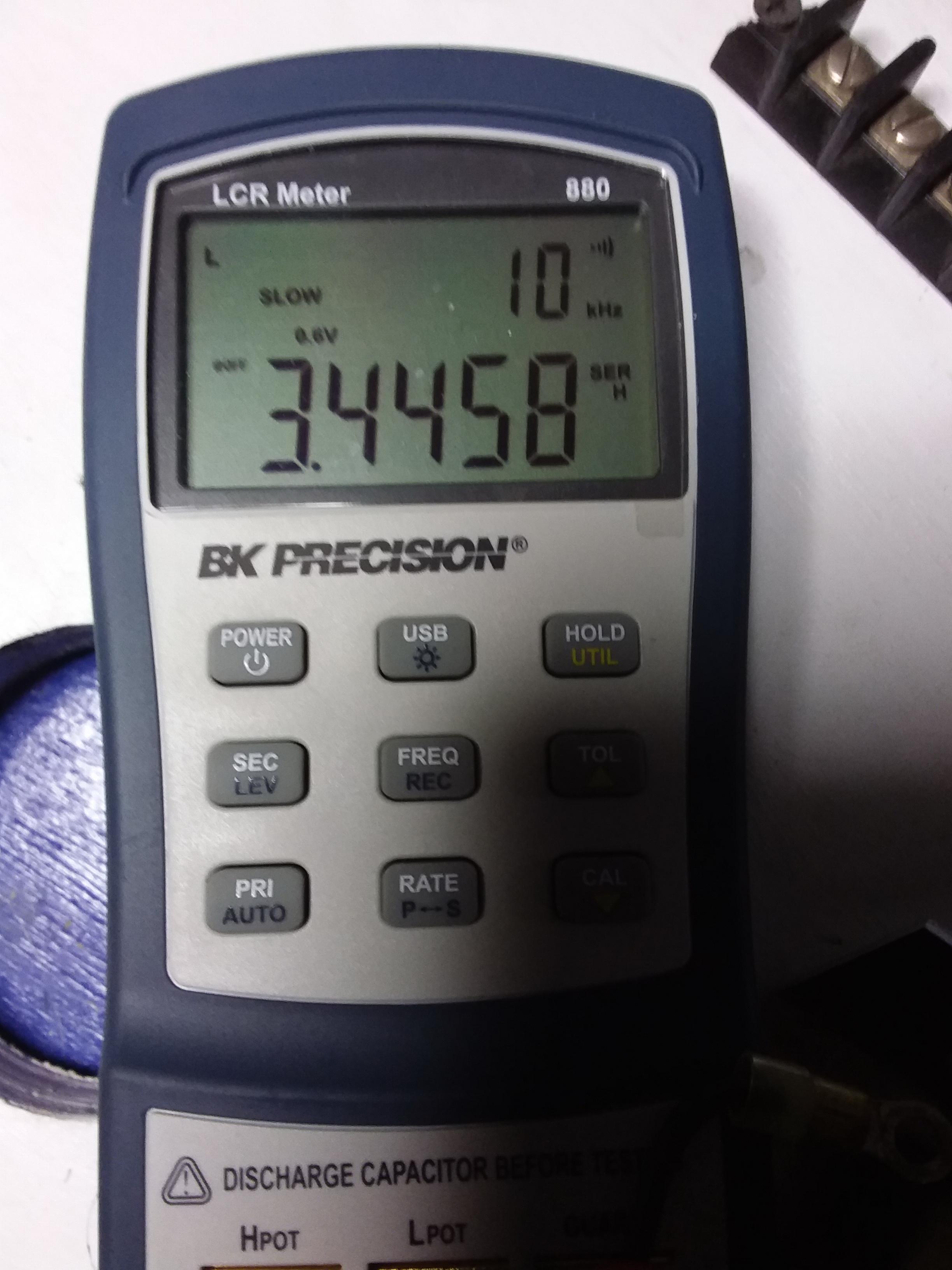

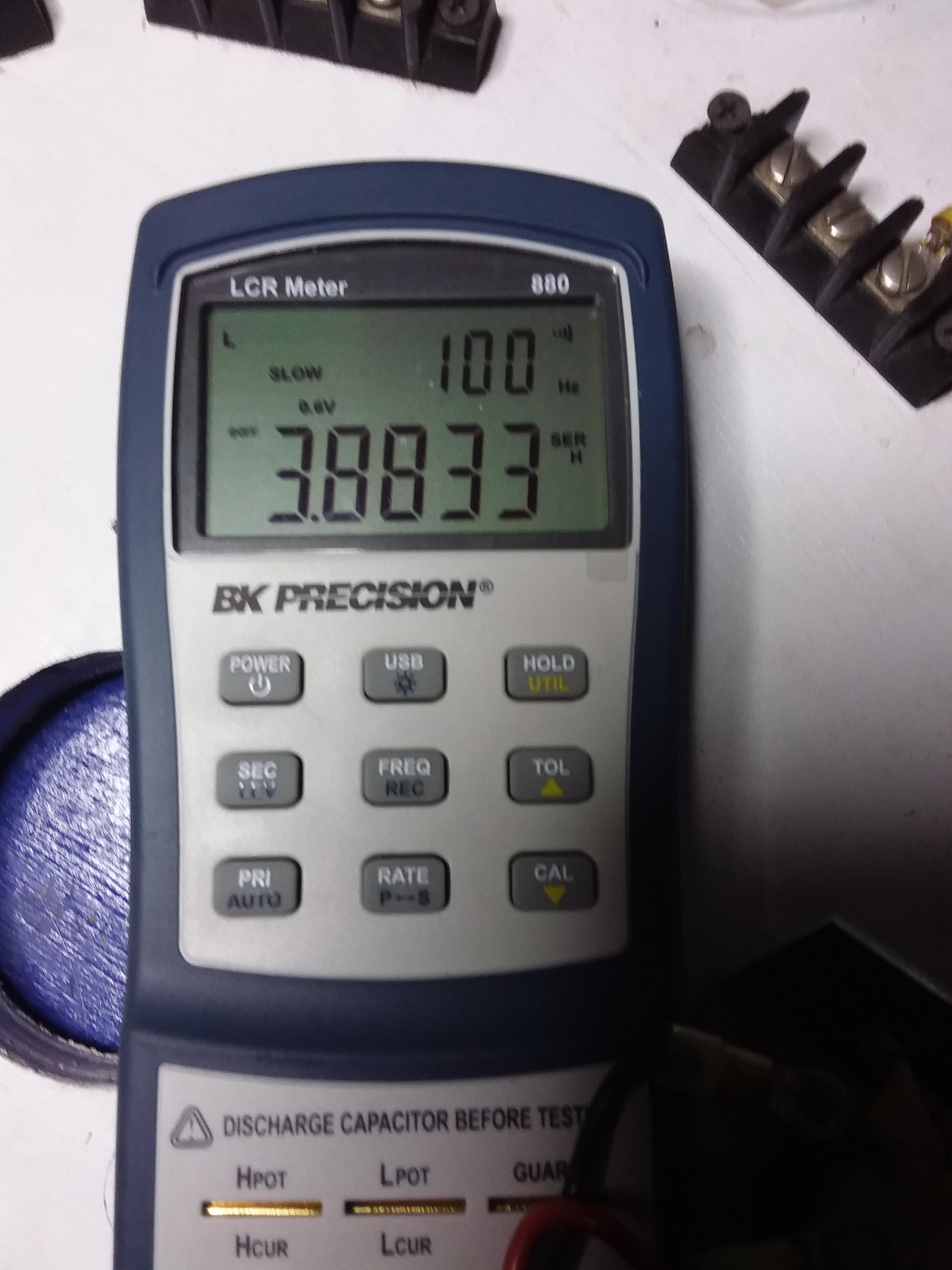

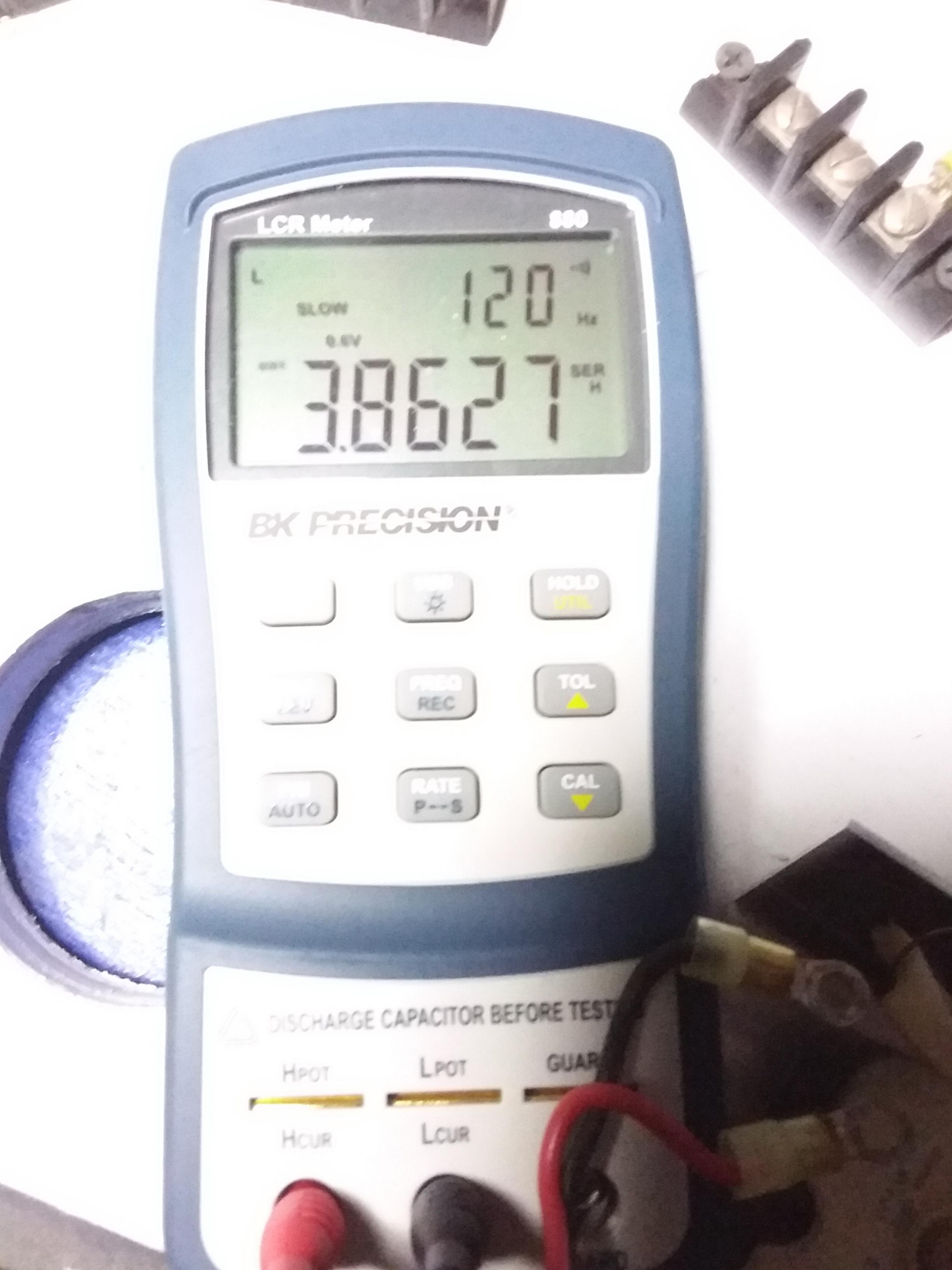

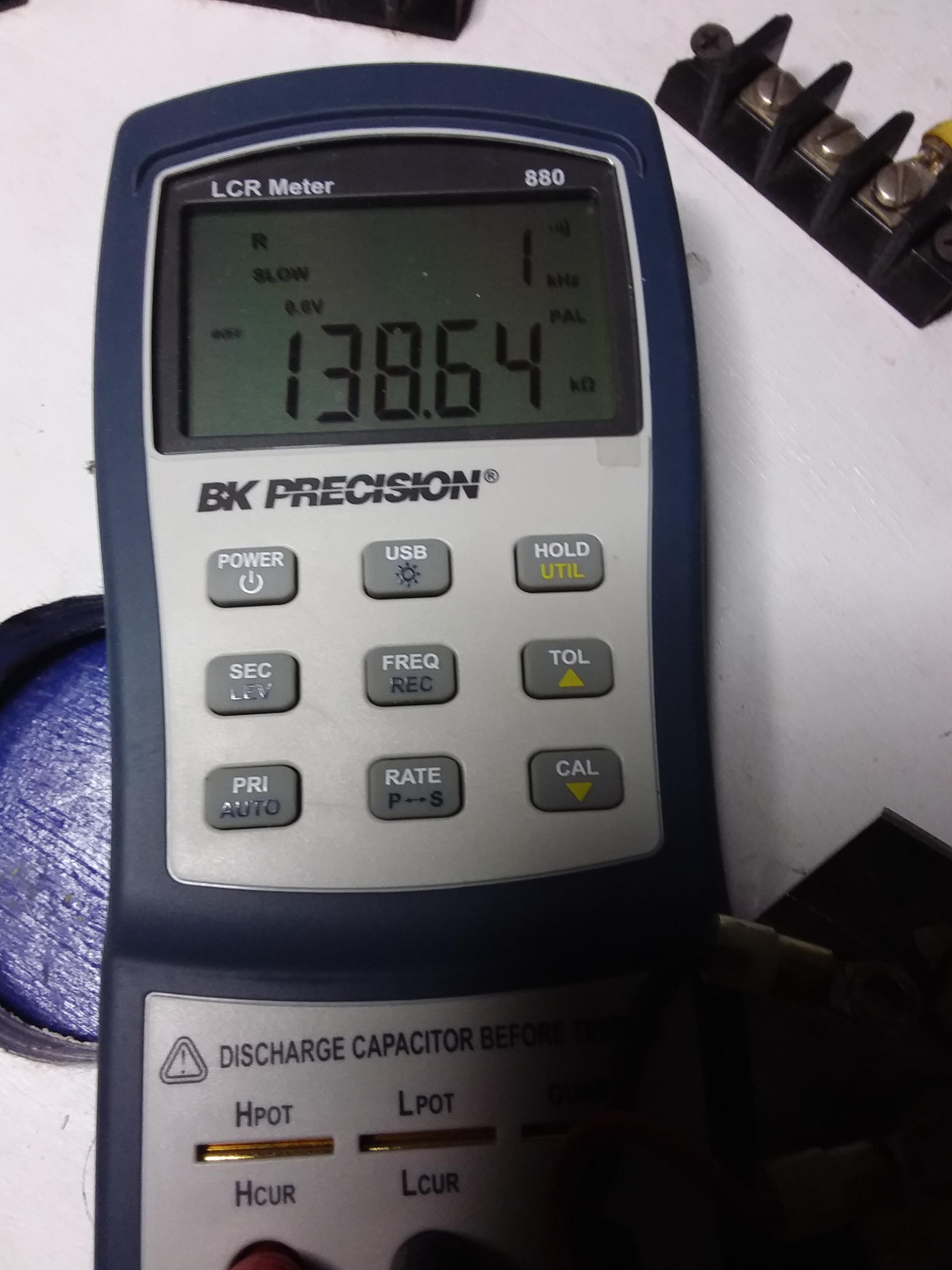

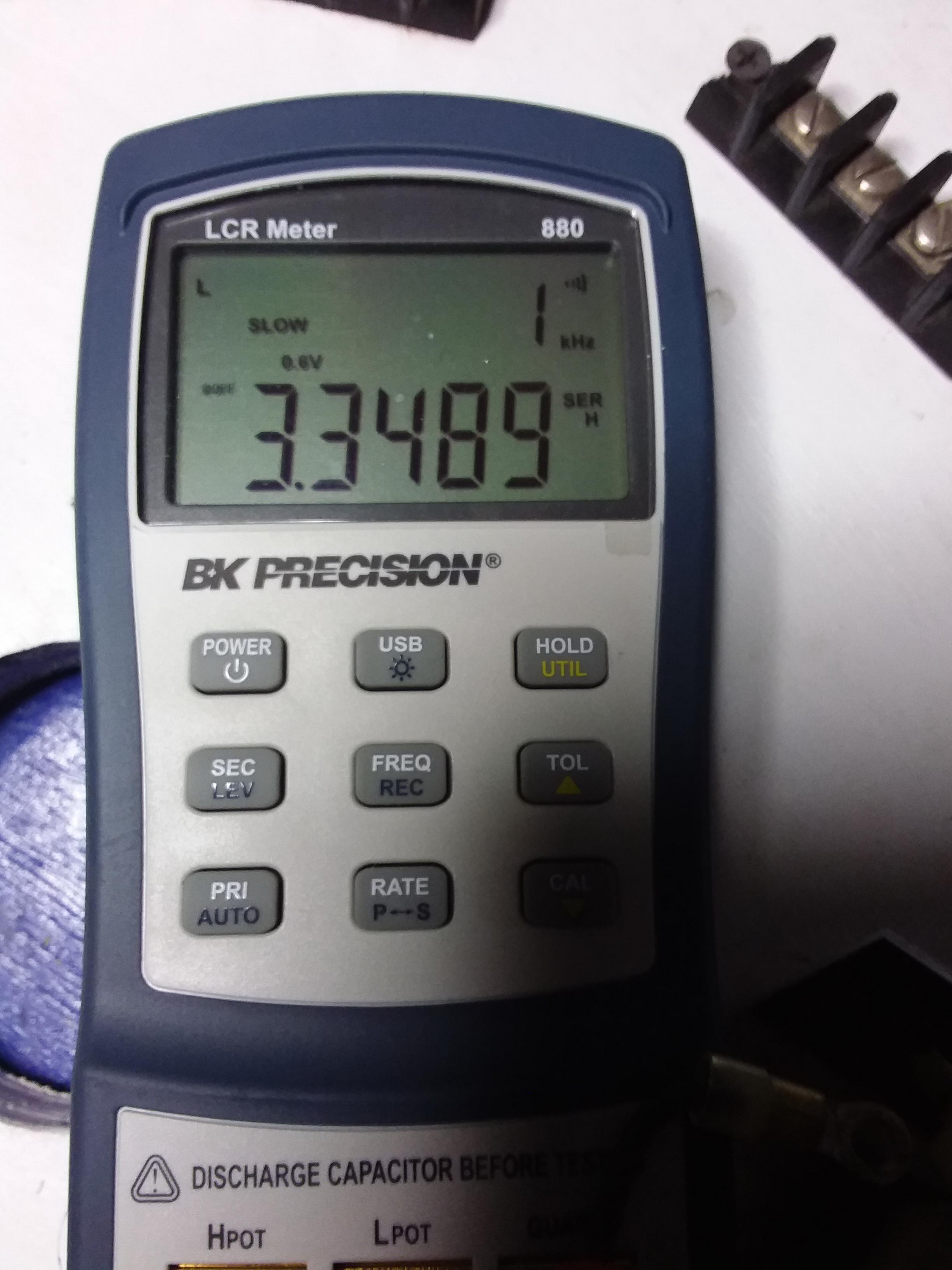

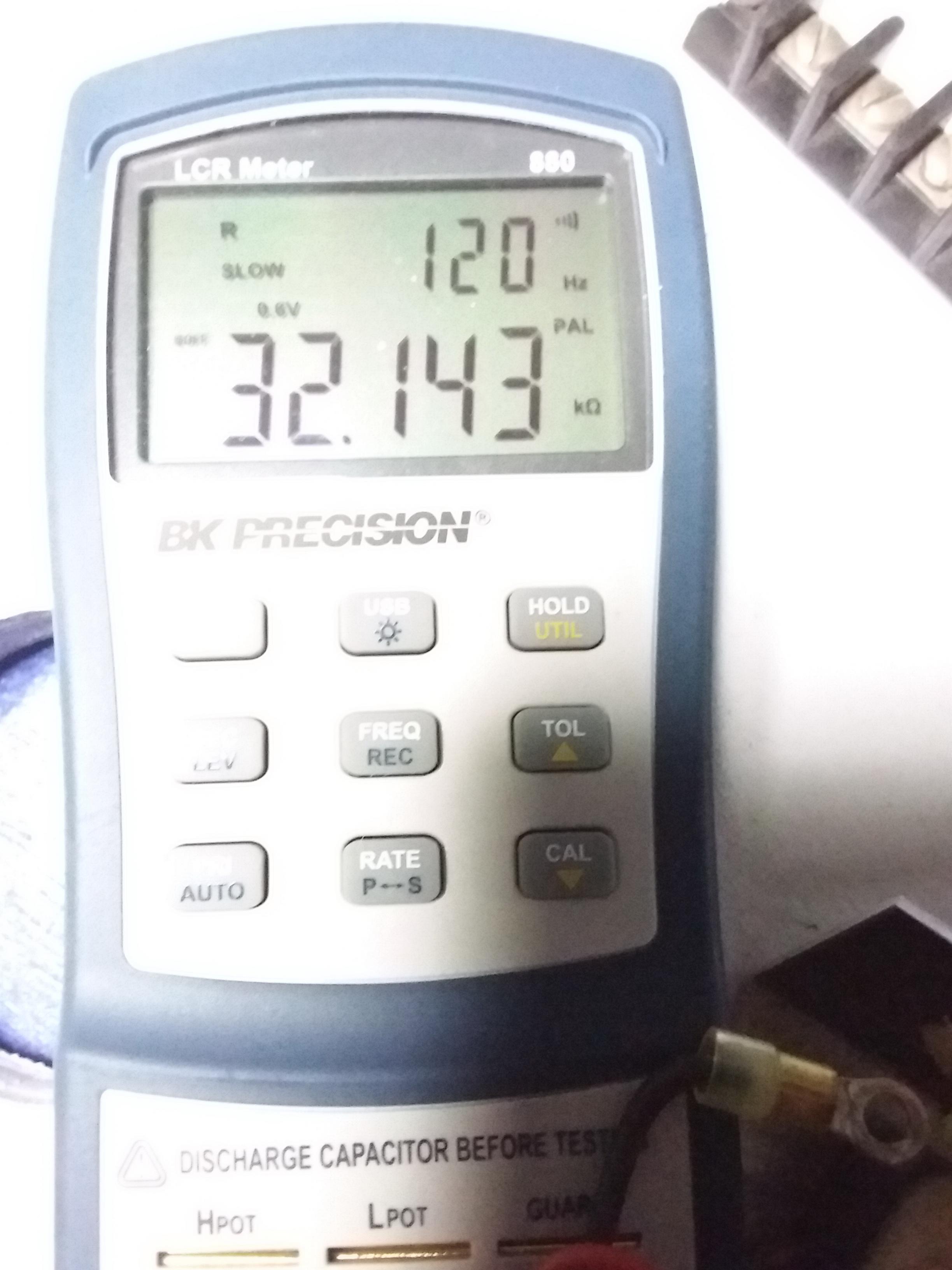

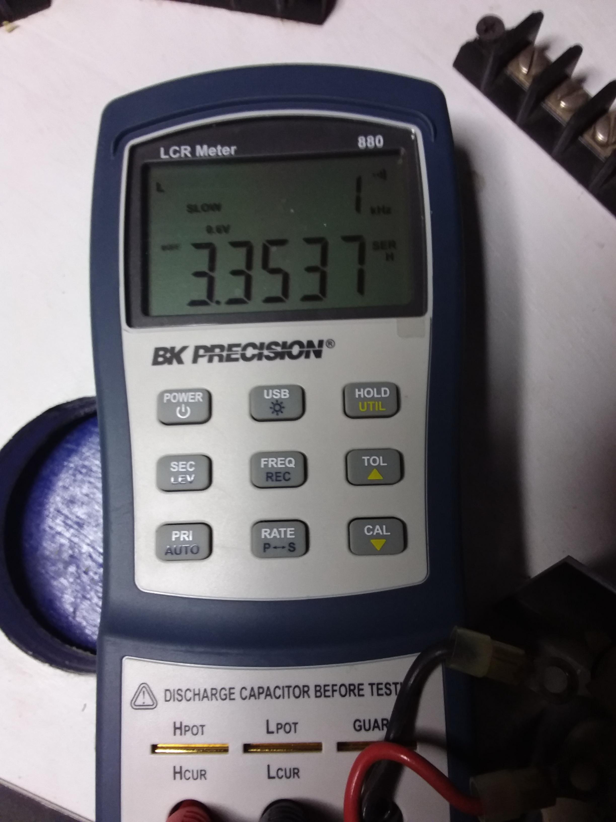

              Here are Pics of the new LCR meter measurements i took tonight on the FW Hub Motor Coils...
              there are 10 coils connected in series on the hub motor
              Still trying to get the hang of this meter...
              you should be able to see what is being measured by the upper left hand L- R- C symbol, and the Frequency that it is being measured at in the upper right hand corner, and the value measured in the lower right

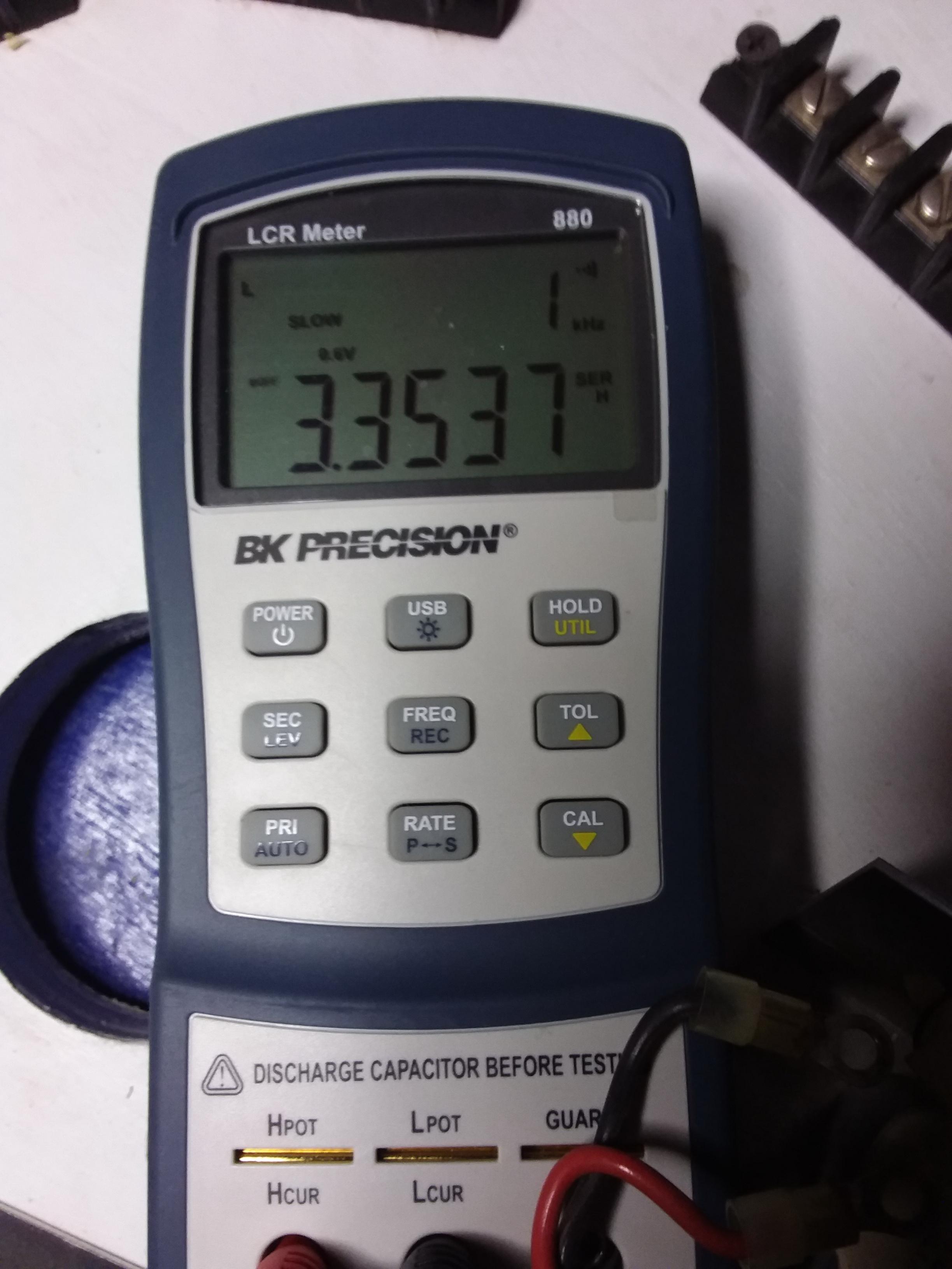

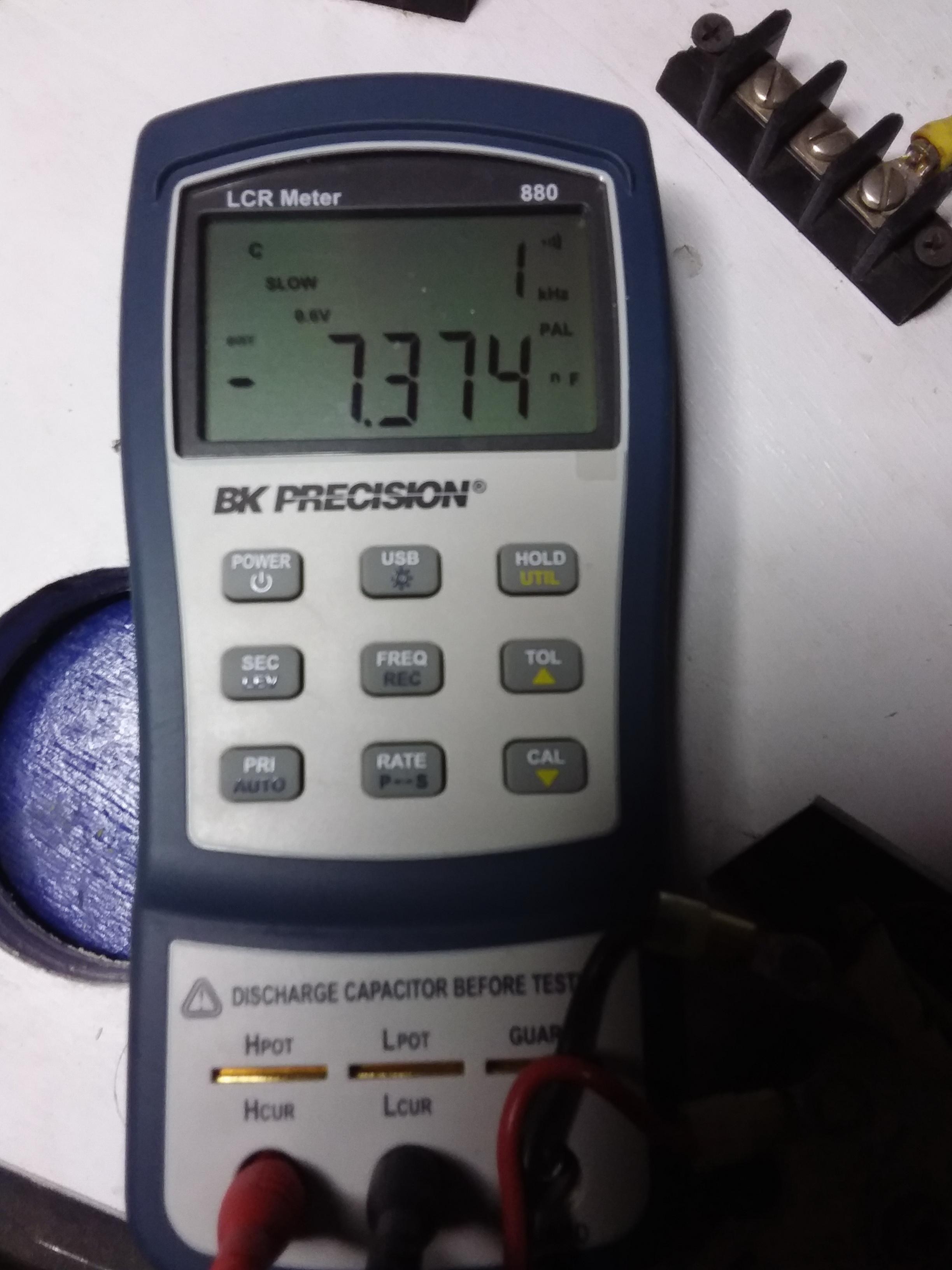

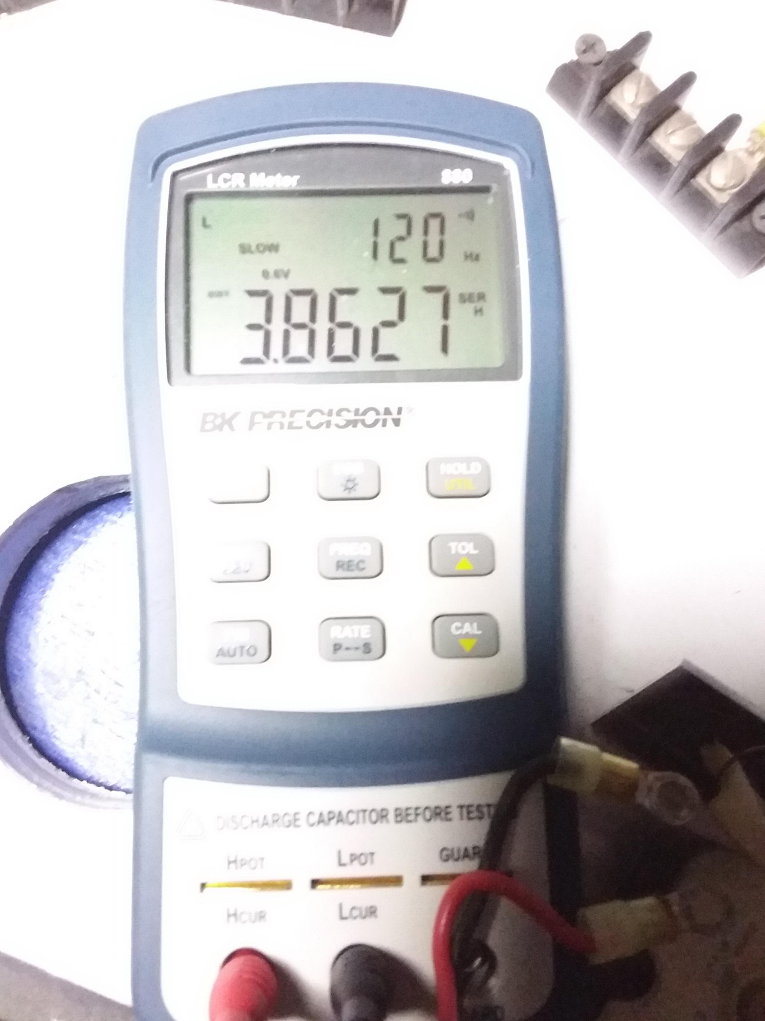

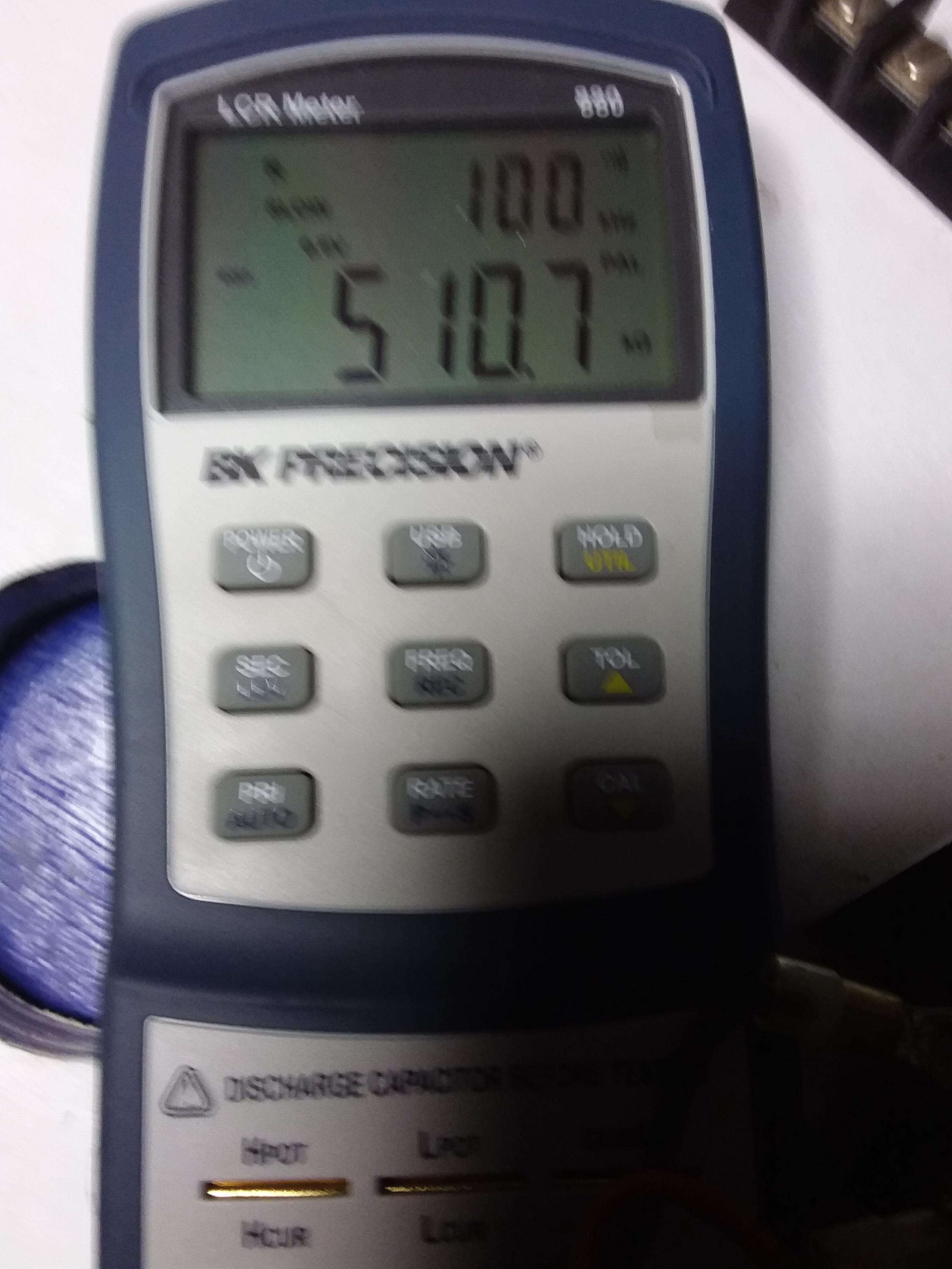

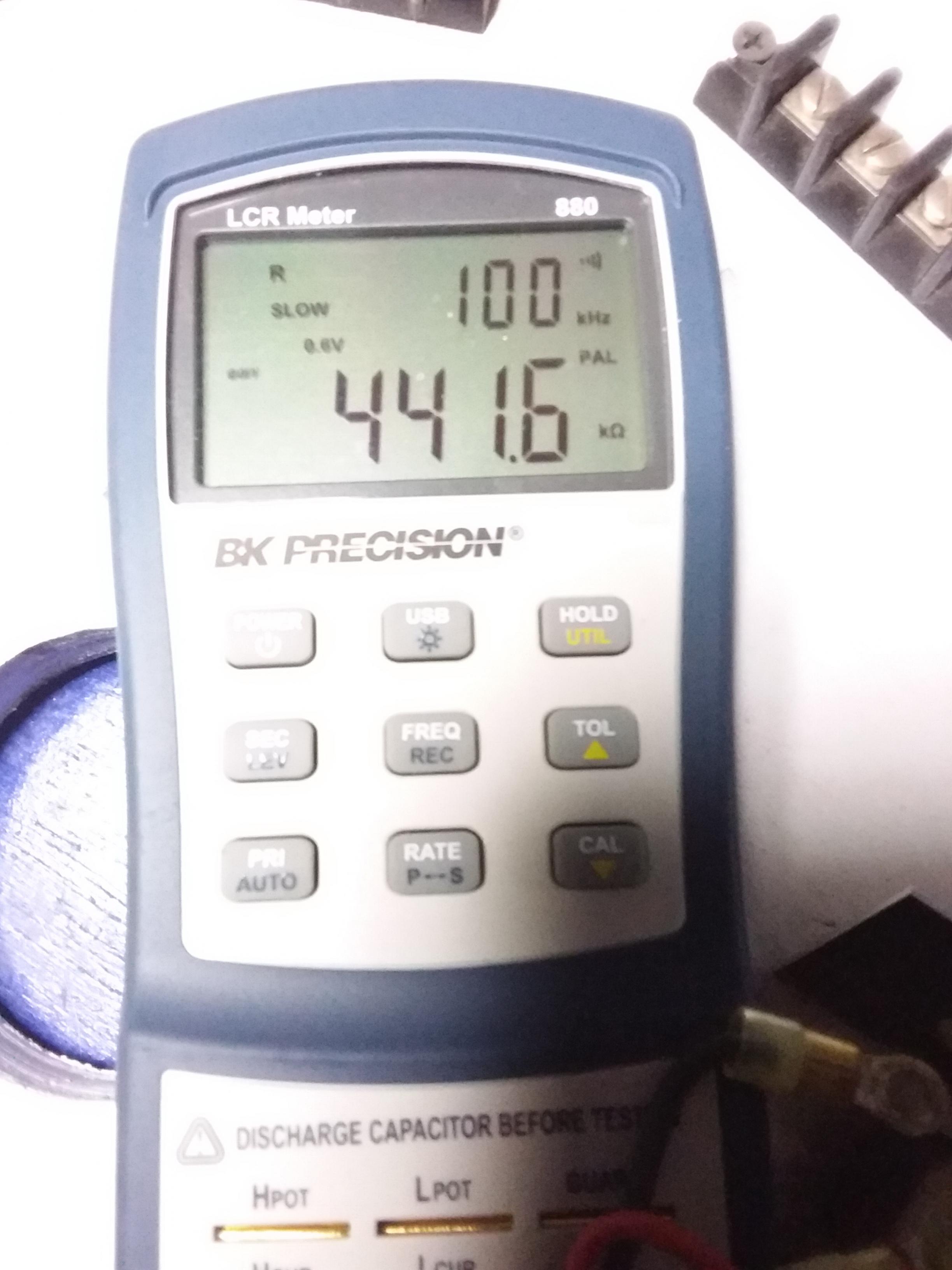

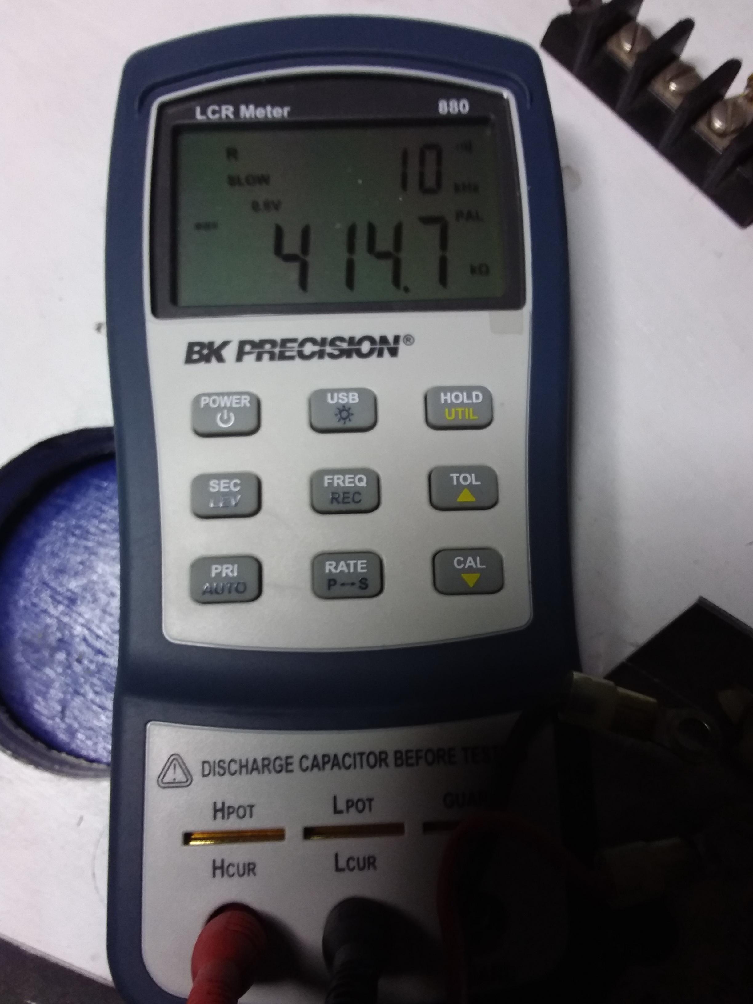

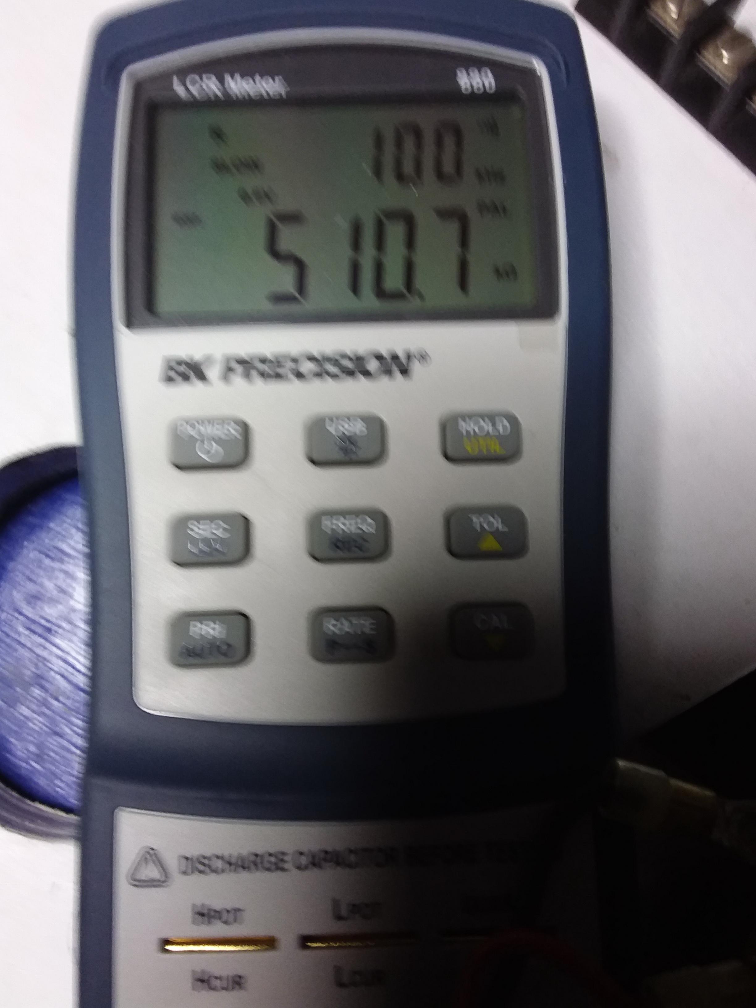

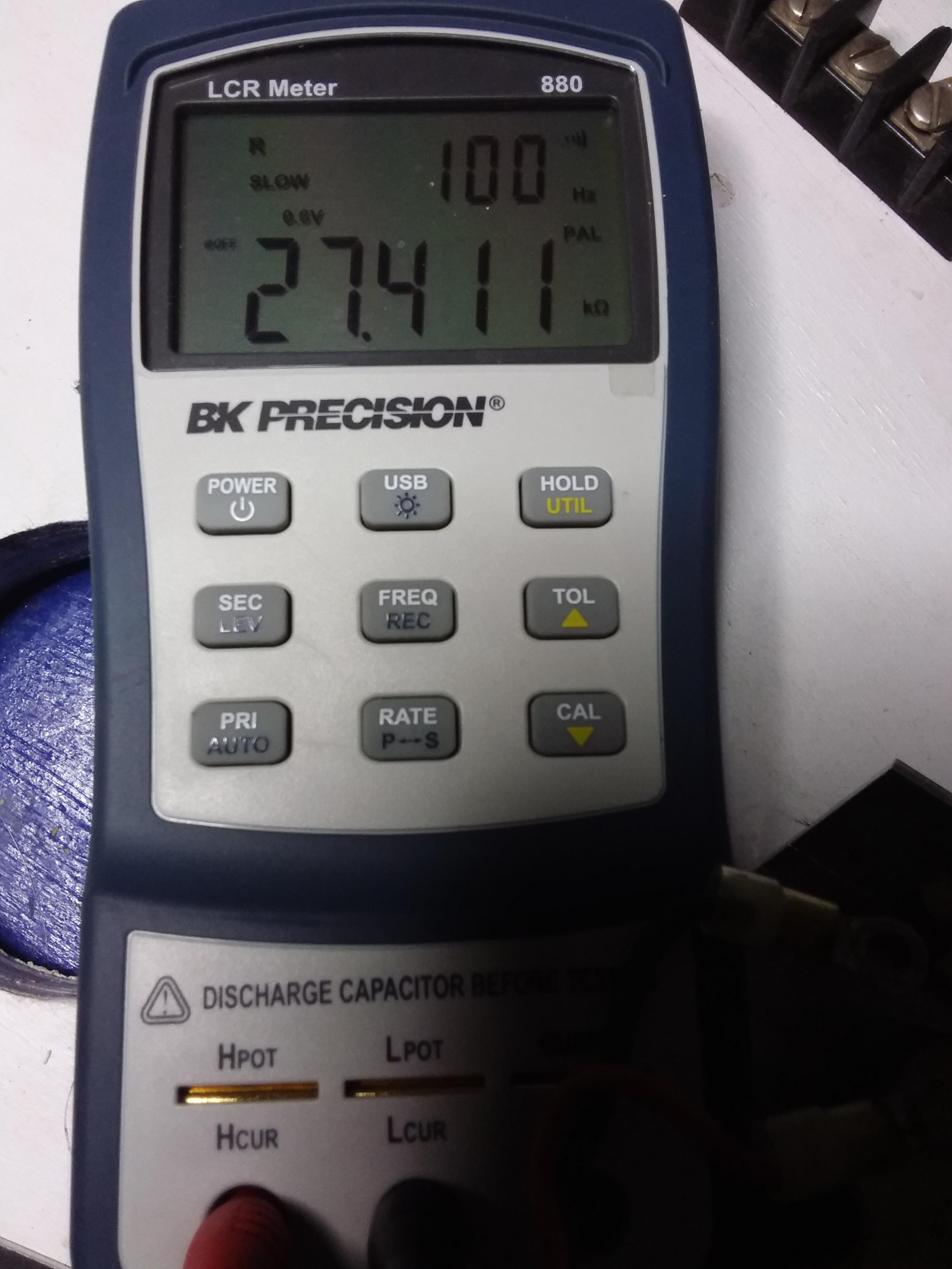

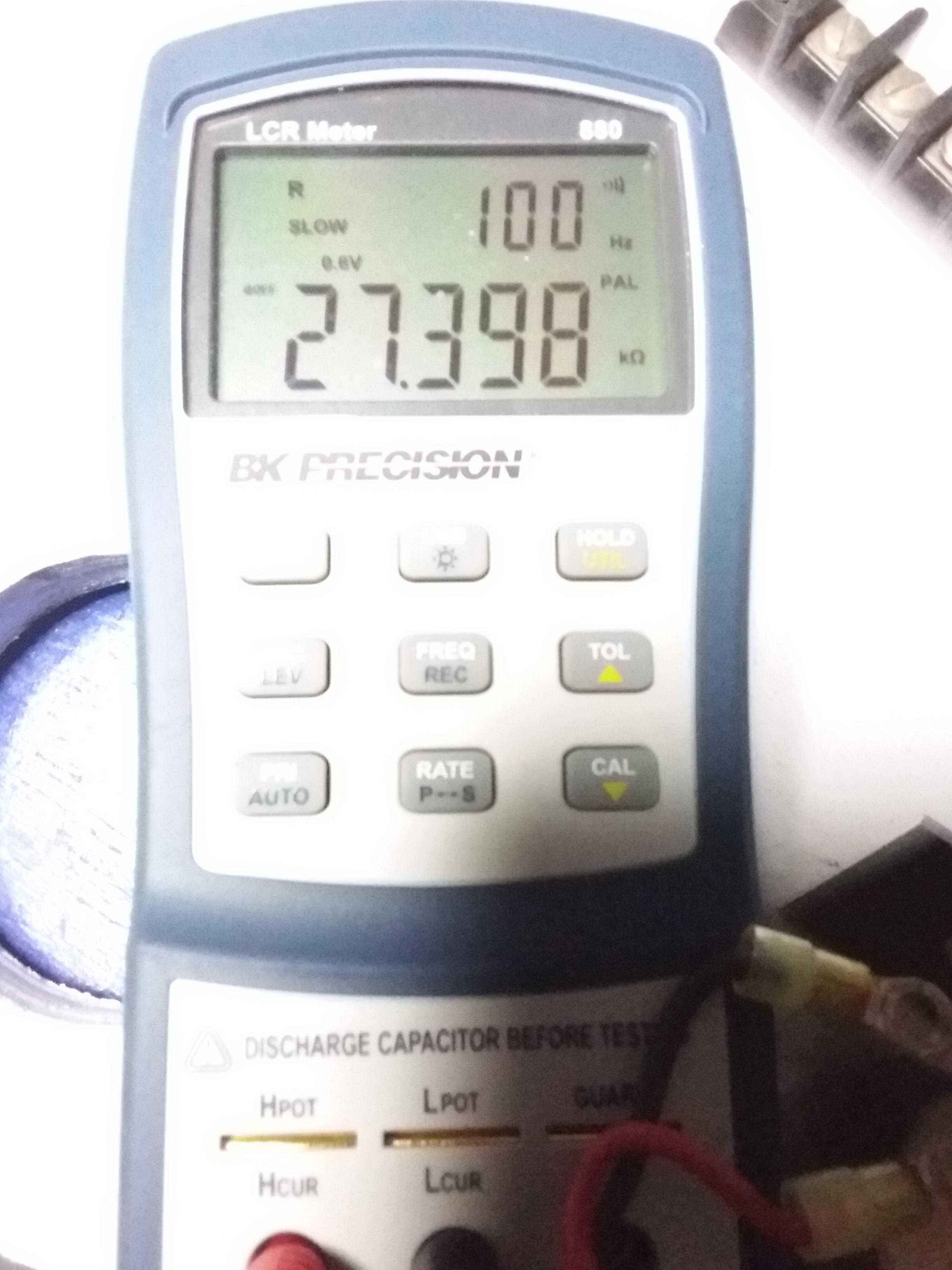

                Random LCR Meter pics.....
                • #23

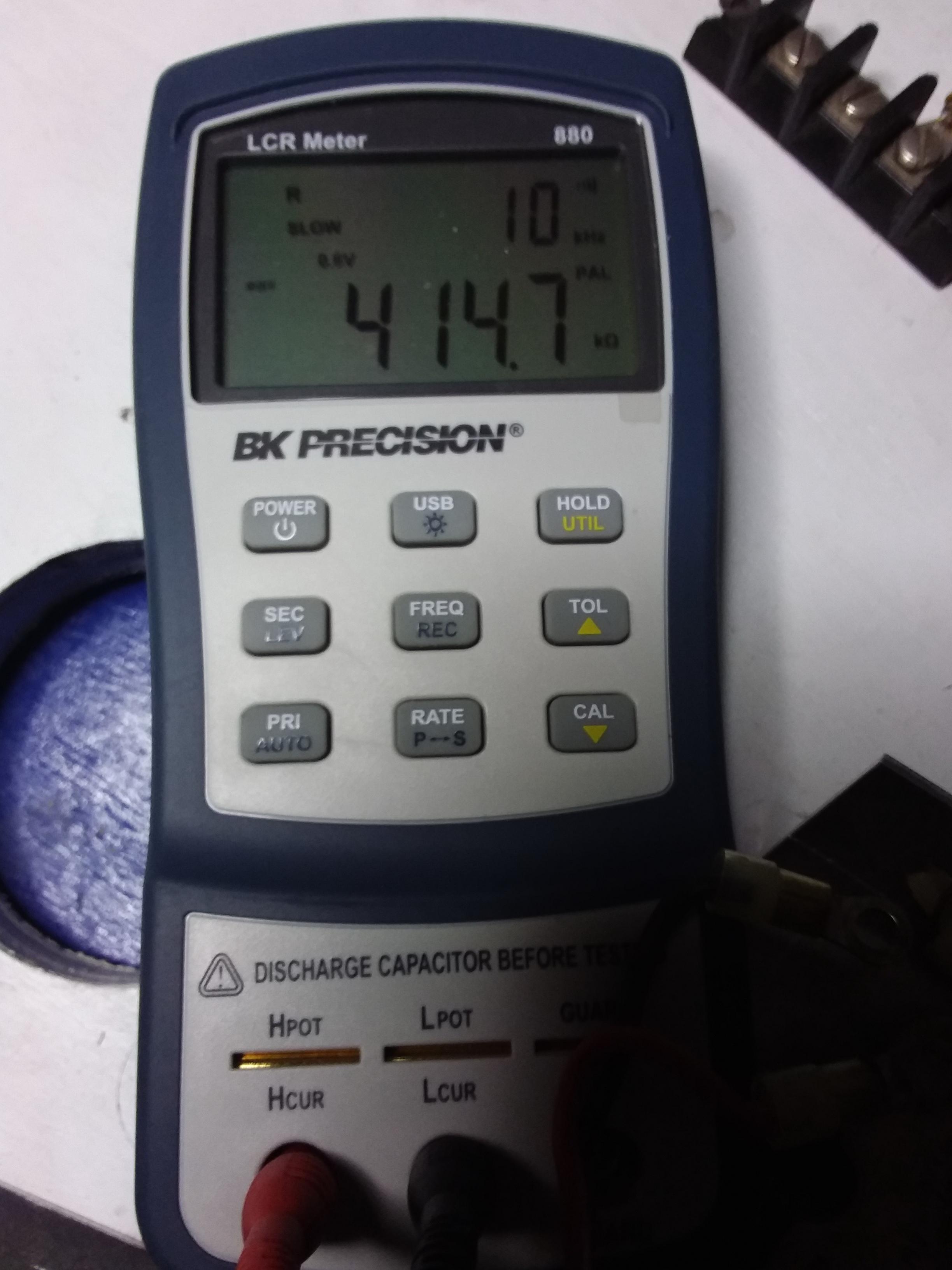

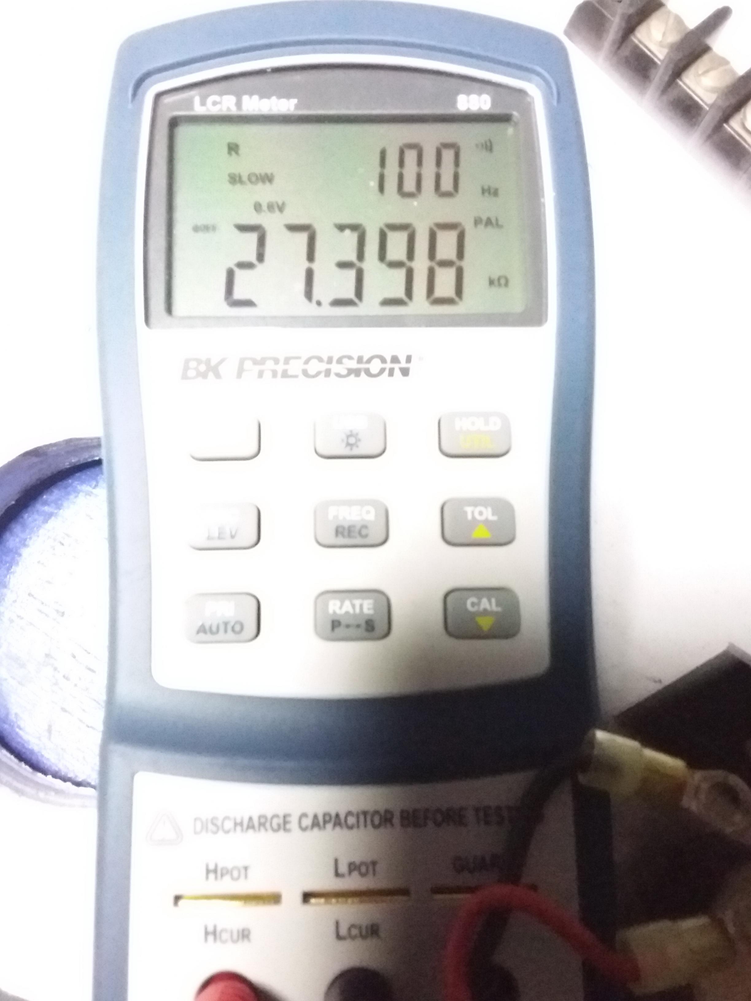

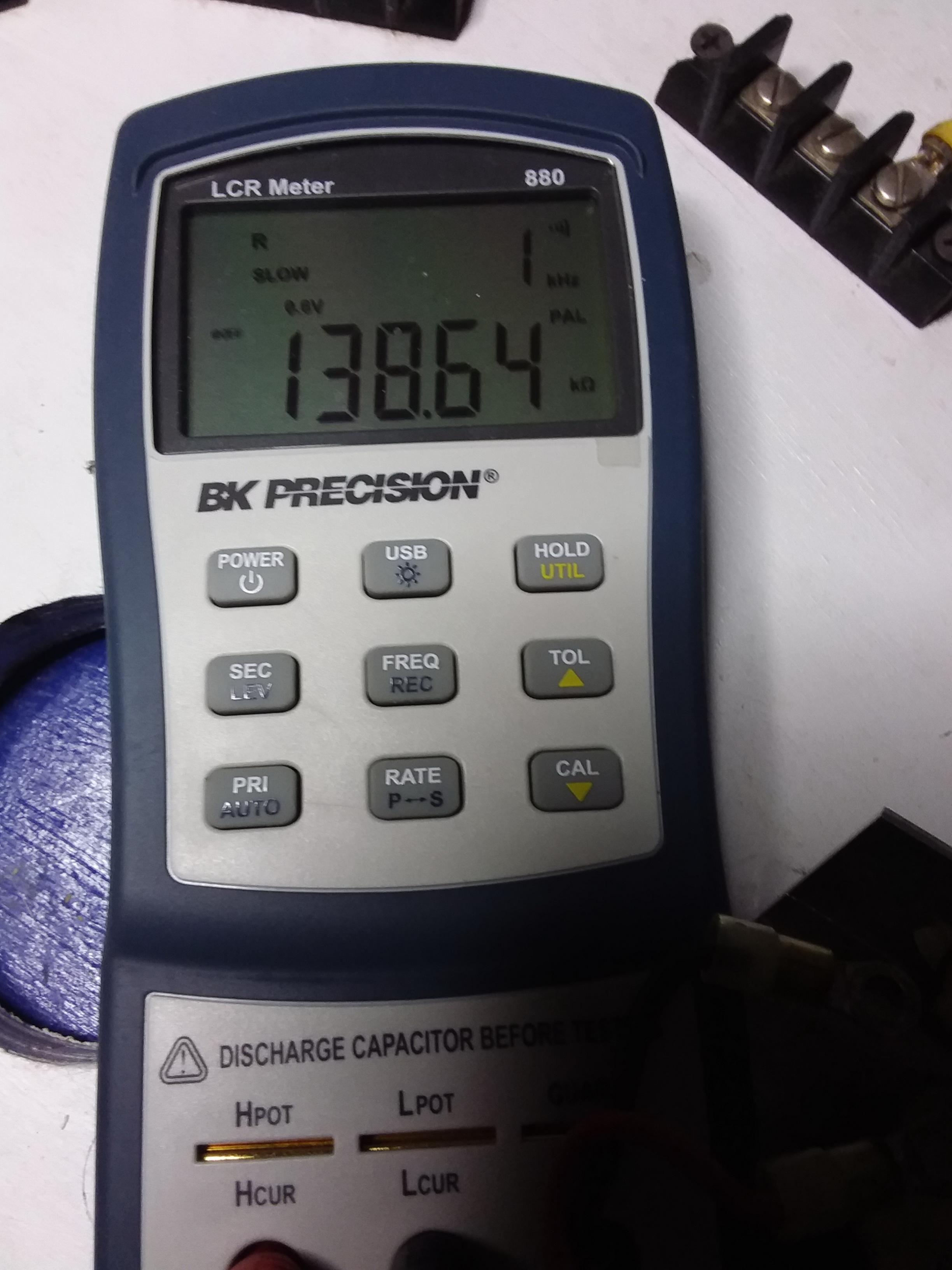

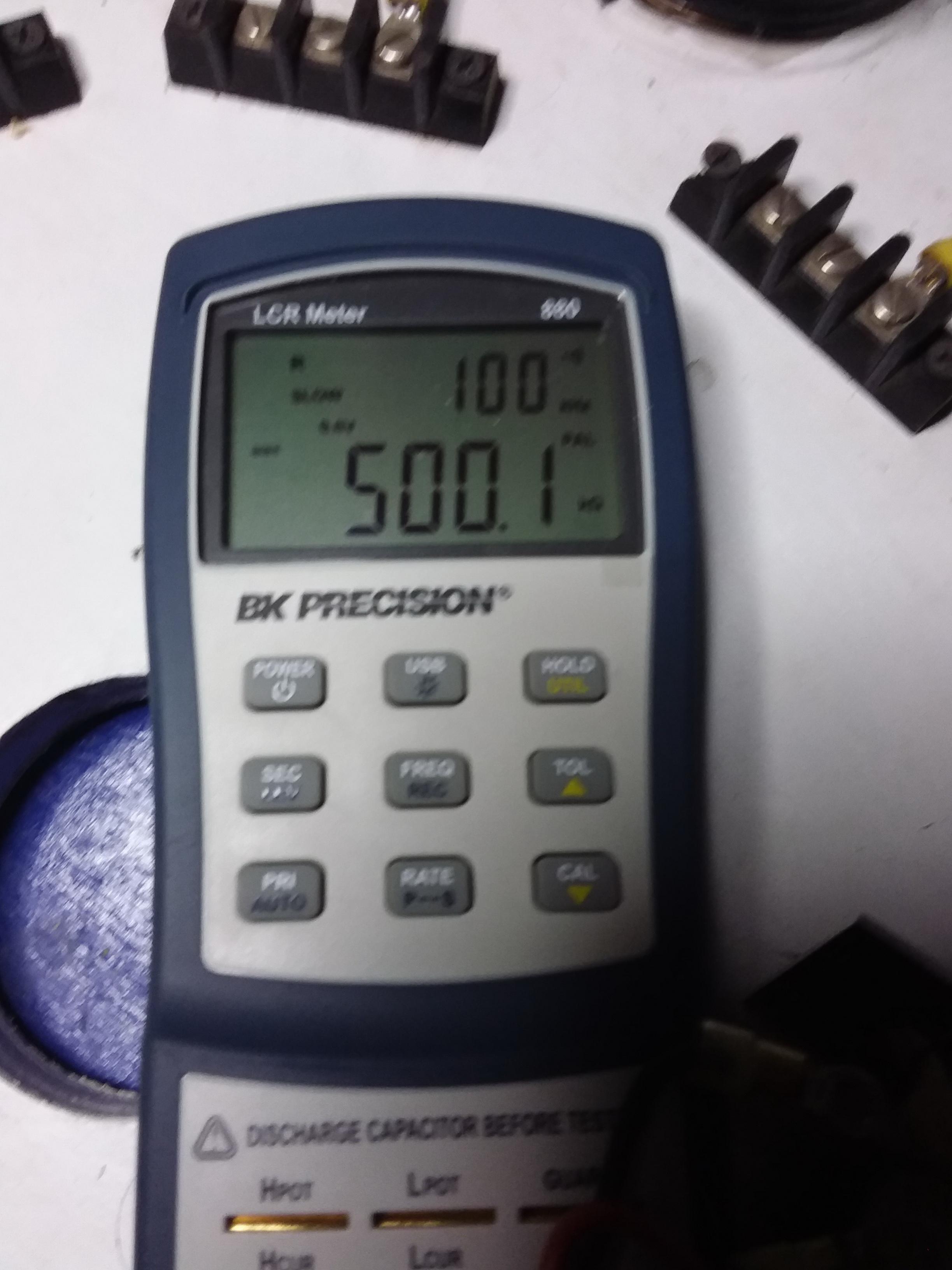

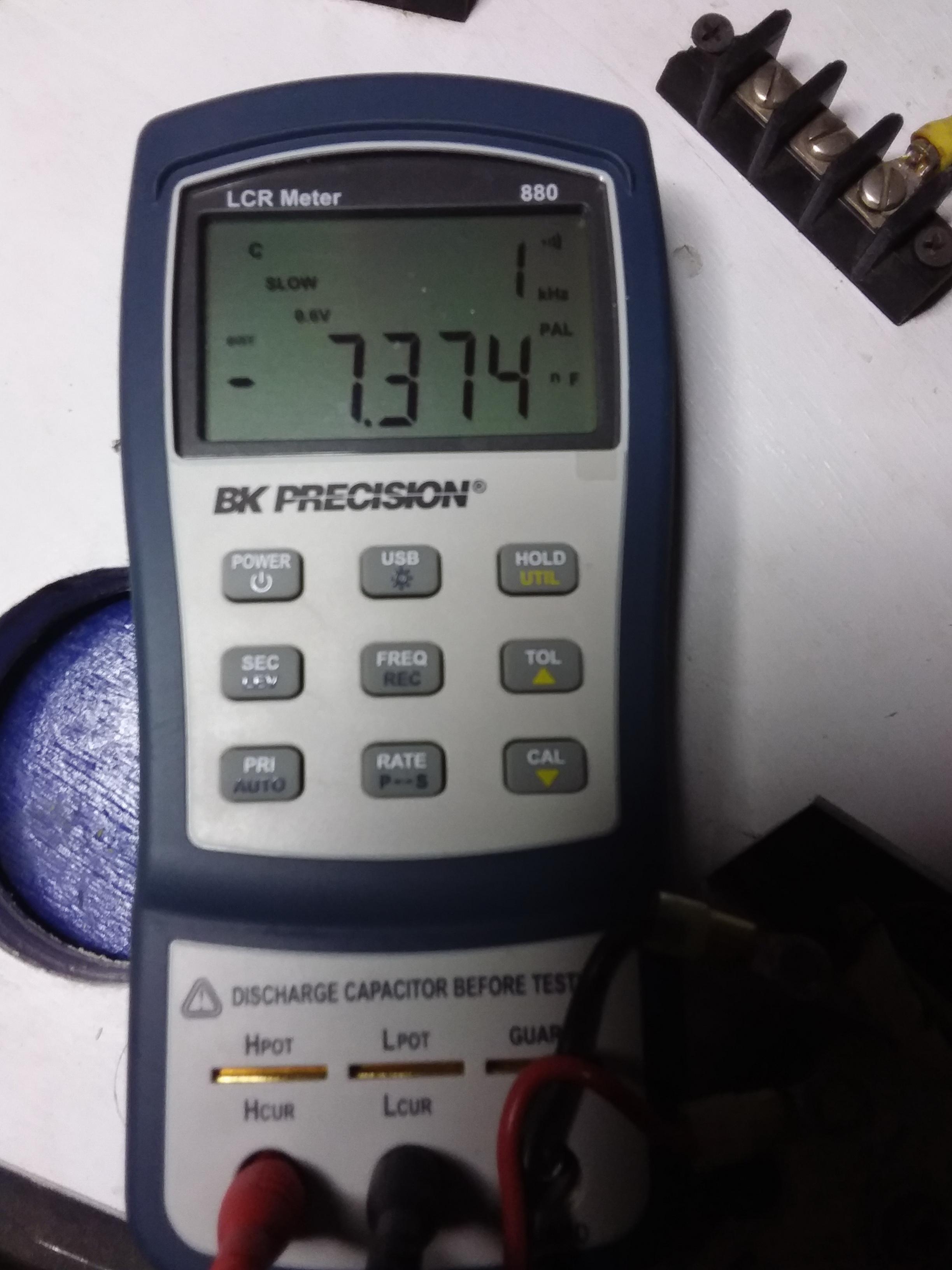

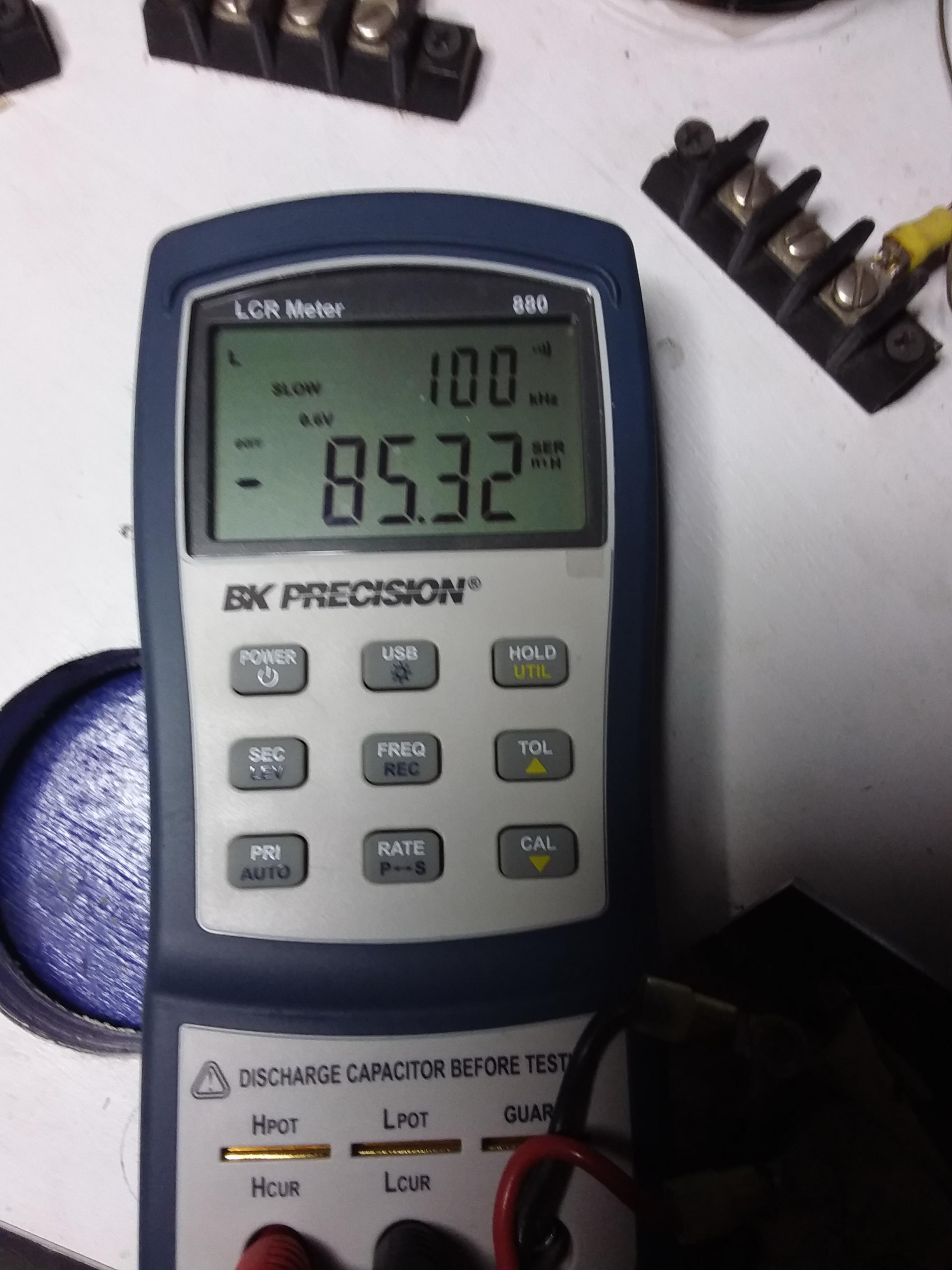

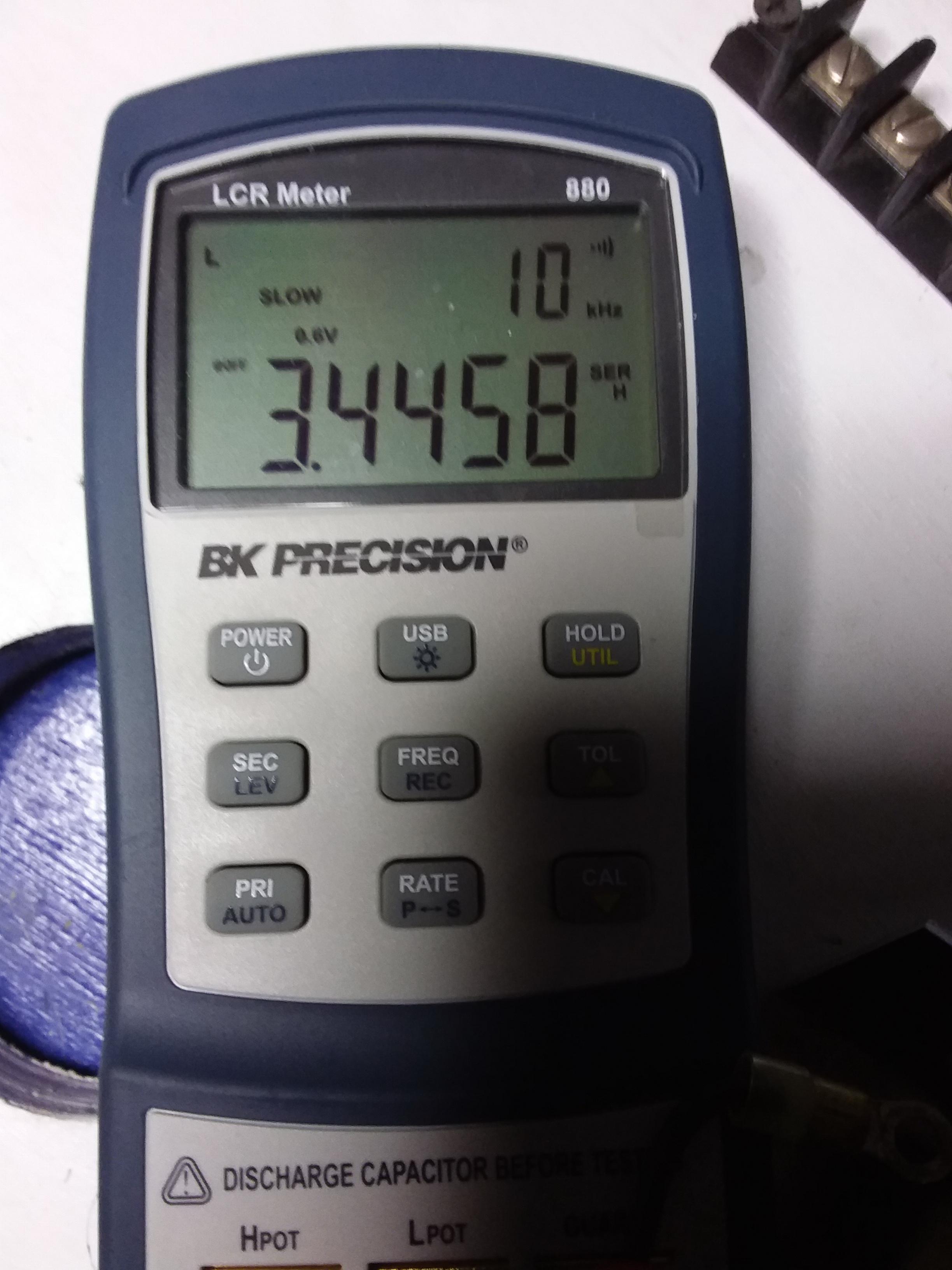

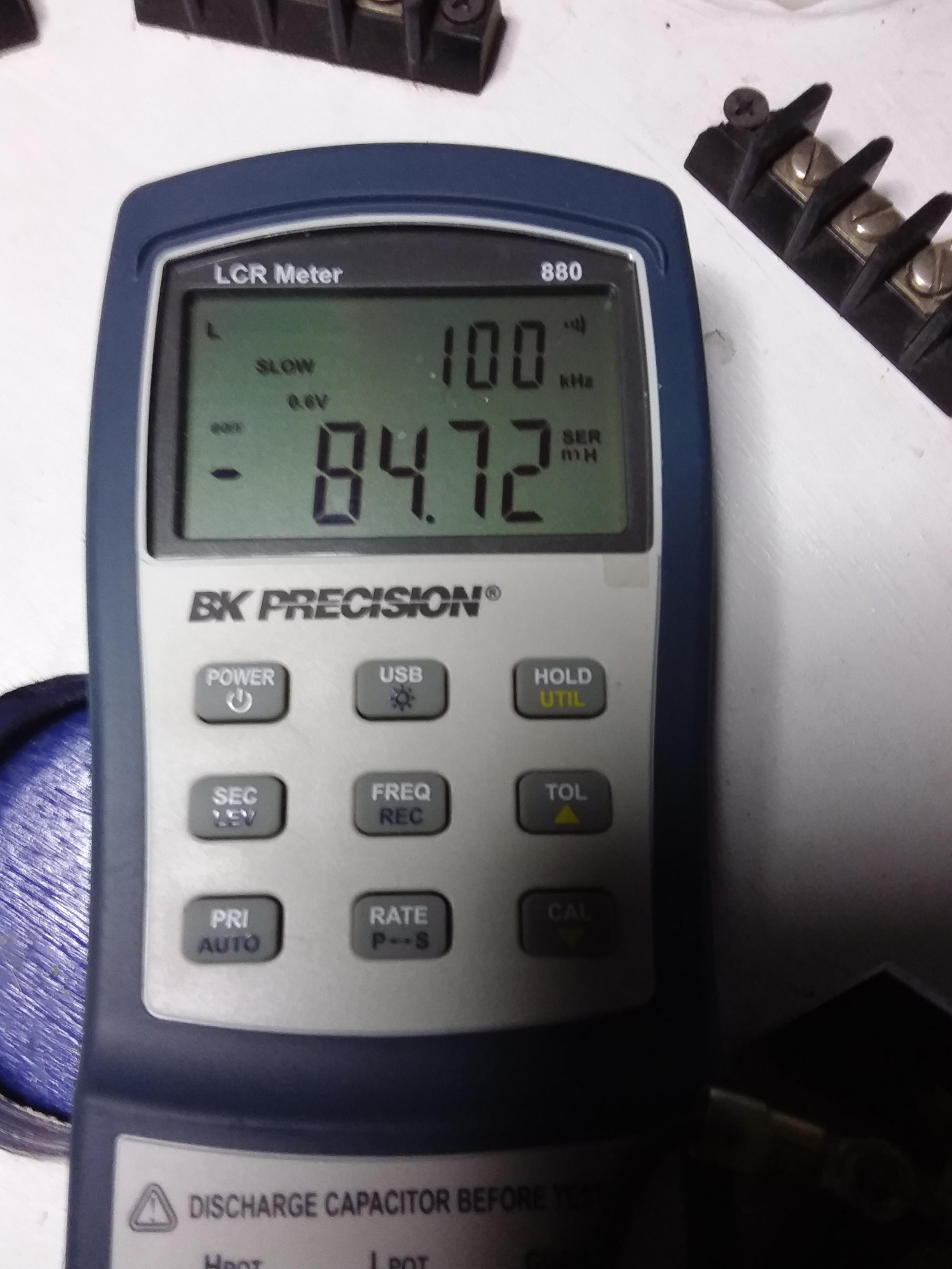

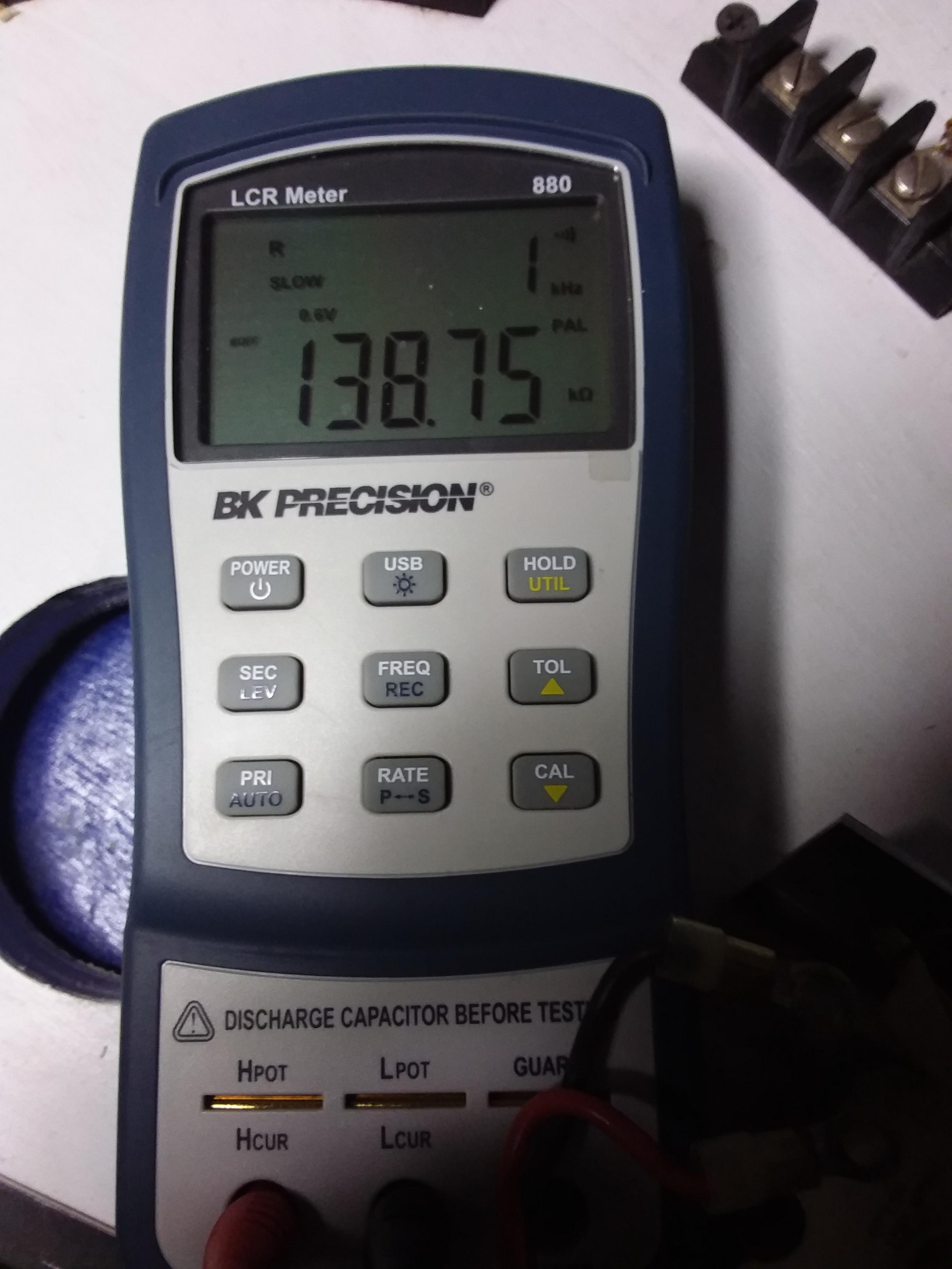

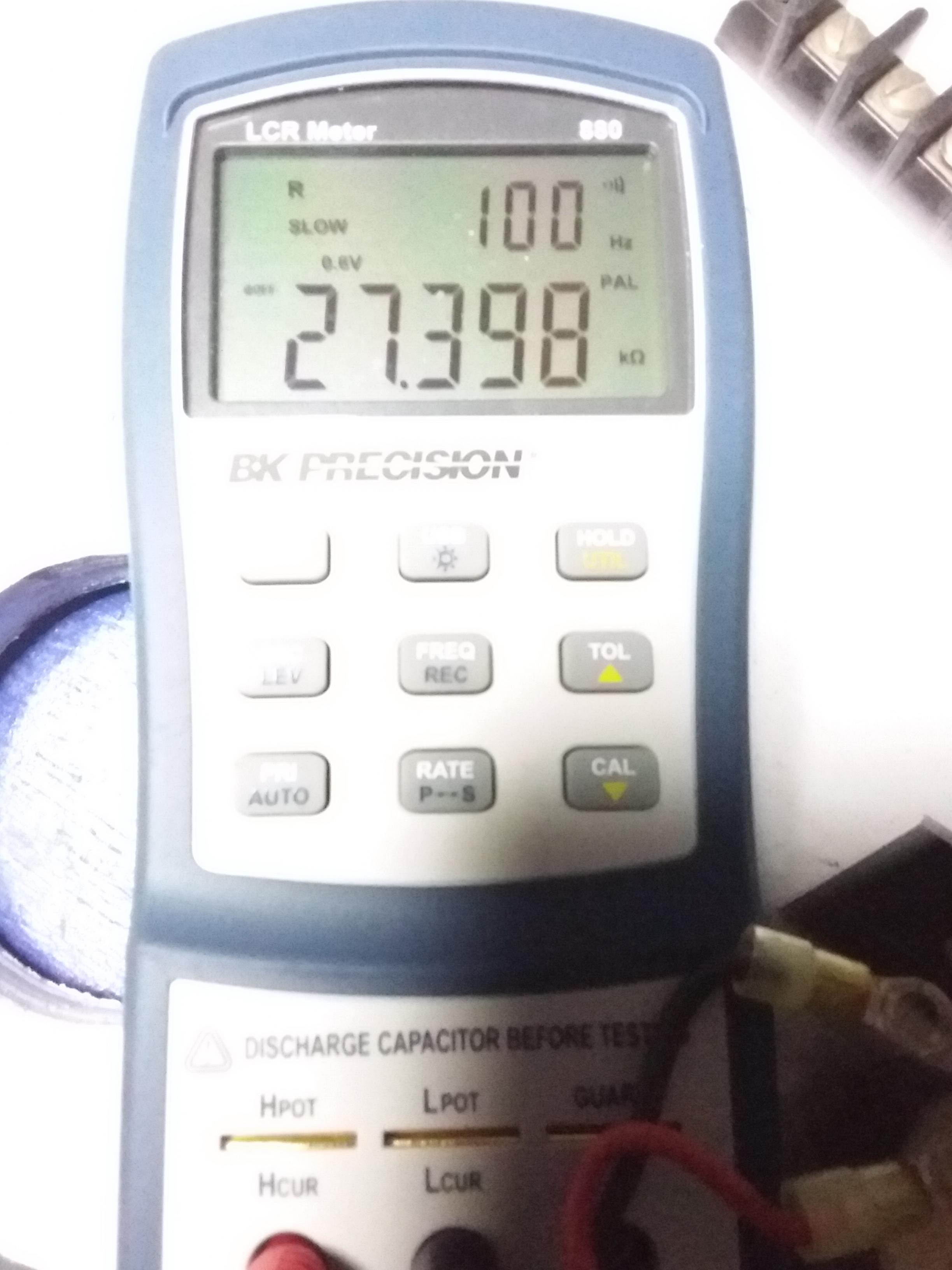

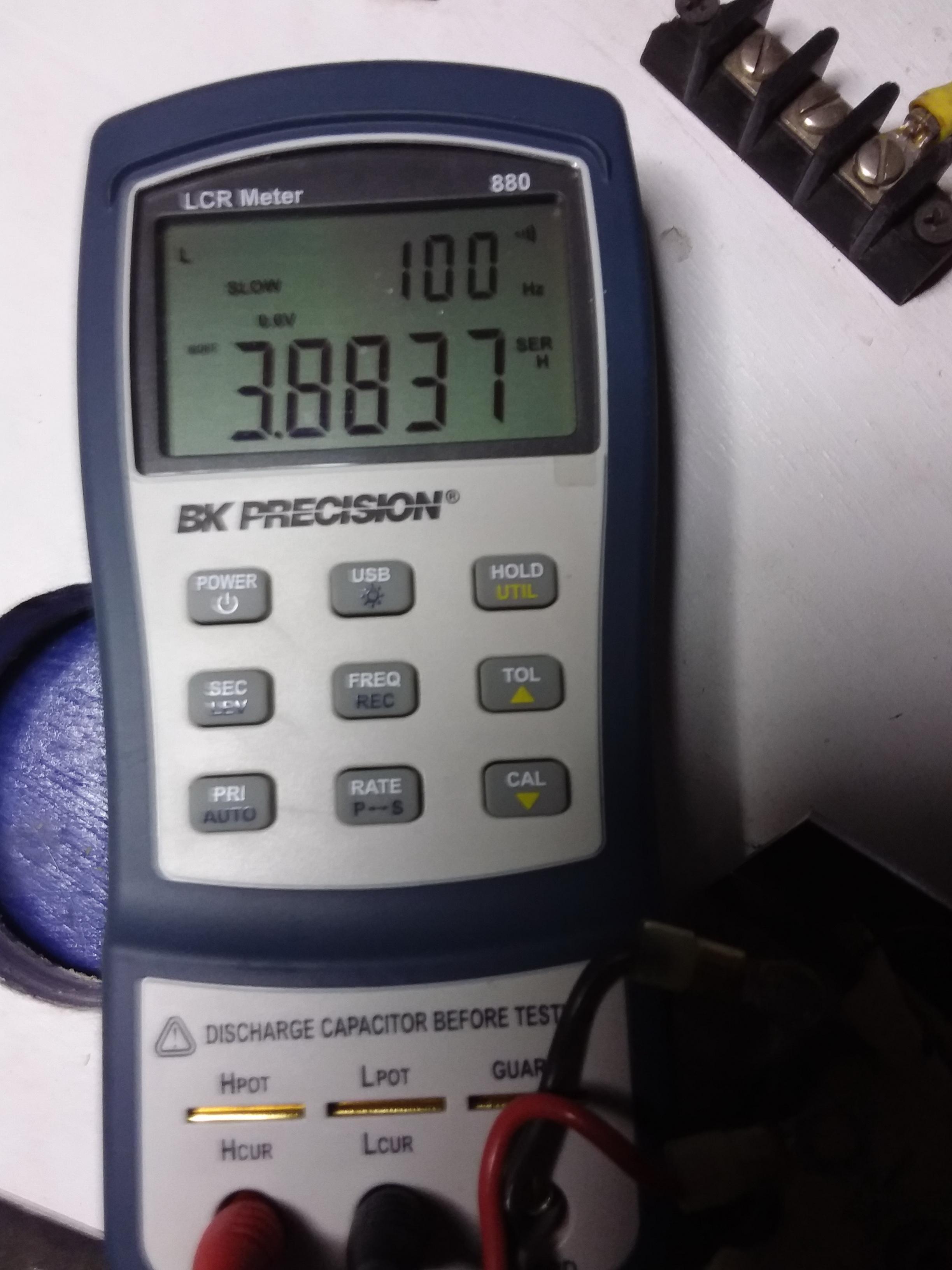

                  More random measurements
                  • #24

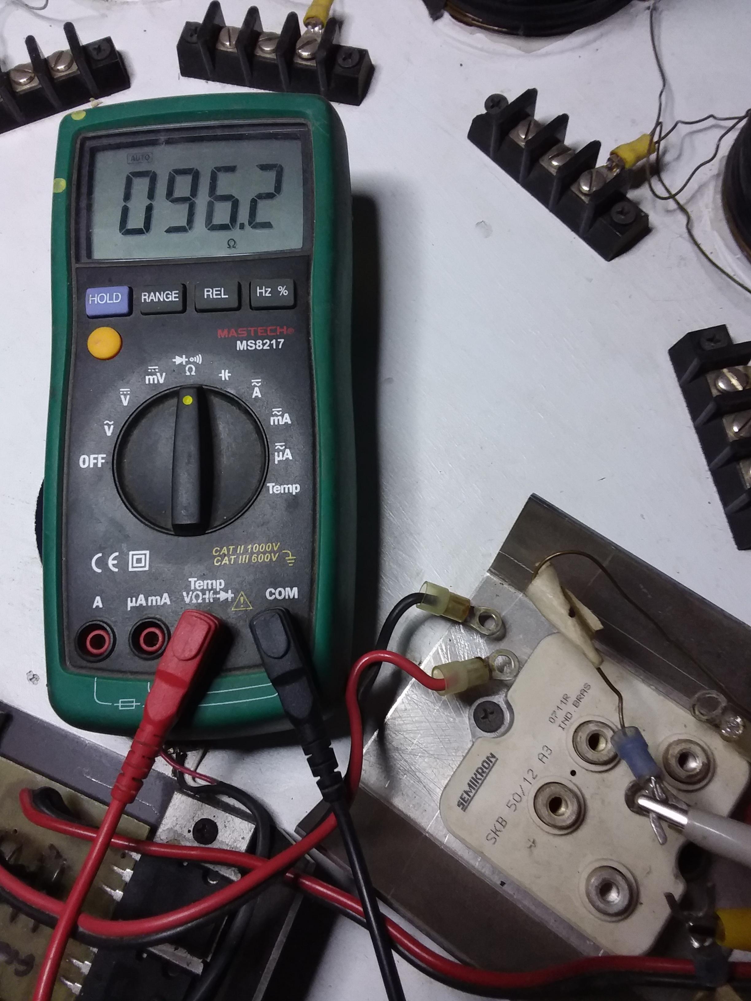

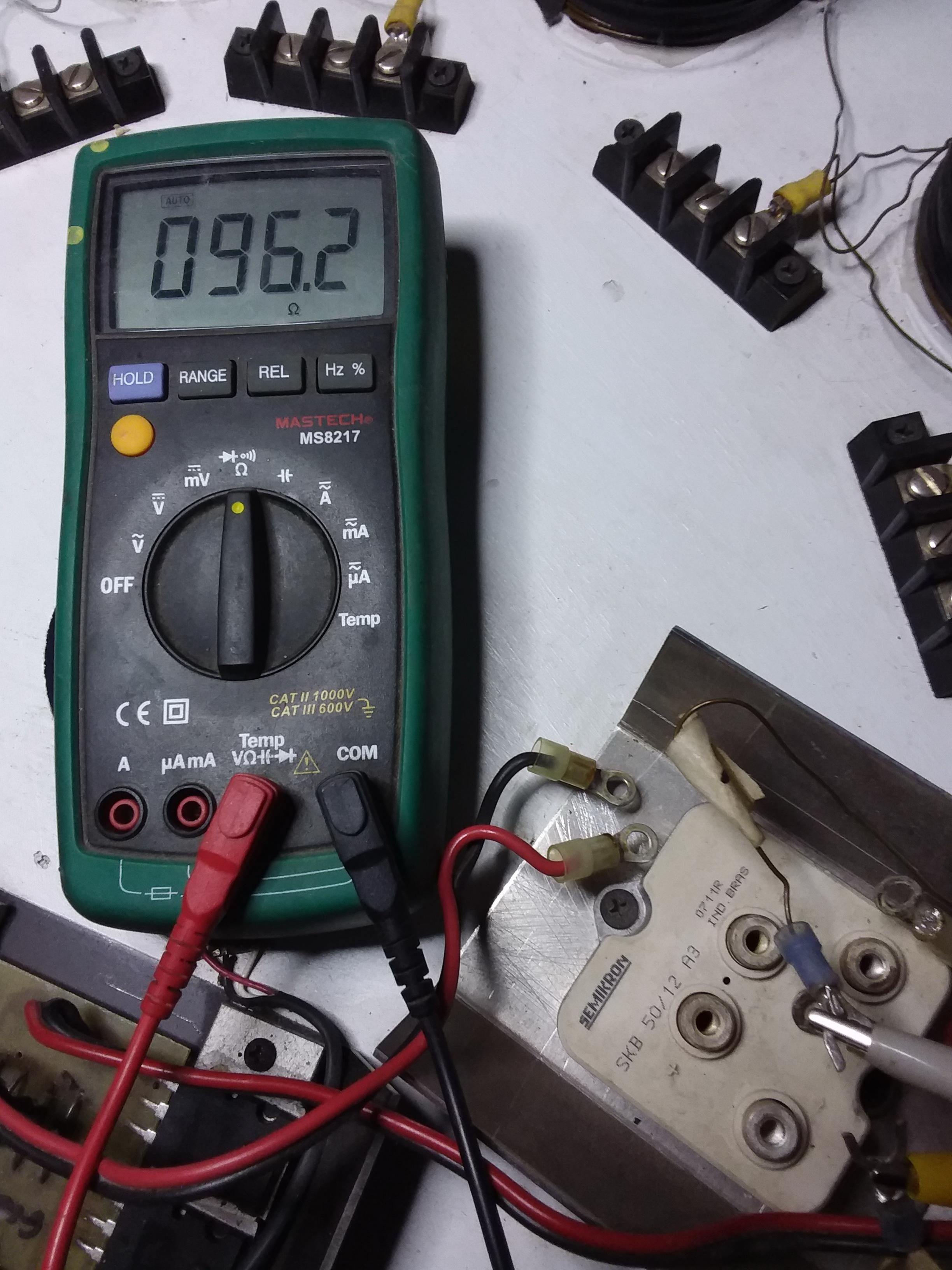

                    The last pic with the green mulitmeter is measuring the DC resistance of the 10 hub motors coils in series. I have not tried to analyze these measurements, but will be looking them over in the coming days

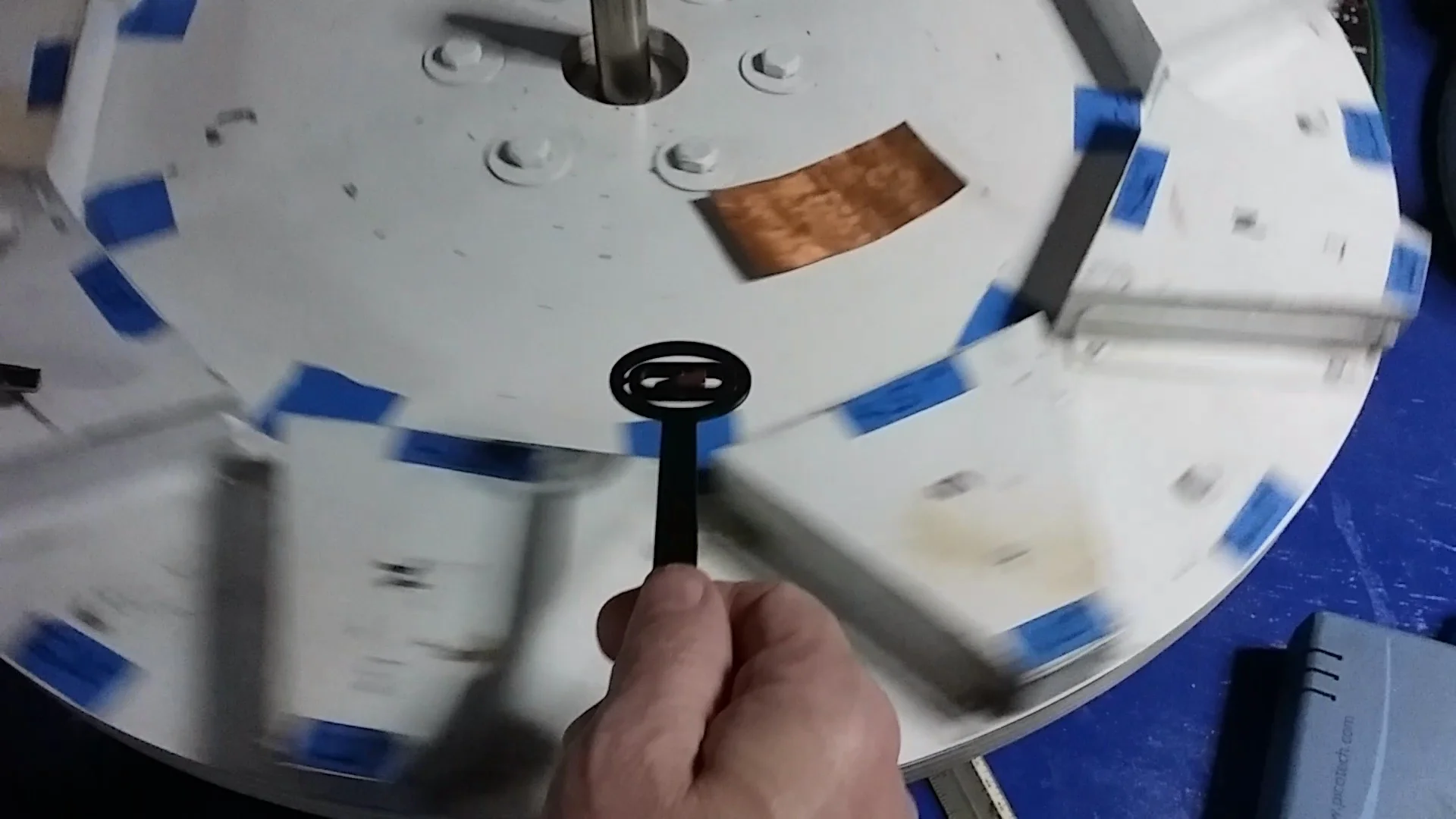

                            One more video of a different kind of magnet field sensor before i change things up.....
                            https://vimeo.com/383189042?utm_sour...campaign=28749

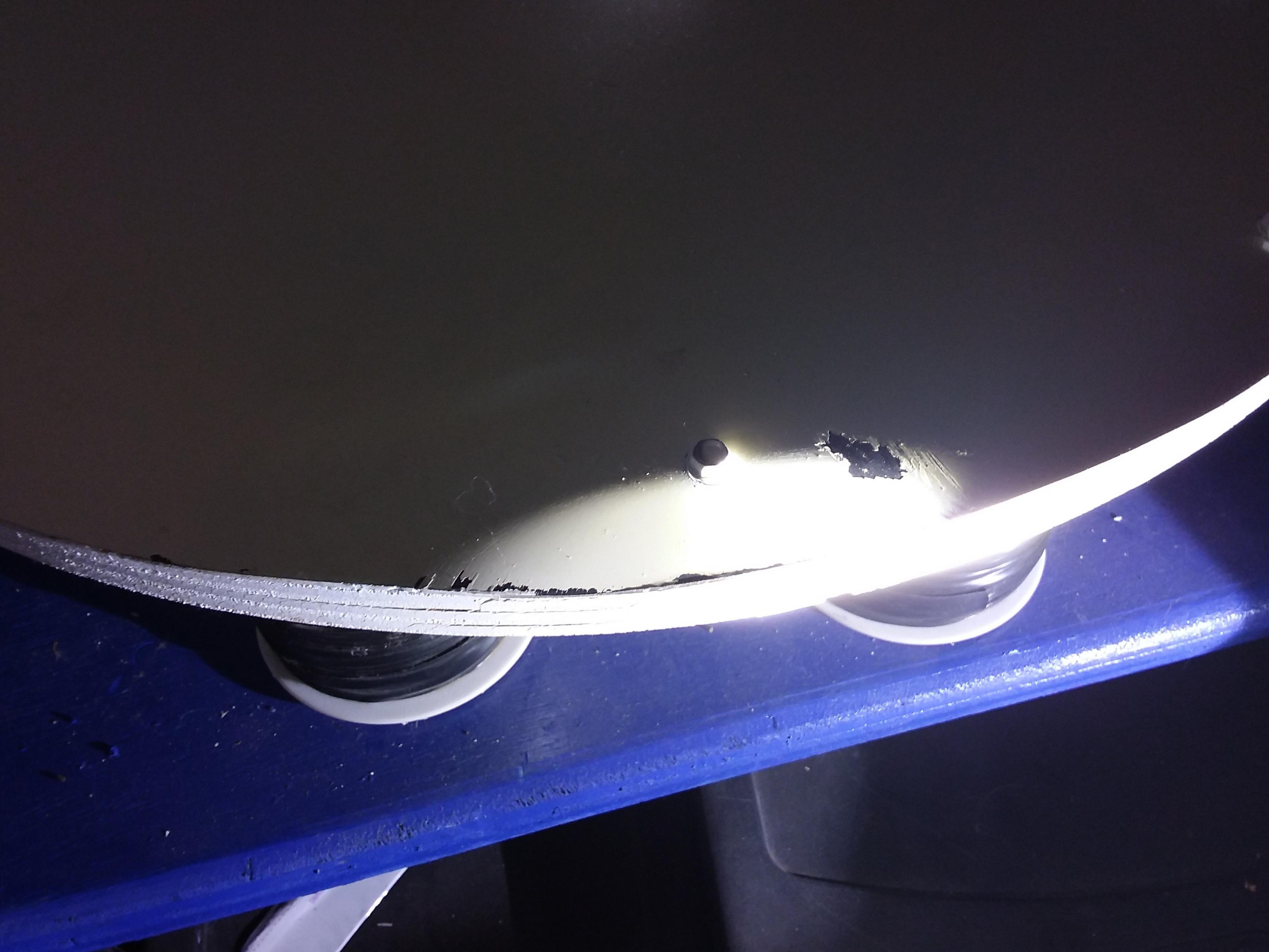

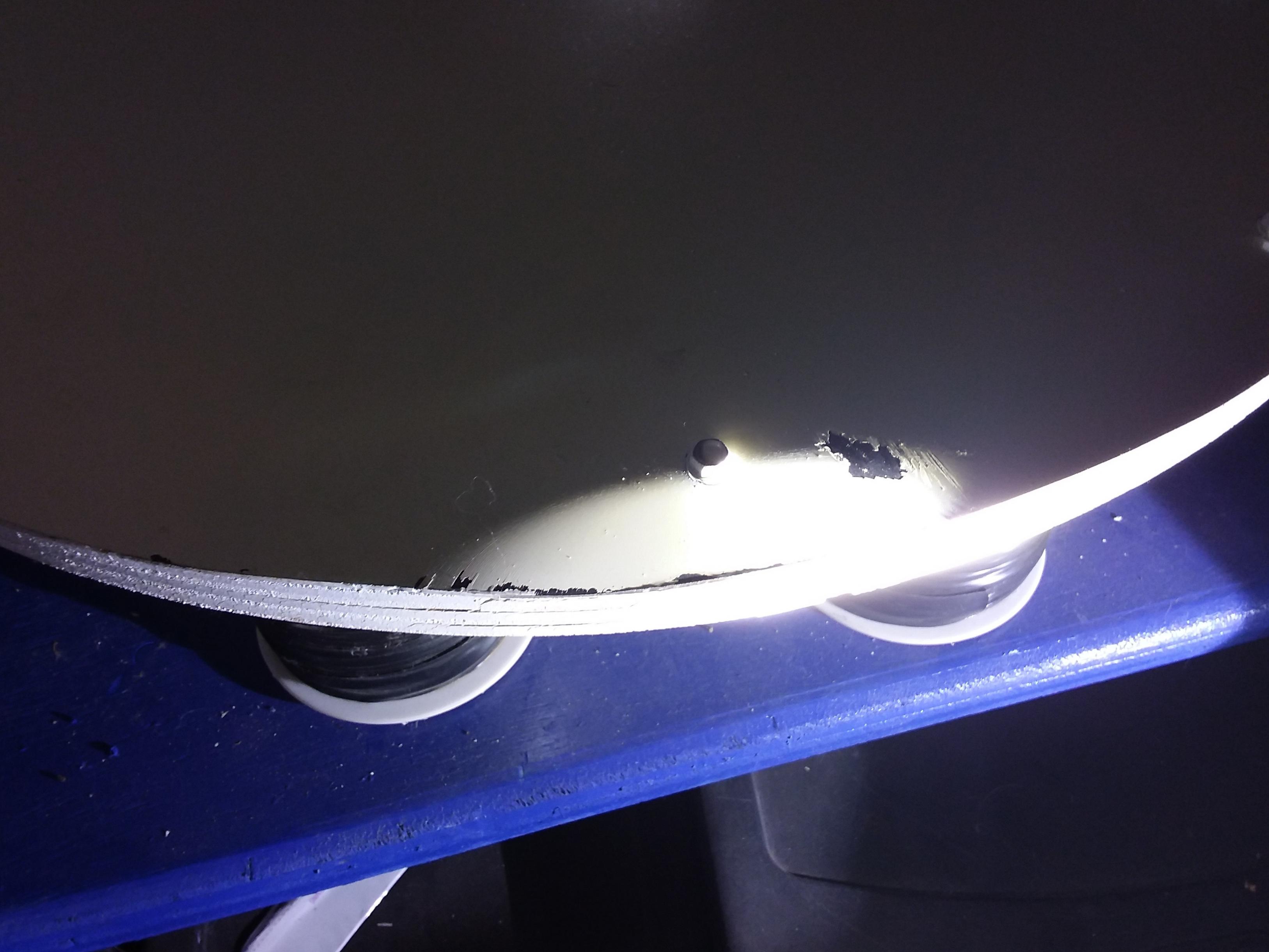

                              Click image for larger version  Name:	20200101_190640.jpg Views:	0 Size:	410.4 KB ID:	72489
                              A dent in the edge of the sheet steel of the hub motor coil base. It was like this when I received the FW. JB said to straighten it out, and it would be fine.
                              • #30
                                I found that the sheet steel on the hub motor has been polarized. i don't know if that is from the motor operation, or from the magnets stuck to the sheet steel for so long after JB dissembled the FW, and I received the FW, and the time between now and then......
