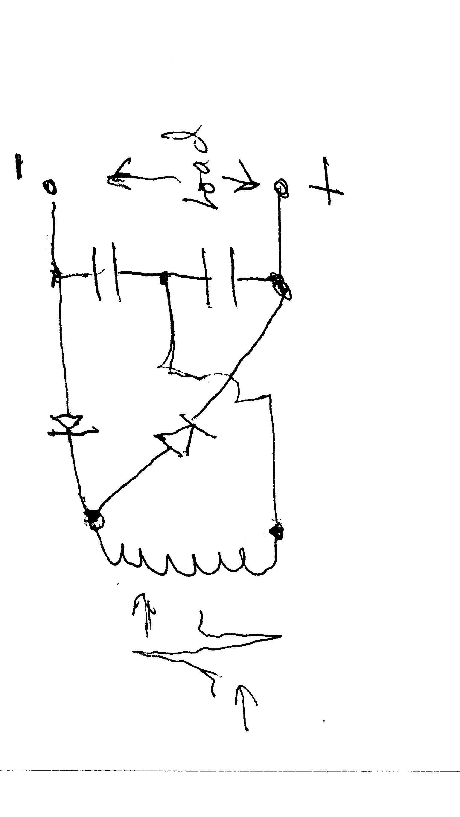

Hi Gary, am interested, three times now I've gotten "Invalid Attachment specified. If you followed a valid link, please notify the administrator". Prolly a problem on my end, maybe on your end, if neither, let's raise a ruckusOriginally posted by Gary Hammond View PostHi Paul,
I've had good success with this circuit using only two diodes in a back to back arrangement charging two caps. You then take the load from across the two caps in a voltage doubling scheme.
[ATTACH=CONFIG]7562[/ATTACH]

Hi Paul,
Sorry about that. I'll try again. For some reason the scan shows up sideways. When I tried to rotate it 90% it wouldn't load properly. It's a rough sketch, but you can get the idea.Originally posted by ZPDM View PostHi Gary, am interested, three times now I've gotten "Invalid Attachment specified. If you followed a valid link, please notify the administrator". Prolly a problem on my end, maybe on your end, if neither, let's raise a ruckus
