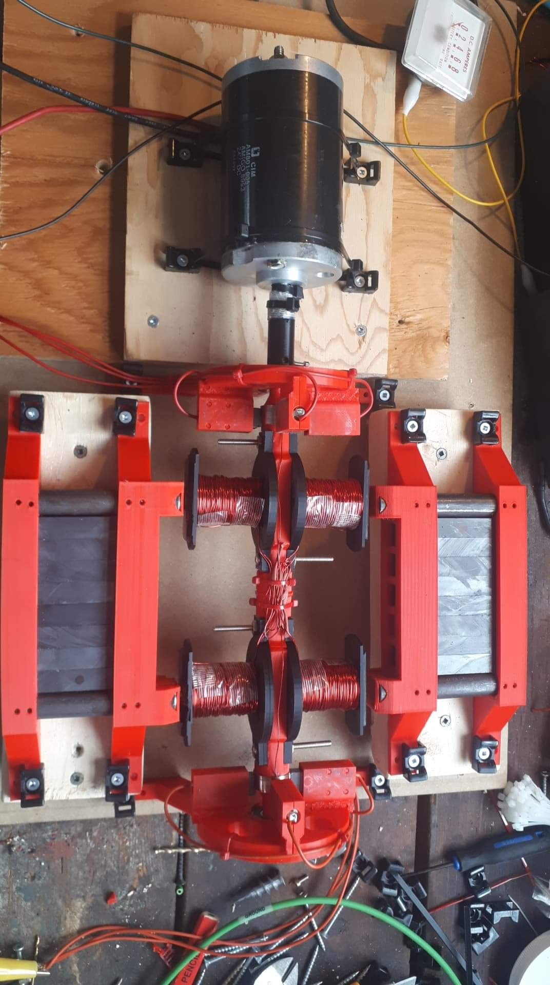

YARO!!! been awhile...where is everyone on here these days lol....
update vid shows I have attained the rpm increase under shorted output with a plastic and wood housing!!!

Great Demo! Love the use of low tech for the gen body - simple, yet effective, for experimental purposes. So you did accomplish your goal of speedup under load - excellent progress! What's next?

Happy Fathers Day to you too! Aside from getting the gen2 kromrey kits ready, i am building this one. I think it is supposed to do the same thing. Which, would be great because no slip rings needed and no spinning coils. We will see.
Question on the iron bar. I understand that when the bar enters the magnetic loop it becomes charged. Does it matter the thickness of the bar? I would have to assume that a 1 inch thick bar would be better than a 1/4 inch bar but I dont know. Is it like impedance where the "more copper the better" approach is used?
