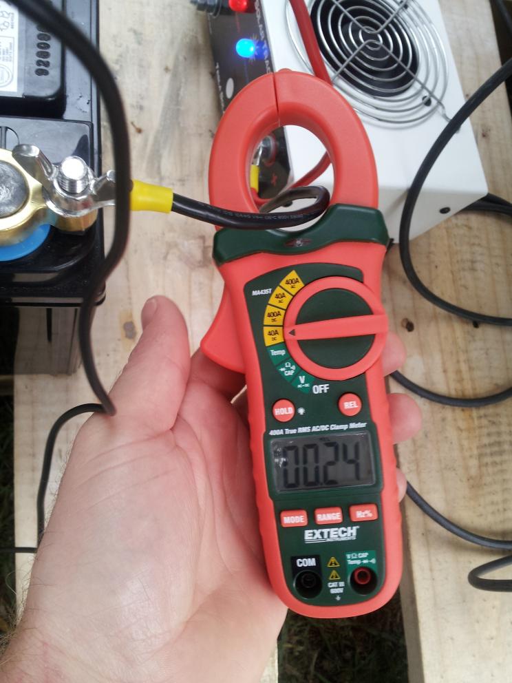

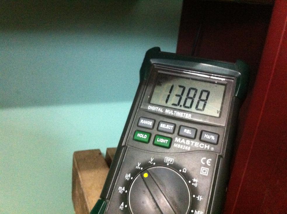

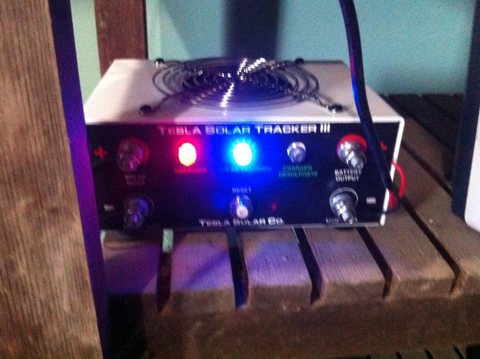

I haven't had the chance to run a Tesla Solar Tracker V through its paces yet, so I don't have any data to share however my TSTIII starts charging batteries before sunrise and after sundown, obviously not full power but at a guess I would get at least an extra 10 percent out of the panels.
