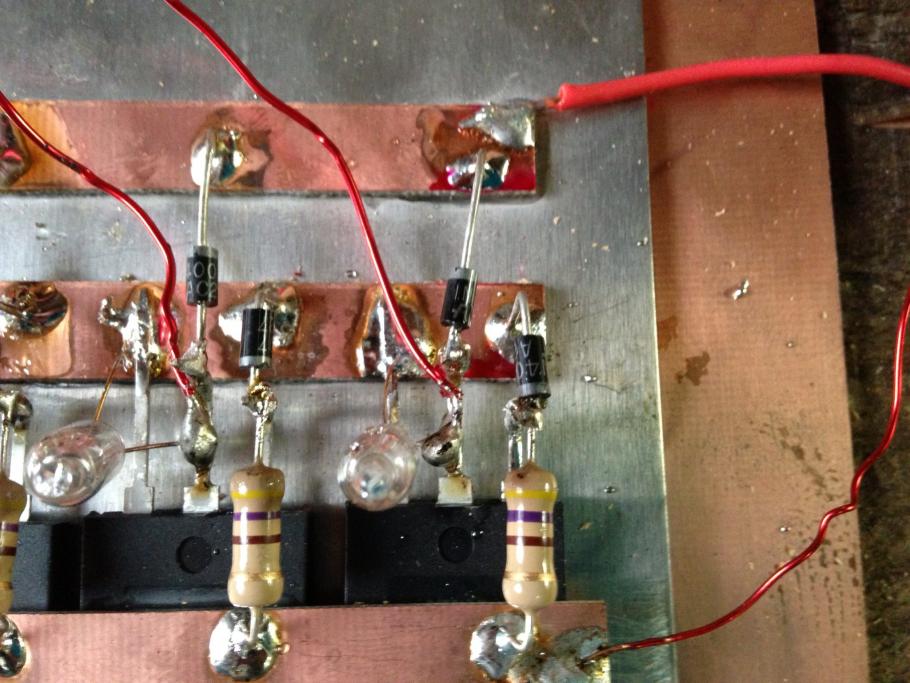

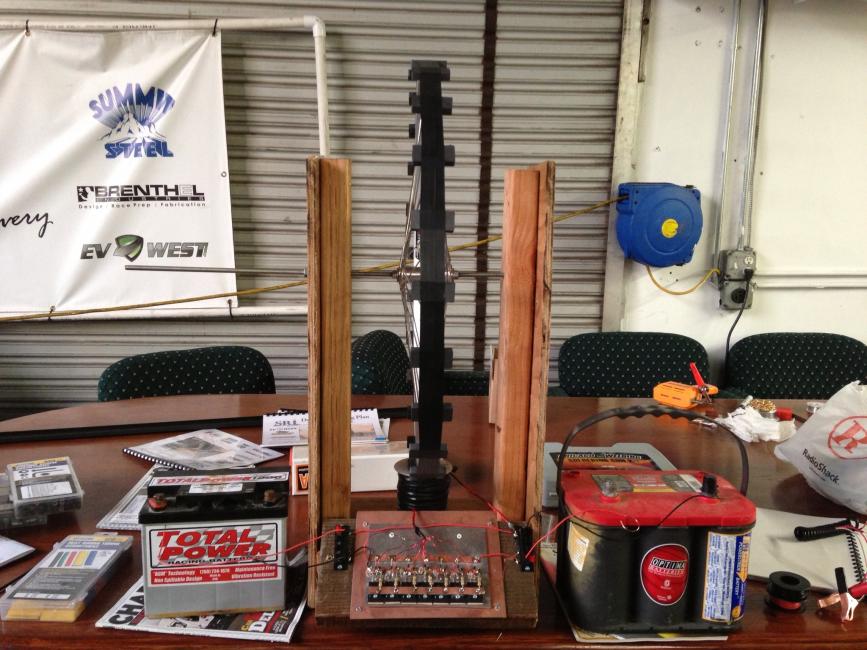

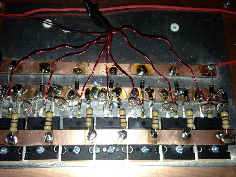

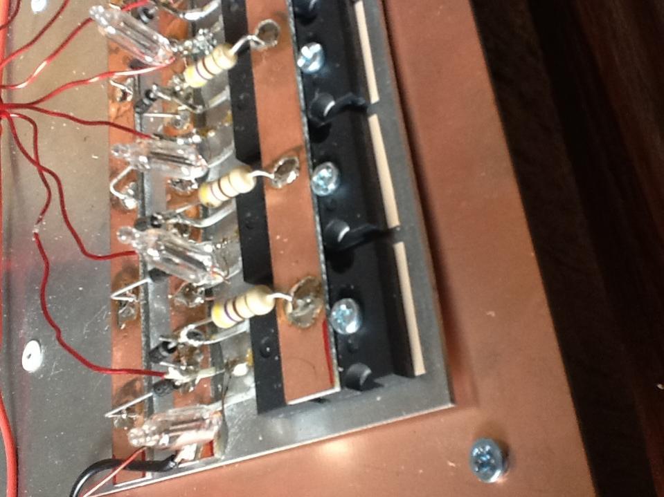

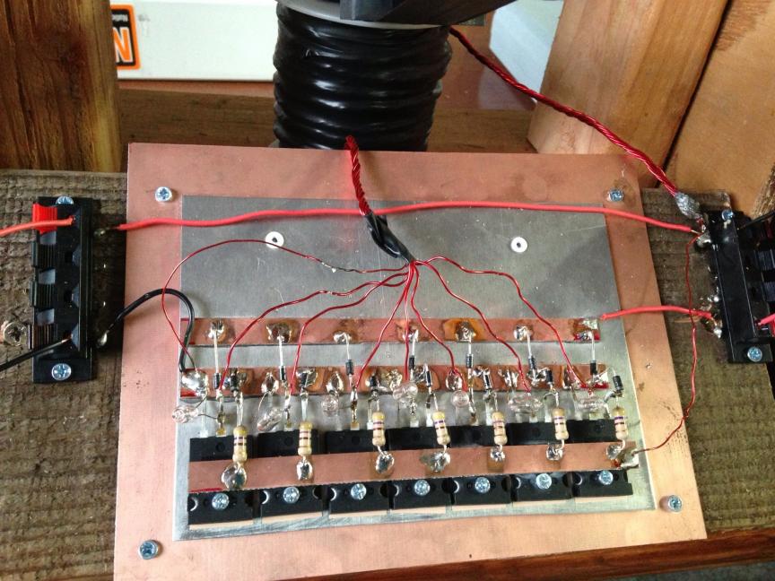

Hello fellow Bedinians. I have just finished constructing a Bedini SG with 1 coil, 7 power windings and 1 trigger winding. I built 7 circuits to run the system. When I fired it up for the first time, it didnt opperate. When I connect power, the coil attracts the magnets, but when I give it a spin, it doesnt start the magic. I tried switching my +and- leads to the battery but that only made my coil hot. I couldnt get the neon bulbs to illuminate when i disconnect the secondary battery either. I am a begginer at reading circuitry schematics, but I am pretty sure I got it all hooked up right. Im not sure if my trigger wires are hooked up to the right place. If you look at the attached pictures, the windings from the bottom of my coil go to the collectors of my transistors, and the trigger goes to the - of my primary battery. The 7 power windings from the top of the coil go to the - of my seconday, and the trigger goes to the capaciters. Neon is connected to the collector and emmiter. Im not sure if one set of the diodes are going the right direction. Hopefully my pictures can help answer any of your questions. I really want to get this one going. I built a single bifoiler coil before with one circuit, so this is the most complex that I have built.Thanks for your help.
7 circuit Bedini SG

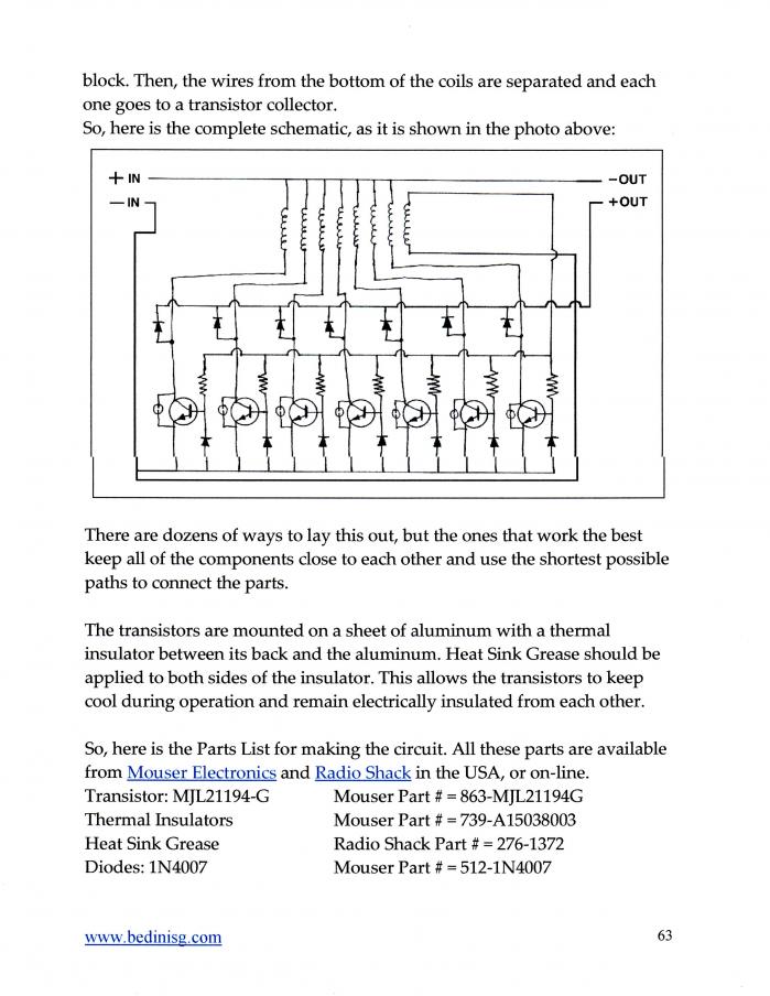

The diagram I used is in the bedini handbook. I will attatch a picture of the diagram. I am not completly sure that I read the diagram correctly, but I am pretty sure. Some of the pictures above should show you if I have followed the diagram or made a mistake somewhere. I used all the recomended parts. Again, I dont have extensive experience reading schematics, but I am teaching myself to do so, with the help of wise folks like you.

unhook all the circuits but one, get it running on one circuit, then add, it is easy to diagnose one circuit.Originally posted by Gpilot View PostReversing the trigger winding didnt change anything. I can tell if the system is self oscillating or if the trigger isnt triggering. I can post a video in a little bit if that would help.

desolder the base resistors which is the trigger that will turn off the transistors you are not using, leave one connected. then take the wire bundle from the coil and split it out so you can add one wire at a time to the circuit, remove the wires going to the transistors so you have only one power winding connected at a time. use your meter to make sure the power winding connected is the same at both ends.

i see that your Trigger connections have to be reversed.. and you will be on track..! having that done most of the transient (Radiant Spike!) protection look very much in place.. neat and effortful work ..!

take that big circuit off the machine build a single SG circuit like this one. add circuits as it starts running. I see you have insulators on your transistors, good you can leave the coil as is. with all of the components many things could be wrong. if you have the SG book you wil see this coil is in repulsion mode, do not worry about that, run your coil the way you have it one power strand one trigger strand in attraction mode.

Can you tell by the picture if my diodes are the right way? The magnets i am pretty sure are N out. When i plugged a battery into the coil alone, it does repel. The transistors I will need to test again, it is possible I burned them up during unsuccessful testing. The connections will be resoldered. I am building a single SG circuit now, and will update this evening on the findings.Originally posted by Tom C View Postcoil wires not shorted together internally
