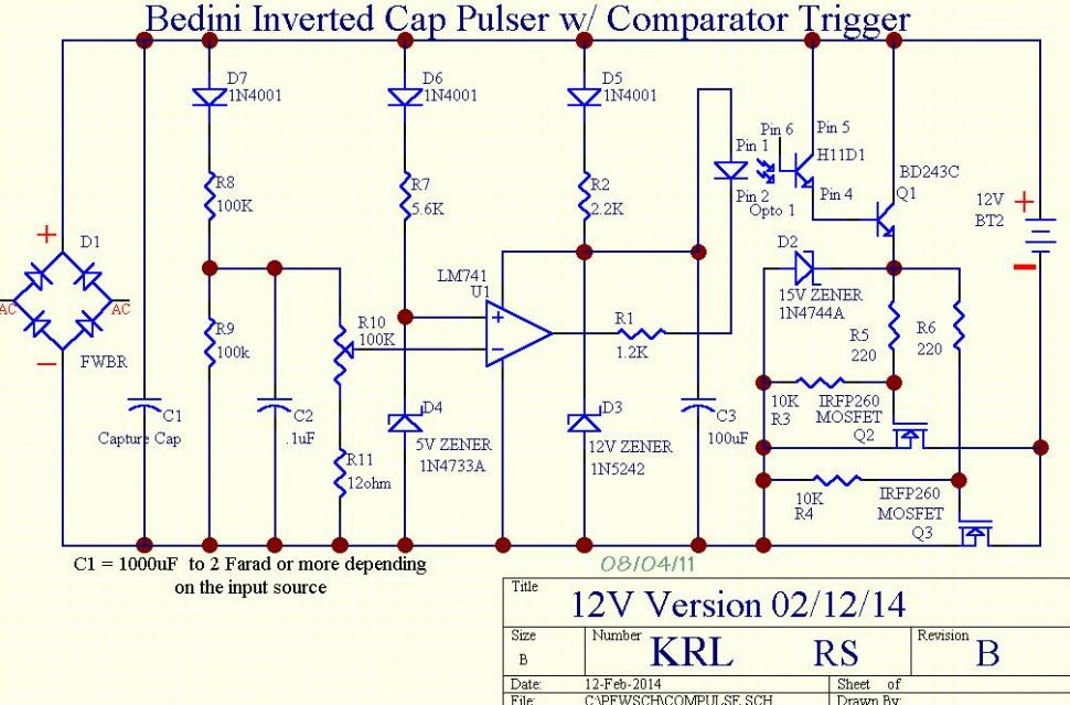

your comparator should be dumping at 2x battery voltage set at the comparator dump potentiometer. pulse power is hard to see with a meter, the only way to really see it is with a scope and a current probe, hundred amp probe minimum.
As simple as the configuration is, of the LM358 op-amp as a comparator driving a mosfet. It took me years to figure this one out.
