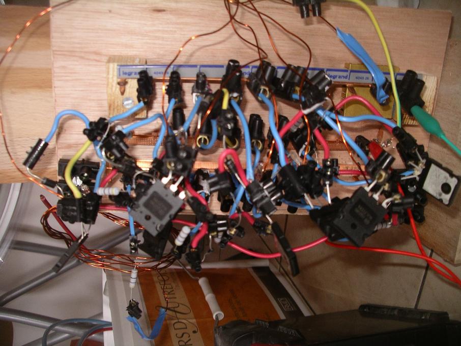

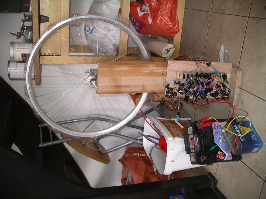

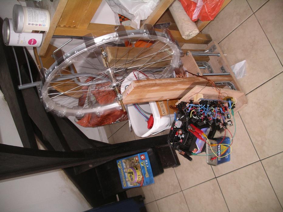

    Dear Mentors, all,
    I'm very glad to say after building a SG from scratch, I have made it solderless and it WORKS !!!!!
    argggghhhhh....never thought this would be possible.
    Have a look on the photos !!
    I am currently testing the charge of a 12 V battery with a 6 V battery, and testing about the overunity inside the batteries.
    So far, I am quite disappointed with the results, because it barely barely shows a 1:1 albeit with 7 strands.
    The wheel is running at about 139 turns per minute.
    The Base resistors are 47 ohms, if I recharge from the 6 V the trigger coil resistor is 47 ohm also,
    if I charge from the 12 V I installed 2 resistors worth 200 ohms.
    eeerr.....I was expecting a 7:1 ratio...with 7 strands....well, I'm still researching this.
    Anyway, I am so proud , so happy to see the machine working .
    I am a newbie and to tune the system as described above, I needed around 10 hours of work.
    I am open to suggestions to improve the efficicency though, if anything seems obvious from my mentors posting here...
    To have this working, I destroyed 5 transistors, 1 diode, 1 ne-2H bulb.
    Sharing the good news, I want that the newbies here feel confident they can make it.
    Yes, the BEDINI SG works and it does STRANGE THINGS !!!! This technology is not a SCAM !!! I'm a living proof for it !!
    Next step for me ? Get up to the 7:1 efficiency ratio !! * ...if I can...
    not impossible, probably...haven't I done the hardest part ? Yes, that is so I believe.
    * mind I'm not using capacitor discharge, just the "spikes".
