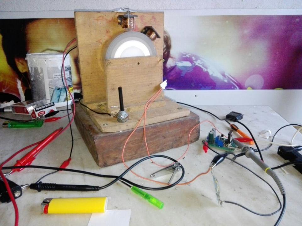

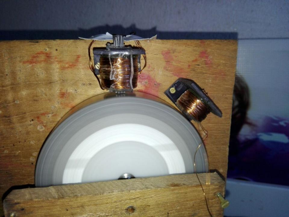

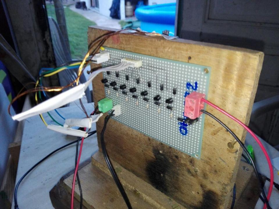

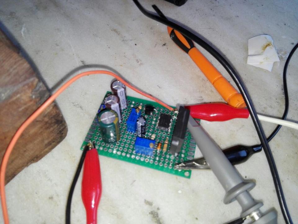

                        I got back into my little ssg motor that I posted in this thread 2~3 years ago.
                        At that time I had it with a bifilar coil for the motor, 1 trigger and 1 power winding. Now I made a larger coil, with 8 strands of wire, 1 trigger, 7 power.
                        The circuit is the same as the advanced book, but with small transistors, 2n2222. All matched up and everything.
                        It runs much faster!, with the old coil it ran 3000++ RPM at 12 volts. and everthing got hot, the coil and transistors.
                        Now with this coil I have not tryed to run it on 12v... yet.
                        with 5v input from a phone charger, it runs at 3600++ RPM. o.O
                        in the past I wondered why mine droped a lot of RPM with the gen coils in place (not connected, just drag from the iron cores). And the SSG from the advanced book didn't drop any RPM with the gen coil. Now I see that I had 1 power winding, and 6 gen coils... the SSG from the book had 7 power windings and 1 gen coil... totally different story.
                        I have to start new tests now, I have to get other batteries because the lifepo4 that I had at the time are not in the best shape. And I want to try with normal batts, I might get some new 6v 4ah batteries. And see what happens on 6V. It might get up to 4000 RPM.
                        I don't want to run it on 12V because I am afraid that those magnets escape from the rotor or something. I have to make a better frame...
                        I might put all 6 gen coils back in, out of phase each with independent diode charging a cap dump circuit. I also have to experiment with the AC cap that John had in the 1984 booklet in the gen coils.
                        here are some pics that I took just now, with 1 gen coil going to the new cap dump circuit that I made.

                        best
                        Alvaro
