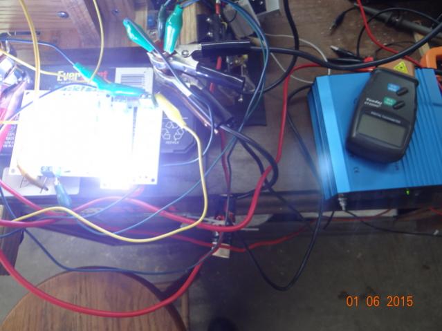

              Hi All, New update
              When running with 36 ohms base resistance and only 1/8" air gap in radiant mode, the added generator coil will power 40 LEDs and produce 370 RPM with the cap discharge connected. But the charging is very slow. It takes 3 hours pulling 1.0 to 1.1 amps from the run battery to replace the 1.0 amp hour previously pulled from the charge battery. And when running the same way in common ground mode, the results are only slightly better. It pulls 1.4 amps from the run battery at 355 RPM and takes about 2 hours to replace the 1.0 amp hour previously taken from the charge battery. And I can't see much difference whether it runs directly to the charge battery or through the cap discharge unit.
              It also will power an additional 40 LEDs from the generator coil I added upside down under the main 8 filar coil with no added load anywhere in the system! This one is a freebee!
              BUT .....When I go back to the 3/8" air gap and 12 ohm base resistance it will still light all 80 LEDs running at 314 RPM and pulling 1.0 amps from the run battery. It takes it 2.33 hours to replace the 1.0 amp hour in this mode. And in common ground mode it pulls 1.6 amps, lights 80 LEDs, starts at 220 RPM, and fully recharges the battery to 15.3 volts at 250 RPM in only 32 minutes for a COP of 1.17 !!!

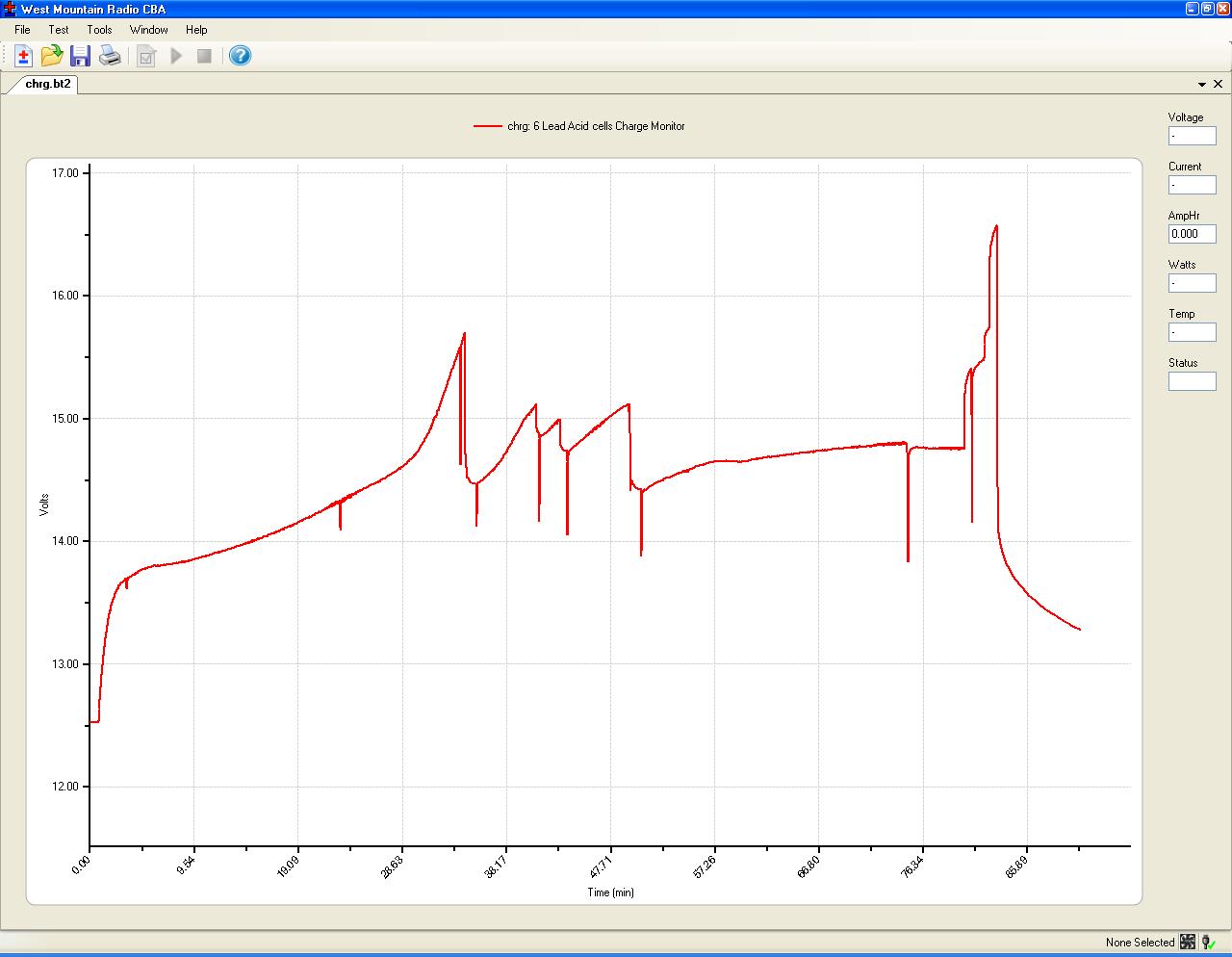

              Just for kicks and grins, I let it keep running in common ground mode and started adding loads to the charge battery. I plotted this run on my CBA analyzer and show it below. I first added a 500 ma load of LEDs, then another 100 ma load of LEDs, then another 100ma load of LEDS for a total of 700 ma of load ........and the battery voltage kept on climbing after each load was added, so then I added a 300 watt inverter at idle which pulls 300 ma. The system was now powering 80 LEDs, 3 LED panels from Teslagenix, and an inverter for a total of 1 amp load while only pulling 1.6 to 1.8 amps from the run battery. All this, and the charge battery was still slowly going up in voltage while the run battery was dropping only very slowly!!!
              The negative spikes on the charge curve are where I inserted an ammeter to check current draw on the run battery, and the positive spikes are where I added each additional load to the charge battery. The very last spike is where I removed all the load from the charge battery.
Name:	1-6-15 charge curve.JPG

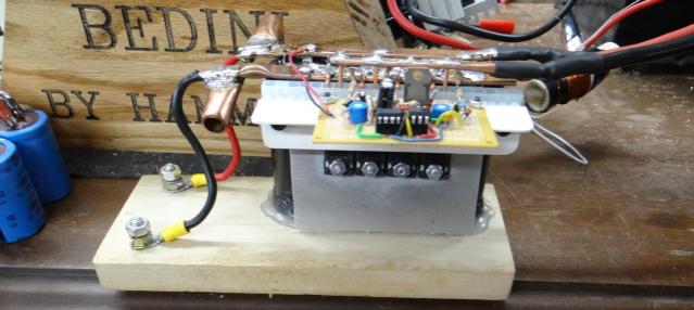

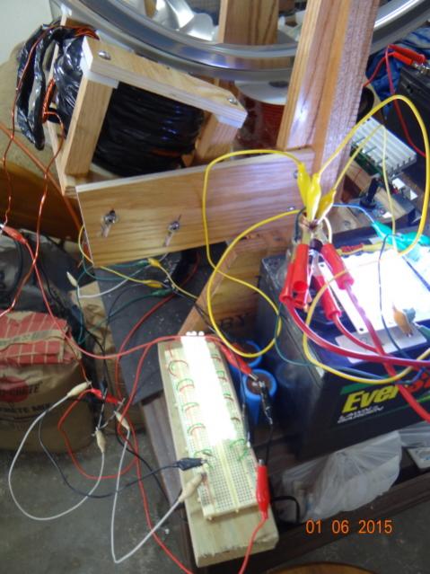

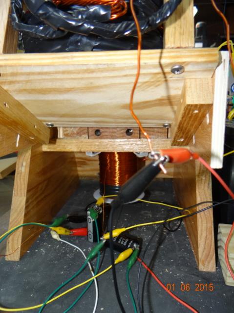

                Here's some photos of the machine.
Name:	advanced SSG 001.jpg
Name:	advanced SSG 002.jpg
Name:	advanced SSG 003.jpg
Name:	advanced SSG 007.jpg
Name:	Cap Discharge 001.jpg
