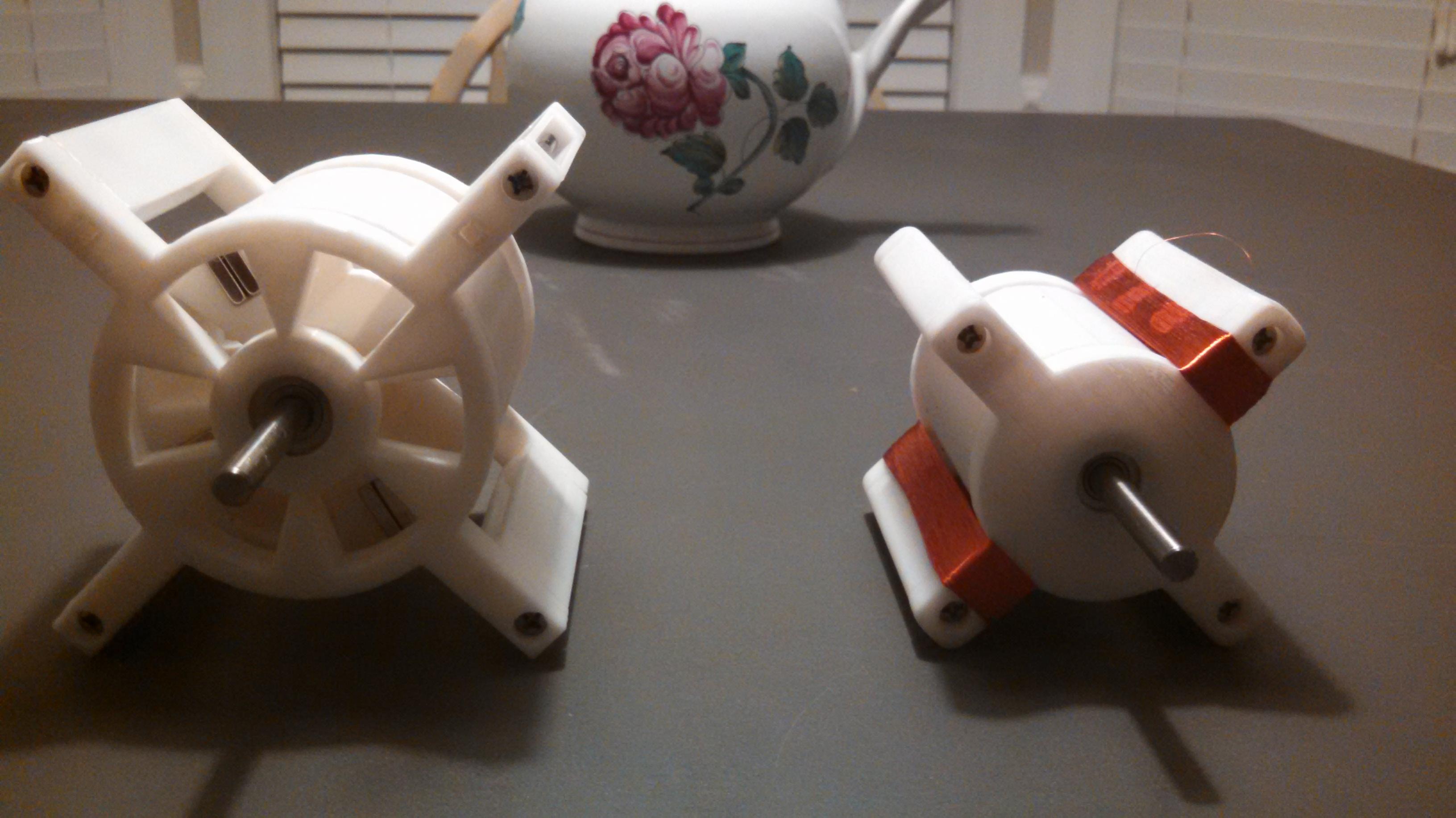

                I added this design: http://www.thingiverse.com/thing:2081053
                It is setup to put two magnets in repulsion in four positions at every 90 degrees. This should create a focused magnetic beam and a very abrupt pulse. It also has slots for iron coil cores (welding wire).
                If someone wants to try a different size magnet or magnet arrangement for the rotor let me know. I know that there are others out there that live in the metric world. This is a very easy adjustment.
                DMann
                  Here is a picture of the two side by side. My printer, as is, prints 4" X 4" X 5". The one on the left comes close to a max on the length and width. If you look closely you can see that, on the larger motor, the magnets are placed together at each of the four poles. They are in repulsion N facing N. I was able to confirm a very narrow band of magnetic influence is the result. I faced a steel rod toward the rotor and found that is was only attracted to the narrow N beam at each of the four poles. This should make it easy to run off of a reed or hall circuit, triggering off the rotor. It should be self-starting with iron cores due to the narrow magnetic beams being the only apparent point of attraction. I'm going to try it with an SSG circuit to begin with on Tuesday.
