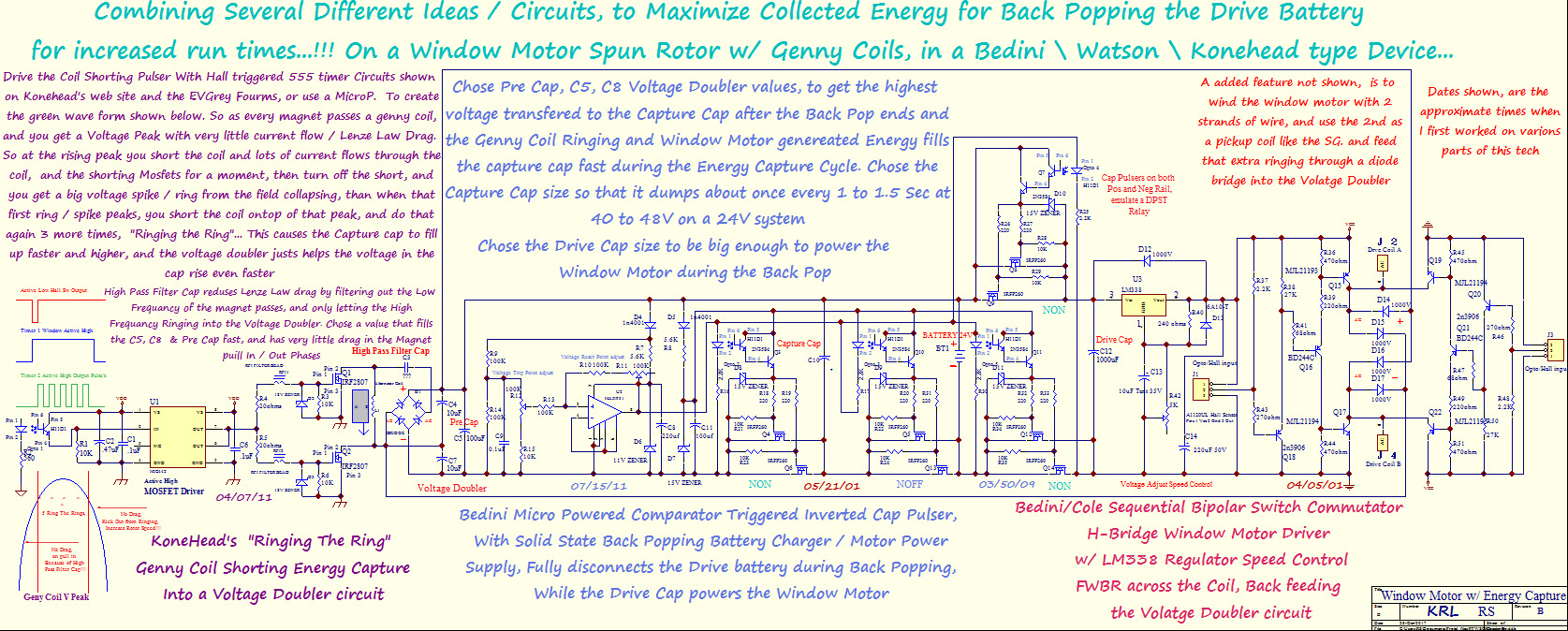

    Here is the Combined Circuits Schematic that I shared at the 2016 Conference.
    I recommend, to not add the Gate to Drain 15V zener diodes in the cap pulser stages, unless you are having trouble with gate failures
    Fixed it

    Hey RS. Maybe if you take a picture of it with a camera from your computer screen it will come out clear. It should be jpg from the camera. Someone else may have a better solution but I have done this myself before and it worked great.

      Greetings:
      Could you please post the circuit in the design software that it was made in?
      I would like to open it in a designer to get a good look at the components, and perhaps, a BOM.
      Thanks, I appreciate it.
      glenWV
        It is in Protel 99SE, and I doubt that you can open it, unless you can find and download a cracked copy.....
        here is a BOM.....
        These values are close, but you need to tune them to your various Hardware and setup.
