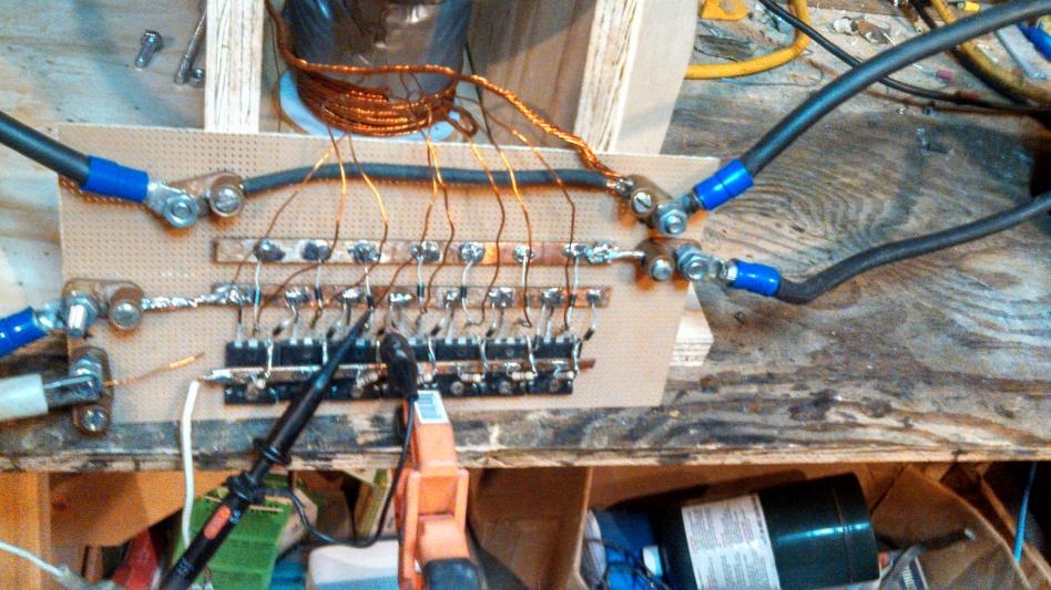

              Hi Tom,
              Not seeing 1:1 charging.
              Wire size and length of wire , and what size the trigger wire is if it is different from the power wire
              pwr strandsare #20wire, trigger is #23. 130ft length, litzed.
              Number of wires on the spool
              7 pwr strands plus trigger on master coil.
              Number of magnets on the Rotor and type of magnets
              21, c-8, 16"rim
              Free spin time of the rotor with the coil removed
              8:30 (8min, 30 sec)
              Type of transistor or transistors, and if you matched the components
              MJL21194. trannys, base resistors, charge diodes are matched.
              Type of battery you are trying to charge
              Walmart lawn and garden
              Is it a single or multi coil machine
              Single
              What steps you have already taken to remedy the problem.
              Bought 8 new batts.
              Charge run batts with 2A12 charger.
              Started with etched cct board with huge traces but now have new manual copy with #6 wire in and out.
              Continuing runs. Am draw is .7A
              Please have pictures to upload of your circuit and your wheel.

                    do you have the final 12 ohm resistor in there? what is your primary current draw? too much current possibly. I found on mine I had to add a 33 ohm resistor as a base resistor before the branch resistor to get my current down. Tom C

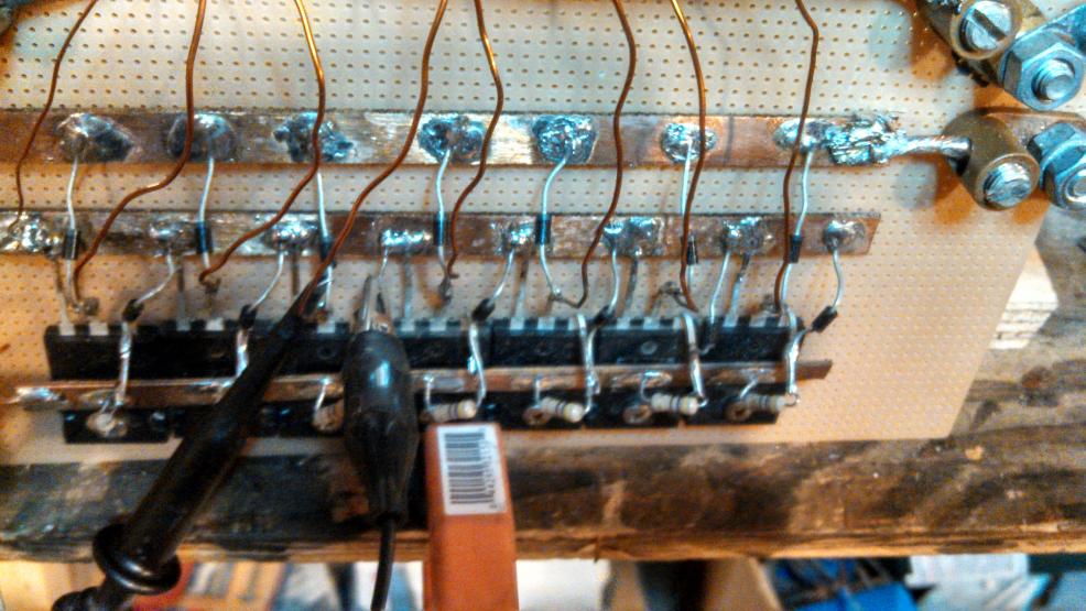

                      Hi Tom,
                      What do you show for amp draw?
                      I'm seeing around .6-.7A.
                      When I checked it with an inline analog meter it initially showed .6A and than as the machine adjusted to the meter it showed .7A.
                      I have a 10ohm, 10W resistor which is soldered to the base resistor buss and then to a pot.
                      The total resistance is 45.8ohm from buss to coil trigger winding top. Yours sounds like 12 + 33 = 45.
                      bro d

                          my sg pulls over one amp. you have big batteries and you are running at a 2 transistor draw rate. I like to see 200 to 250 milliamps per transistor. not sure why your current draw is so low for 7 transistors. that current draw would work better on smaller batteries. you need a bit more juice. work with your base resistance to get your current draw up. thats the thing it can be too hi or too low.
                            Hi Tom,
                            Thanks for the reply.
                            I hear John B say that "it's a one amp machine."
                            I thought that his amp draw was 1A.
                            I checked each component in my circuit and thought I might find a defective device but they all seemed to be OK.
                            I then, made minimum connections with clip leads. And played with the gap. It's running now at 1.2A.
                            That is with matched 66 ohm resitors.
                            If the gap was 1/8" wider it wouldn't run.
                            Is your SSG running with #18 pwr windings at 130ft?
                            That should call for a little more amperage than my #20 coils, right?
                            I thought that maybe I was causing a problem by removing wire insulation with a butane torch.
                            What's the best way for that.
                            Thanks for your faithful help.
