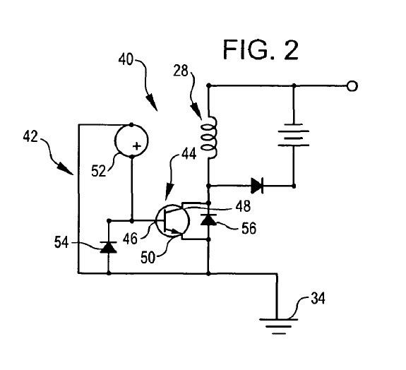

                The big anomaly that has my current interest is battery behavior to pulse/radiant charging. In the plots above, it is clear that something (“conditioning”) is happening. I’ll leave the why to someone good with electrochemistry. I’m wondering what steps can be taken to optimize this behavior, and what are the practical limits.
                I’m considering moving my studies to a solid state design very similar to the circuit shown in John Bedini’s patent US 7990110, figure 2. See excerpt below. A good control circuit (#52) and fast switching transistor (#44) could give great flexibility in pulse frequency and duty cycle without the limitations of a mechanical wheel. I’m thinking of this as focusing on a part of the SG rather than abandoning the current project.
                Thanks for the ideas and encouragement!
