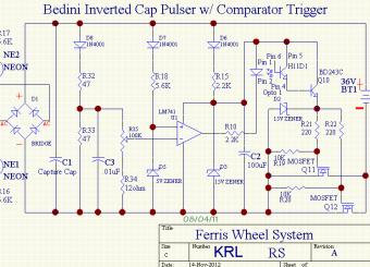

    change the 2 47ohm resistors with 100K
      Great! Ask and you shall receive! I will let you know how I make out with it.
      Would you recommend I build this type instead of the timing design?
        Also, would the type, capacitance and voltage rating be of C1?
          you need Low ESR fast discharge Caps
          The Value depends on the size of energizer feeding it, and the size of battery you are charging.......
          voltage rating is 35 to 50 V depending on the voltage of the charging bank.......
          I like this version, Because it is self adjusting, it always fires at the same voltage on the capture cap, no matter if things change like the primary runs down, etc... the timing changes..... where a timer will fire in the same time period no matter what, but the voltage on the cap is different as things change......
          Also, the above Sch was designed by JB for a 36V system, and will run a 24V system too, but will need some minor tweaking to run a 12V or smaller V system

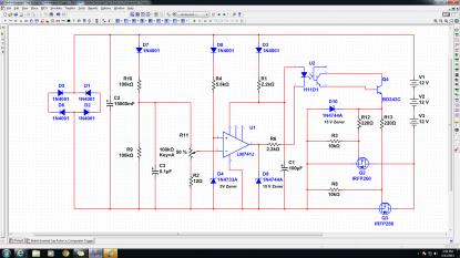

            Thanks again for the schematic. It is greatly appreciated! I have re drawn it in multisim and placed the values as best I can. Some of them were a bit blurry but I think I got everything. Just not sure if those are 1.5V or 15V Zener's. I have attached the redrawn circuit here. If you could take a quick look over the values that would be awesome!

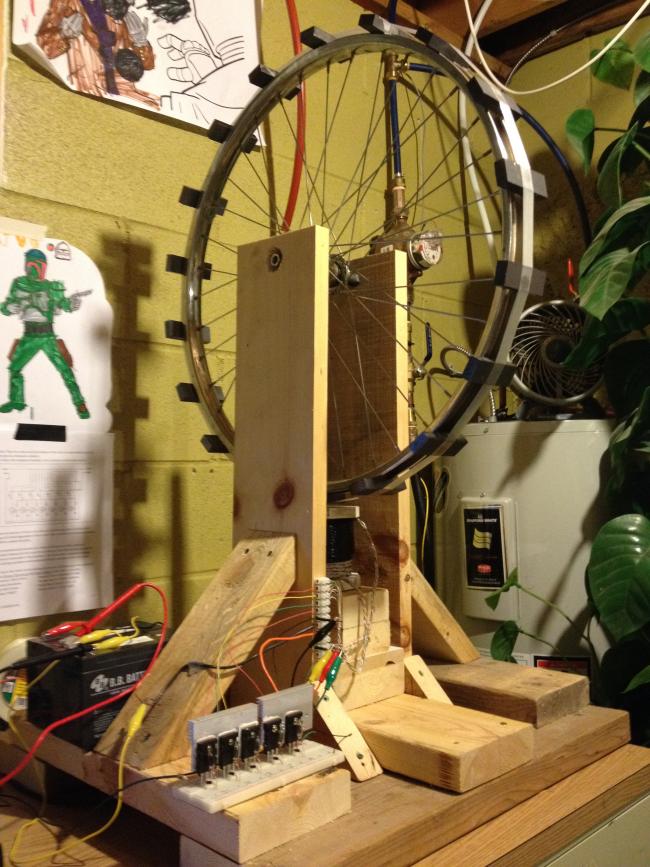

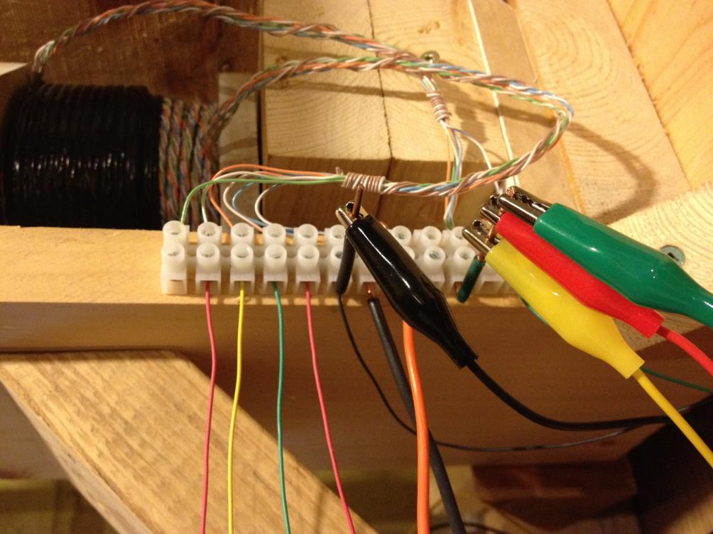

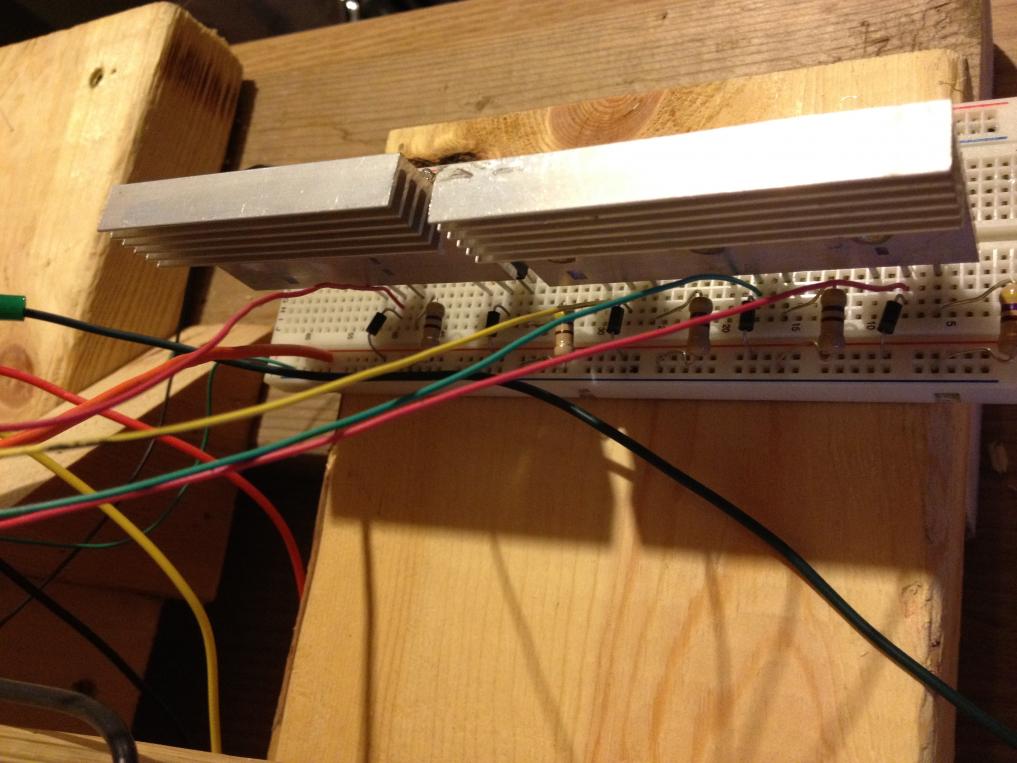

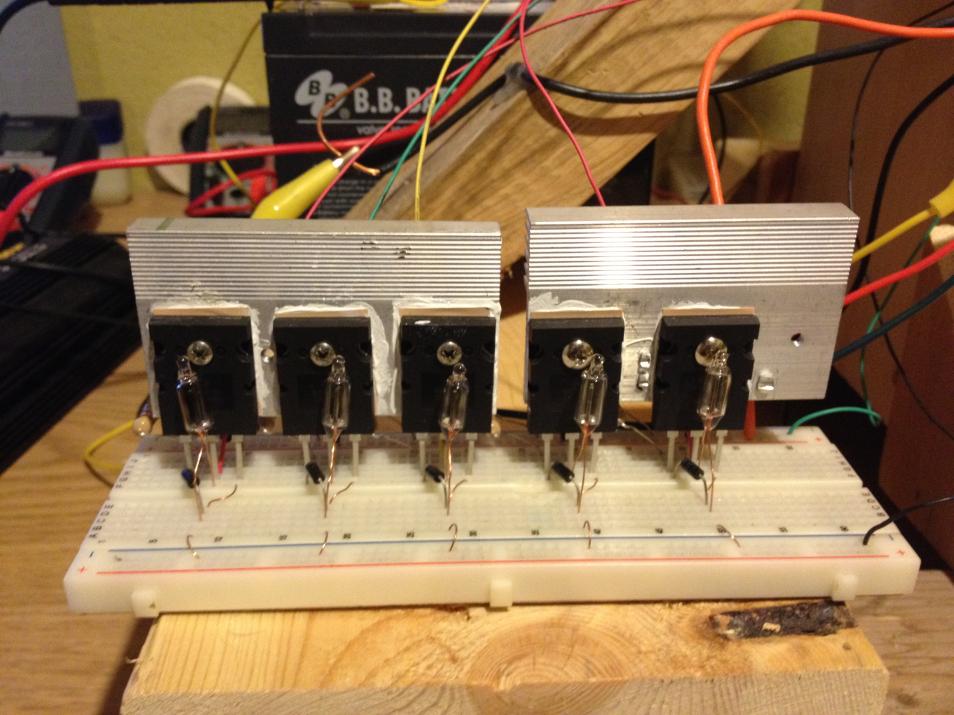

            I have also attached some pictures of my machine so far.
            Thanks again, your help is greatly appreciated.
            J.
              Joster,
              I have the full wave bridge diodes pointing in the wrong direction, even though i have it Labeled + and - on the sch, my bad, i have done this on several sch's, and was a copy paste mistake that i had not noticed for a good while, until some one pointed it out recently. So change the diode direction on the full wave bridge, and your sim should work correctly......
              the Zener reference on the comparator is 5V, the other ones are 15V
              If Tom C. or John K. could post a link for their source for caps it would be great......
              a) Would I be looking for a 50V max voltage with a 36V system? 50 to 75V will work for 36V
              b) Is there a ratio to go by, say 5000mF/MJL211? not that i can figure, but there is a relationship....
              c) I have looked up a few caps and checked the ESR ratings. Is 11mOhms @120Hz considered a low ESR rating?
              d) I could reduce the ESR with more caps in parallel correct? this can help depending on what caps and values you have
              e) The max DC surge rating on most of the caps I have looked at are only about 12Vdc. Would it not need to handle much higher pulses ? DC surge is a amp rating......
              "Would the size of energizer be determined by the number of devices running?" yes
              nice looking unit..... you want to build up a solid soldered and with solid battery connections with heavy wire unit, as soon as you feel you understand the circuit, and get rid of the alligator clips and proto board
