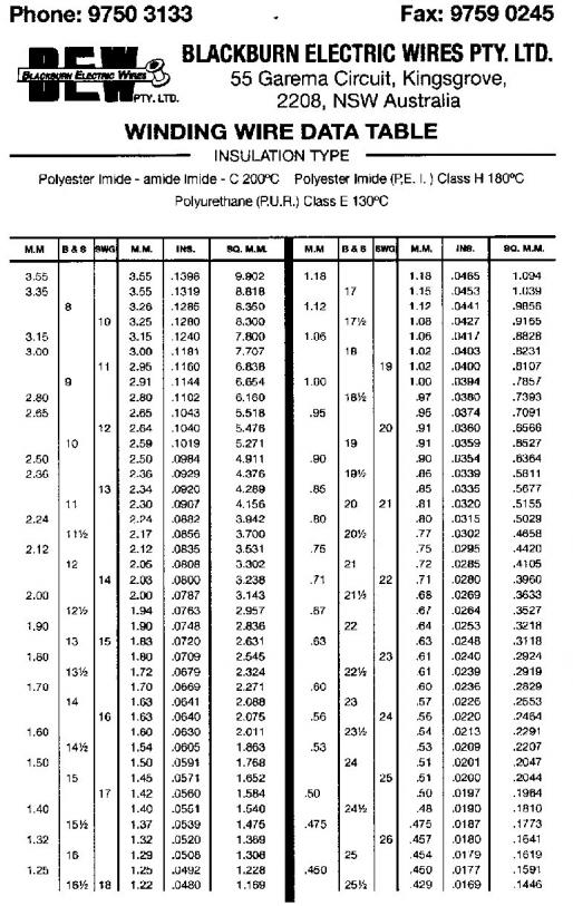

        Can you please tell me what the ohms are on the AWG#20 and the AWG#23. On the chart i have the AWG#20 = .91 and the AWG#23 =.61, the reason I'm asking is because i have found a company in Sydney that sell peai grade 2 which is rated to 200 deg + the problem is that the closest to AWG#20 is .90 and AWG#23 is .60, even though they are very close I'm not sure if it would make a difference to the end result of 130 feet.
        Best Regards,
        George N.

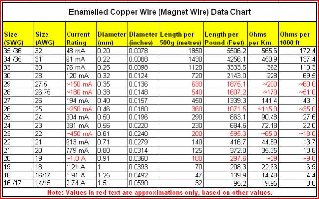

                Oh, and here is the chart I use that I did years ago. My chart matches my measurements and the wire from my supplier.

                Looks like your chart is in SWG, not AWG.

                    Hi John
                    Thanks for your reply mate!.. yes your very correct SWG. 20#AWG = 0.0320 x 25 = .80mm
                    24#AWG = 0.0201 x 25 =.5025 say .50mm
                    I found a table that gives ohms per 1000 feet
                    20#AWG = 10.13 x 130 feet = 1316.9 divide by 1000 = 1.3169 ohms
                    24#AWG = 25.67 x 130 feet = 3337.1 divide by 1000 = 3.3371 ohms
                    Cheers,
                    George
