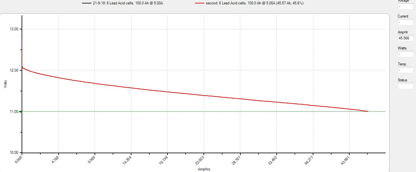

        • #19
          I have removed the scalar wheel and replaced with an identical North out wheel.
          18 Magnets with 8 x 18ga x 8 filar coils.
          Generator Mode
          10 ohm trigger
          128 hz Single pulse mode.
          230V peaks at 5V scale on scope.
          1.8A per coil
          430 RPM
          Air Gap 12mm (scalar magnets 25mm larger diameter wheel)
          I replaced a cluster of diodes with one 150A diode to better handle generator mode. (7 x 6A didodes were running about 90C)
          Primary Draw after 1 hr battery was at 12.049 indicating that it has used around 9ah max.
Name:	Primary Draw1.JPG
          Secondary discharged 45.6ah.

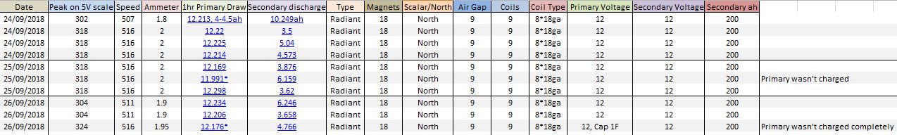

              • #22
                Testing the north out wheel has varied results.
                Primary draw has been fairy constant which has been good at an estimated 4-4.5ah.
                Secondary output has been all over the place without rhyme or reason.

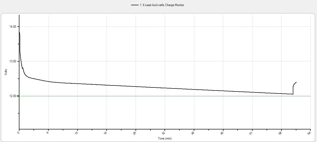

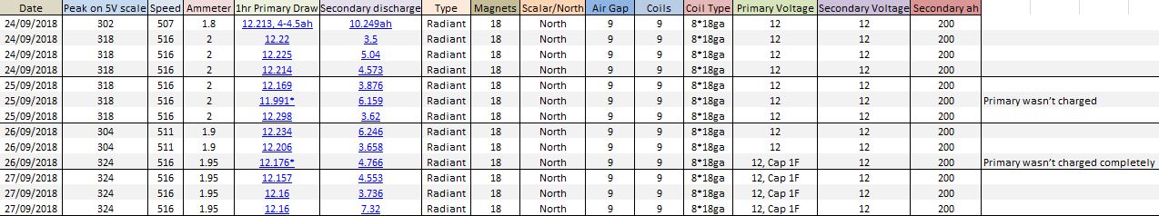

                    • #25
                      I put a super capacitor across the primary to help it out a bit.
                      The primary drew more power but im guessing this is because the machine can actually draw as much as it wishes now.
                      I will replace it with an electrolytic type to get rid of the balancing circuitry in the super cap.
                      Secondary discharge was again inconsistant ruling out the primary source as the issue.

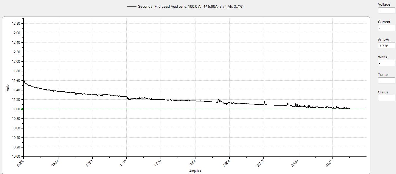

                        • #27
                          Yaro,
                          I dont really have specific resting data but I can give you starting voltages of the load test.
                          I havent focused on battery chemistry yet.
                          Starting voltages are as follows.
                          1. 11.524, 4.553ah
                          2. 11.781, 3.736ah

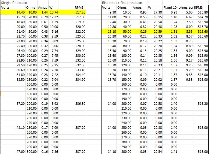

                                The generators parallel (32 wires) were putting out 75V peaks into a cap bank which i used various loads to monitor how the machine reacted.
                                Maximum speed no load was about 540rpms.
                                Maximum speed short circuit was 511rpms.
                                Maximum speed at maximum output of 20W was 516rpms.
                                So for a loss of 23rpms I could power 20W of loads with little change in Secondary charge.
