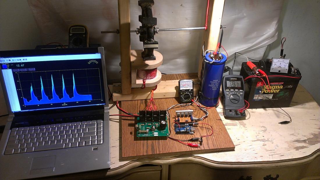

I have setup my monopole in a new configuration based on the information Mr. Bedini gave in Part 33 of the energy series and I wanted to share.

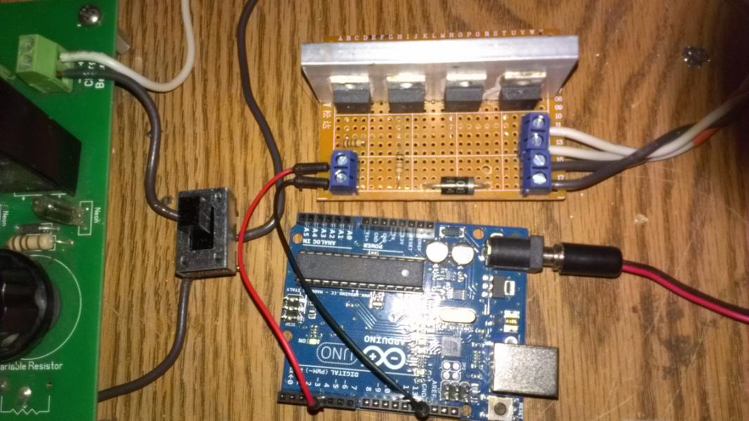

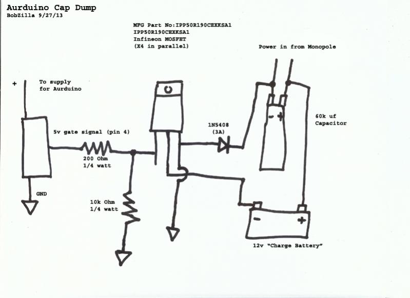

This is not a true Mode 3 because it is not using a comparator circuit however the results of what I am doing are pretty close. The difference is that my system is timed by a micro controller for which I can code the off period and the on period of the control signal which dumps the cap. The timing is completely adjustable.
The following test runs were done to emulate what Mr. Bedini showed in the video as closely as possible. I am charging the cap to 25v and dumping to the charge battery on the negative rail, positive is connected parallel from the cap to the battery. The monopole is running in generator mode, so we have what Mr. Bedini showed with the acceptation that my cap triggering is different.
The duty cycle is set as such (coded on micro controller)
1.5 seconds OFF
0.5 seconds ON (when on we are dumping the cap)
At the speed I am running the monopole this charges the cap to 25v and then dumps a 4A pulse and then it repeats.
I would estimate the primary draw is between 1A - -1.25A. It is hard to say because it jumps around on the meter. What is not shown in the video is the additional draw of the micro controller because it is hooked directly to the primary and not through the amp meter. It pulls around 40ma to power itself and provide the gate pulse to the Mosfets.

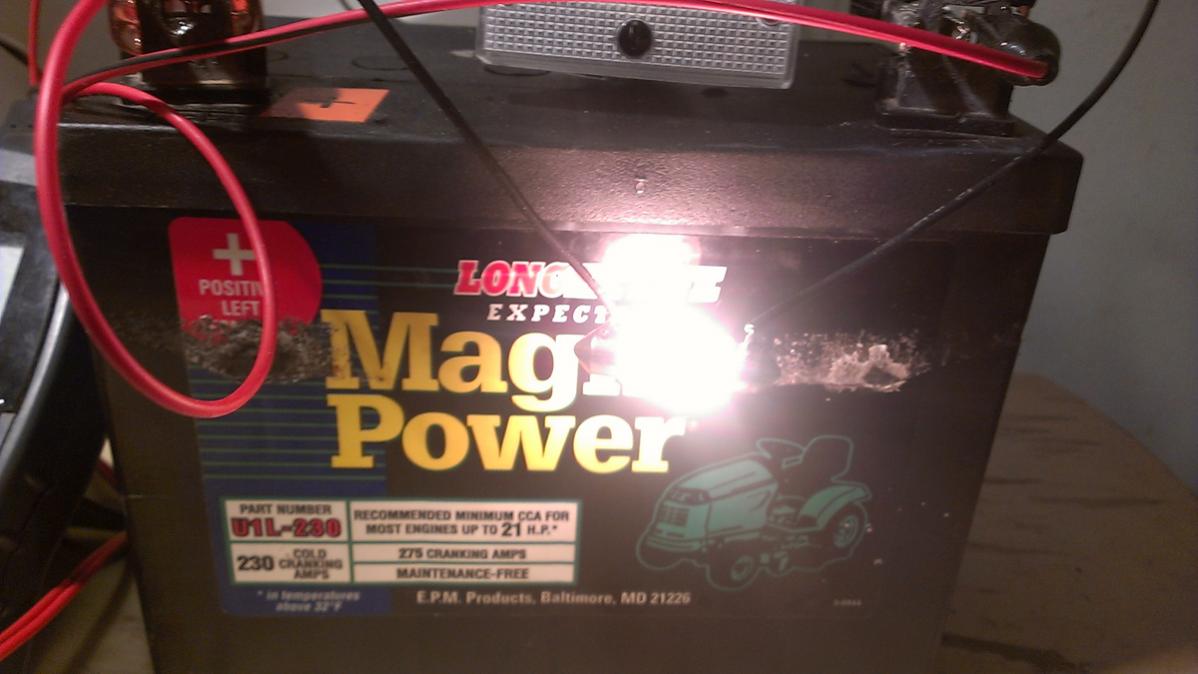

The charge battery is a typical Garden tractor type. This battery was brought back from the grave by a different machine but I mention it because this is not a new battery. It was given to me after years of service in a friends tractor until it would not start anymore and the battery would not charge for him ;-)
The load we are using is a 13.5v,,, 5Watt automotive interior lamp.
The capacitor is 60k uf in a single package. Notice the shape of this cap, tall skinny like a flash cap.
Here is a wide shot of the whole system on the bench.

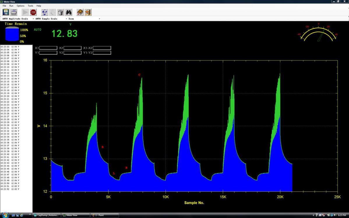

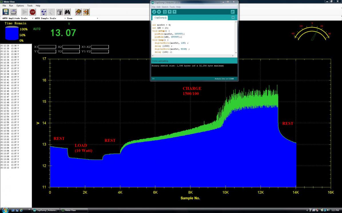

The chart is showing five complete cycles done consecutively. Each stage is 1000 seconds which you can see at the bottom of the chart. That works out to be 16.66 min each.
I have marked each stage on the chart so you can understand what you are looking at.
“R” This is a rest period (1000 sec)
“L” This is a load period (1000 sec)
“C” This is a charge period (1000 sec)
So that is a complete cycle of which we have five of them on the chart. The battery was pretty well charged to start with. This chart is to show pulling a load and charging back up then doing it again. It is not intended as a chart for looking at a full charge cycle from dead to charge. In fact I did not let these charges peak, it was based on the 1000 seconds per stage to keep everything even.
