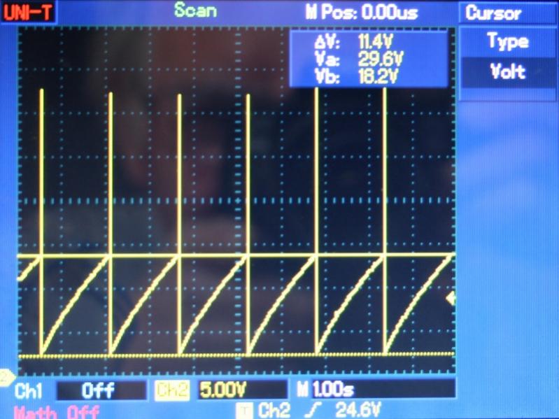

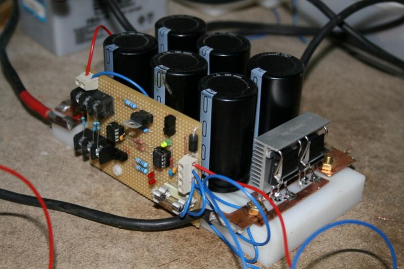

I finally got my cap pulser to work as designed, I got through lots of mosfets on the way.
I am testing it on a 12V system on a bike wheel first.

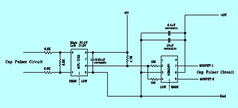

The caps charge to 29.6V before discharging down to 18.2V into the battery. These voltages can be changed
by replacing the 3 resistors in the terminal blocks.
These resistors can also be changed to use the cap pulser on a 24V system.
6 x 10 000uF 100V caps
2 x IRFP260 mosfets
1 x dual mosfet driver.
2 x IRFP260 mosfets
