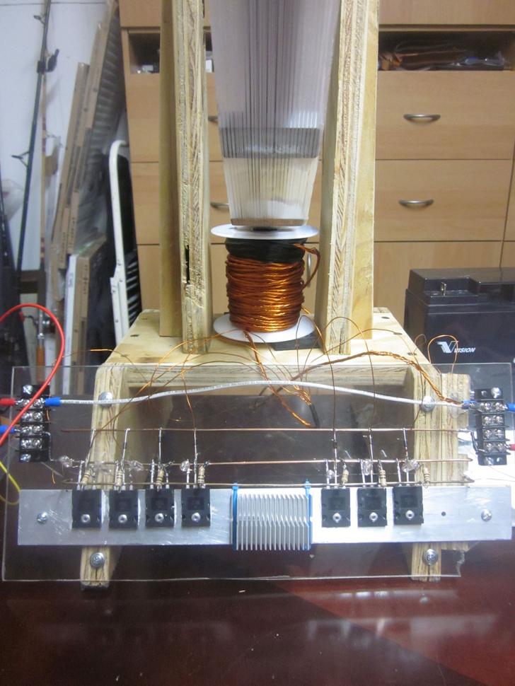

Its alive! My 2nd ssg Thanks John - your a brave soul.
  • Its alive! My 2nd ssg Thanks John - your a brave soul.

      Thanks D Rhodes,
      nice trick with the led timing light. So, the goal is to get it to one concentrated pulse? Will that be comparable to the wave structure I'm seeking on a scope (if I had one)? But why a 330 ohm resister? How is that calculated and can a 470ohm be used?
        OK I built the timing light and using it on the spokes, I don't have the amp meter yet, but I manage to get it down to one pulse, but its wide (broader) than what you were able to get it down to on your video. 19 magnets on a 22in rim. If I go any lower on the pot it feels like its going to shut down. Is it just a problem of the pot being too sensitive (1K).
        Very cool indeed.
          Nice call on the timing! It seems I'm getting more into the charging battery and less out of the primary (more efficient). I already have a bunch of matching resistors to replace into the circuit, I need to build one of those testing devices for the transistors next, but not sure how to build it yet.
            Have you hooked up an amp meter yet to see your primary draw amps vs. charge input amps? Curious what your numbers look like...

                  Until I get my analog ammeter, I tested the amp draw and input with a digital meter and here are the results: The primary battery draw is .61 and the input on the charging battery is .40. Any comments??
                    sounds about right. Like Brodie mentioned, you will see the effects in the battery, not on the meter. Al
