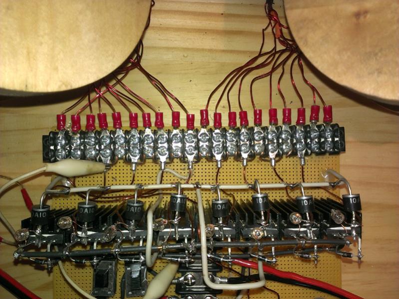

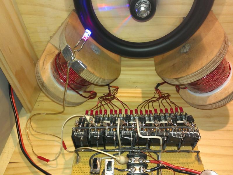

i am tuning my bikewheel with the help of an Led,but if i change the baseresistance with a Pot there is no change of the switching,wich means the marks are allways at the same place.It should switch in between two magnets but it switches allways when the magnet is alignet with the coilcore.I have changed the coildistance from 2 up to 10mm in 1mm steps,no change.I have hooked up the Led with 300 ohm resistor on Anode to Collector and Cathode to Emitter.
My wheel has 46cm diameter and 17 scalar north magnets,the coil is 18awg 8filliar with 7 MJL.The batteries are 22ah for Lawnmover with Calciumtechnology.Baseresistors are 470 Ohm and the preresistor is 5.6 ohm than it draws about 1 Amp.
Then i have changed to 300 ohm and took a Pot but there is no change of the switching angle.
Does somebody know what i made wrong.I have capacitor discharge with SCR, Zenerdiode and 60000uf and it dumps from 25v to15v every 1.5 sec.
