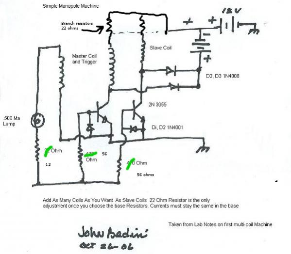

JB has said many times you have to design the coil to match the voltage you are going to run at.
So far as I understand, a 24 volt coil is 1.2 ohms #18 awg. If this is correct then the next step in designing the coil would be to determine
the base resistances used. I have been just using 470 ohm resistors. But I got to thinking about Ralph's machine. I realized we knew almost everything about it.
Even that it was tested at 12 volts not 24. So I was wondering what his base resistors were and maybe some ideas on how to determine what would be a good process
for calculating for any build we may want.
