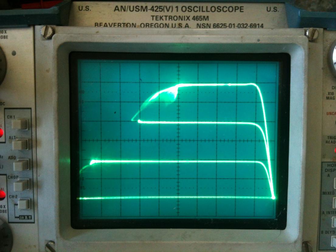

Here is a photo from my scope of curve tracing one of my MJL21194 transistors:
This particular curve tracer is a fairly simple transistor circuit - so for NPN power transistors the curve starts at the bottom right corner of the screen. I imagine the noise on the left end of each trace is due to the simple design of the curve tracer. Each of the lines is nice and flat indicating how stable these transistors are.
From the instructions, it appears the transistor gain is very close to 60. I tried two other transistors - there is an "A/B" switch allowing you to quickly see how they compare. All three were almost identical. I did notice that the longer a transistor is being tested, the gain appeared to increase as it warmed up, so a quick test with them cold got the most consistent results.

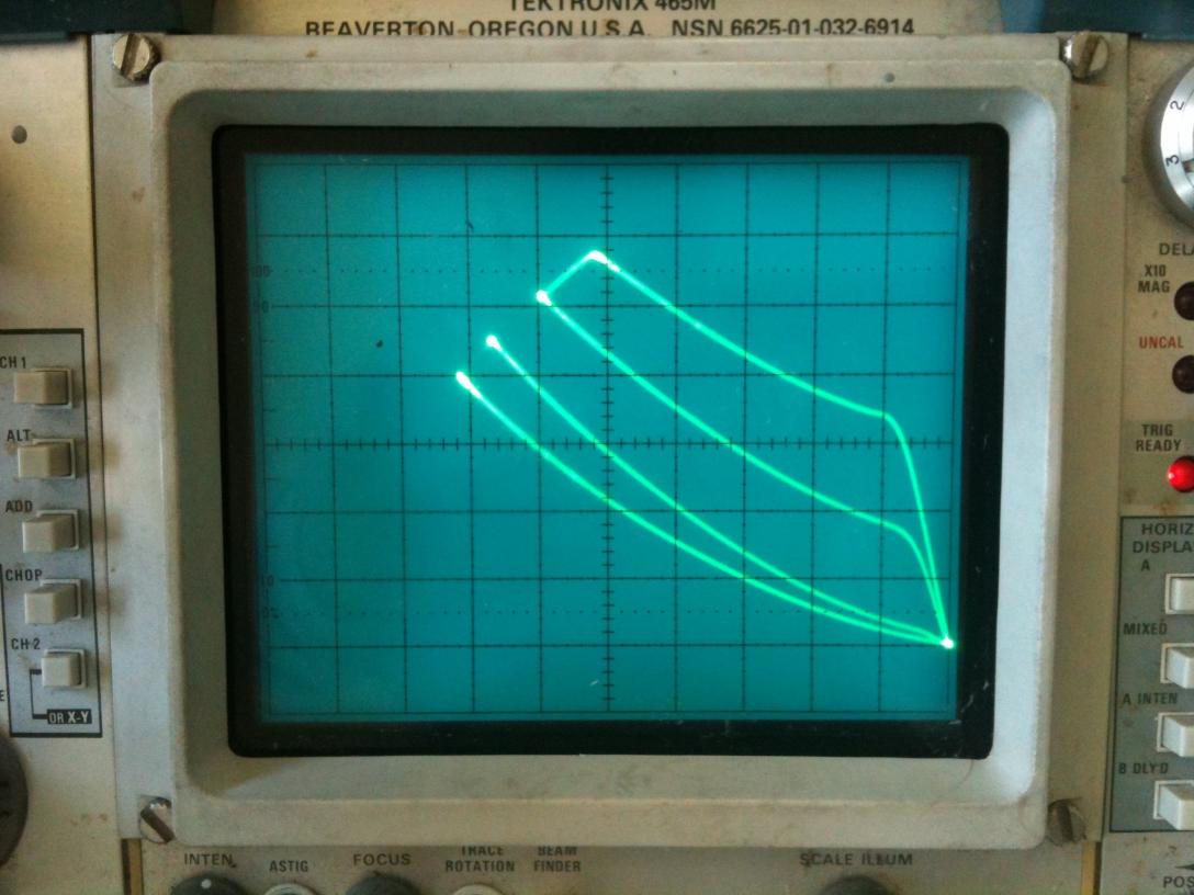

I also took a failed MJL21194 and tested it and got traces showing really bad leakage:
I believe I cooked this transistor by trying to force too much current into the energizer in an experiment last spring
