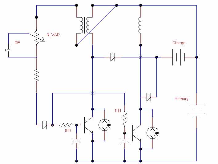

Alright - so here's a vid on taking the SSG wheel and turning it sold state. For those who have not done it yet. it's very simple, you just take the bottom trigger lead, remove it from the primary negative/emitter and place it on the primary positive.
Warning!
before you do this, you MUST increase the resistance to the base of the transistor.
start w/ a 20k pot, make sure you have an additional fixed resistor inline to the base. This will help if the POT burns or you accidently lower the resistance too much.
Hope this helps - Kind Regards,
Patrick A.
I'm going to start to answer your question here to keep the cpd stuff in one place in case it helps others.
I think I understand what you are describing. so when you are turning the pot that is in parallel w/ the cap down/lower resistance, you hear the individual pop pop, then all of a sudden you get to a point where you hear high freq.
This means your cap is too large, you should get the full range like I try to describe in vid 2 here.
so what is happening there at the "point of no return" where it goes into crazy high oscillations. very simple, this is a complementary Parallel RLC circuit. Once you pass the point of resonance you may as well not have the cap there at all. It is doing nothing.
try the same type of cap (I like those) but smaller. Maybe 1uf, I do like the big yellows best for these size coils though.
Remember though we are balancing the cap w/ the power coils. In other words, we do not want the cap so small that the power winds do not fill up. Once you are in resonance, your cpd cap will fill up for free (IMHO).
I hope this helps - Kind Regards,
Patrick A.
By the way I did use a 1uf but not in that video, it also works nice just like the 5.5 but slightly different level, what I mean is it has nice range too but only extremely low input. If you watch that video I do show the primary a bit as I am adjusting. I have no problem getting slow controlled oscillation on the cap but it wouldn't charge anything like that.

I watched your vid again just in case I missed something. I'm pretty sure I understand what you are saying about charging at low freq. You do have excellent control at low freq. Now you need to get control at a higher freq. In order to do that you need a lower cap value.
Since you said you already tried a 1uF, other things that come to mind are: The branch resistor, are you using one? What is it's value? What is the value of your individual base resistors? Maybe you could steal a wind to put in parallel w/ your trigger winding, you might not be getting enough "umph" (did I just say that :-)
What I go for when I tune this SS it to give a good smack to the base of the transistor, not too long not too short and with enough strength to connect the emitter and collector quick on quick off. I try to do this as much as possible at resonance so the switching is free.
OK, I have much more to say, however, this post is getting long and confusing I think... I'll wait for more info.
LMK - KR,
Patrick A.

Hi Bob,
before you abandon ship, give the extra trigger wire a shot w/ the 1uF and a branch potentiometer. There is more balancing to be done w/ the mod than at first glance.

While I did not get to hear bob's coils w/ the 1uf cap on. I've been doing some more long runs on the wheel so I had some time to investigate some other situations that might cause your system to hit the point of no return too soon.
a couple of things,
Burnt POT across the cap - I happened along this one as I was trying out different sized POT's. Since the pot was the only thing I changed, it was easy to pinpoint. Put the pot on your ohms meter and sweep it making sure there are no little hops.
This software and a mic was as useful as a scope in finding the burnt spot. It's very easy to burn these pots if you're passing too much current.
make sure and have a good branch resistor - see below...
The second thing I found was if your Branch resistor is too small, both in watts and size it's pretty easy to skip a whole range of pulse frequencies. I have a 2 watt 5k POT for this 4filer and it works very nicely.
Third and most obvious for most - loose wires, bad solder, BREADBOARD. I like my bread boards, but they have too much metal too close and they create too much capacitance between rows for these ckts. Many times this will interfere and cause strange things to happen - some good most badddddd.
Another very cool thing to try is get it working w/ 1 transistor, then add one power winding on at a time, monitor your batteries, the pulses and the temp on your transistors.
