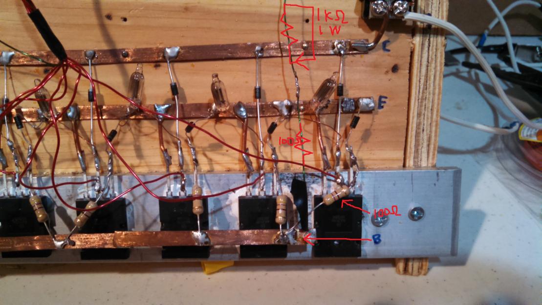

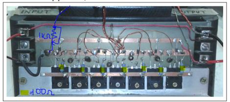

I would like to do the fine tuning described in the intermediate SG manual. It mentions after haivng matched transistors and testing for 7 100ohm resistors of exact values then only a single 1kohm 1w pot is needed to adjust for max rpm. What would the schematic be for this? Thanks!

The picture is real small, hard to tell what I am seeing but it looks like you have the proposed pot at the trigger bottom going to the emitter? If so then that is wrong, you want it before the base on the top side.
So from your base you would have the 100 Ohm resistors which bus together, then you would put that intermediate resistor which just assures some resistance when the pot is fully open or if it shorts, then the pot which has the trigger top connected.
Looked at the picture again and it may be right, just can't see it well enough.
Yes only one and it is in series with the trigger wire. See what it does is allows variable resistance on the trigger wire on it's way to the base, that's it really. That will affect how much your transistor is opening the C to E path.Since the pot goes in the trigger wire, is that why only one is needed or does there have to be one per transistor somehow?
