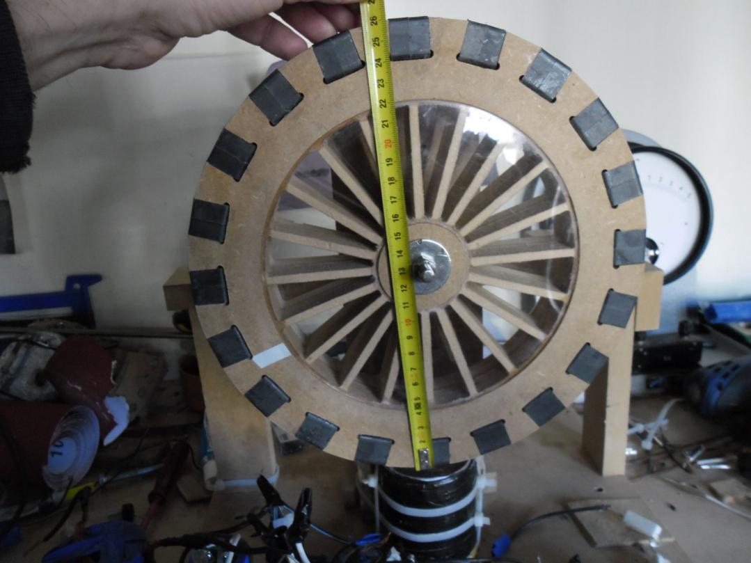

About the superpole magnet distance,
Today I finished my new 9" 20 magnet SP wheel weighing 2,4 Kilo. I first put only 10 magnets on the wheel and it run at 570 RPM and pulled over 600 mA.
And the charge was real good. After that I mounted the additional 10 magnets so I had 20 SP magnets on the wheel.
So the wheel is now almost doubled in weight but instead of less RPM to maintain the same coil freq it went up a lot. It run at 924 RPM and because I could
not go up in base resistance it stayed there but I can go over 1000 RPM I think. I also expected more input current at this higher speed but it went down
a lot. It run at 924 RPM at 360 mA and charging was about the same as with the 10 magnets on it.
The gap between my magnets is about the same as the distance of the combined magnets.
So my conclusion is that more SP magnets is far better if you keep the gap between them small.

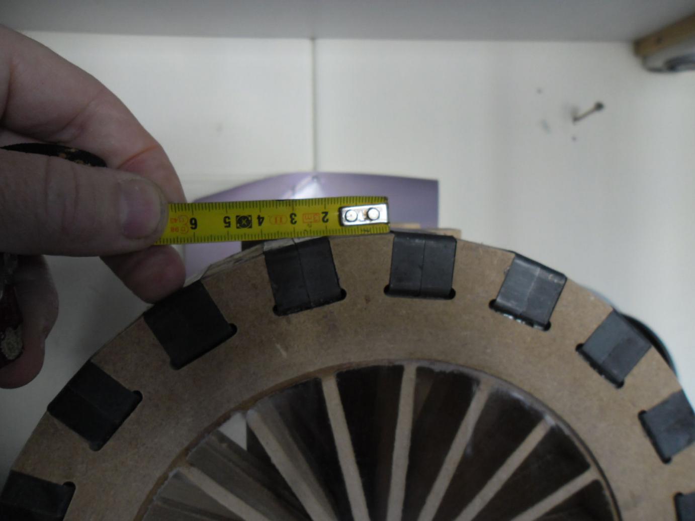

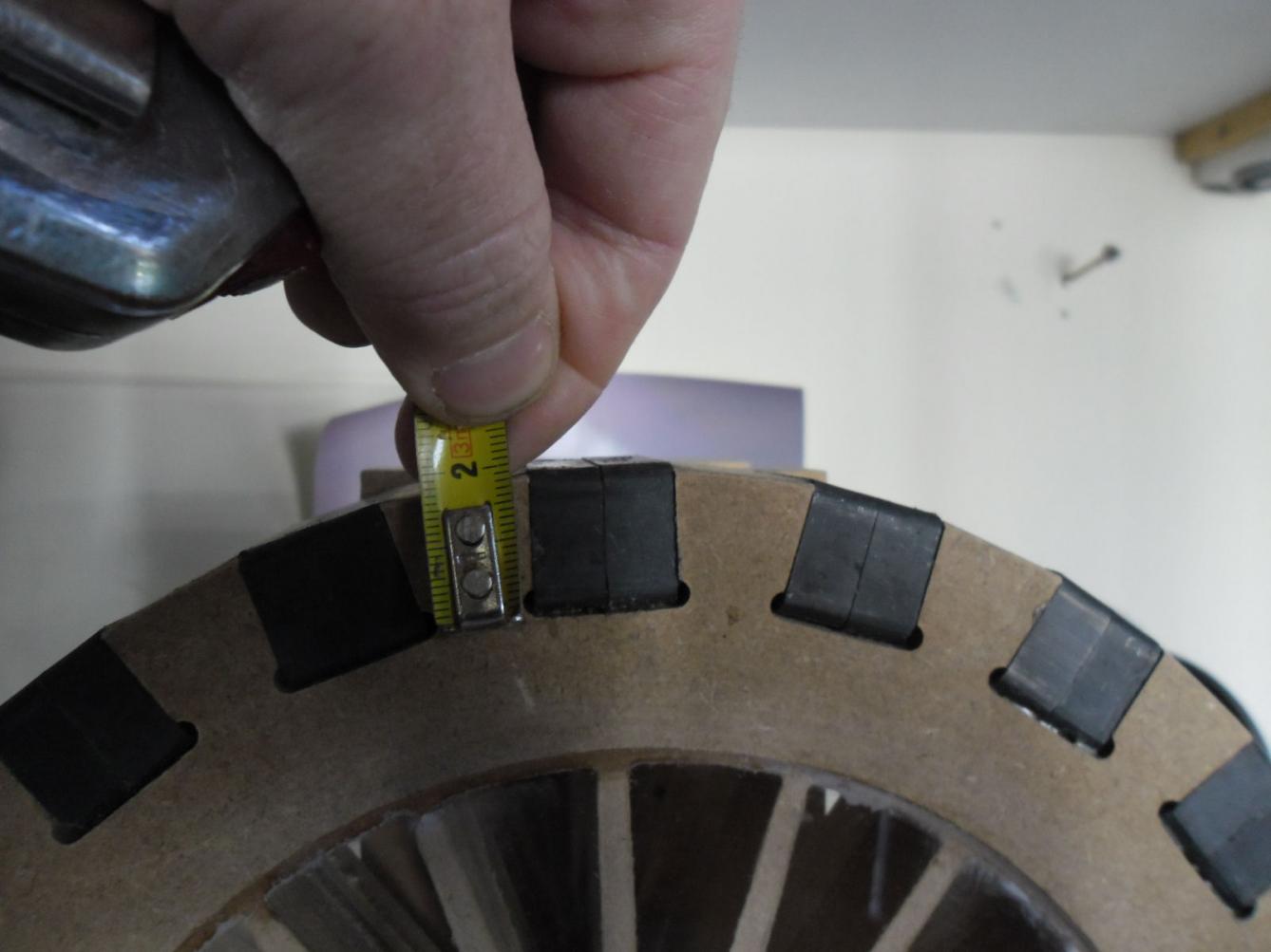

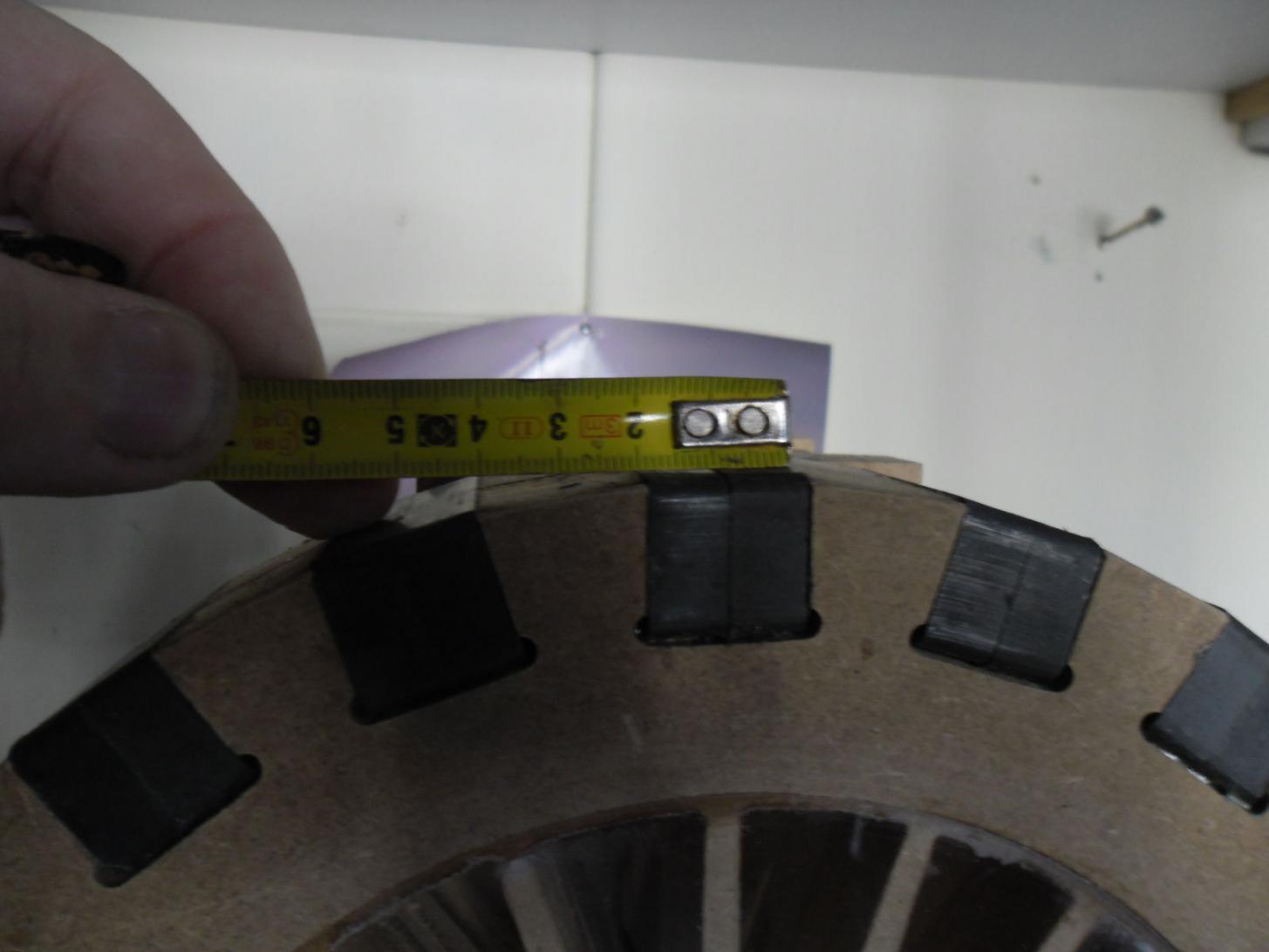

Can you give me the measurement between the outer corners of adjacent mags. It sounds like your distance reference is center to center. It sounds like the distance between 2 mags pairs would be less than .5".
Thanks bro d
Hi Bro d,
This is what I can offer, it's in cm because I live in Europe so you have to make some conversions.
The magnet_pairs are 2cm x 2cm x 4cm the gap between is also 2 cm on the outside and the diameter of
the wheel is 26 cm so around 10 " I guess.
Karel[/QUOTE]
Thanks Karel for the info and pics.
Looks like CNC quality.
Beautiful work.
I have a mill, drill, lathe and can turn up to 13"
Ready to go again with matched mags and components.
bro d

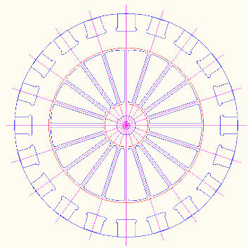

Bro d,
It is CNC made, if you are interested you can see how it is made here: The making of the new 20 SP magnet wheel - YouTube
Karel
