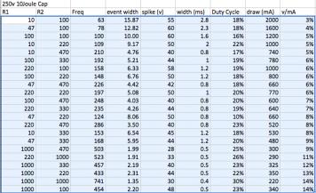

Not sure if this picture has attached or not, but I'll tell you what it is.
I have a 8 filar (one trigger 7 matched circuits) #23AWG coil I got from rcharge that I've set up in SS mode using the CPD modification. I used a 250v 10joule cap parallel with resistor one and they are in series with resistor 2 which leads to the diode and from there to the bases of the circuit boards. I kept everything the same except R1 and R2 and noted changes in the frequeny, voltage spike, draw and width of the square wave. I calculated voltage spike/amp draw and found a large variation from .03v/mA to .14 v/mA. If anyone has experience with setting R1 and R2 with this configuration and can give advice, I'd be grateful.
thanks,
