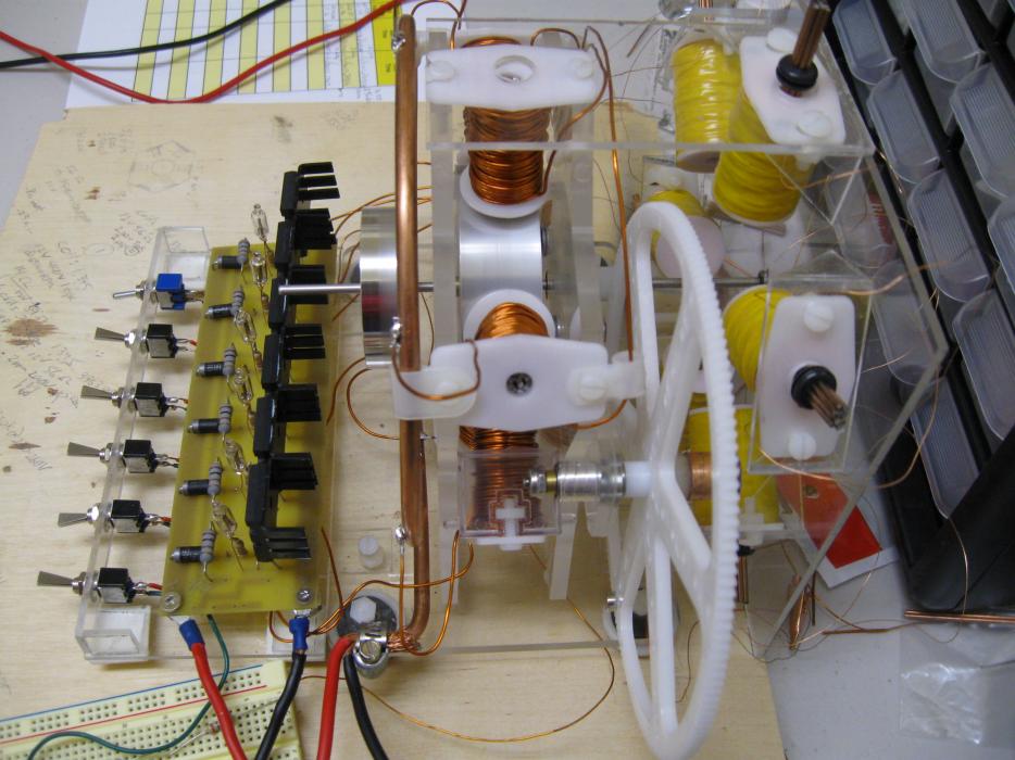

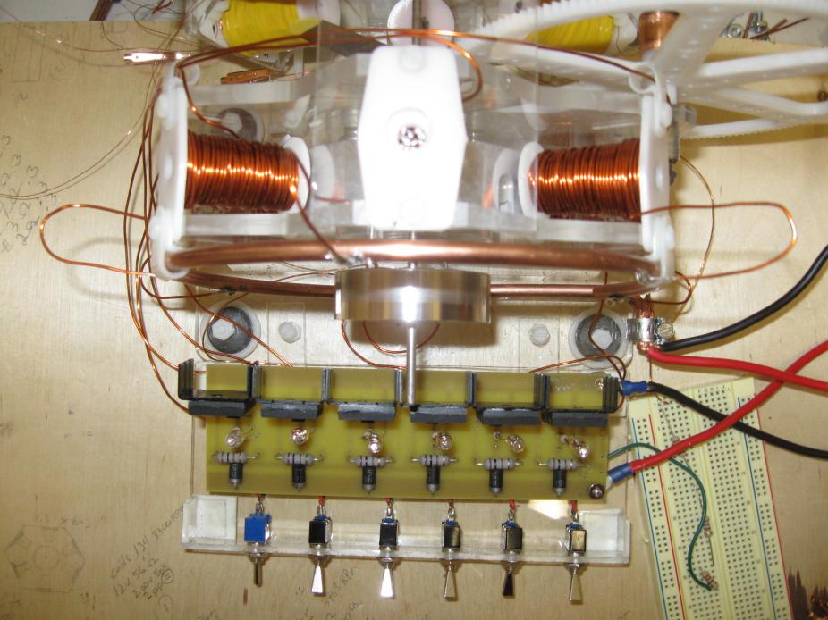

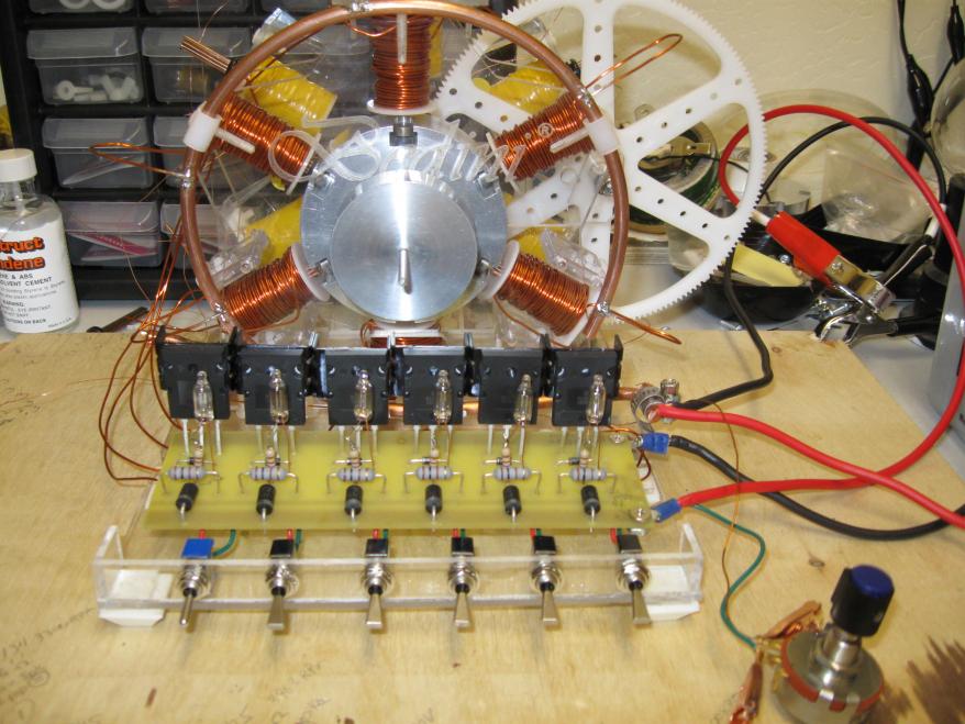

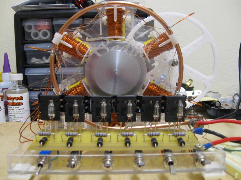

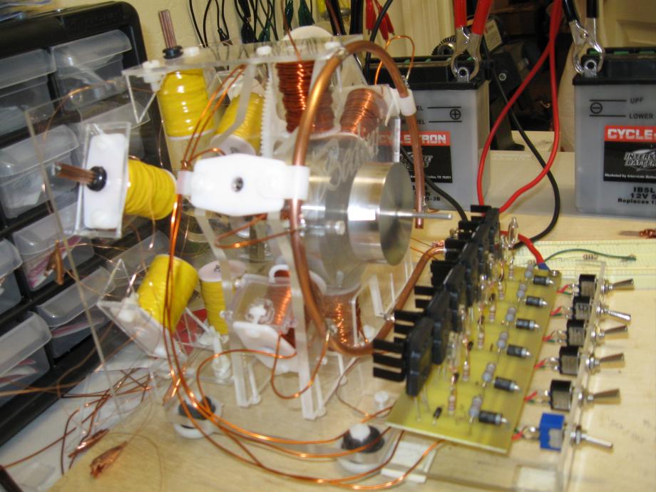

I finally have a build that will charge a single identical battery with a single charge! It is my old mini 6 pole that has been rebuilt with 19 awg motor windings, and 23 awg trigger. I am running it with only 4 coils activated, as this seems to be optimum for running at 12v. I am getting 410v spikes, with 2 pulses per magnet. All components are running cool, including the charging battery. The unit starts at around 3900 RPM, takes about 3 hours or less to charge a 5ah battery, and at the end of the run the RPM is at about 2950. I am getting battery COP's of over 2 with both 5ah and 9ah batteries!
Here is a pic:
