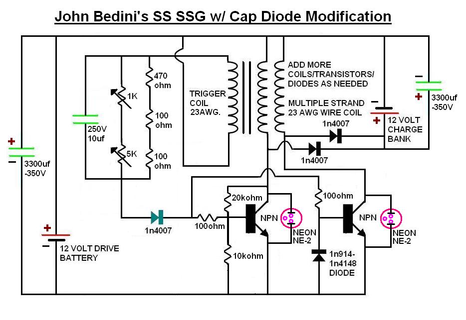

First I'll describe the setup. It's an SS SSG with CPD mod as per Patrick's (min2oly) schematic. My goal with this is to be able to charge and restore medium to large sized car batteries (at least 75AH). The components used are:

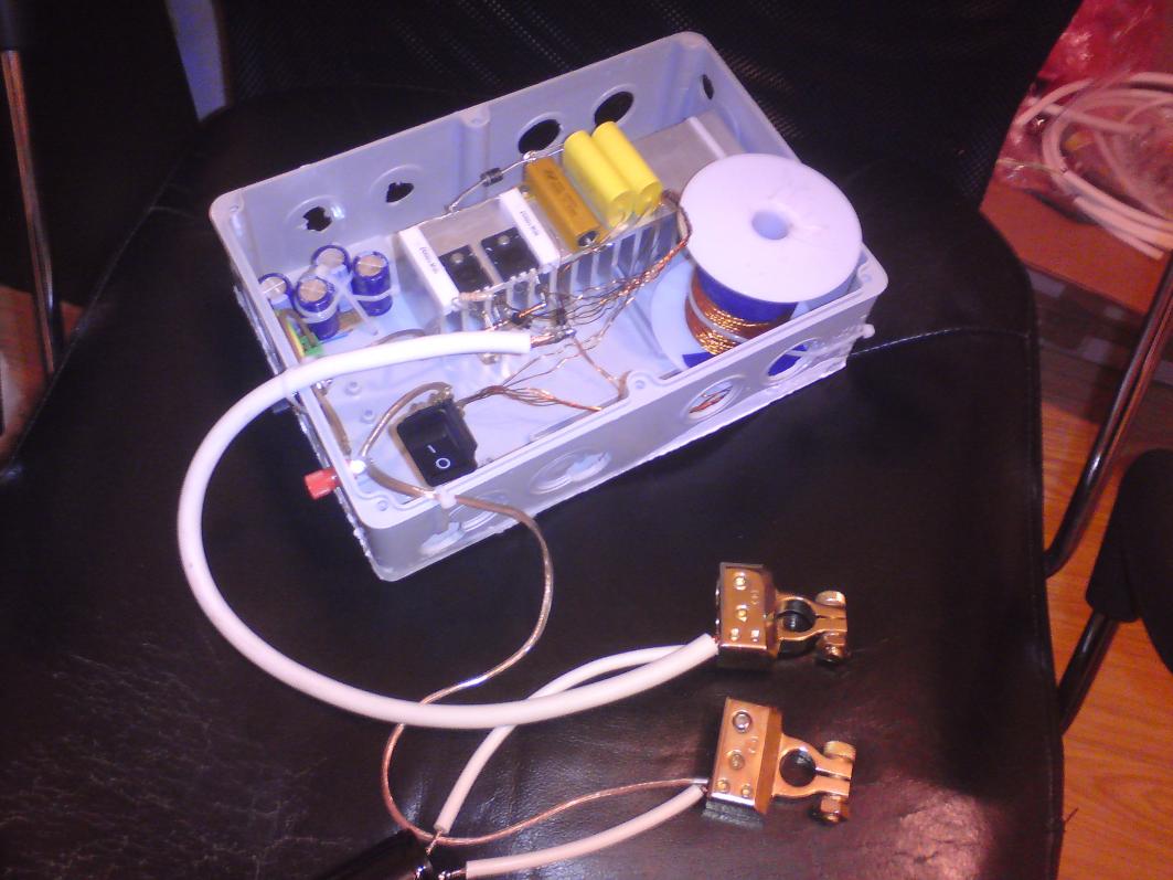

The coil used is an 8 filer with 0.562mm diameter (close to 23 AWG), approx 280 turns, litzed. Each strand is 40 meters (~130 feet) with a resistance of 2.8 ohms and an inductance (air core) of .914 mH. I used this coil previously with another setup with 7 MJE 13007, but those were not matched. The trigger is 2 of these strands, and each power winding has 3 - with the resistance measured at 1.1 ohms (I know it doesn't add up with the previous measurement). It oscillates at 1.35KHz. I also tried 2 strands per power winding and the only difference is the frequency goes up to about 1.5KHz. The problem is the coil gets pretty hot and I can't say the charging is great either. I used this wire because I had a big spool available on hand.
