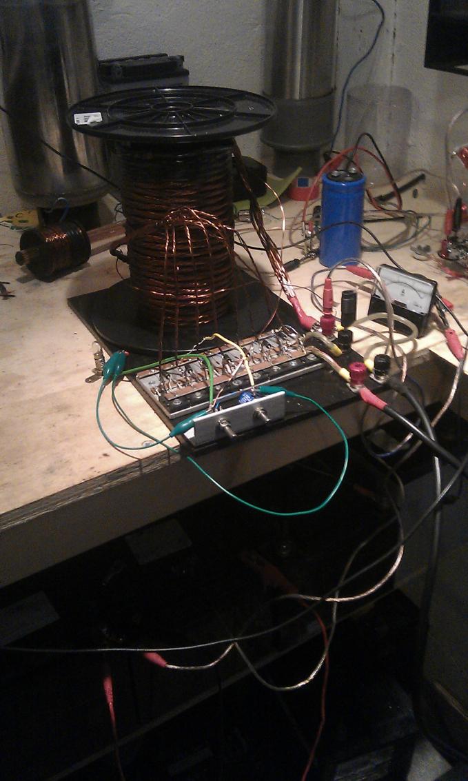

Been working in the shed building and testing a new large coil I made to run solid state (SS), or perhaps rotored later, and see if large is better. The coil, for now, is about 10cm wide x 20cm high, aircore. It has 25 x 130' #18 magnetwire twisted together.
It has been interesting to test it in various configurations and work towards a 24 branche system with 24 transistors all components matched . However, that will need to wait until money permits.
At first I first ran all 24 wires on one transistor, 100ohm at the base and with a diode to 2x50Ah batteries. From the base connected through a diode then two pots (1k), 5K) in series with a cap across, the triggerwire connected to plus. I use no B-E diode in SS mode. Very basic setup that appears to work best. The frequency range I have seen is somewhere around 50 Hz to 25KHz. I have seen good charging at 200ma with 5 or 16 Ah battery. But It also chargers well between 1 and 2A with the right batteries connected and all components stay cool. Surprising.
But OK, currently it runs with 8 MJL's thus 3 strands per transistor. With 200ma per transistor it charges a battery pretty much one to one. That is OK for starters so now I focused my attention to building a large cap dump setup. I will tell more about the setup later as there are more topics that I believe are worth sharing. Things like the "One wire change", batteries, SS tuning and cap dumping.
