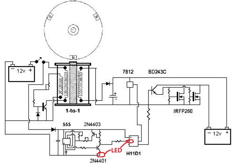

i have build the SG with compacitor discharge with this diagram , and it's working right now , but where should i put a LED in series in the circuit ?
i tried to connect pin2 of H11D1 to ground,the LED is always on , i measured the voltage with a multimeter , the voltage circulates between 10.23v - 12.15v
so ,of course the LED will always be on , i don't think it is the right way to see the pulse signal...
do i need a 12V LED ? or a 2.2v LED in series with a 510 ohm resistor is ok ? please help me , thank you very much !
