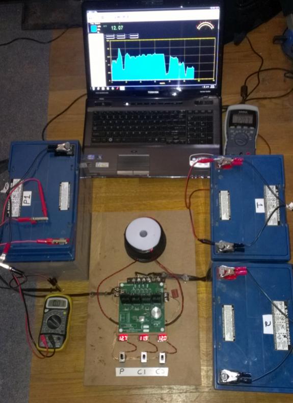

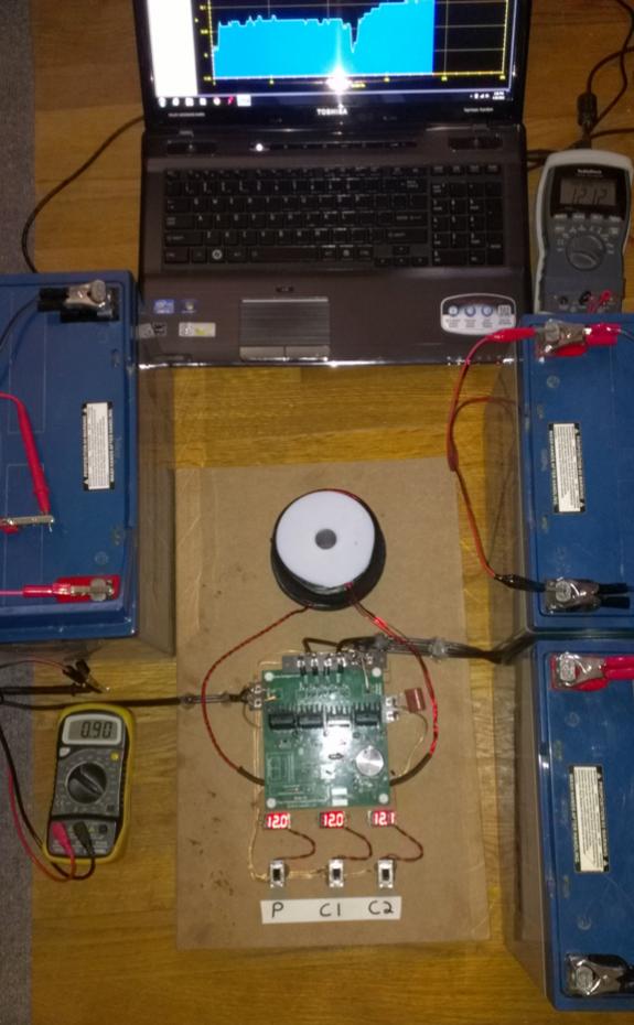

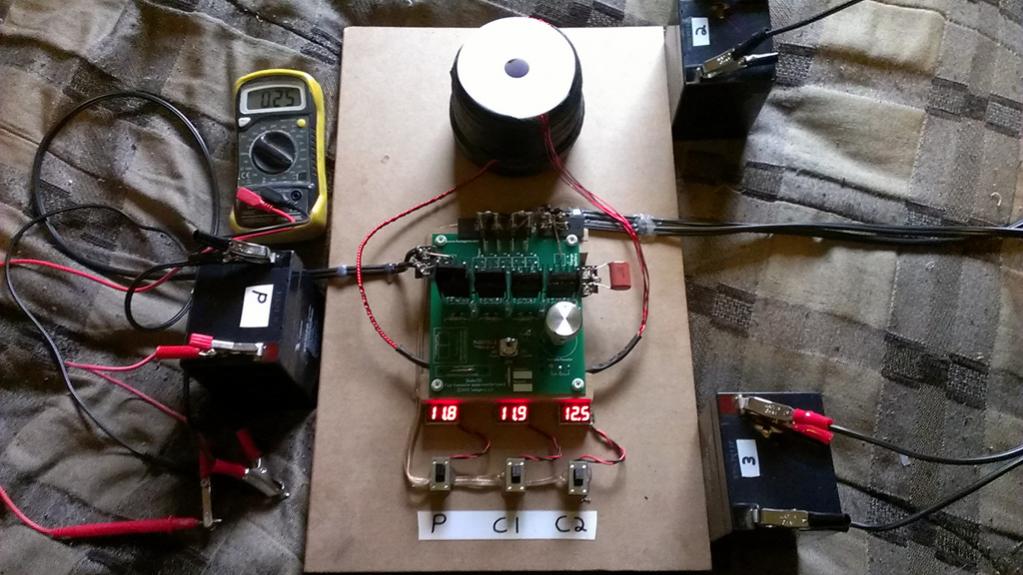

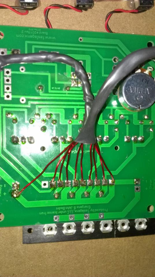

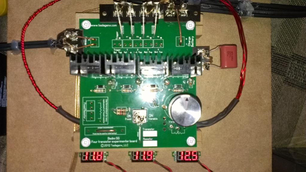

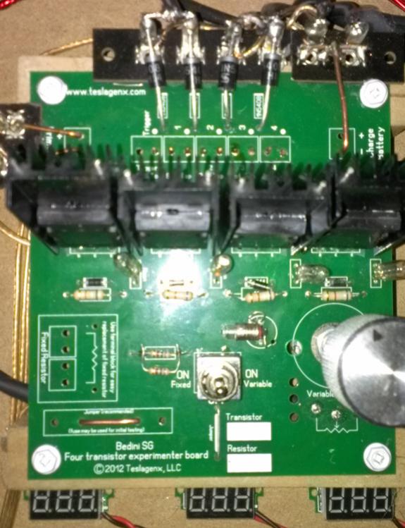

I have constructed a new Solid State energizer and I thought I would share the details for those who are interested.
I have used a TeslagenX circuit board in this build which works VERY well with a little modification. HUGE thanks to Tom C and the guys over there. I highly recommend them!
First off let me just say that I am not responsible for any mishaps if someone tries to replicate what I have done. With that said I am providing as many details as possible so that if YOU choose too try I can get you in the ball park.

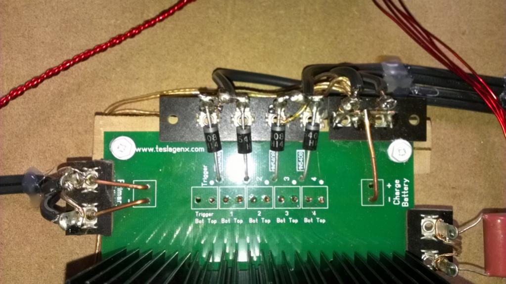

Before I get into the component specs let me explain a little about general operation. I engineered this to have four branch charging legs independent of each other. As you will see in the picture I have combined the outputs with a little bus bar into two sets. If I were to remove those bars than I would have four outputs but I choose to combine them for two sets of independent parallel outputs. It is designed to charge two batteries from one primary. I believe that if you want to combine outputs this is where you do it, at the output of the diode, not at the collector leg.
You will also need to move the bottom end of the trigger wire. Normally it is running to the emitter but we need to move it to the Primary Positive/ Charge Negative Bus.
