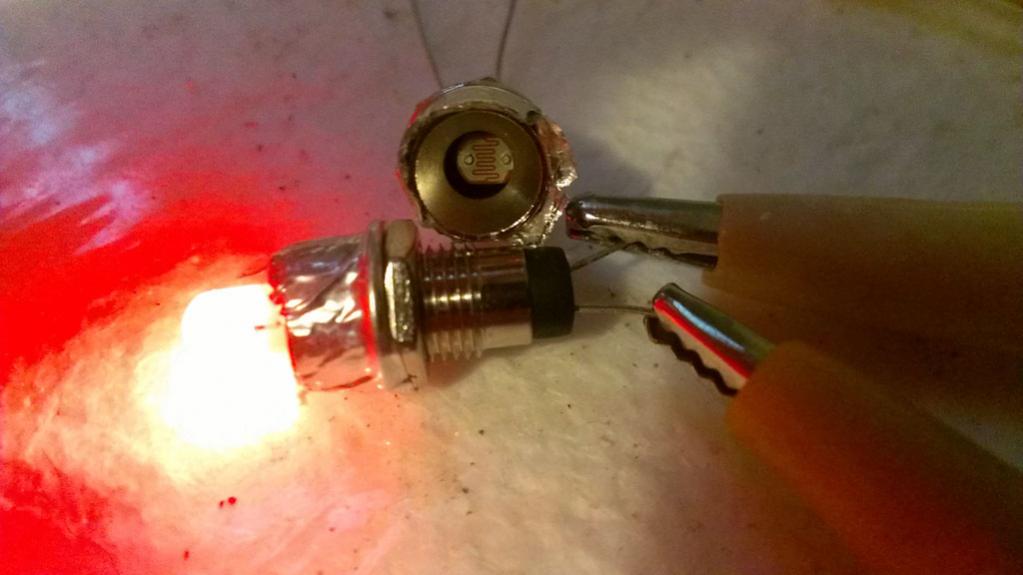

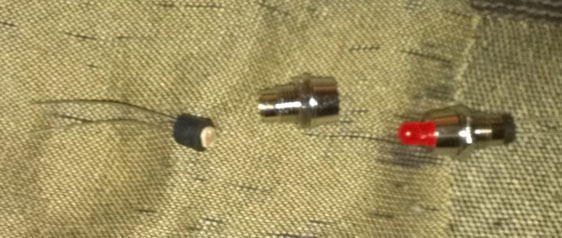

The system is simple, it uses a flashing LED, a photo-resistor and the caps. What I am doing is using the LED in a closed dark chamber to light the photo-resistor as a sort of relay system. When dark the photo-resistor will produce about 2M ohm, when lit very brightly as I am doing it drops resistance to only a few hundred Ohm.
Here are some shots of those parts. The chamber is two LED holders taped with foil so that the LED faces the photo-resistor head on.

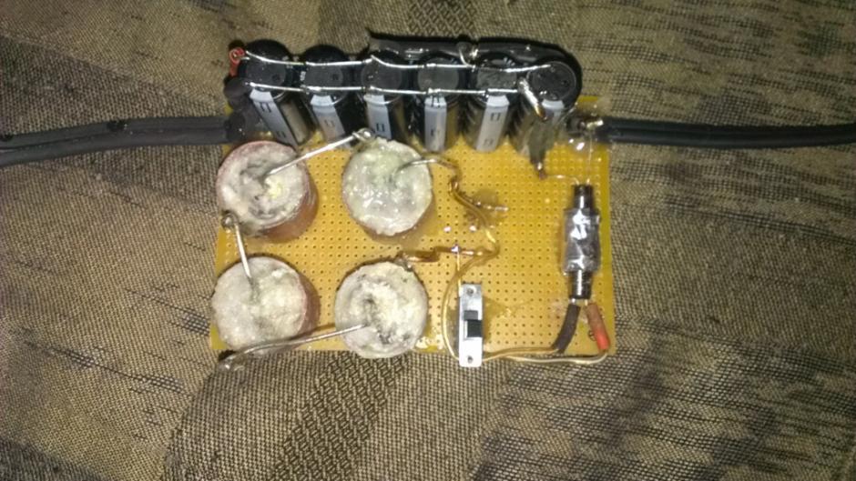

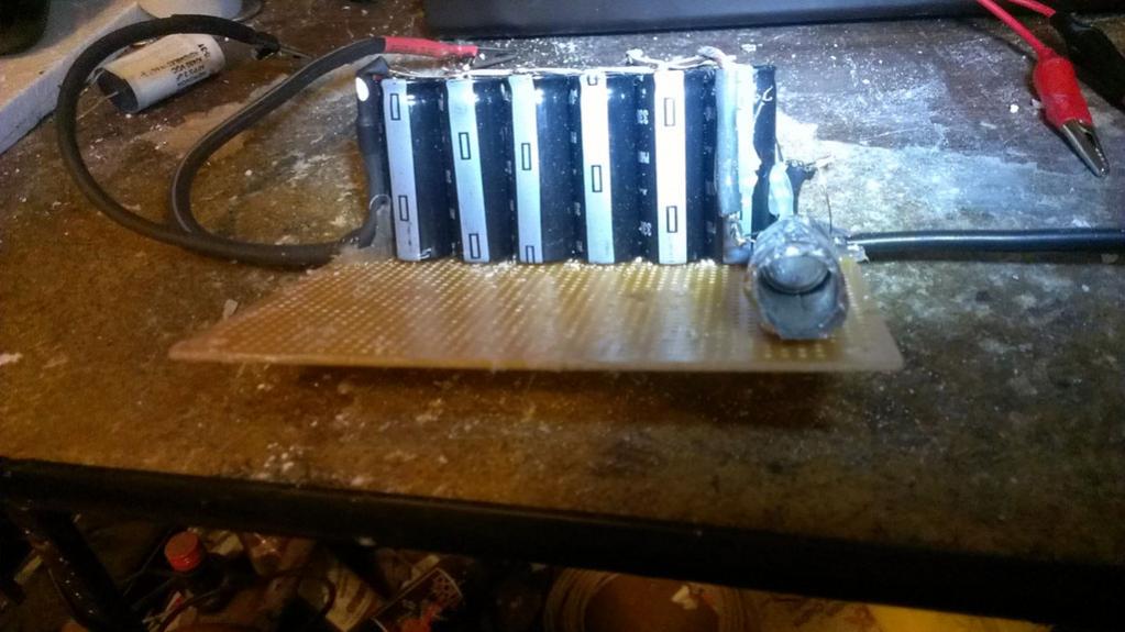

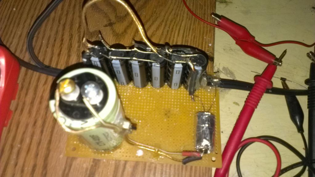

Here is a shot of the board I put this all together on.
Well that's the introduction to my latest experiment. I am in the process of doing some runs with it and I will post back with some data. It does look promising though ---Bob
