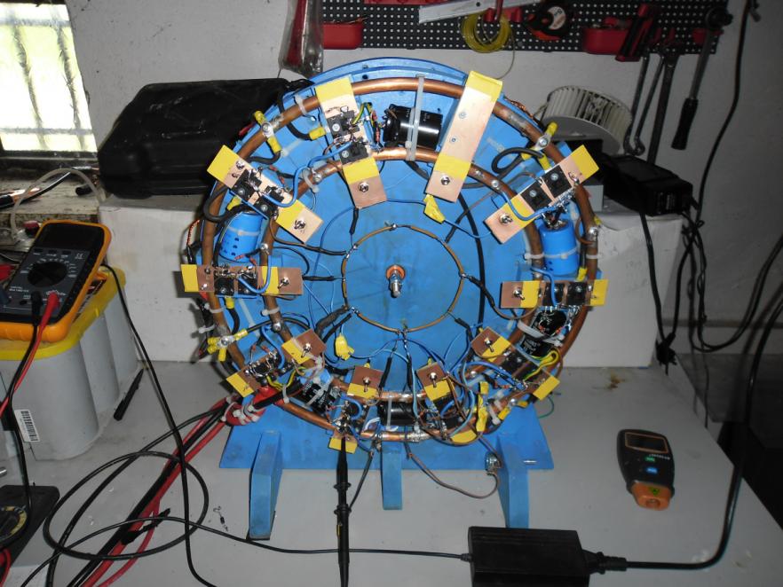

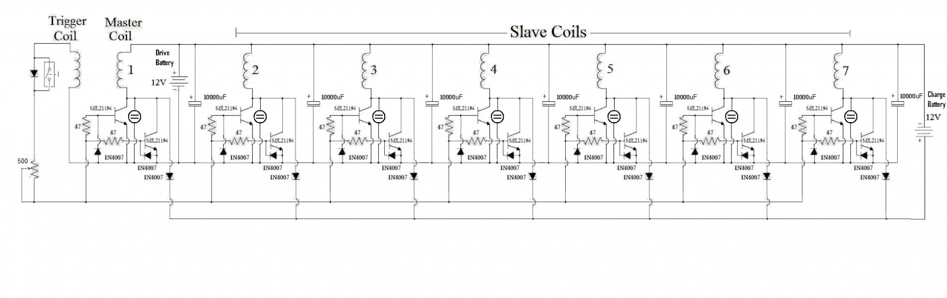

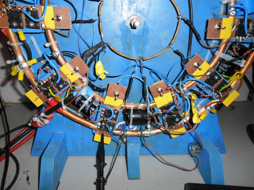

There is one coil with #19 wire all parallel and one trigger same size and the other 8 coils are #27 (0,36 mm diameter) 24 strands all parallel just as pushers.
The transistors are 2 parallel conected to the complete set of wires on every coil.

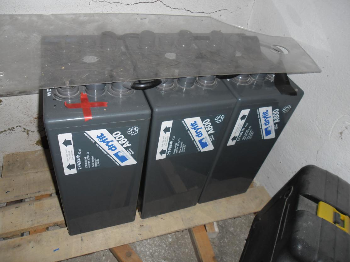

The battery I am charging now is a bank of 6 2volts 500 amp/h in series so 12V at 500 A/h.

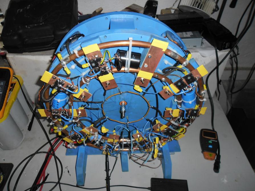

I build the base of this machine two months ago and have been adding coils ever since, started with 1 coil than 4 than 5 and now I added 4 more.
Unfornunatly I don't have the materials to finish the last coil. I just added the last 4 coils 2 days ago and have been testing it
since then. It is running at fasted speed lowest current 1750 rpm and 2,2 Amps but I can also push it to over 3 amps without heating
anything. All transistors stay cold and so are the coils. the only thing that heats a little is the potmeter in the base but I believe
that JB also had a lamp in this circuit so there is same waste of energy here.
I could charge the 500 A/h Batts over 15,30 V but I have not yet drained them so I don't yet know how fast they can charge.

Just want to report some things that I have found while playing with my new 9 coil machine.
I have been using it like it was with everything theoretically balanced and matched (but in real life it wasn't).
It was running at around 3 amps input and the results where not sweeping me off the floor it was just like
one of the smaller machines only I was able to charge bigger batteries and they where not really gaining much capacity.
After reevaluating the things night after night when I could not sleep I was suddenly beginning to
see what it was all about, not just the complete h form was important but only the part where the
transistor is going from the closed state to the open state. When I measured this on all the collectors
I saw that these signals where not very nice and steep, they where all different and there was a jitter and oscillations on it.
I thought to just disconnect one transistor and use just one on the complete coil (which is around 0.6 ohms) but then it
really killed the signal it was very ugly and the transistor heated up.
So here you can see it is all about the right matching of impedance.
I found that I had to adjust the resistor for every transistor until the signal was sharp and steep.
When I did this for all transistors the performance went up dramatically. The input current went down and the
charging was super.
