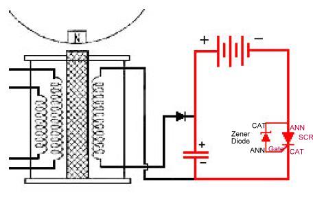

Thank you for your reply and I would indeed like some details as I understand the basic Bedini circuit however adding a capacitor circuit is another step up for me. Do you mean a Silicon Controlled Rectifier that is turned on at the gate by a Zener diode? If so, how do I work out what size/type SCR, Zener and capacitor to use?

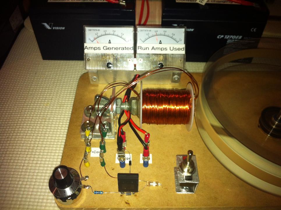

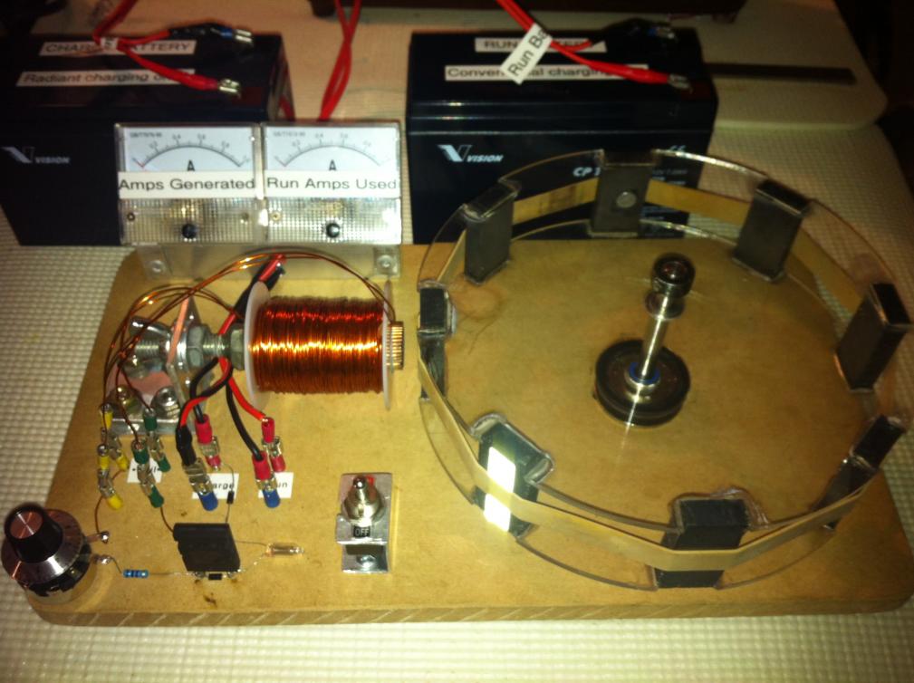

My setup is the basic Bedini circuit with 450 winds of AWG 20 & 23 and the batteries are 12V 7ah.

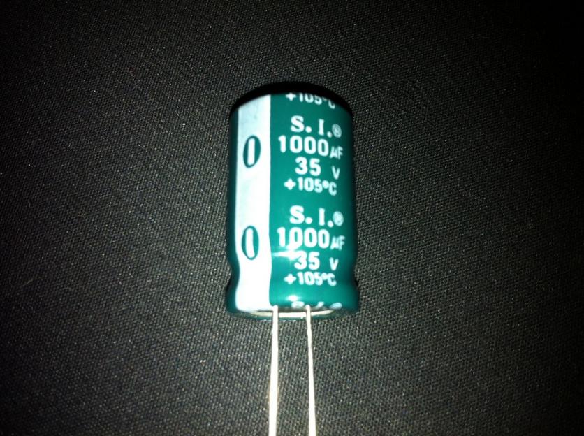

Great! There is a schematic in the book for the SCR based cap pulser. I think it uses an NE-2 neon bulb on the gate of the SCR but you can use a zener diode instead. The zener should be rated at how many volts above the charge battery you want to dump the cap. Start off with a 12v zener as you want to dump the cap at approximately double the battery voltage. Start off with a 1000uF 50v cap. The SCR in the book will work fine.Originally posted by Archangel View PostIf you mean "20 Bedini-Bearden Years Free Energy Generation Circuits and schematics - Yes
Let us know how you go.
Looking at pages 44 & 45 in the FEG I can see the schematic but no values are given. My Jaycar magazine has the following SCR's [email protected] - 400V@4A and 500V@8amp; which should I use?
Regarding the capacitor, would I use polarized or non polarized?
Also regarding the Zener, (assume I know virtually nothing regarding this subject, hence the basic questions
) if the charge battery is 12V and I want to dump the capacitor at approximately double the battery, would it be a 24V zener I would use or as you say, a 12V zener?

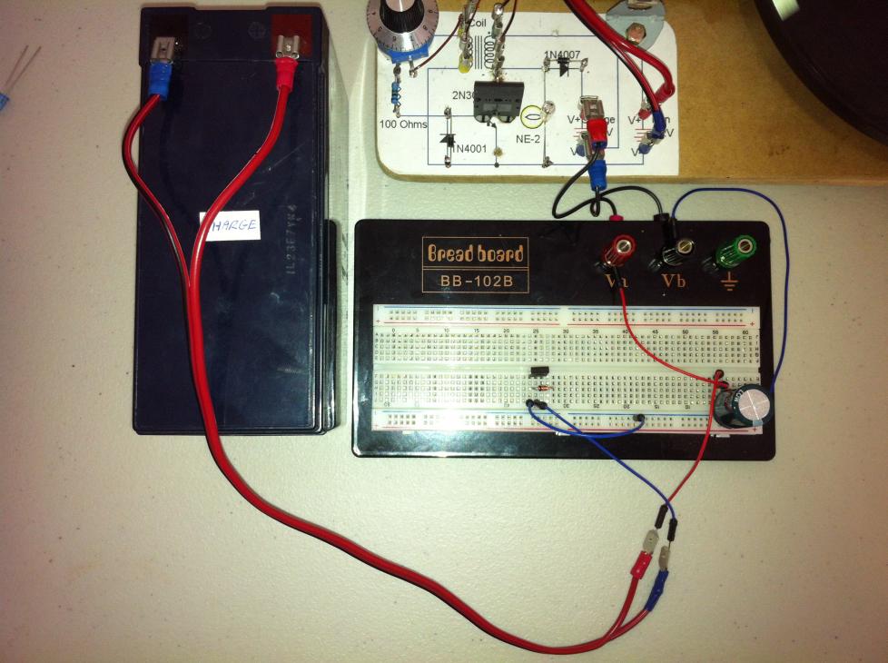

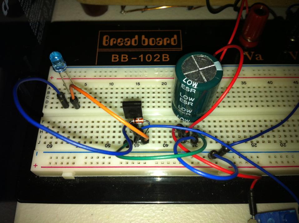

you need to get that bolt out of the coil and put a correct core in there...Originally posted by Archangel View PostHi Guys,
I’ve upgraded one of my Bedini’s and my good friend Leith is putting it through the 20 x 20 charge/discharge cycle, (I like to build them and he enjoys the data logging side.)
Once we collect and analyze the data, (which is already clearly showing that the charge battery is charging quicker and discharging slower,) I would like to add a capacitor circuit and run the tests again.
Please could you recommend a good, basic, efficient cap pulser circuit that a beginner could easily build but would yield efficient charging without consuming too much power? – THANKS!
[ATTACH=CONFIG]2547[/ATTACH][ATTACH=CONFIG]2548[/ATTACH][ATTACH=CONFIG]2549[/ATTACH]
