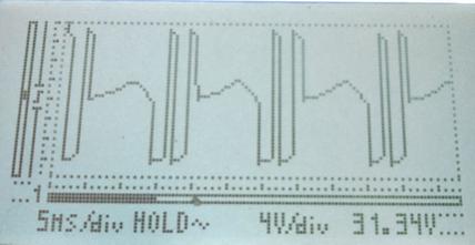

          I have a wheel for 26" and am using 22 Magnets - the rest was almost literally following the beginners book. My input current with 470 Ohm resistors was around 400mA, and the wheel turned 200rpm. After reading the intermediate book, matching the transistors, and buying a scope, the first sweet spot with a nice scope curve was with 465mA and 210rpmClick image for larger version
ID:	46002. The curves below that sweet spot didn't had the "h" form...
          regards
          Ralf
