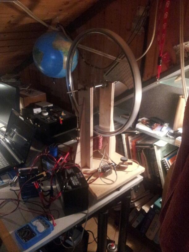

My wheel is made of steel,54cm dia,36 spokes,18 regular north magnets 40x25x10 mm,[email protected] Amp,The scalar north Rotor is 47 cm dia and 17 mag and [email protected] Amp
Coil:7xAwg 19,1xAwg 22,40m(132ft) long,Weldingrods R60 1.6mm,18mm(3/4") dia,85mm long,8mm distance core to mag
7 MJL 21194,470ohm baseresistance,pot 20 ohm
I have all new 2x14 AH Gel cell(20charge disch. cycles) and 2x22AH(340CC)Lawnmover lead acid(35 cycles)
Cap dump Capacitor 30000uf 100v low ESR,SCR 45Amp 1200V,100ma Gatecurrent,12V zener,it dumps every 0.85 sec from 23.5V down to battery V,i thougt i am so far away from 1to1 that its enough with the SCR or how many % is the comparator better?
Everything has roomtemperature
With this setup the batteries are to small,i paralell each two that i have 44AH and 28AH.
I let it run with one and charge the other and vice versa.I need ca.3 to charge 1 and without capdump it charges faster but dont hold the charge when i hook up a lamp with C20 rate its 3 times down than i need to charge.

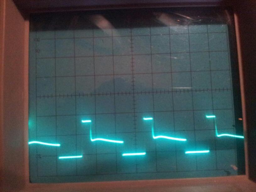

The H-wave is a little broader than with scalar north and the last line before its straight is with reg a little crooked and with scalar more rectangular,the spike is not to see on the photo,its ca.40v and when i hook up a cap instead a battery without capdump it charges to 450v.

You said the coil should saturate to a certain point,When i hook up the oscilloscope then i adjust the pulses so that i have one puls per magnet,thats the fastest speed and lowest ampdraw,but when the wheel stops and i want to start it again then i have to lower the resistance on the pot until it speeds up to the final speed and then i can turn it up till it beginns to switch twice per magnet then i turn it a little down that i have one pulse per magnet.By JB you see he has the fixed 12 ohm resistor and the wheel speeds up without changing the resistance,if i adjust it that it speeds up without changing the resistance by every start i need 700ma ampdraw and when i adjust it every time with a new start i have in the end with the same speed 600ma ampdraw.Can you tell me what is better,charging is at 700ma faster than with 600ma thus the speed is the same.

Yesterday i have made a new coil for my bicyclewheel with AWG 19/22 because i had no 20/23 at the moment and the Ampdraw goes down from 1 Amp at 260 rpm with the 18AWG coil to 0.6 Amp 230rpm.The other things i have to change.
Thanks Tom,i dont know why i thought it doesnt make much difference when i had a bigger coil.So guys,dont waste your time,build it exactly like JB`s .
Leave a comment:
Thanks Tom i will change these things.Originally posted by Tom C View PostForelle,
you said everything is same as Johns its not....
1- get rid of the superpoles and go to regular north magnets.
2- if your cap dump charges slower there is something wrong with it, SCR cap dumps are not as effective as comparator style ones. there are losses in the zener/ led and the SCR. you can see the difference simply because the dump is less effective than pure radiant, it should be the other way around.
3- you need to do a 20/23 coil 8x18 is a huge coil, you are barely pumping the coil at 1 amp. it is all about scale, the coil needs to be saturated but just barely.
Build a machine EXACTLY (component wise) as John's machine and test from there. please cycle your new batteries on a standard charger and get the capacity logged using your CBA , you need a baseline to test from.
